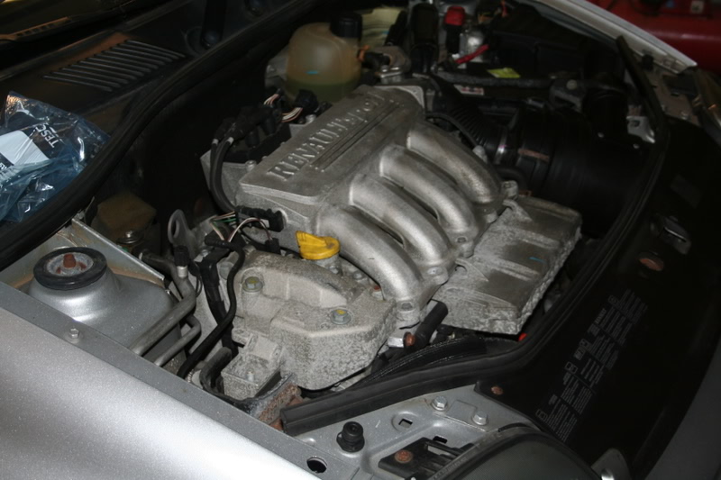

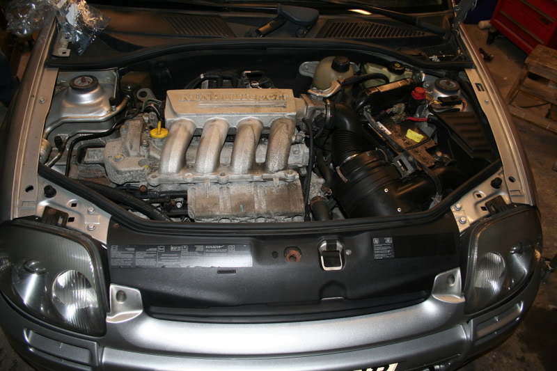

normal 172

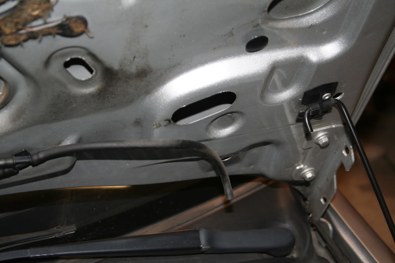

window washer jet unclipped
bonnet off.... much better for access etc

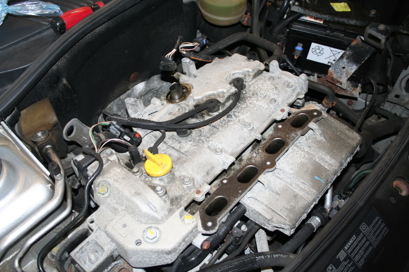

engine cover off

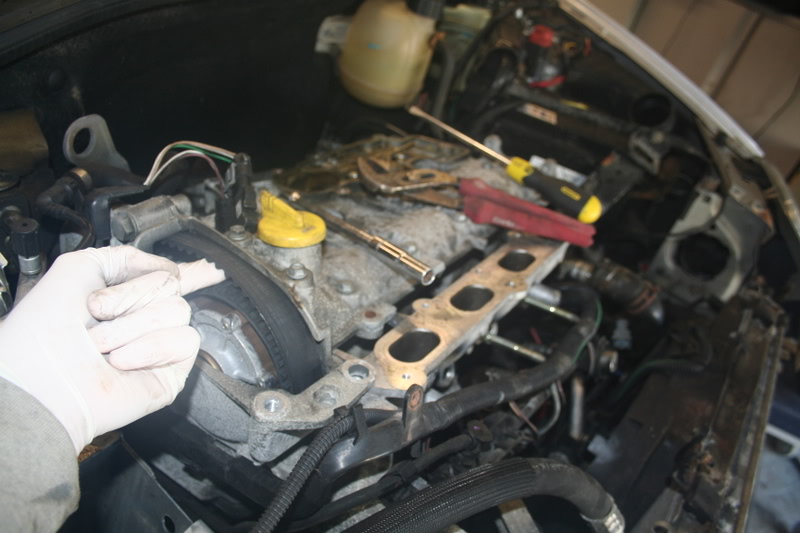

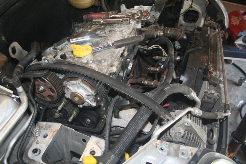

checked the aux belt.. why is only half there?

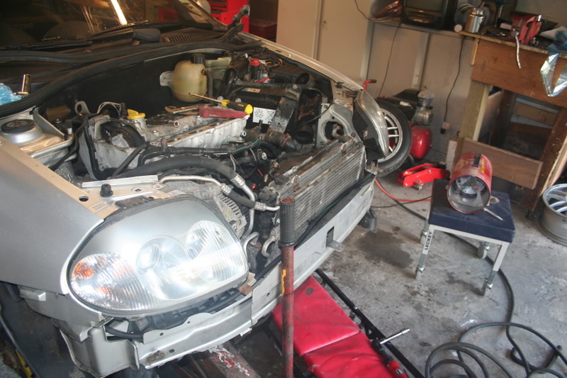

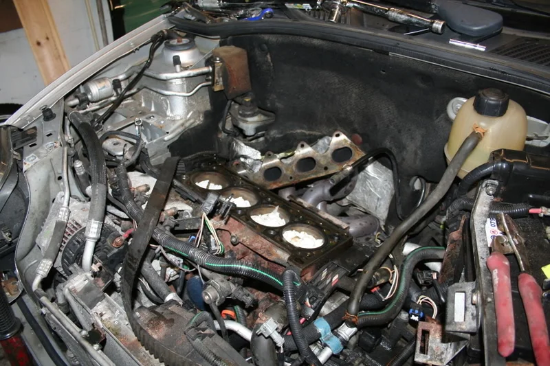

Pelham, coil pack, map sensor, air temp sensor, ICV sensor, TPS sensor and throttle cable removed

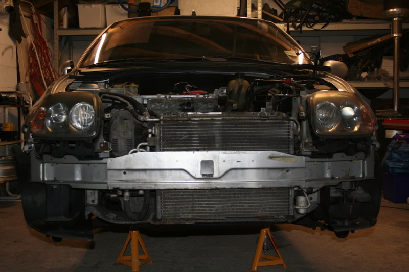

Arch liners, sump pad, upper grill, bumper, fog light loom, T-piece slam panel, injection rail protector, wheels off and car jacked up on stands

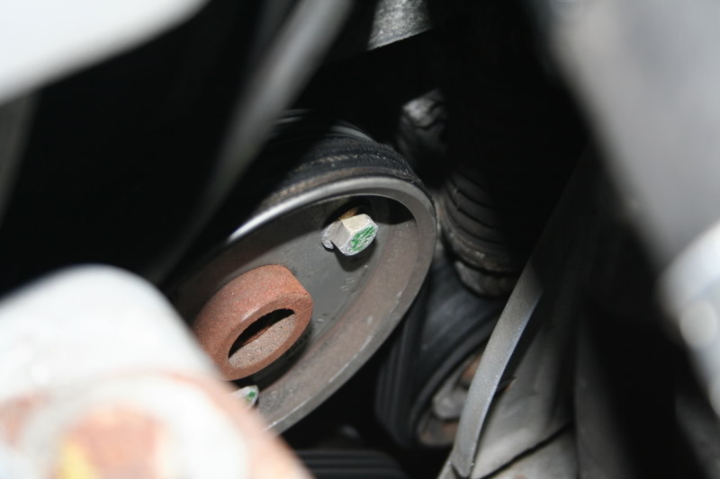

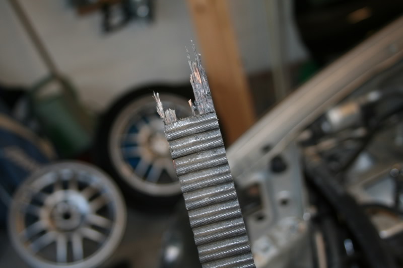

Yep defiantly only half the AUX belt..... ekk

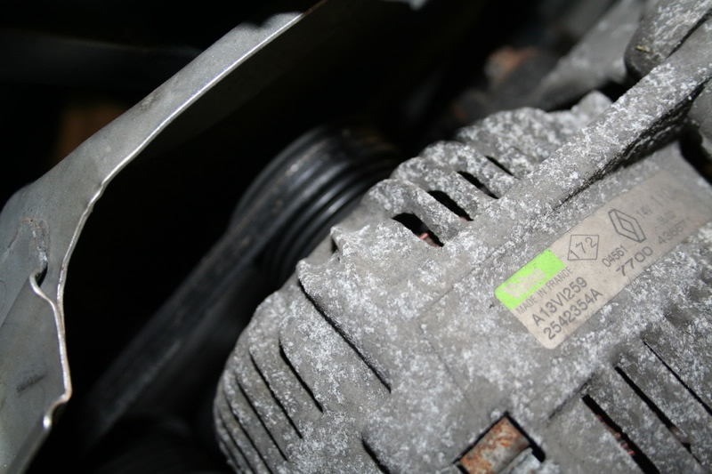

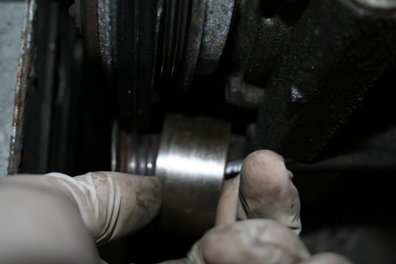

Ohhh the pulley has lost its bearings and sheared from the end-case........nice

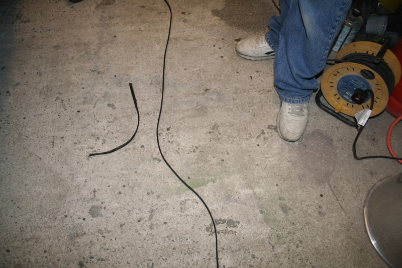

Aux belt removed..well one side of it, it looks like a piece of string lol...wonder where the other half could be? :S

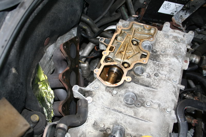

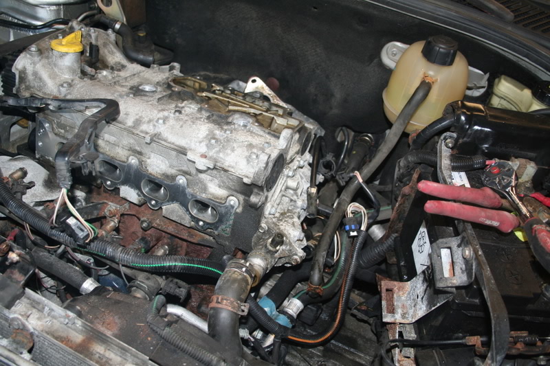

Oil separator and solenoid valve for the VVT removed.
Coolant drained, temp sensor unclipped, loom clips and earth detached from head and removed the top alternator bracket and the lower inlet, fuel rail, injectors etc.

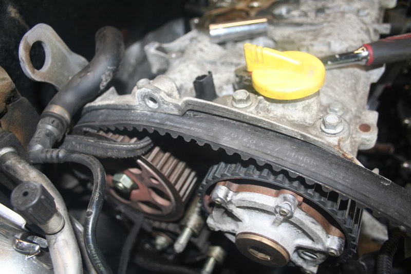

Top suspended engine mount removed and cam belt cover (supported engine on jack)
Oooooh...............found the other half of the aux belt wrapped around the inlet pulley

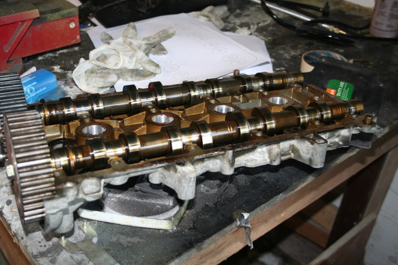

Now I couldn’t remove the pulleys as the belt had snapped! So they would just spin! Ahhhh! So after a lot of faffing about and tapping with a rubber mallet I got the rover cover off!

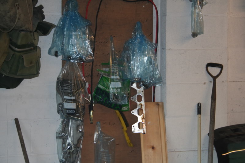

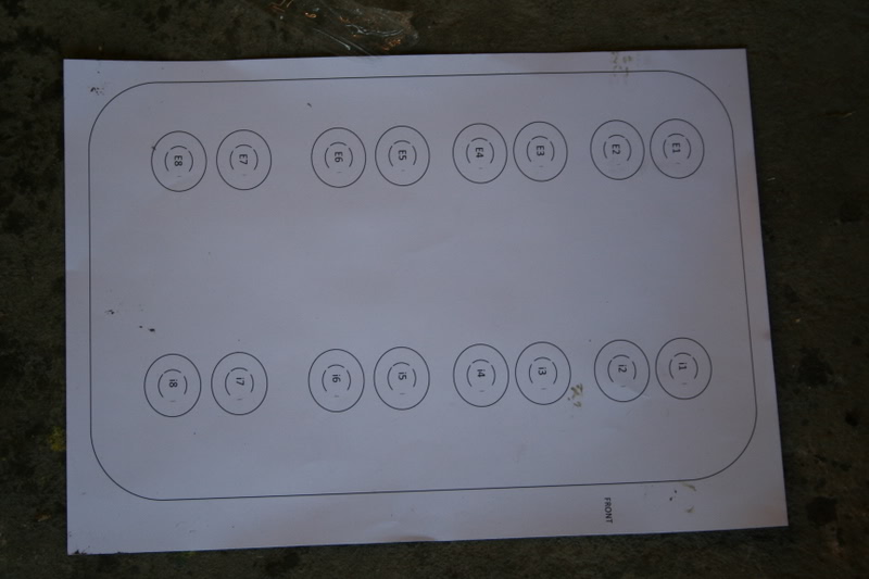

My ingenious way of not losing the tappets original places! Fitted each one in a money bag and labelled to each corresponding fig on the diagram.
All the bolts bagged up and marked in order!

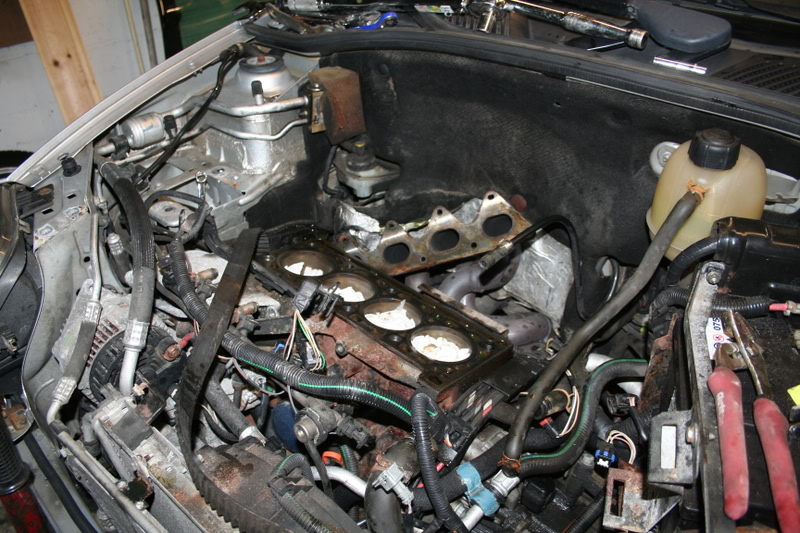

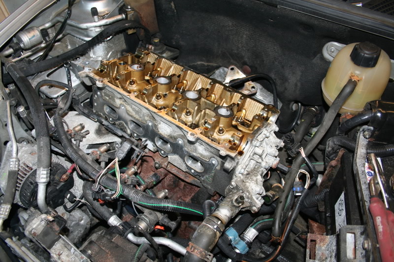

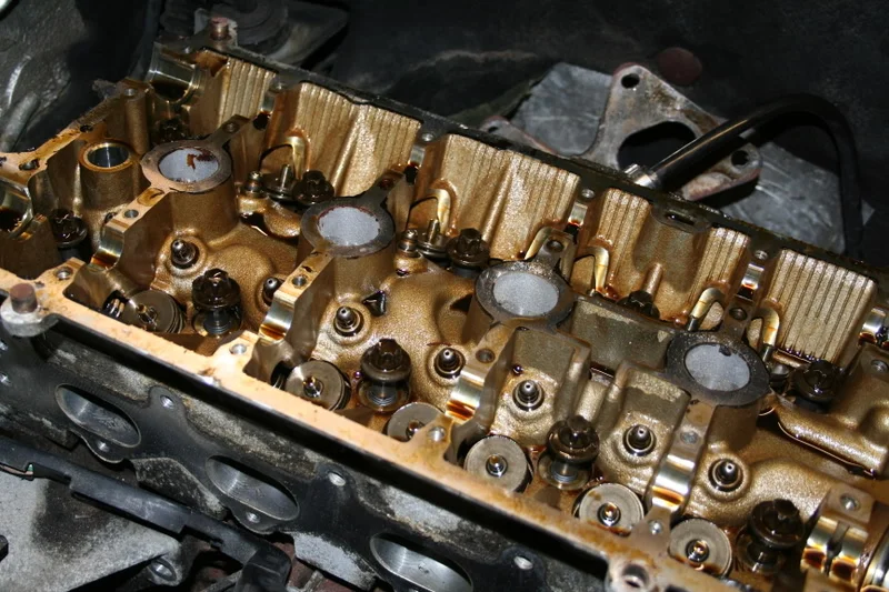

Cracked the head bolts loose,

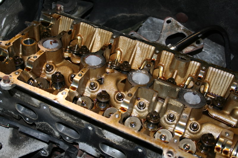

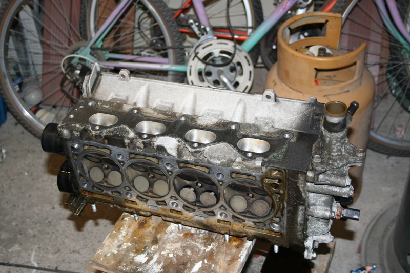

Removed the head :D

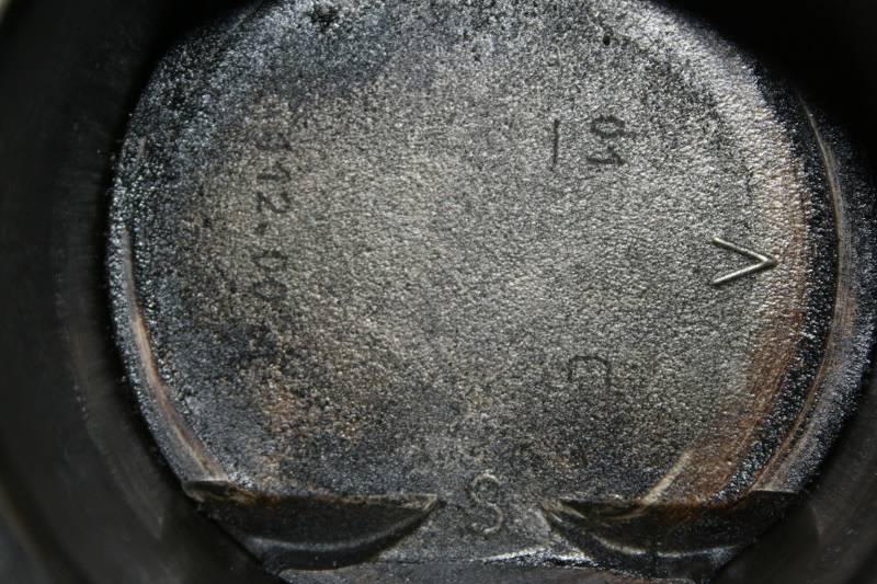

11 bent valves
And one nicked piston
And a few “before hand shots of the head ports” roll on BenR port and bowl headwork! It’s also having cams, inlet match, remap new gaskets, and a few extras :D

Nice work, he/she made a good job of that. That idler always seems to be a weak point, its a bit exposed to the elements all the way down there.
How many miles has it done??? Thats the cleanest valve cover ive ever seen, normally they start to leak oil up through the bolts.
Good reason there to have the aux pulleys changed and not just the aux belt like so many people have done. from my experiance (all makes and models) its 90% of the time a pulley failure not the belt. Seen that lower pulley fail many times on megane's etc. sometimes takes part of the sump with it on those
69k mate, its been off before for the cambelt

but it was a very old belt, what was left of it was in a poor state (cracking when bent, very dry, could pick bits off it
