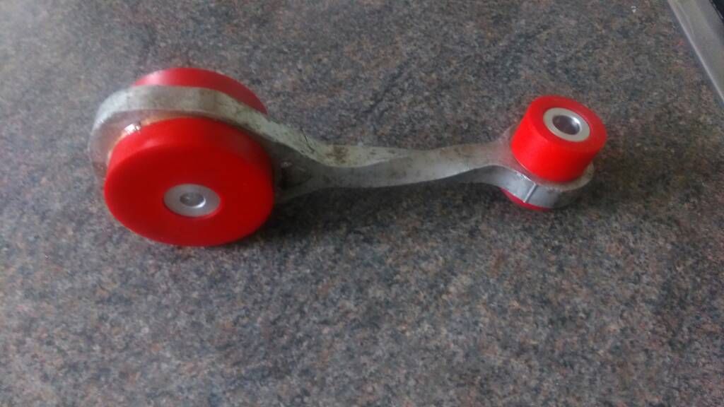

Fitted my racing flex poly Bush dog bone bushes. Surprisingly easy. The only difficult part was getting the dog bone back in as the poly Bush is a tight fit at the back.
Now to let it bed in. On idle it's fine on gentle acceleration it feels like the car is going to shake apart!

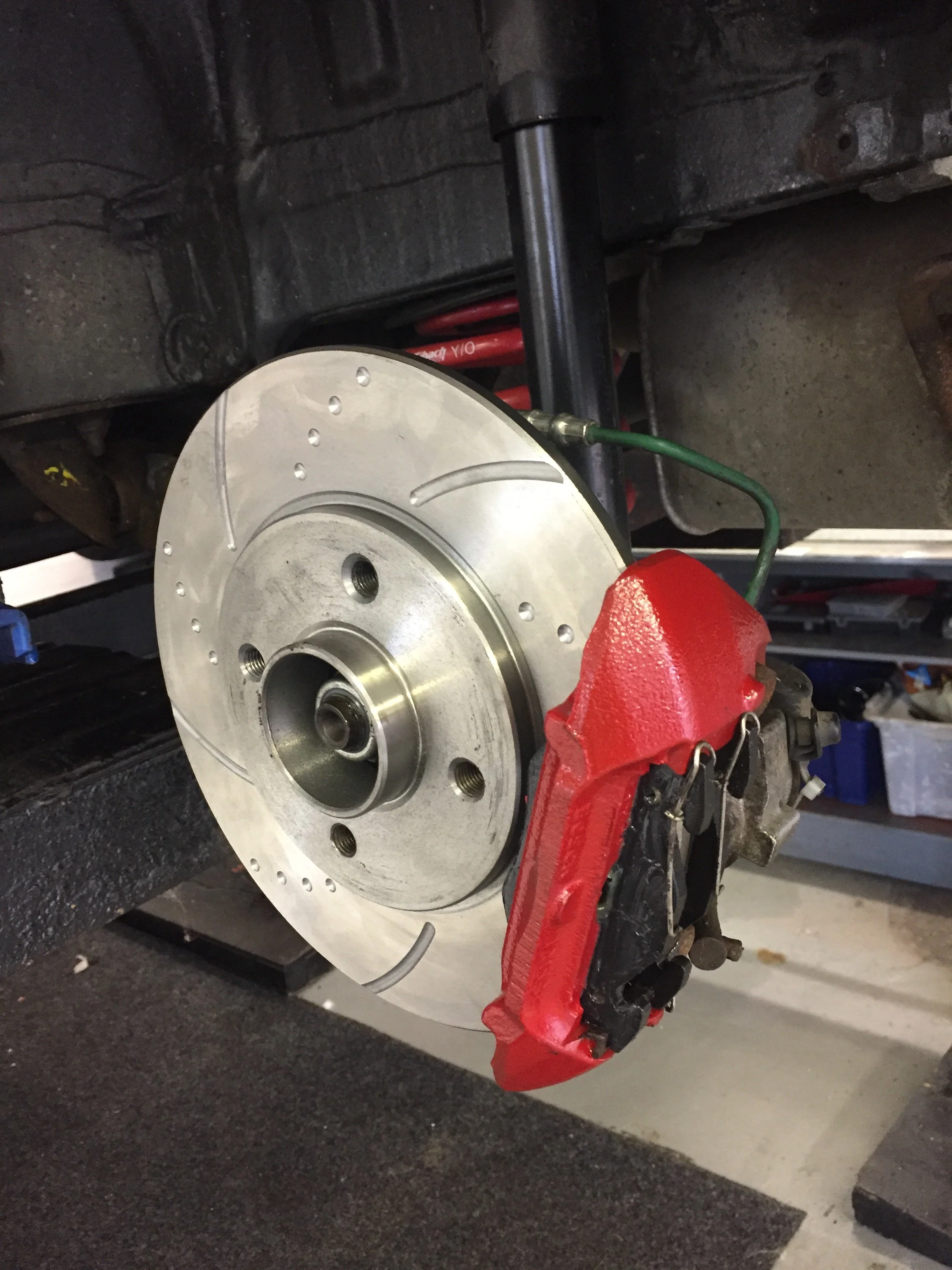

Fitted some grooved and dimpled discs with EBC Ultimax Pads and painted the calipers!
It stops on a six pence now!!

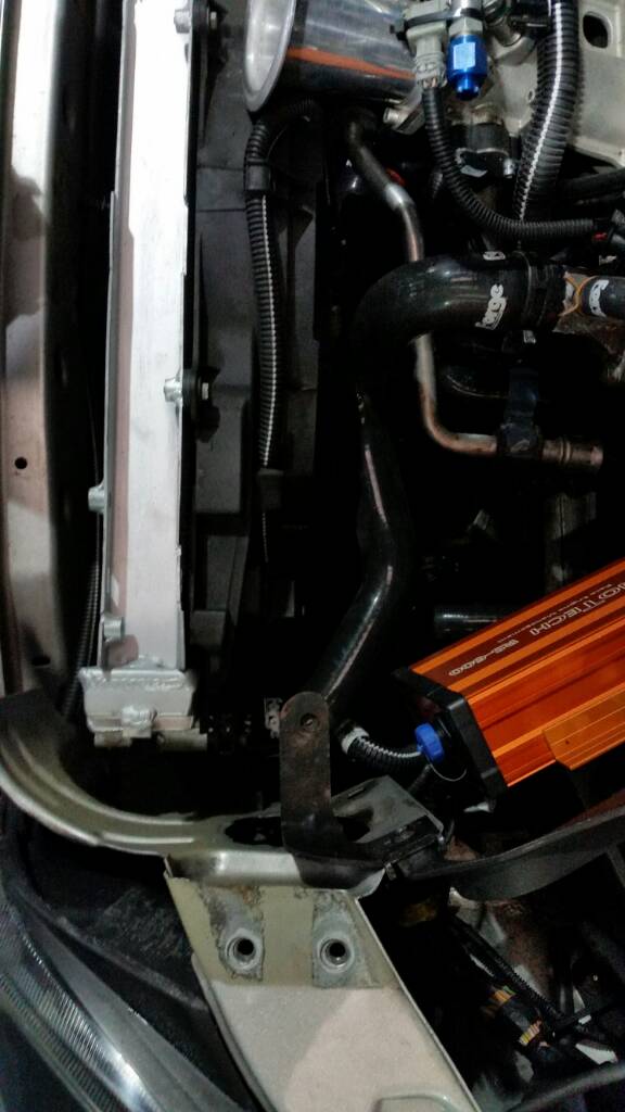

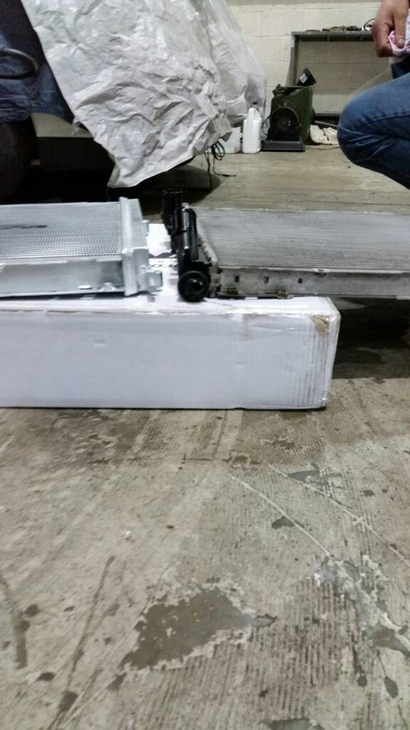

Put direnza rad on and Forge hoses
Nice steady job
Bit thicker core
Hope u can see new hoses lol
Cheers Pat

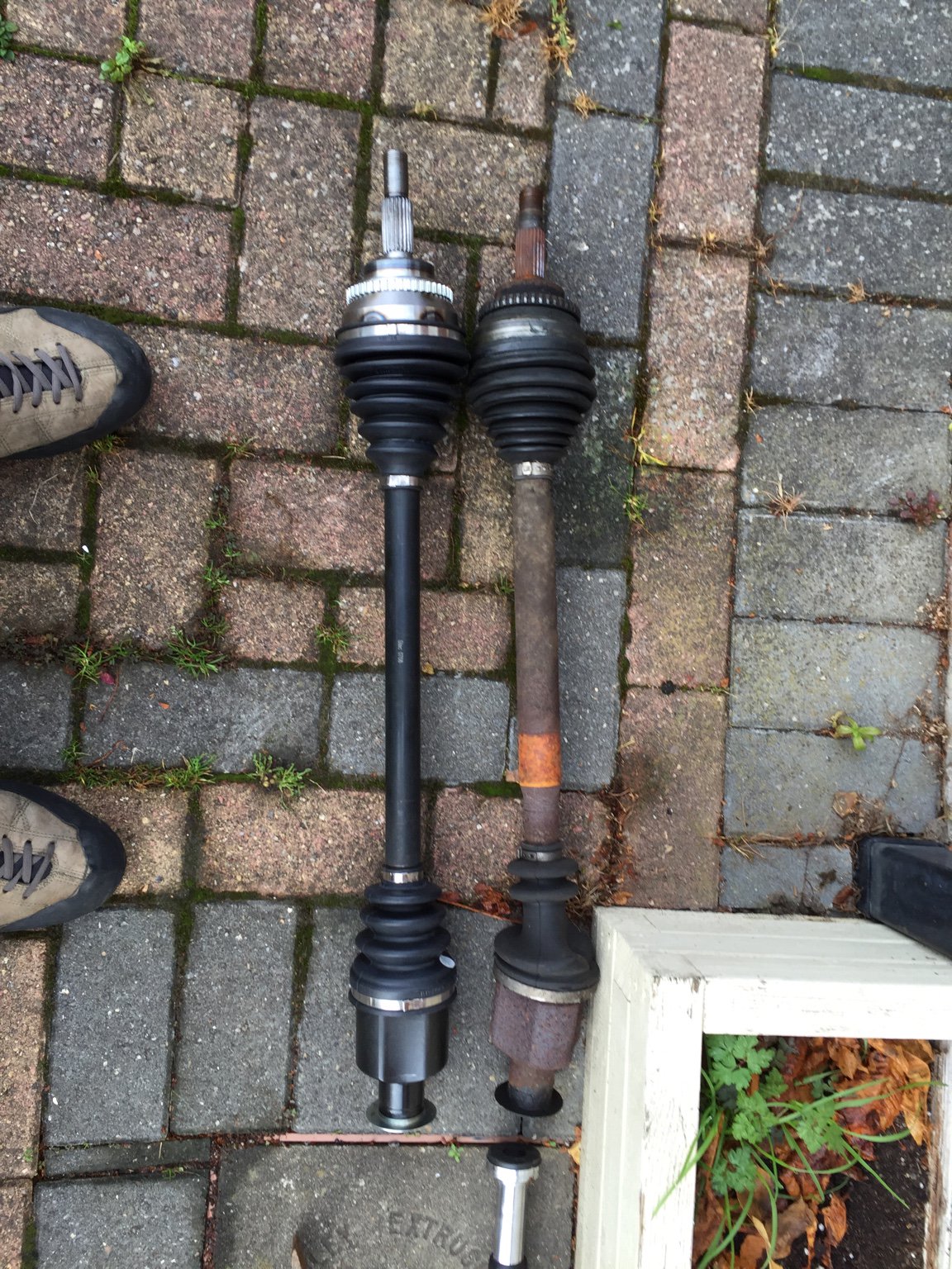

Replaced os driveshaft. All done and dusted before 0830 thanks to the clocks going back! Never mind an extra hour of sleep....its an extra hour of car maintenance!!! Old driveshaft was proper rattly.
You've got two different size shafts there? Something isn't right?!
You've got me worried now @DannyR . They looked the same on a quick inspection and it fitted but now you've pointed it out in the photo it does look odd. I used a Renault part number given to me by mike at Rentech to cross reference against the shaftec part number and they matched up. Renault number 8200027842 and shaftec number R209AR. I've driven it and it seems ok. How would I know if it's not?
Non genuine ones just do not fit whatsoever, you can see its longer by a fair bit.
Where was movement in the old one as it could always be the old one that's wrong?
The movement in the old one was the outer cv joint being knackered. I'll phone the company today.
I don't know. Looks old enough to be
I had no end of trouble with driveshafts and I found the cup ones (slightly longer) used to grind inside the gearbox on sharp corners.
If yours fit ok and don't make any noise, I wouldn't worry about it.
This is a nightmare. Thanks @Daniel and @DannyR. I'll try some tight corners and see if it makes any noises. Need to replace the droning rear wheel bearing before I'll hear anything though!!!
