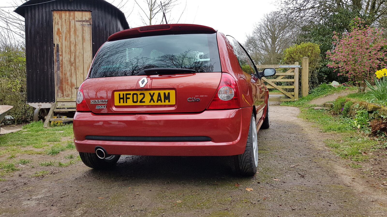

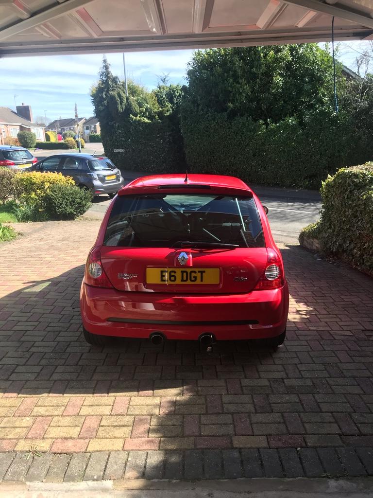

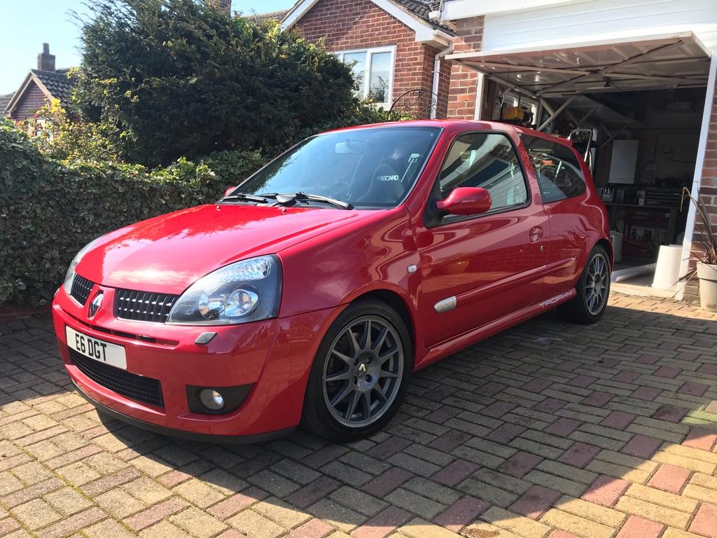

Flew through the MOT today. No advisories 🙌🏼
Cover your numberplate even though it’s in your profile pic 😂
Photo was taken using snap, but good to know we have a stalker here :ROFLMAO: 10 cliosport points for you my friend Or were you just making sure I wasn't BSing about the no advisories :D

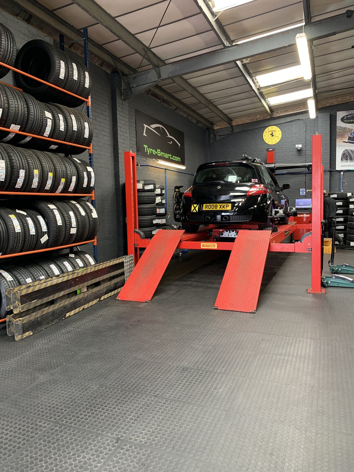

Popped down to see the guys at TyreSmart in Witham, Essex again today.
They did a grand job on the Clio so decided while I had the Megane out of the garage and some spare time I would get her alignment sorted.... any one for off the scale Toe out?! 🤣🤣

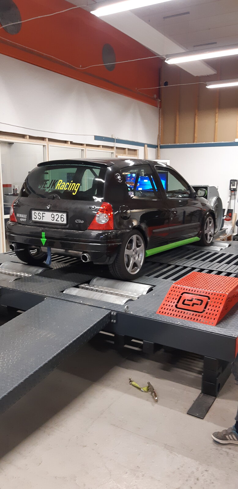

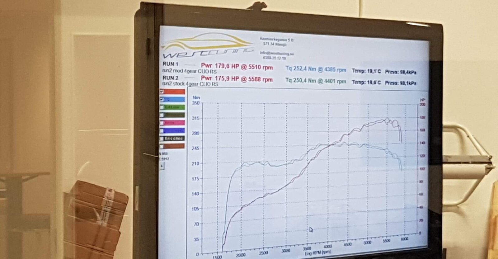

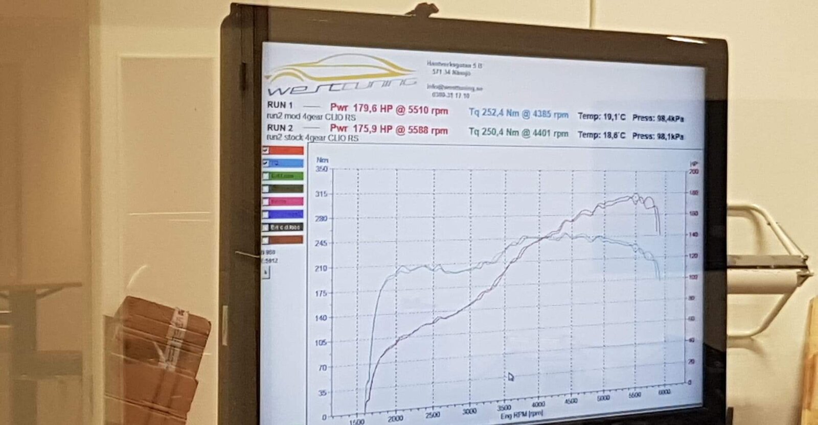

Got the car on the rollers yesterday.
Engine is stock except match portet inlet, full flow cat, 2,5" exhaust and airfilter.
AC and PAS removed.
Anyone that can guess the numbers?

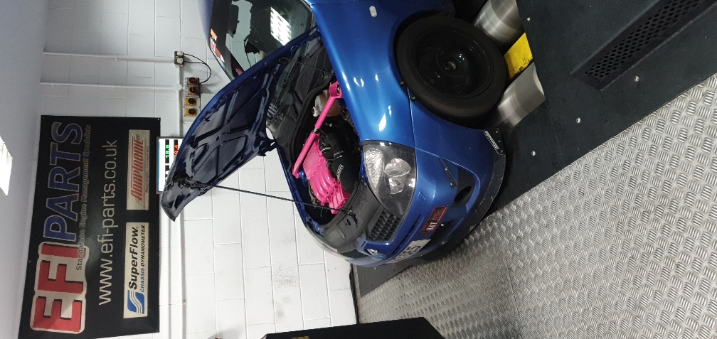

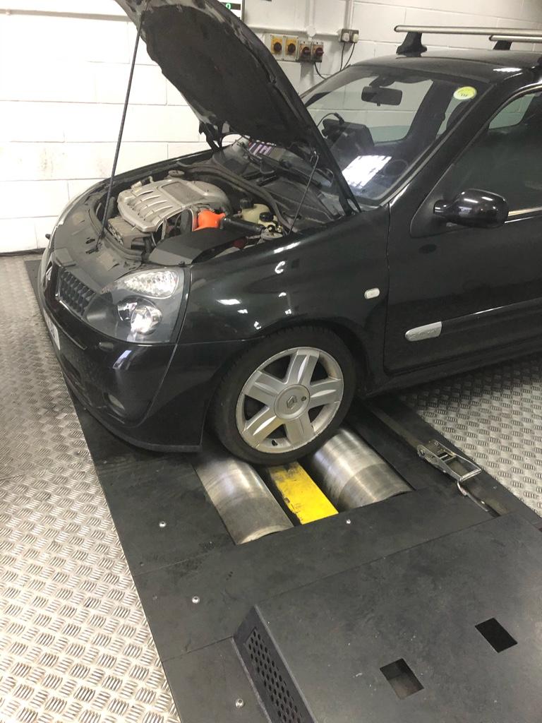

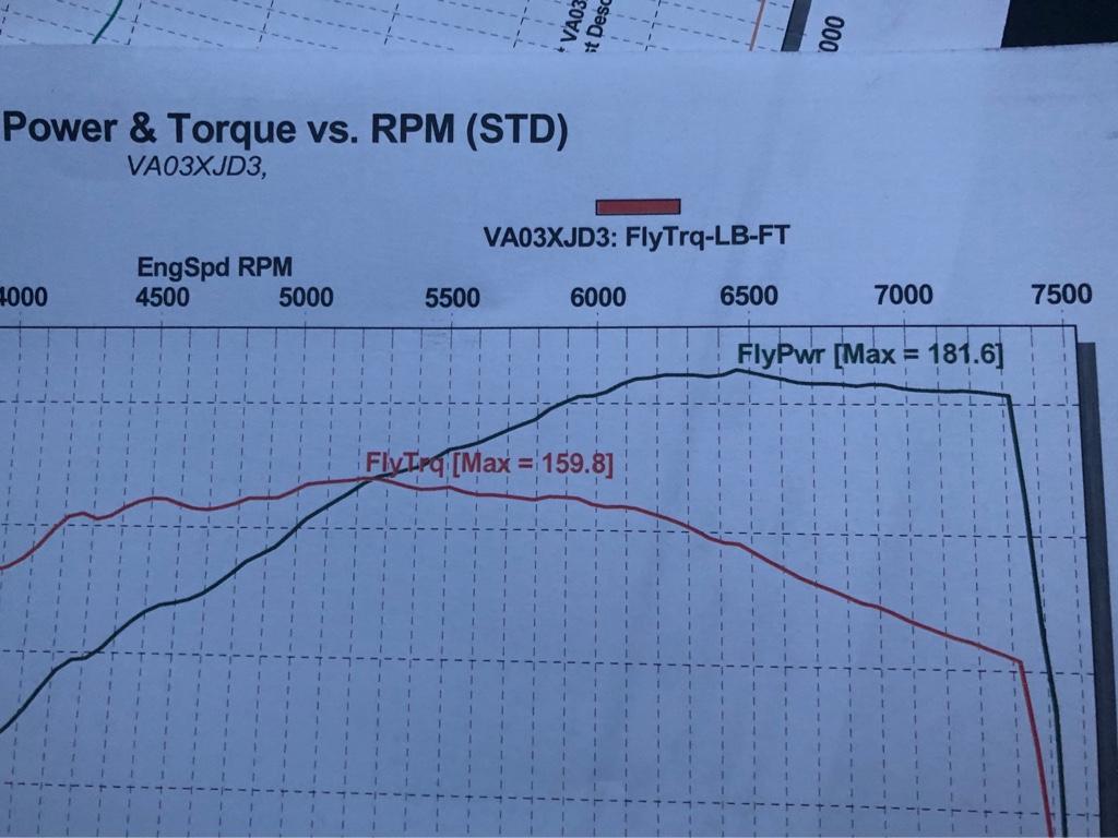

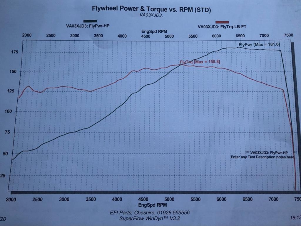

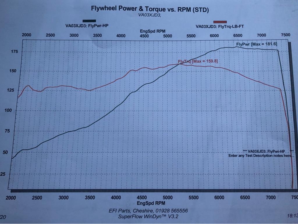

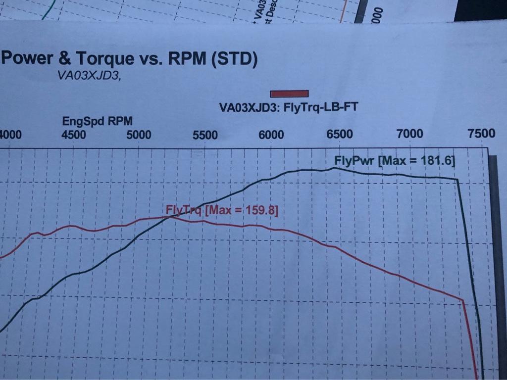

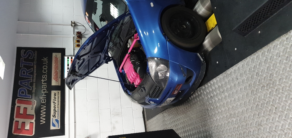

Snap took mine for a power run at EFI
Ah.. nice to meet you today... It was me...

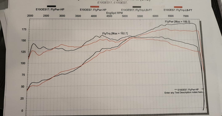

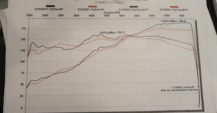

Final results at Efi today after the recent mods of:
197 cams with 8 degree inlet advance
Port matched inlets
Ramair filter.
Epas
Already had at last dyno at 176bhp
TTV lightened flywheel
Arp conrod bolts
Ktec cat back resonated recess exhaust
Today it finished mapping at 189.3bhp with standard 172 injectors running at 95% and safe... Engine mods finished for the foreseeable so time to just use it...

Yeah nice to meet you mate
That's a really good torque figure for a 1*2 isn't it? Mostly seeing around 160 ft lbs, 252nm is around 185?
Must drive well!
Peak power is really down the Revs compared to most
Must drive well!
It drives really well. It will be compared to 4 other Clios and a bunch of 206 RC:s in the end of April when our series finally starts :)
I have no idea [emoji1787]
Yeah looks like the graph is shifted 1k lower, couldn’t work out why your peak power was only 5.5k. Because of how you calculate bhp from torque the graphs should cross at 5.2

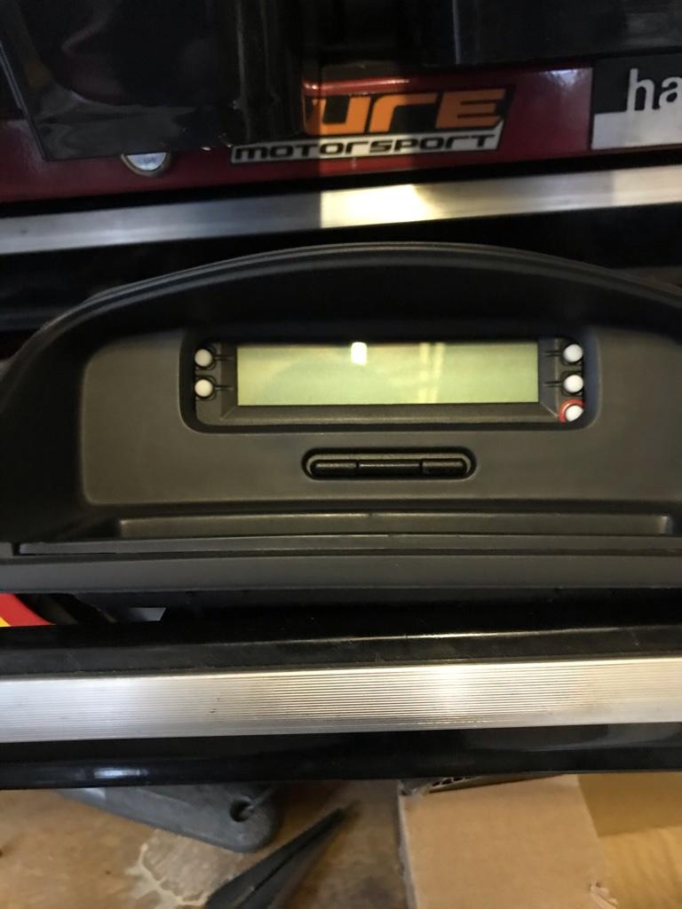

Finally got round to fitting the Spa Design oil gauge, seeing as there's nothing else to do in the current situation.
Originally planned to mount it in an A pillar pod, but had a quick look at the panel with the cruise and esp switches and thought 'it'll fit there'.
Just have to play with the settings now and change the display colour and stuff.

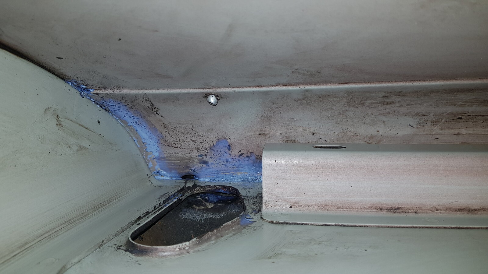

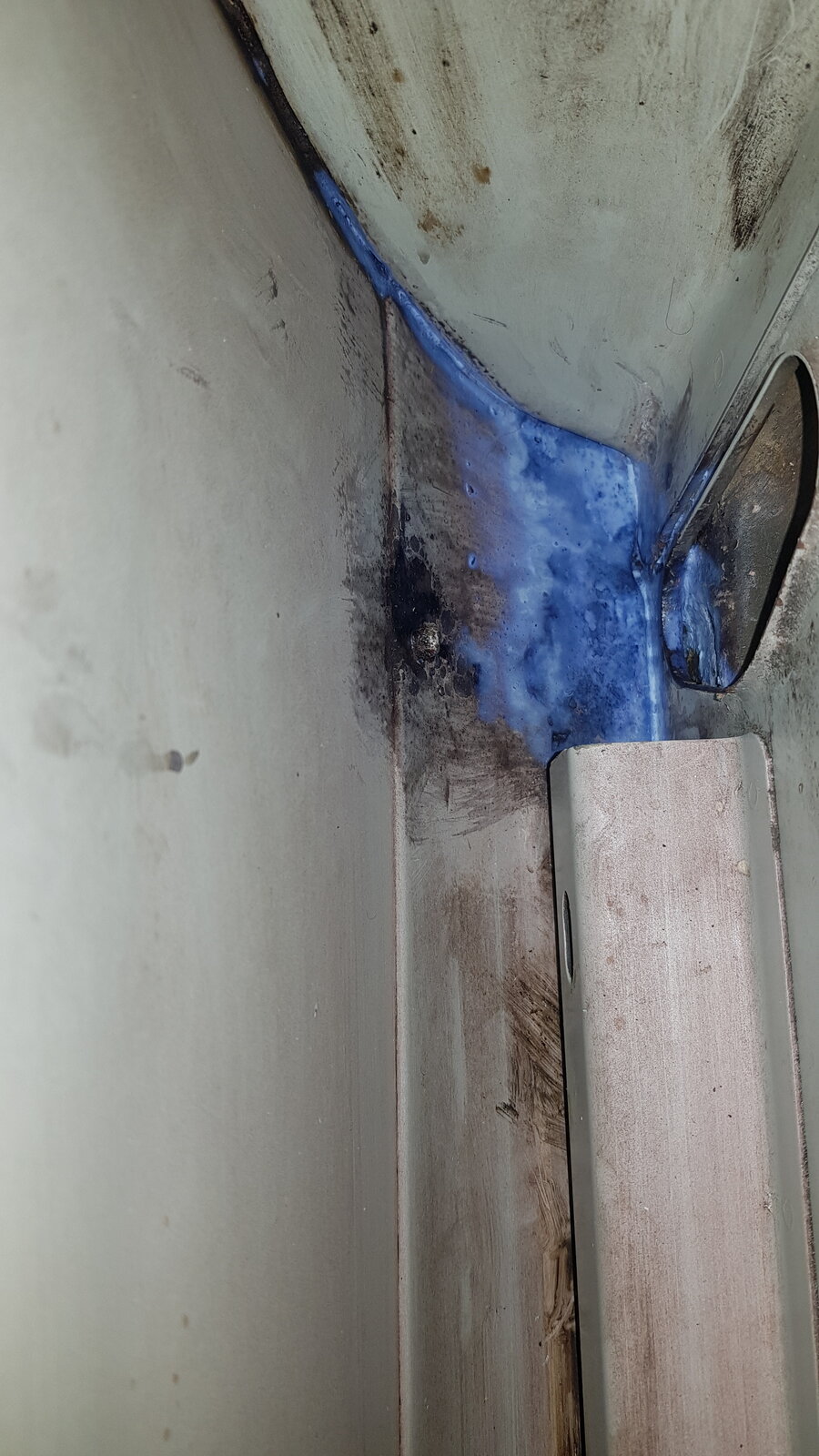

Stripped the rear interior out to check over and treat my sills again only this time with BH Hydrate 80 and S50. Pretty tidy for a once neglected 02 plate
This must be the most boring and time consuming job so far.. Makes a big difference though!
An hour and a half in:

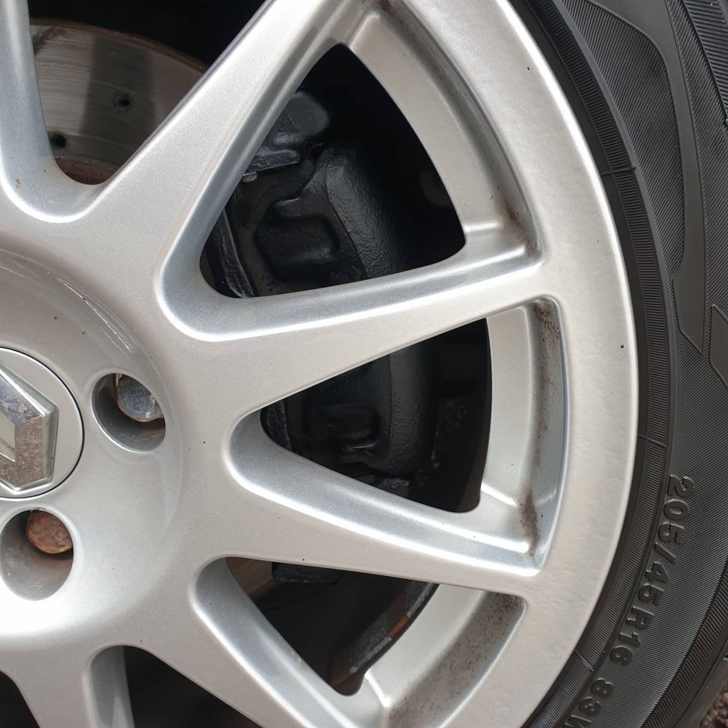

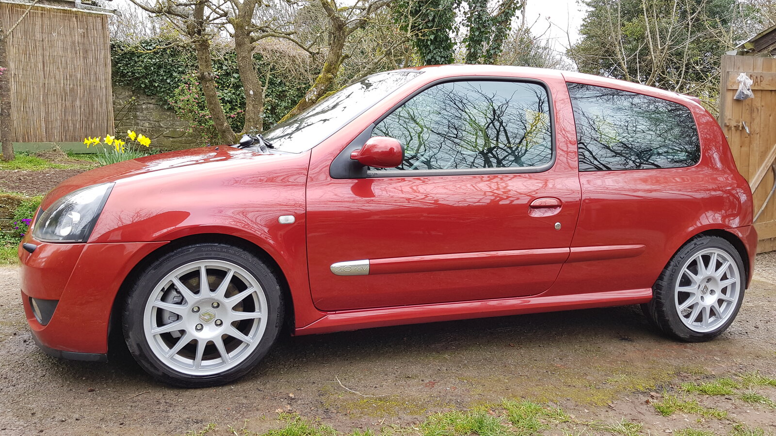

Washed it and cleaned inside the door gaps. Gummi pflege'd all the door rubbers. Polished the miltek. Tried to clean the alloys but winter has ruined them. They are beyond saving and need refurbed. Noticed the rear heat shield is hanging off. The miltek is squint and someone has put a tie wrap on one of the hangers to try fix it, which hasn't worked.
I need to get some tar remover. Are they all much of a muchness?
Maybe some tyre cleaner too, because they are very grey and manky
Looks lovely to me, rare to see flamers too so definitely a keeper!
That was the pretty side, its cosmetically a bit rough but I dont care anymore. Bit of bodywork one day maybe. Sills are good though!

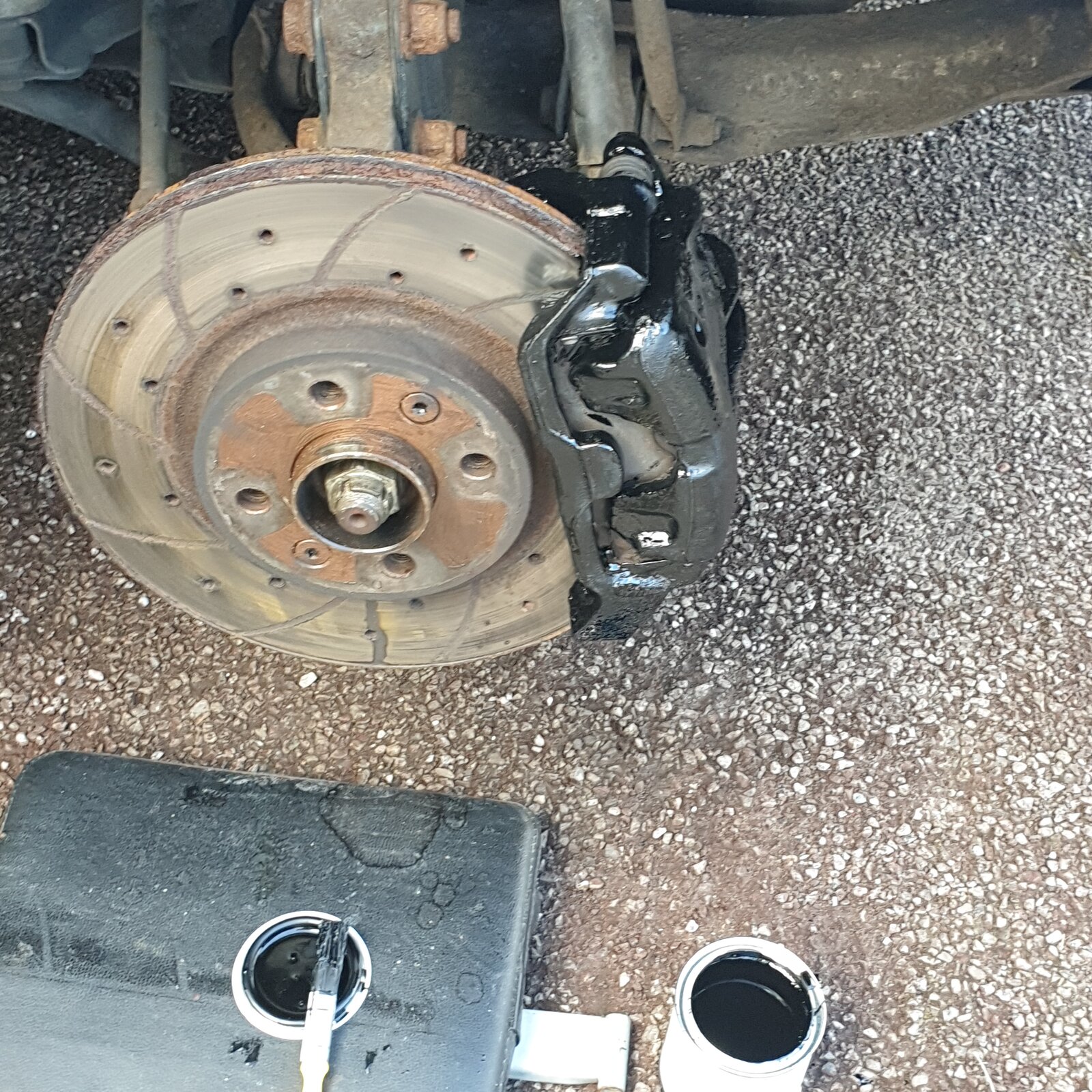

Painted my rear calipers silver to match the fronts I did a few weeks back, bled them all again to try and get the slight spongey feel gone but I've still got a bit of travel before they bite which is annoying.
