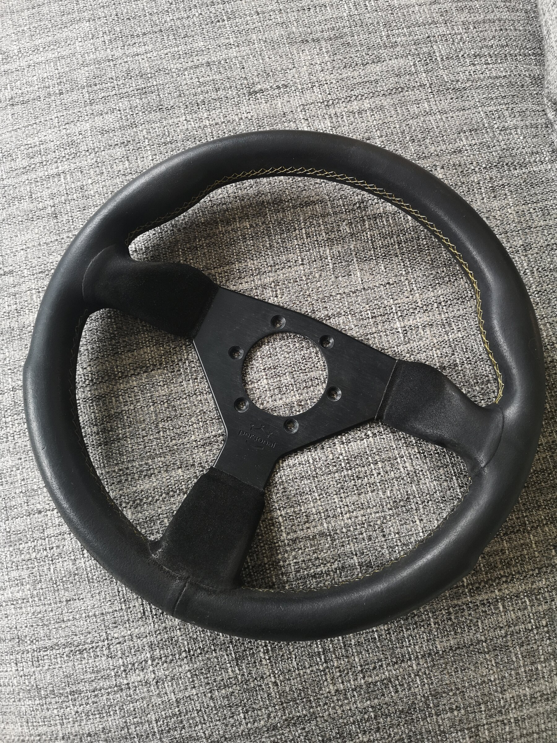

Came across a video last week of @RuskiWeldShit cleaning his steering wheel, so thought, while my wheel was off, I'd give it a go.
I got it second hand and it was quite worn and very shiny. I didn't mind that much though tbh, that it looked decent anyway.
This is a before and after. Still drying but still a considerable improvement. Feels much better now as well.

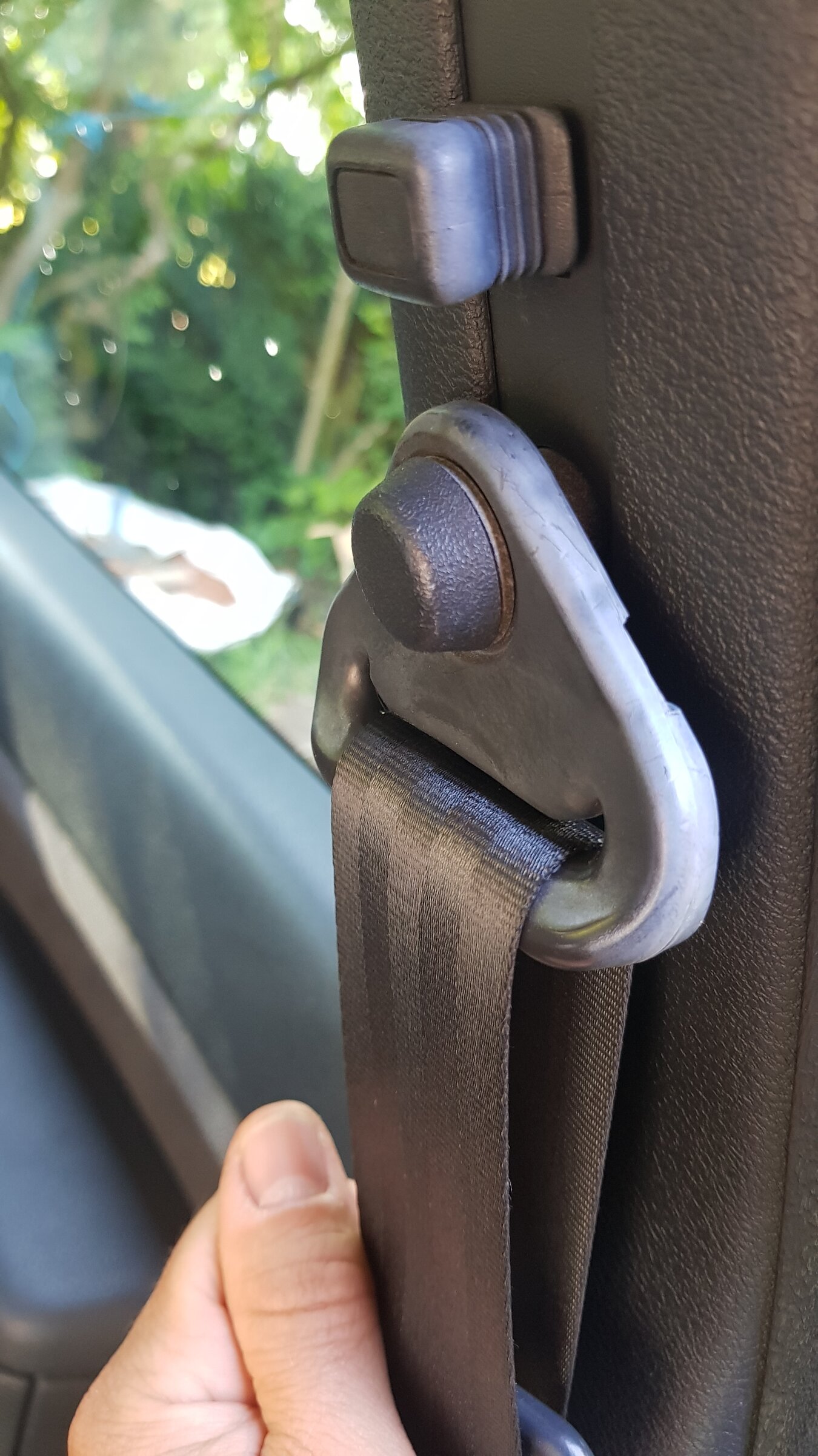

Soaked my seat belts in coop stain remover, such a difference, then I tidied up a few fluffy edges by quickly flicking a lighter over them followed by C4 on the buckles and anchor points. Such a difference which doesnt really show up in my photos.
Before
After

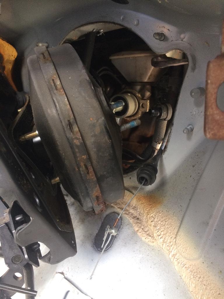

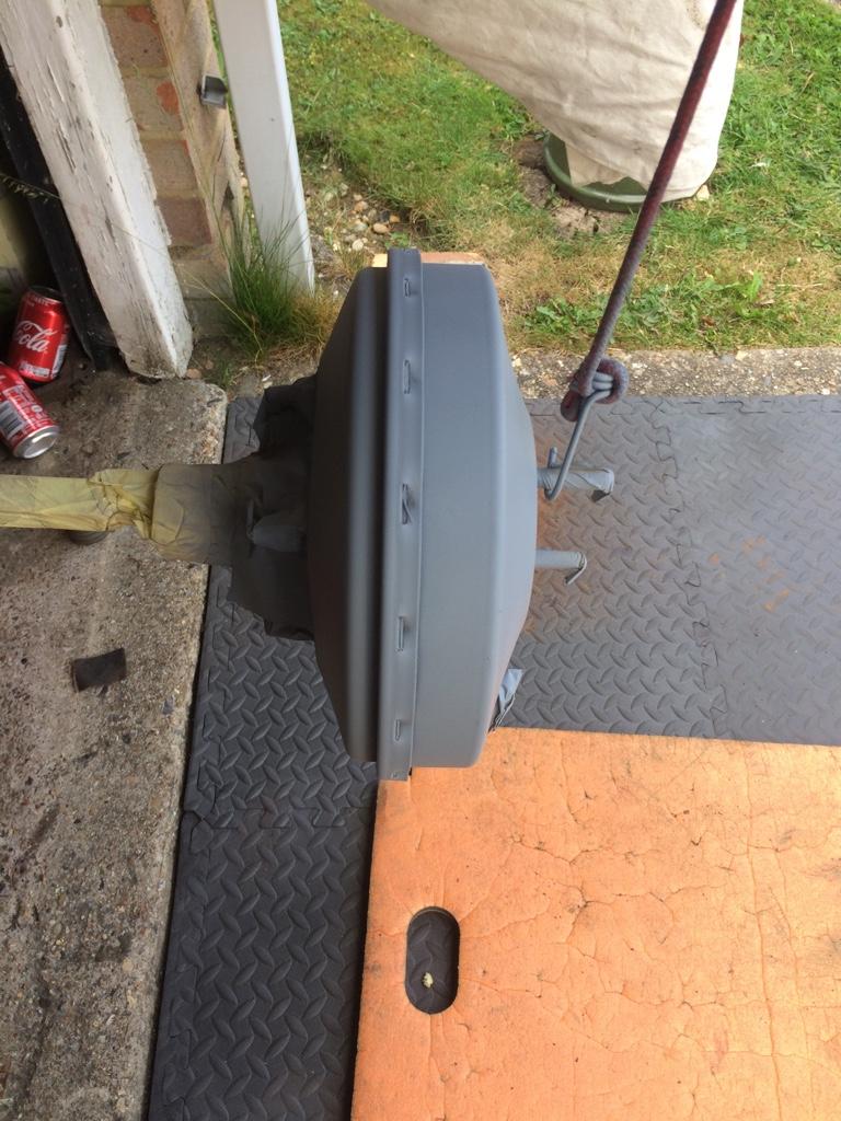

Productive day on the servo removal .
Saw a post the other day regarding these being rusty due to brake fluid spillage , so I took a look at mine and wow it’s crusty and rusty lol.
So spent today giving it a good clean up .
Sprayed it with etch primer to begin with followed by hammerite , think come on it’s not going to win any prizes as it’s all hidden away right .
That’ll do .
How easy is it to remove the servo? Mine looks like its on its last legs but haven’t investigated removal/refitting yet!
As you can see from my picture , it’s quite easy really .
But don’t forget I have the column removed also that’s not there .
Arch liner out , then the two nuts on the brake master cylinder.
Then all the nuts inside the car .
All I can see being an issue for the Oe throttle cable is that it need to be removed gently and then passed through the black bracket into the engine bay , as when you remove said bracket back into the car you’ll need to swing it towards the heater to make a little room for the servo to pass through .
I did un-hook the clutch cable at the gearbox end to help .
But I left it attached to the pedal still , no big drama’s leaving that still on .
That’s it really .

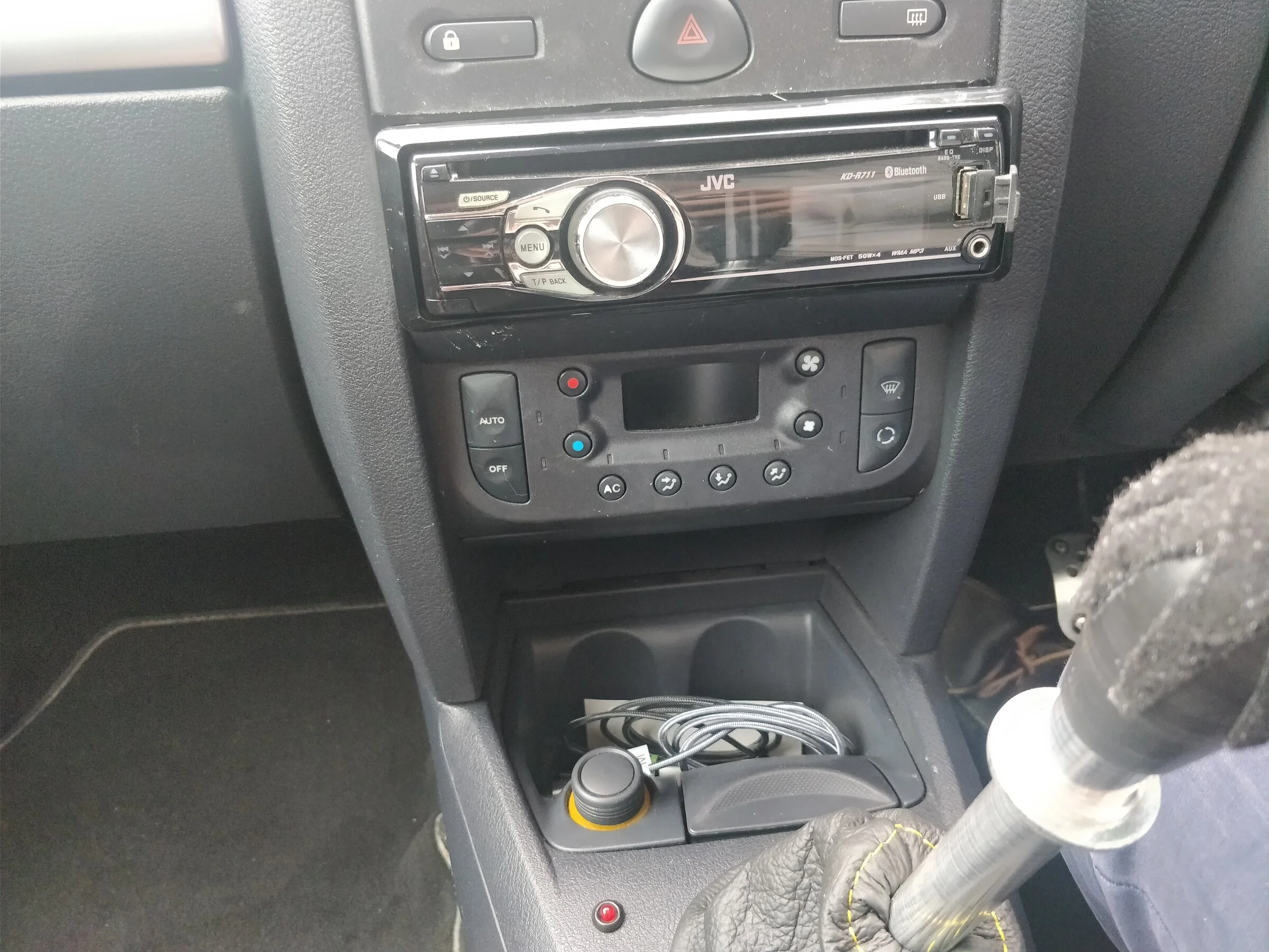

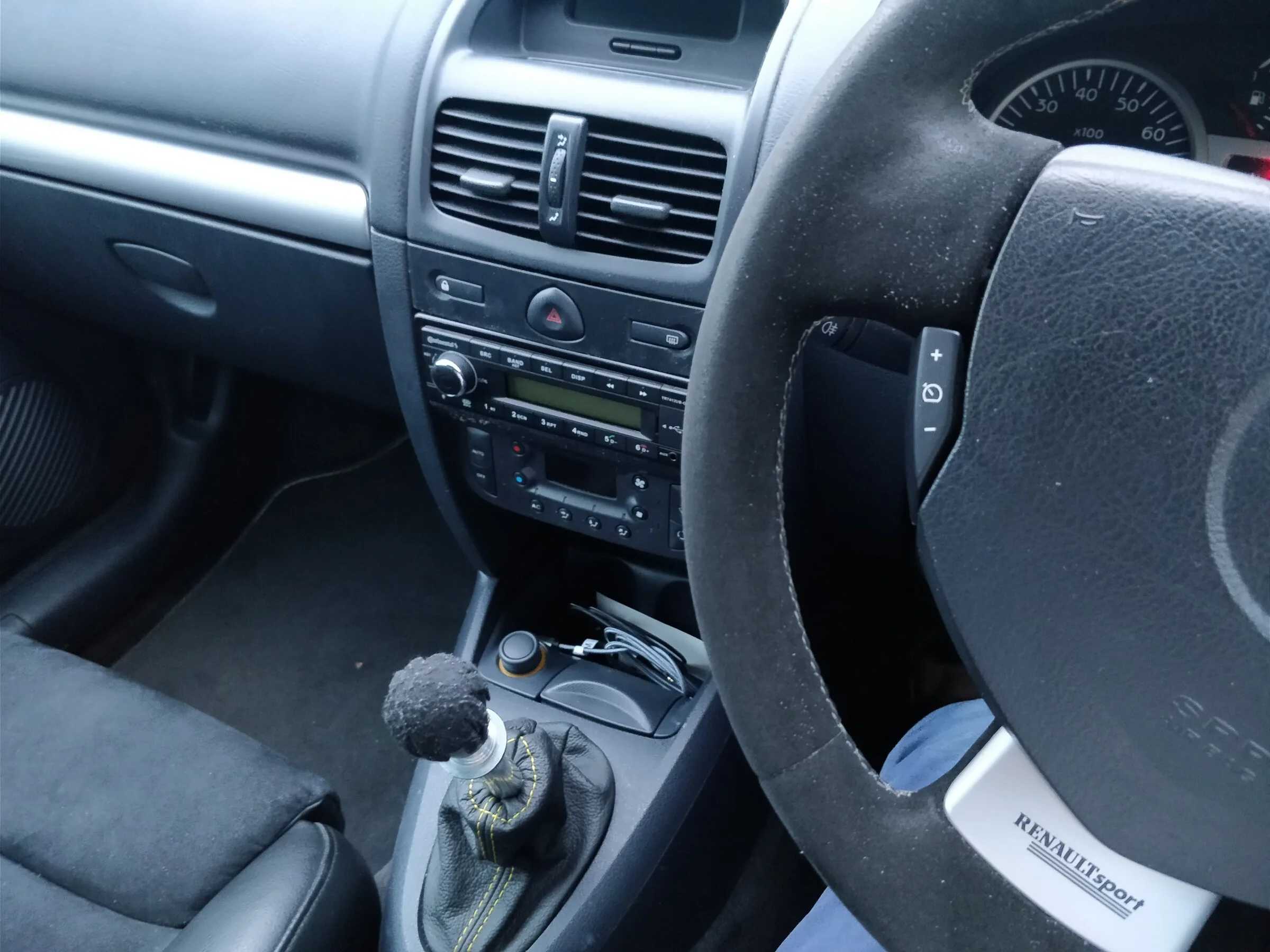

Replaced my stereo since I always found the modern units didn't fit the Clio's simple interior.
The only issue is that I can't find a stalk adapter.
From this:
To this:

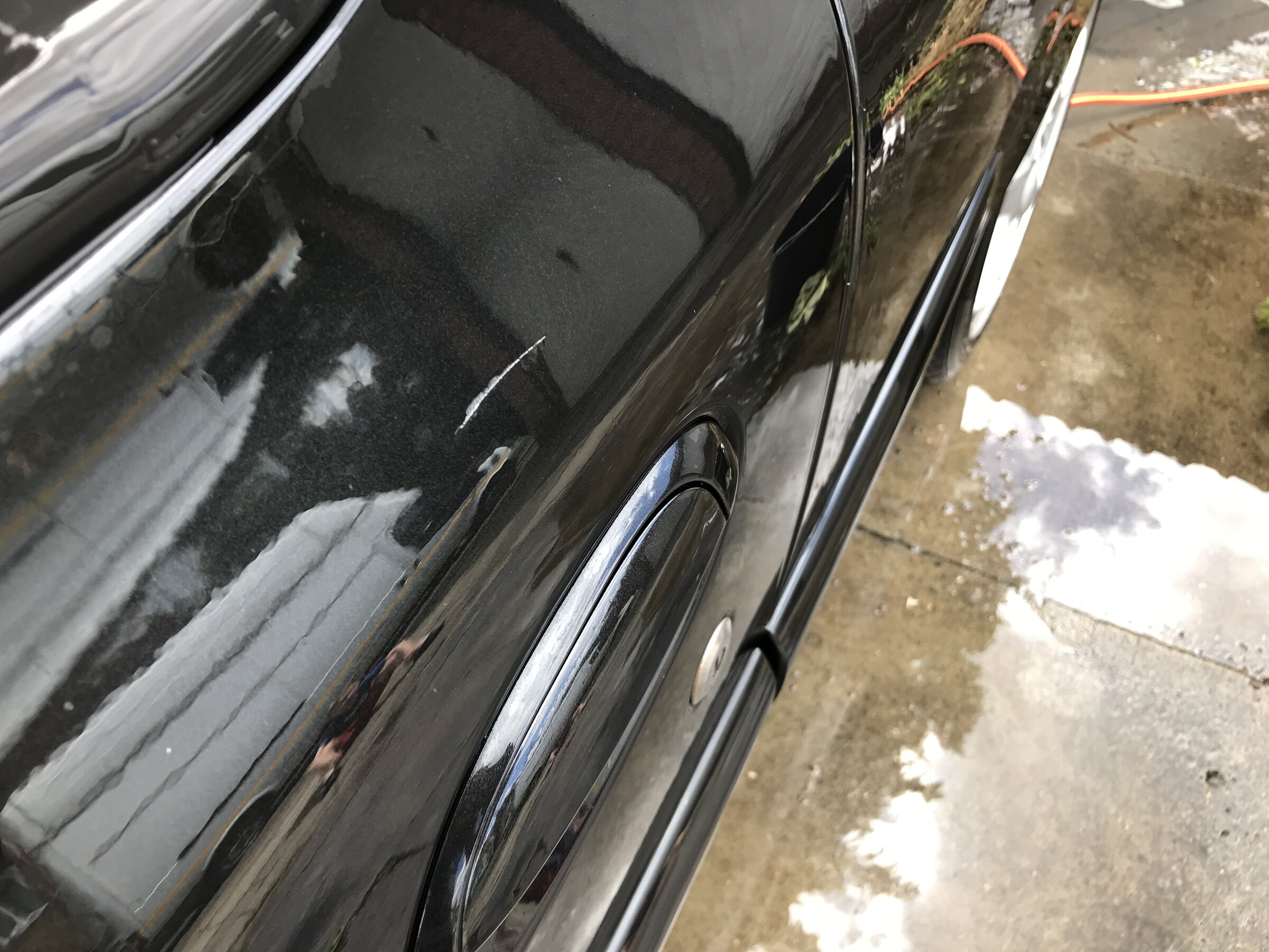

Washed it and also revealed the bad scratch (only one on the body through the paint) that my neighbour kindly done with a bed frame :mad: Proper fuckin gouge!
I’m really gutted about it, worse than I would be if it’d been either of my imprezas.
