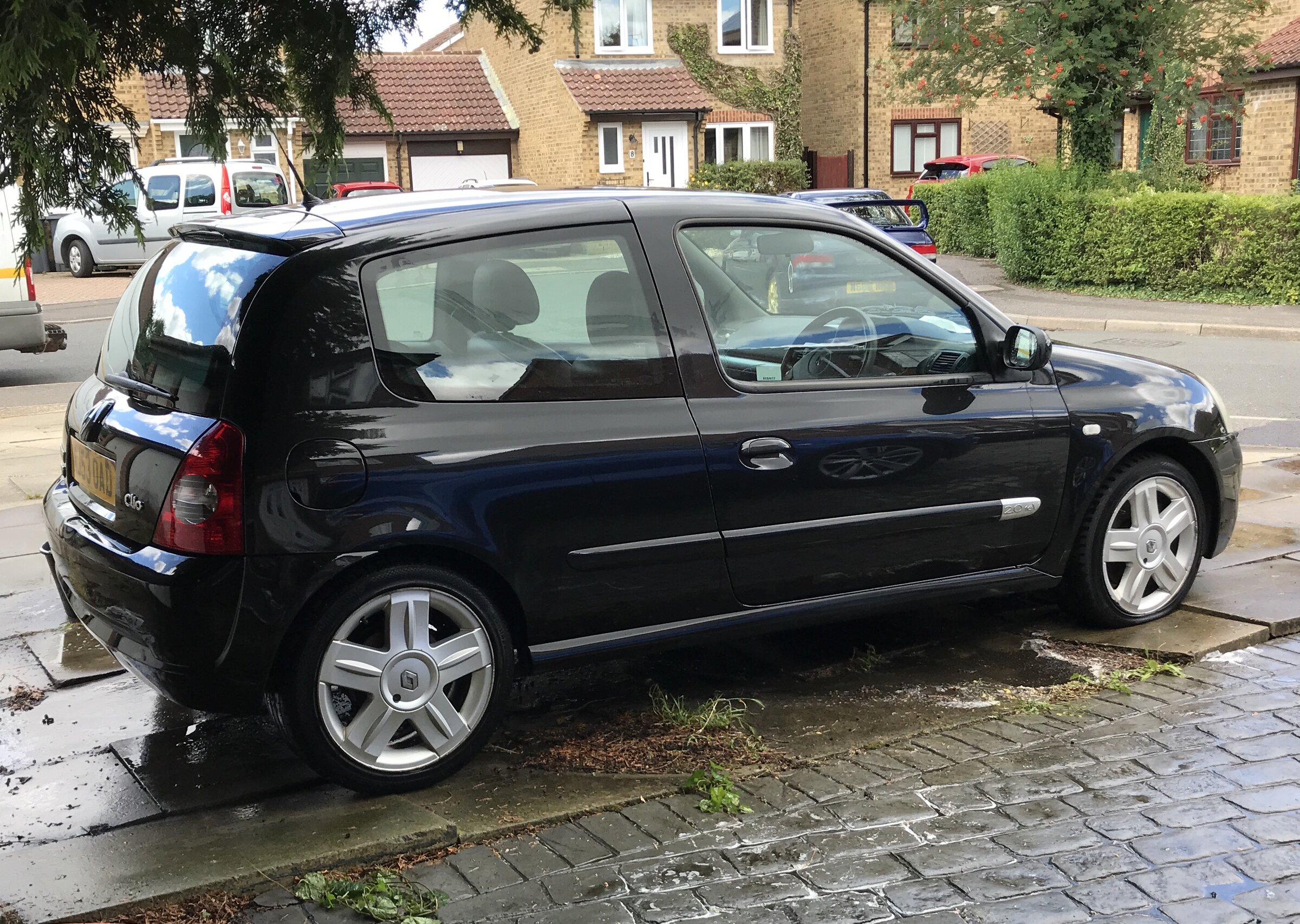

Refitted my refurbed turinis and camber bolts after 'powdercoat gate' and did a by eye alignment followed by a quick taxless drive on my b roads. Looks amazing now.

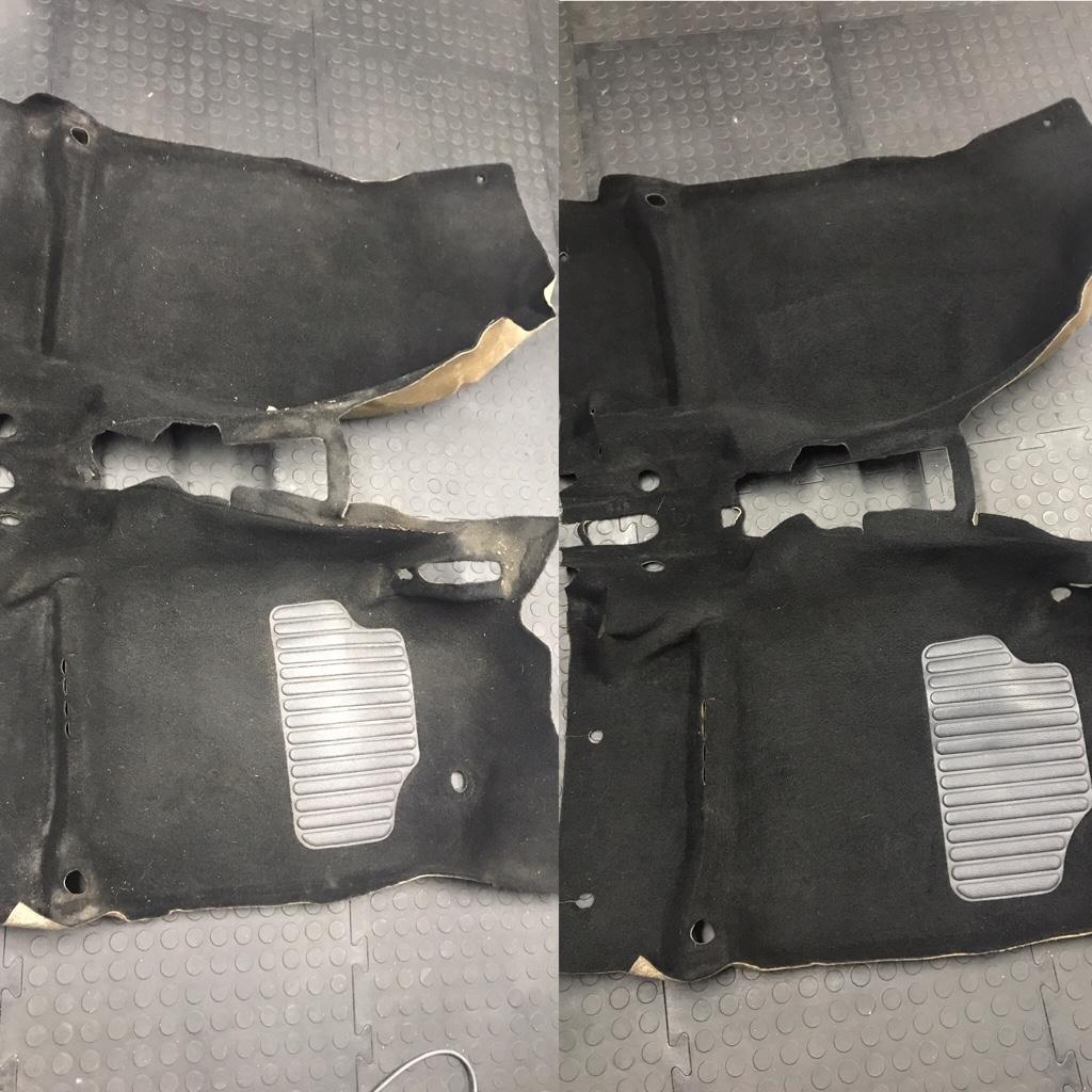

Removed the seats and gave the carpet a much needed clean.

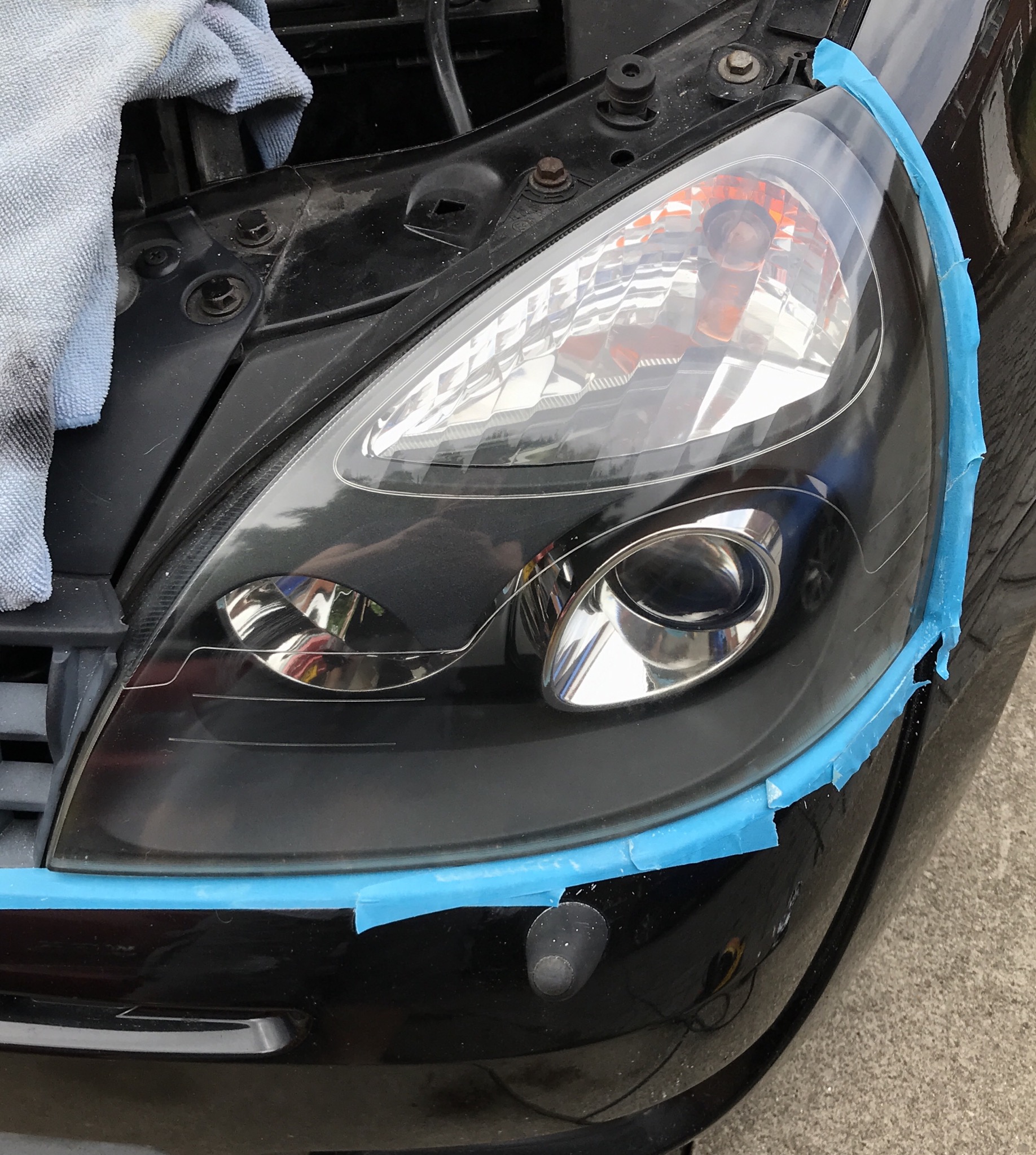

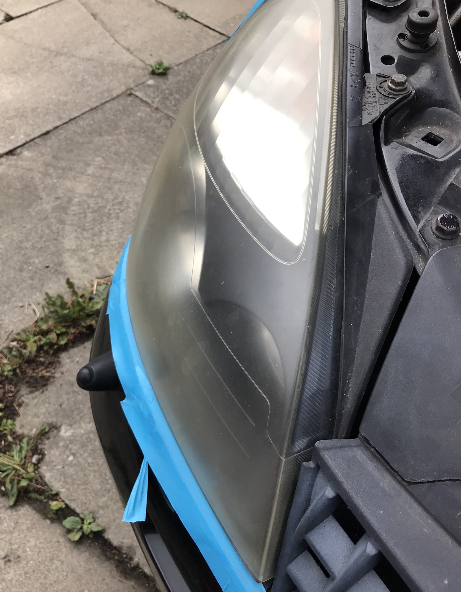

Polished the headlights, fitted door speakers, hoovered it out, fitted new mats, bought four new tyres. In with RS Tuners in Leeds first thing Monday morning for new brakes all round, a full service and re-map. Expecting a different animal back :)

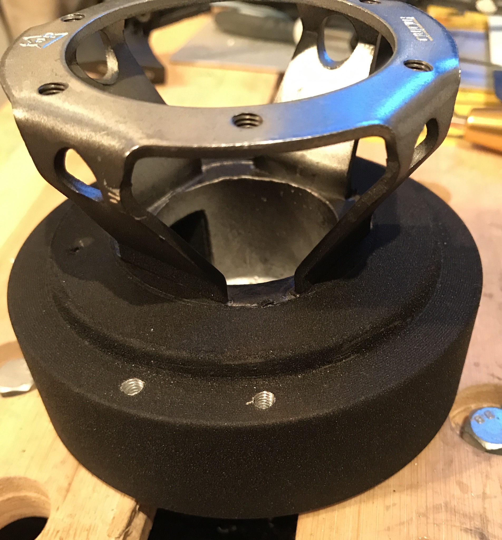

And depending on how much time I’ve got... fitting my new steering wheel boss and my Momo wheel (for the track)

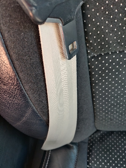

What did you use? I've just picked up a 2004 182 and they are manky!

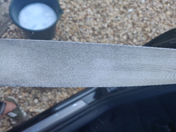

Remove the lower belt fixing bar (T30 torx from memory) pull the belt to it's full extent then use a bulldog clip or similar to stop it retracting. Use a bucket of water with a few scoops of Coop stain remover powder and get as much of the belt in there as you can by putting the bucket up on something. Leave a few hours and rinse, mine came up great and the bucket of water was grim afterwards.

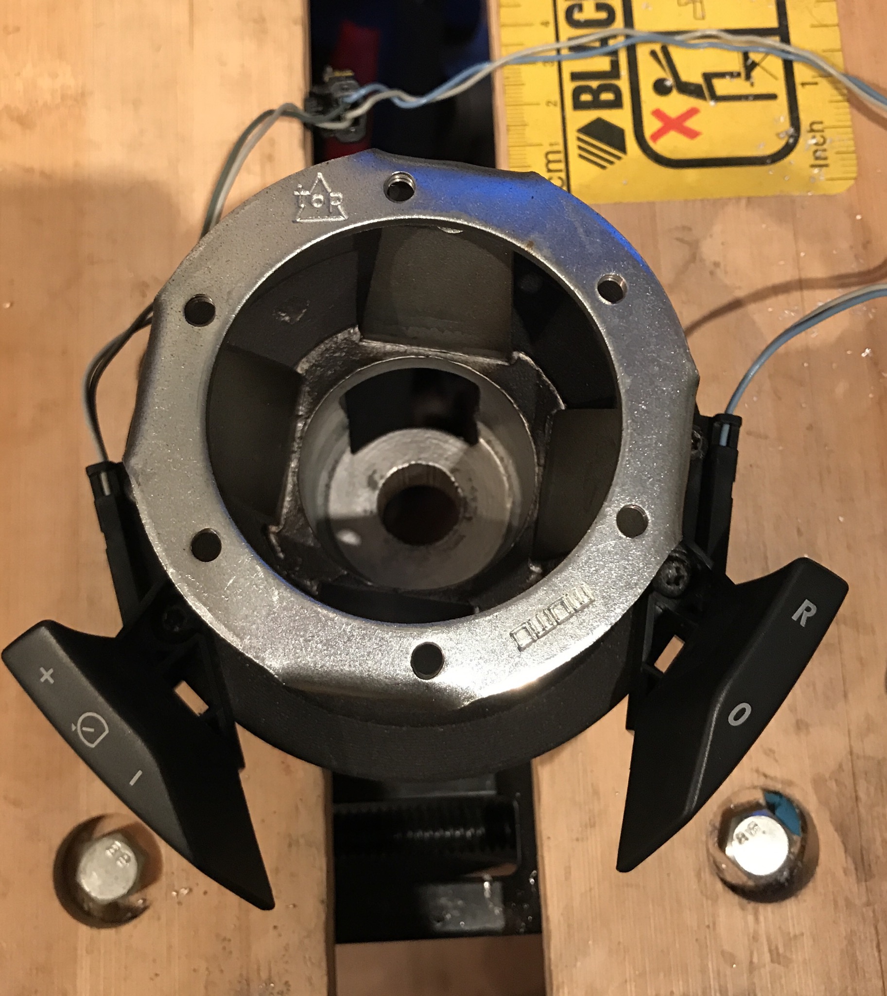

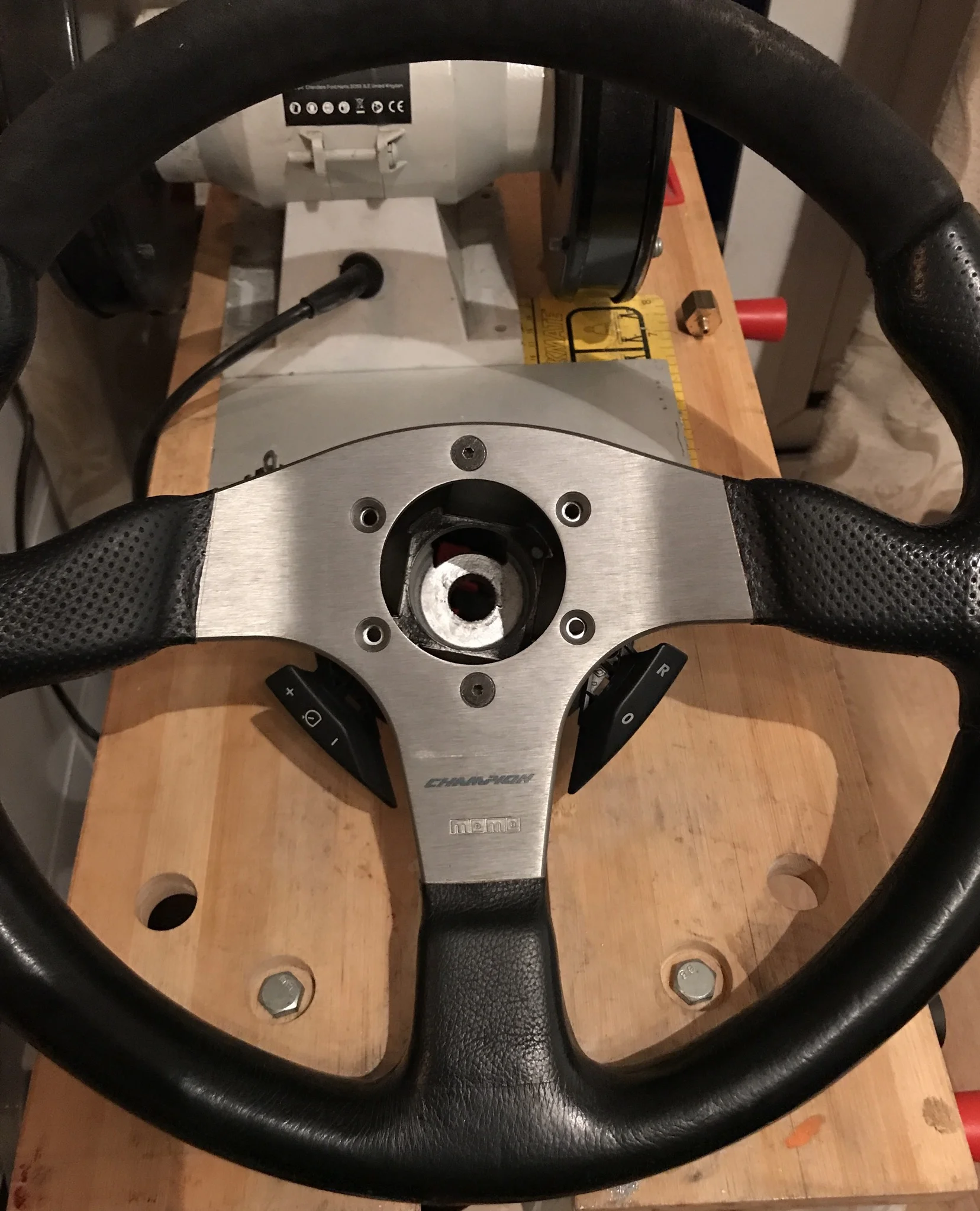

I couldn’t lose the cruise control as it’s my favourite of any car.
Bit of an annoying position compared to standard but being as they’re rocker action you can reach behind with your middle finger and operate them.
Has anyone made a plate up with aftermarket push buttons? Was thinking a sheet of carbon sandwiched between wheel & boss and buttons.
I may even scrap the cancel/reset buttons and have just down on left and up on right as it’s so easy to just use up n down speed to set.

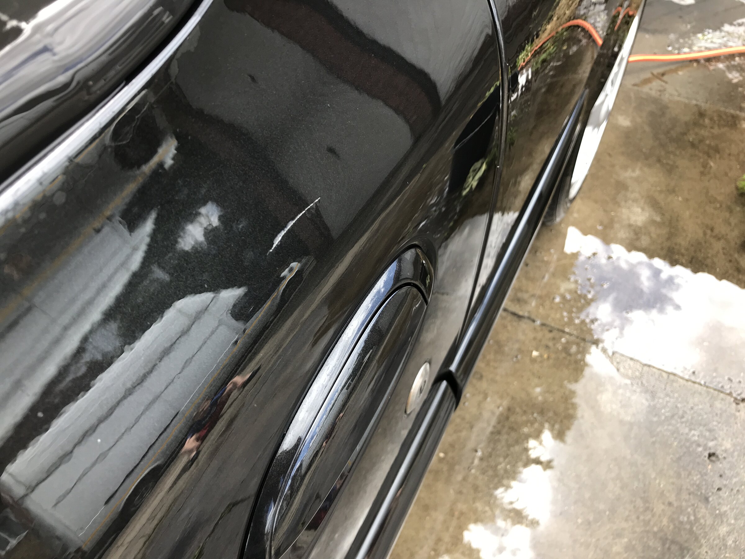

Picked up a cheap new bonnet, unfortunately some peoples idea of mint isn't in line with mine
Unfortunately ‘mint’ nowadays means a different thing thing than it used to. “It’s mint mate” is a statement that usually means avoid as it’s knackered.

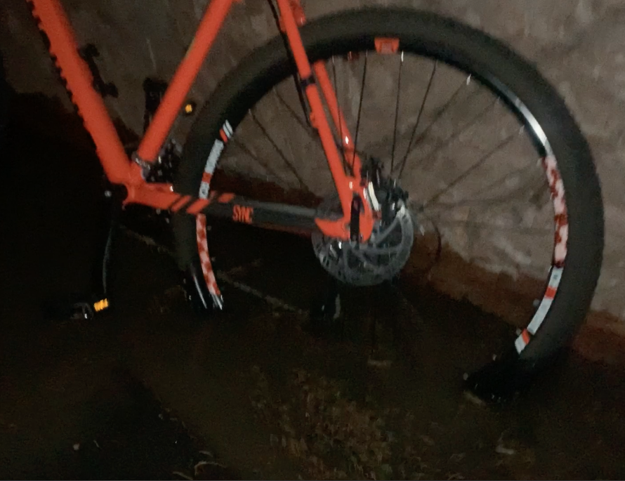

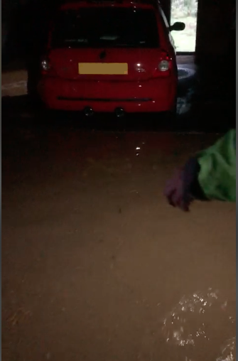

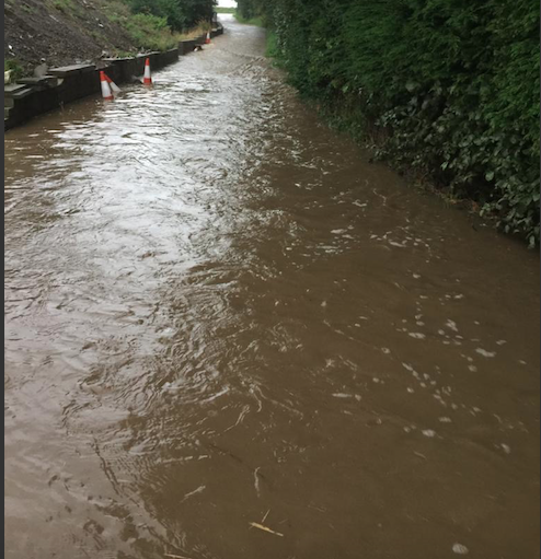

Saved It From The Floods.
First Picture = The Street
Second Picture = My Bike
Third Picture = The Trophy

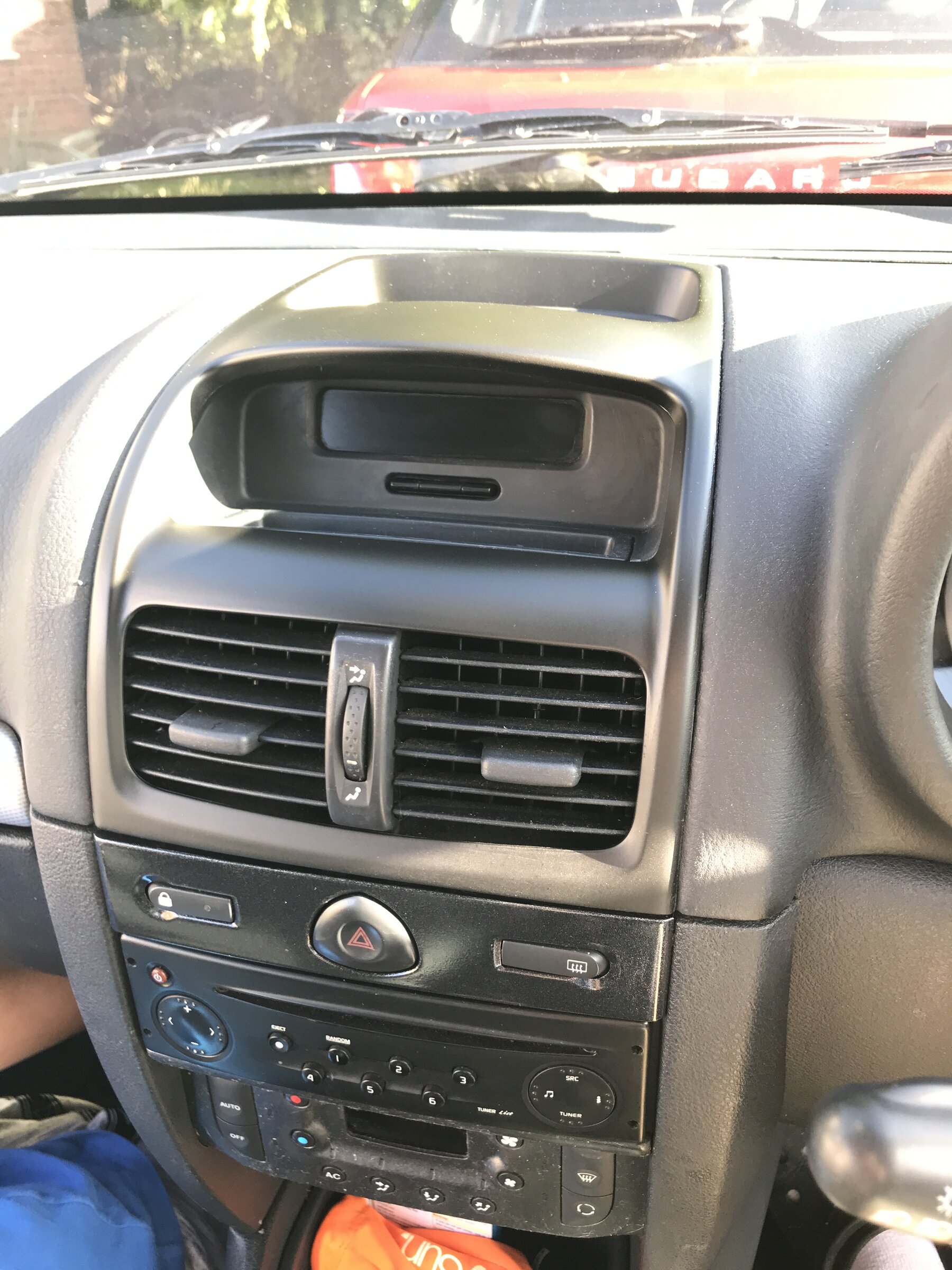

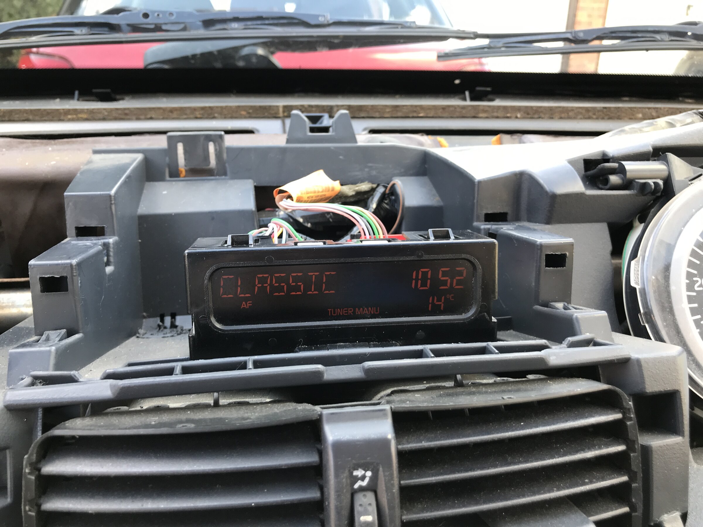

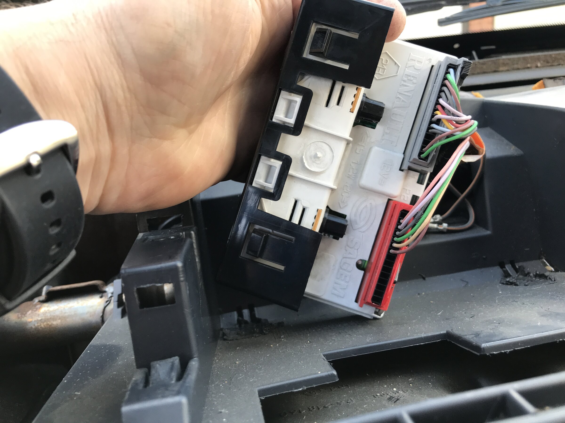

Changed a couple of bulbs which meant
this...
To get to these...
to be able to see this...
which lead on to be removing what was left of the sticky crap on the top surround. Painted it ‘hard hat’ black, came out well (dust is post hardened dust) so just got to do the rest of the nasty stuff now!

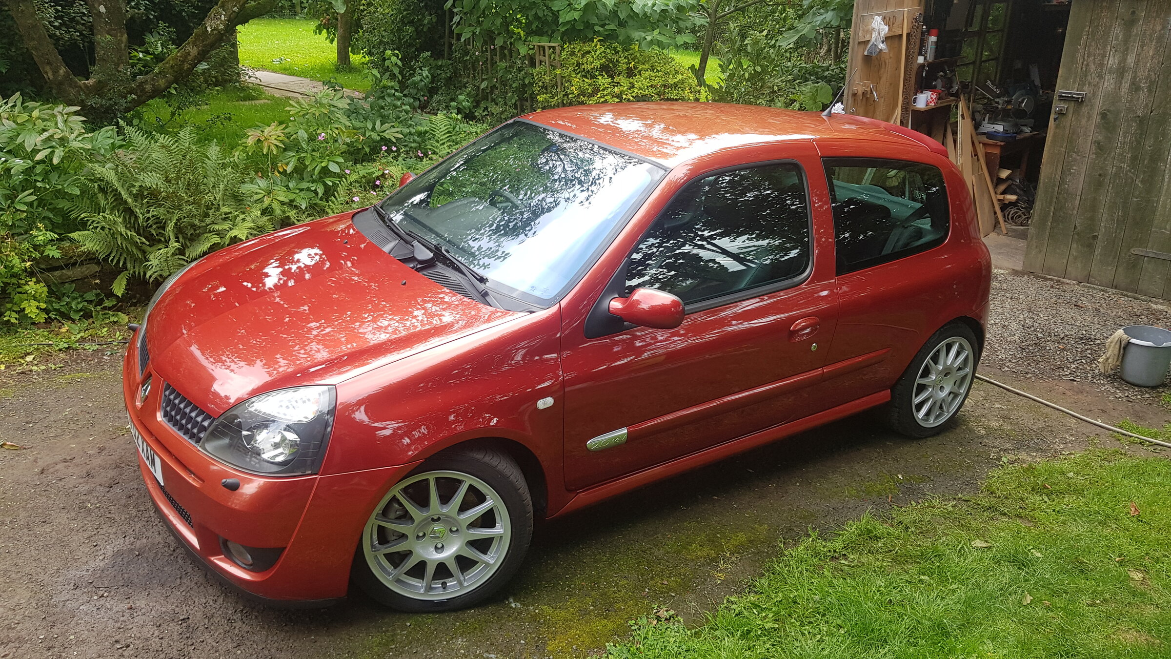

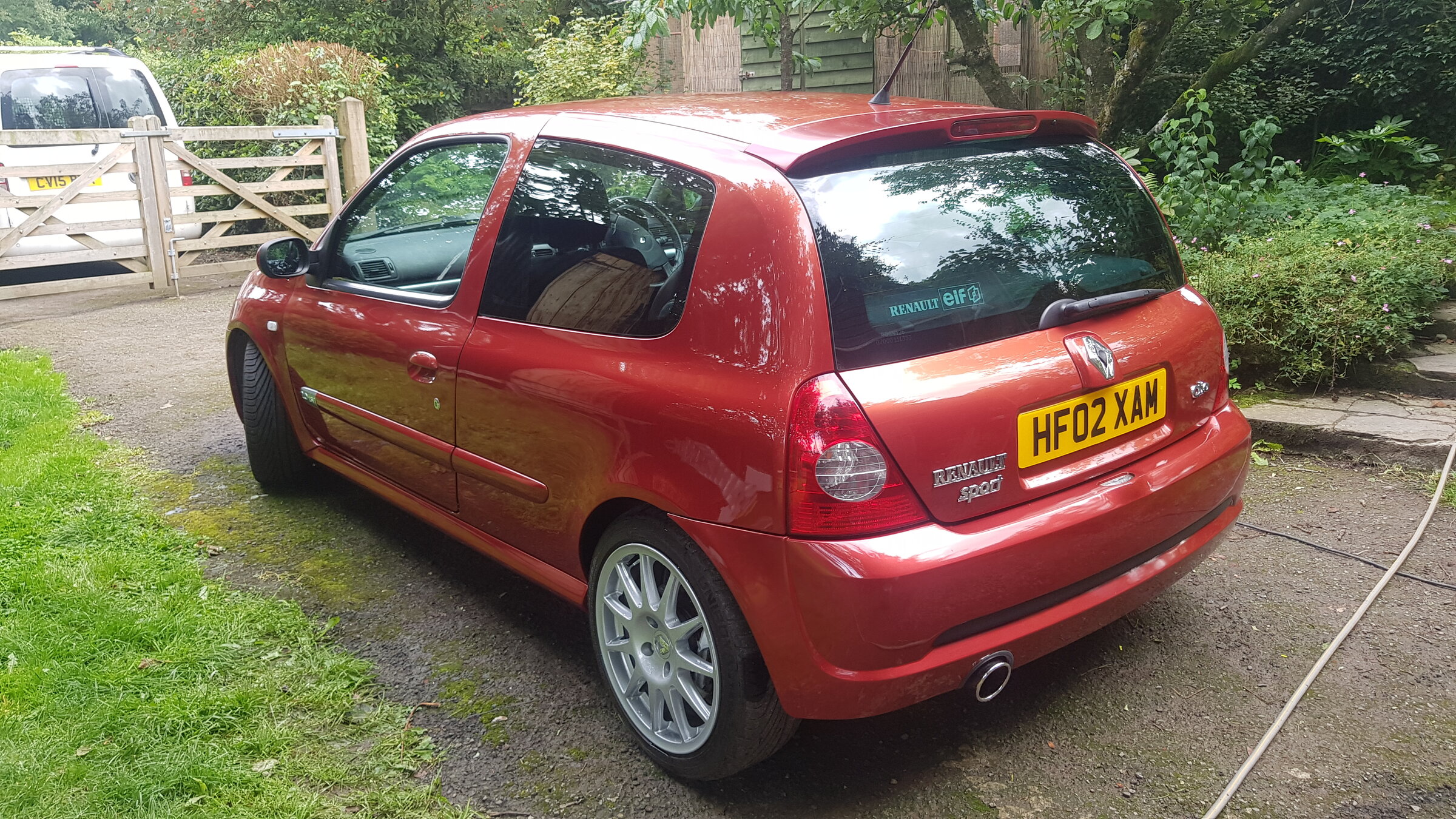

Technically this was yesterday but took this out for the first proper quick blast since it passed the MOT a few weeks ago.
It's been over 2 years since it's been on the road and driving it again makes me realise just how much I've missed it. It's taken a while but I'm so glad I persevered with it.
Came back with such a massive grin on my face!
