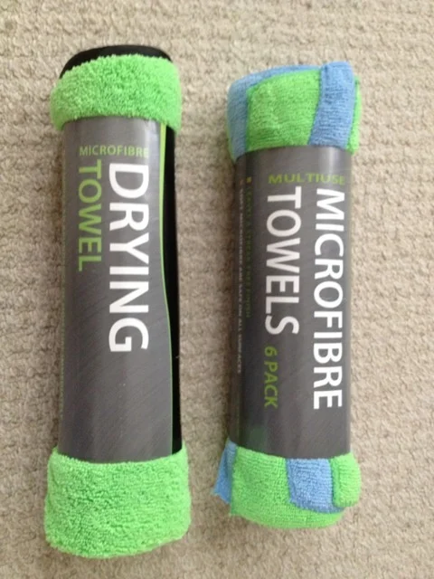

Picked up these from Asda for £5 today, no Kent stuff left. Feel descent and cheap enough.
