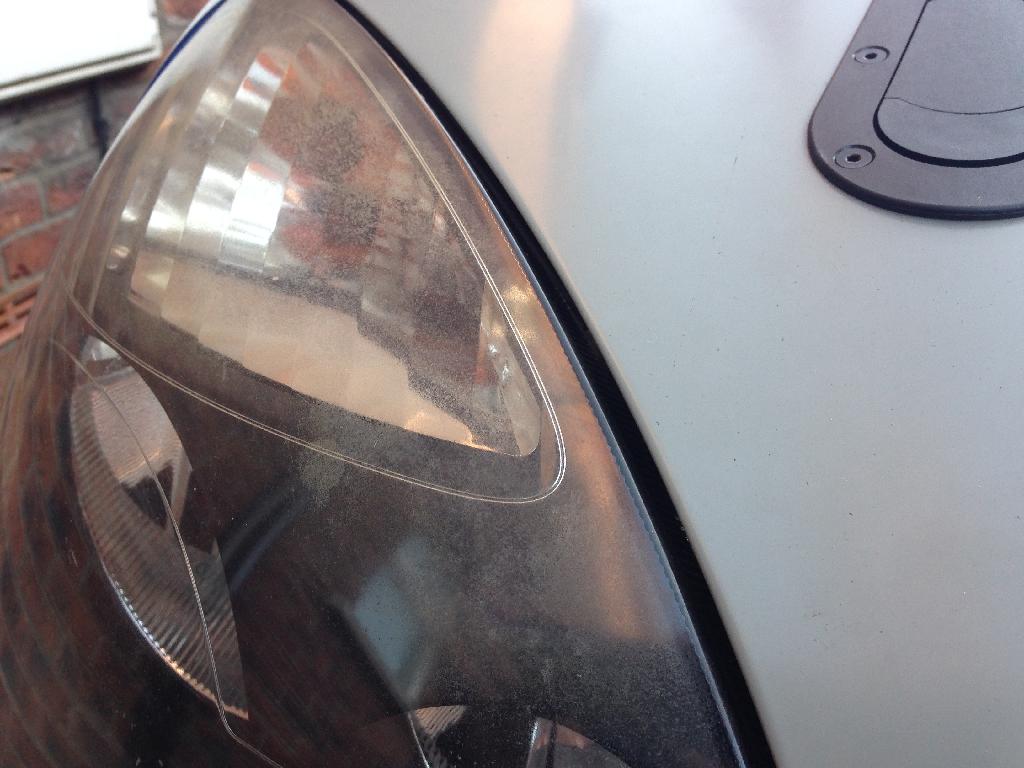

There is a picture there of green residue on my headlights, has anyone any tips as to how to remove that?
Looks great :)

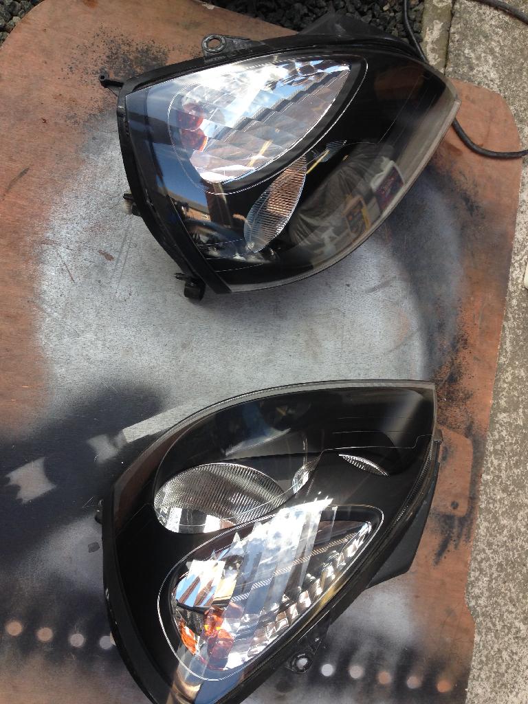

Headlamps are pretty easy, I just did mine today. Give them a rub with wet and dry, I did 1200, then 2000 and 2500, then buffed them up with some menzerna final finish compound.
from this......
to this......
