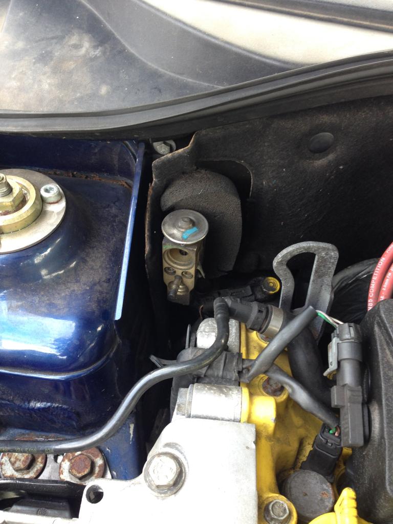

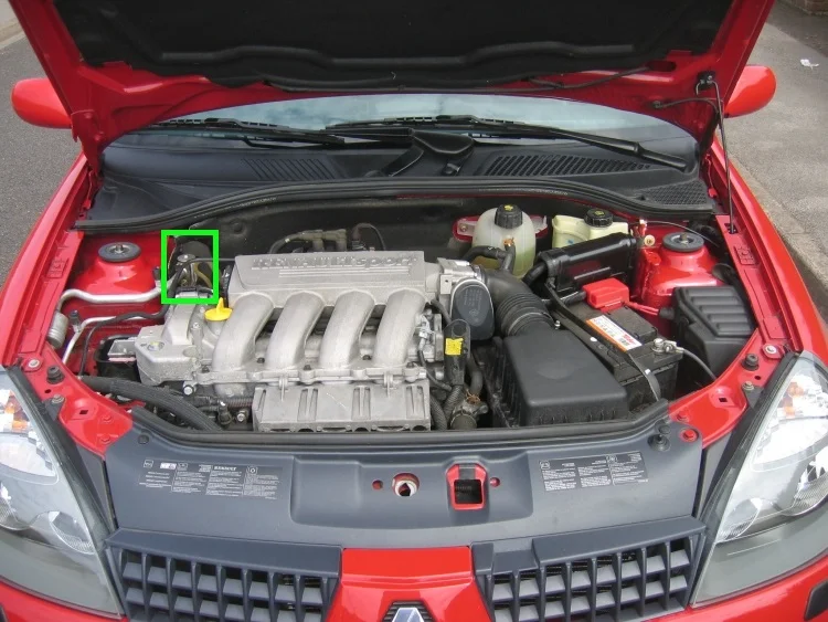

On my recently purchased clio 172 (with climate control aircon) there is a metal rectangular bracket on the firewall with nothing going into it.

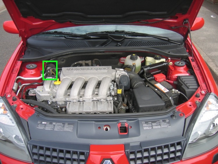

Its what I've highlighted in this picture.....
I'm guessing its something to do with the aircon? Mine also doesn't have a metal pipe coming from it.
Could somebody confirm what this is for.
Thanks!

I removed mine (bcoz racecar - ;)). You need to swap to a cup alternator / aux belt setup when you remove it, so unfortunately it's not as straight forward to put back as you may think. Can be done, but will need to source the parts including a non cup alternator and brackets etc.
I've got all the bits if you decide to refit. Would be best to get a picture down the front of the engine to see what's been removed. There are other ways to remove to air con that don't use the cup setup
This.
They could have simply removed the pipes, I don't know why anyone would, but I've seen a couple with aircon pipes removed, but still with the A/C pump, all brackets and A/C rad intact so it could be a simple fix.

Then theres the pms aircon delete... And even the simple larger idler shorter belt trick
Unless I'm going blind, the rest of the AC pipework's still there? Fiver says the condenser's still sat in front of the radiator reducing airflow too.

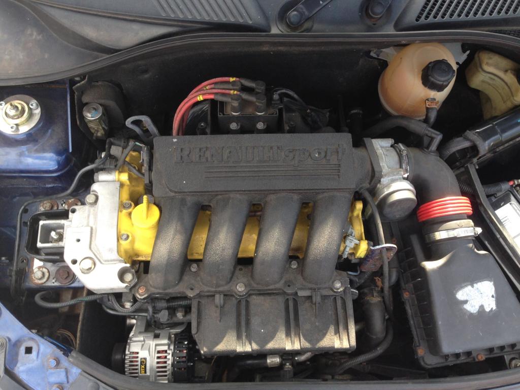

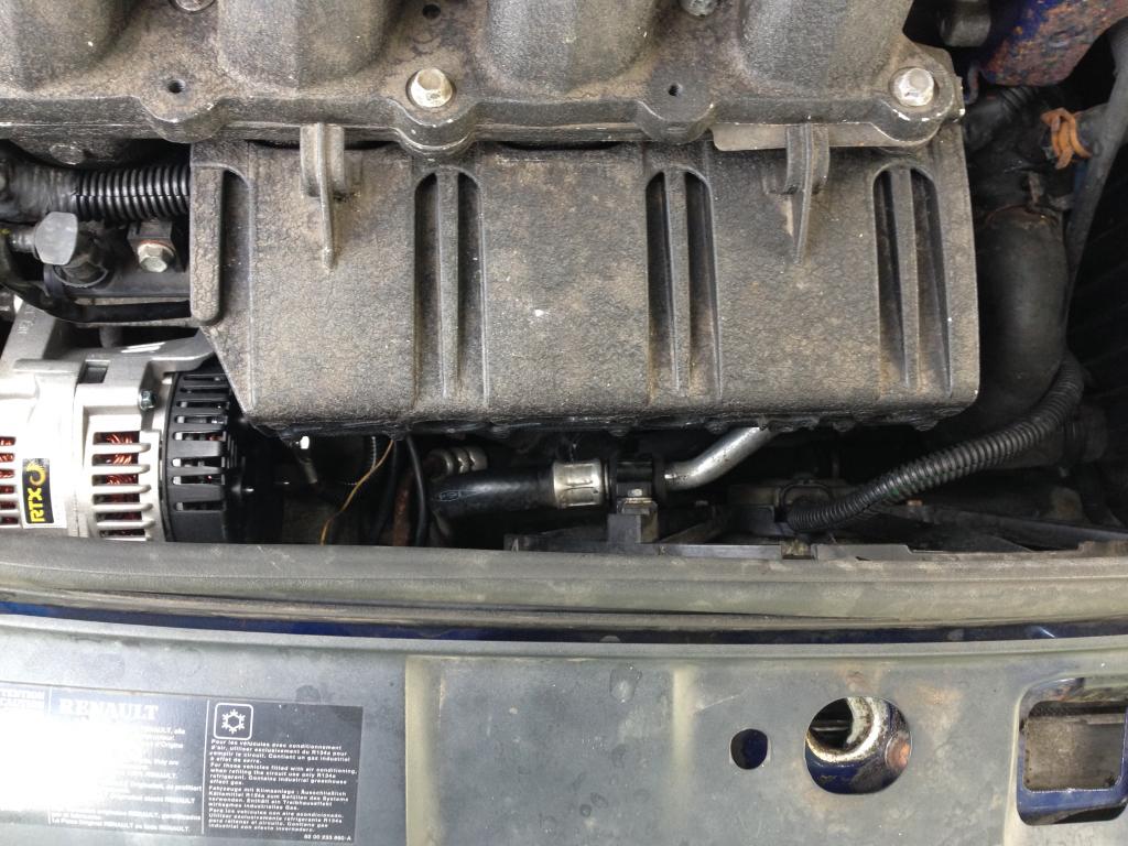

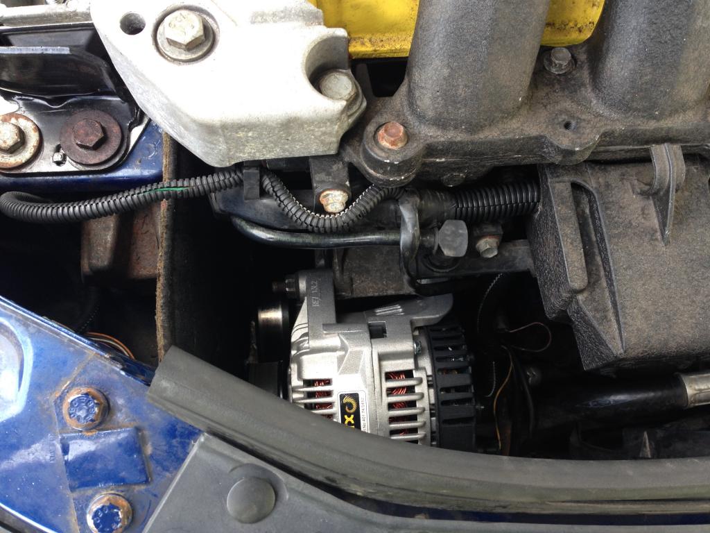

So here are the pictures taken from my car.
I don't think there is much left behind of the aircon but then I'm no expert!
Nope no air con just a dodgey rtx ecp alternator! ... hope u got the original invoice for that bad boy
That came with the car and has already given me problems. Sometimes it like to produce electricity, sometimes it does not :D
