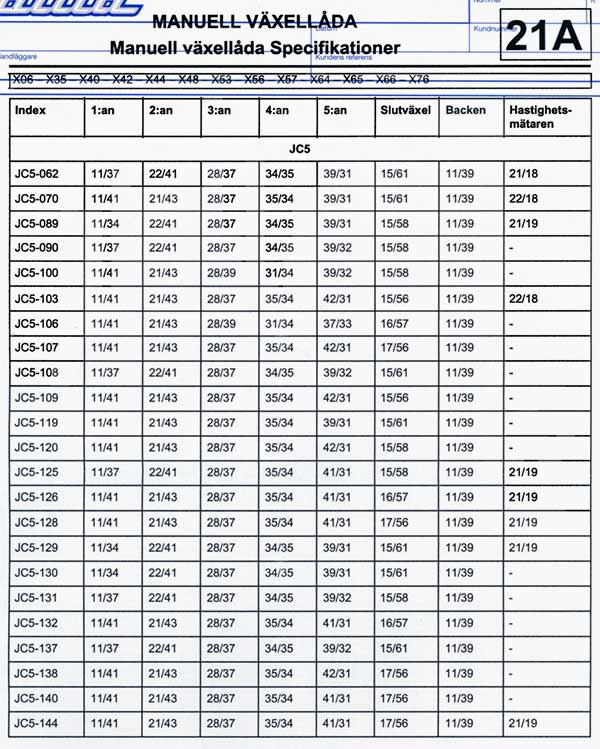

ha ha i like yes standard gears is 64 in 2nd and 87 in third on the mark 2 172

hi have u got any info on the gearing i got a autocar from 2003 giving the 172 gear speeds but nothing else
089 is Ph1 172
129 is Ph2 172 Cup
130 is Ph2 172/182 'normal'
IIRC.
As I said before, there is no point checking if you have the map by checking your speed in gear, because you dont know which gearbox and gearing you have for sure.
Especially when there's easier methods such as idle rpm, rev limiter, and other things.
