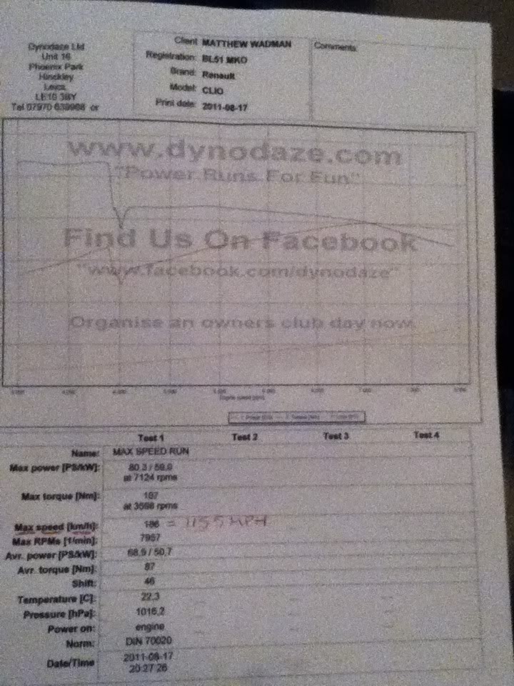

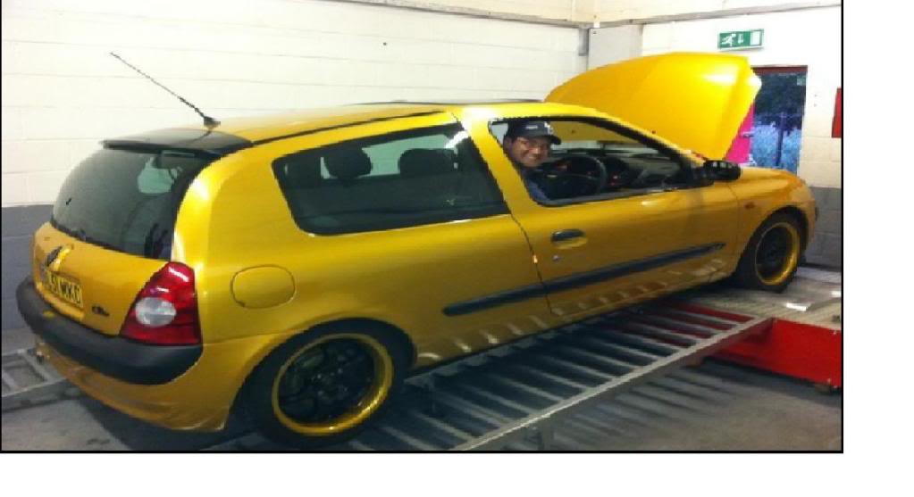

ANYWAY last night I whent up to dynodaze to do a before and after readout for when the conversion is complete these are my results.
Decat and home made cold air feed.
(80.3 bhp) (107nm tourque) not bad i didnt think.
A clio sport 182 whent on the same night he ran 174bhp with air filter..
