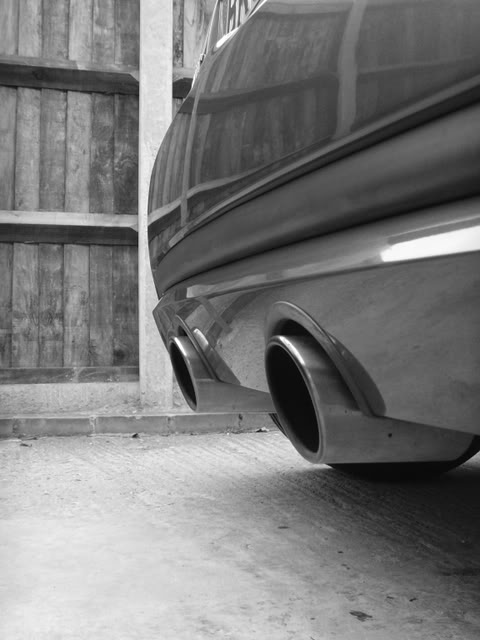

Here we go, I think it sleeves Nicely under the Clamp but not been under there to look properly, Guy said refitting Std Cat would be easy so I'm happy :D
Sits better at the back compared to how it used to though :D

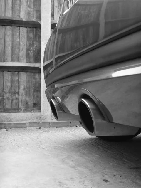

Old
