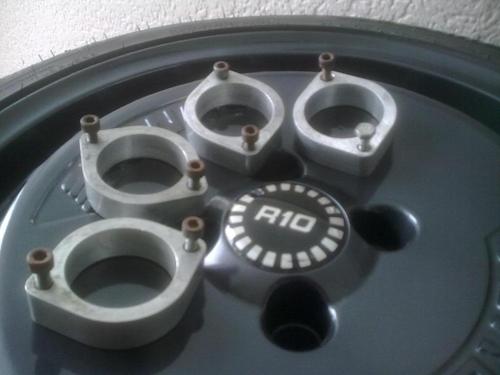

How much do these spacers cost roughly? Don't look as nice as bigger trumpets though..

Bit dearer than the trumpets, unless you are putting them before the bodies (which it sounds like you cant) then I would just go trumpets instead personally.

These are the spacers I have fitted justnow.
They fit inline with the trumpets. I originally bought them to fit behind a flat backing plate to give fuel rail clearance but then bought a deep backing plate so fitted them inside.

Mine would have to go inside the backing plate too.
How much did they cost?

I bought them second hand off of eBay for £50 I think, I got 60mm trumpets with my bodies so fitted these aswell giving me around 85mm but going to 120mm now.
