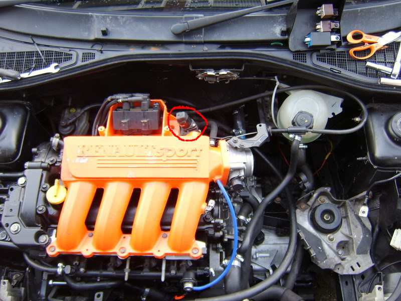

Hi guys I've got a problem with my 2000 Clio 172 phase 1 cutting out at junctions and I believe thus is cause by a dirty or faulty idle control valve. I want to take a look at mine to see what condition it's in but I've no idea what or where I'm looking for. Does anybody have any pics of this in the engine bay?
Also if anybody wanted to let me know the best way or removing/refitting said icv that would be great also

its at the back of the inlet manifold next to the throttle body. it will have a pipe going into it. iirc its 2 10mm bolts that hold it on.
edit here is a pic it the thing circled in red
