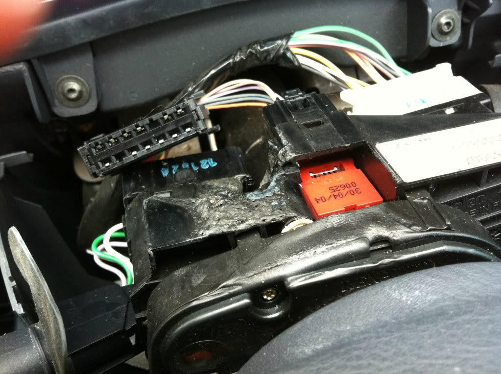

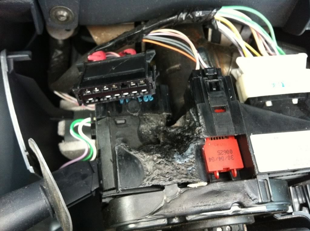

As i started reversing, some penis i work with just stood there so i went to beep the horn & to my suprise no beep came out, i pressed it again & the car alarm went off, lights started flashing & a pile of smoke just came out from inside my steering wheel, followed by a nice orange glow.

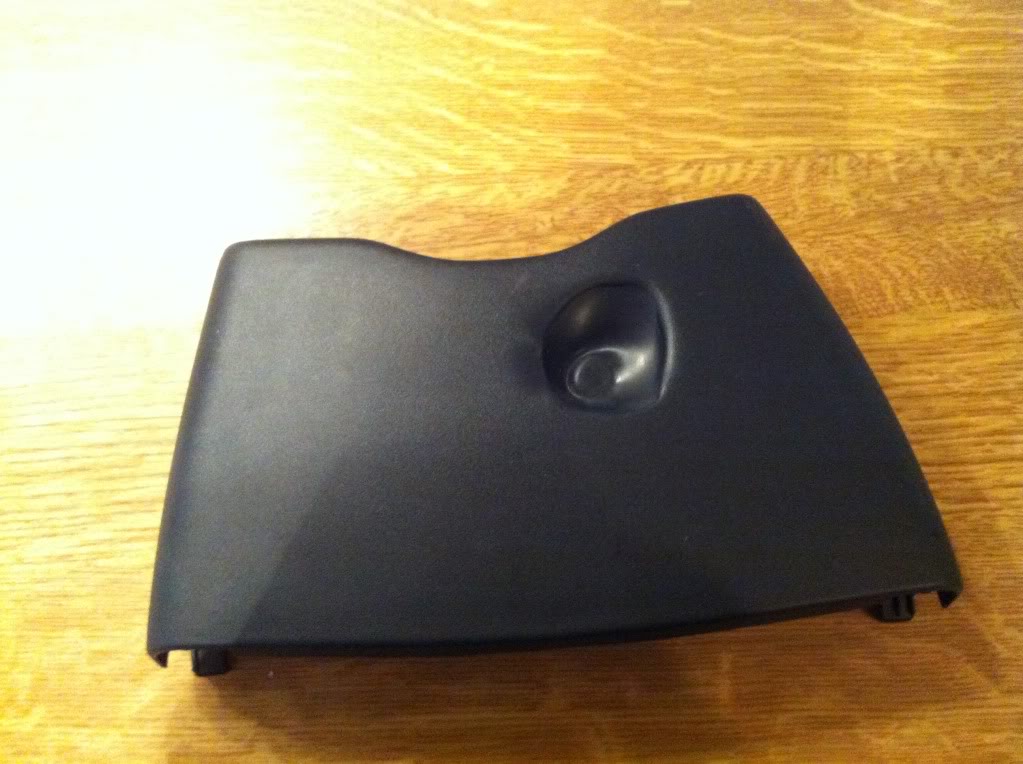

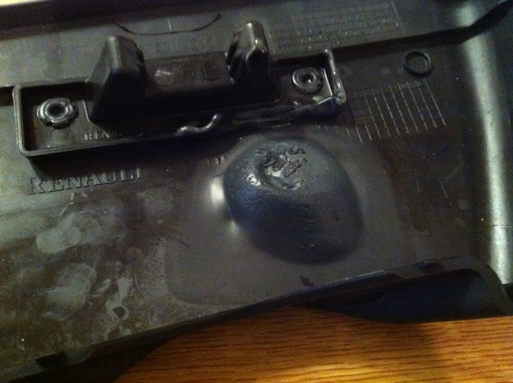

Straight off i grabbed the fire extinguisher & doused the flame then dissconected the battery, now as you can see i have a lovely melted piece of plastic & burnt rotary arm! Renault reckon it's going to cost me £280 including VAT & labour...

it is the horn wiring or contacts that melt.... When I removed the after market steering wheel the pervious owner fitted to mine...
The two contacts for the horn in the squib were burnt and touching hence when I took my wheel off the horn just stayed on... And the wiper arm where the live and earth go to the wires were melted
I changed the squib and it has sorted the problem...
But if your steering wheel angle sensor is damage that is not just a plug and play it it will need programming to the car
