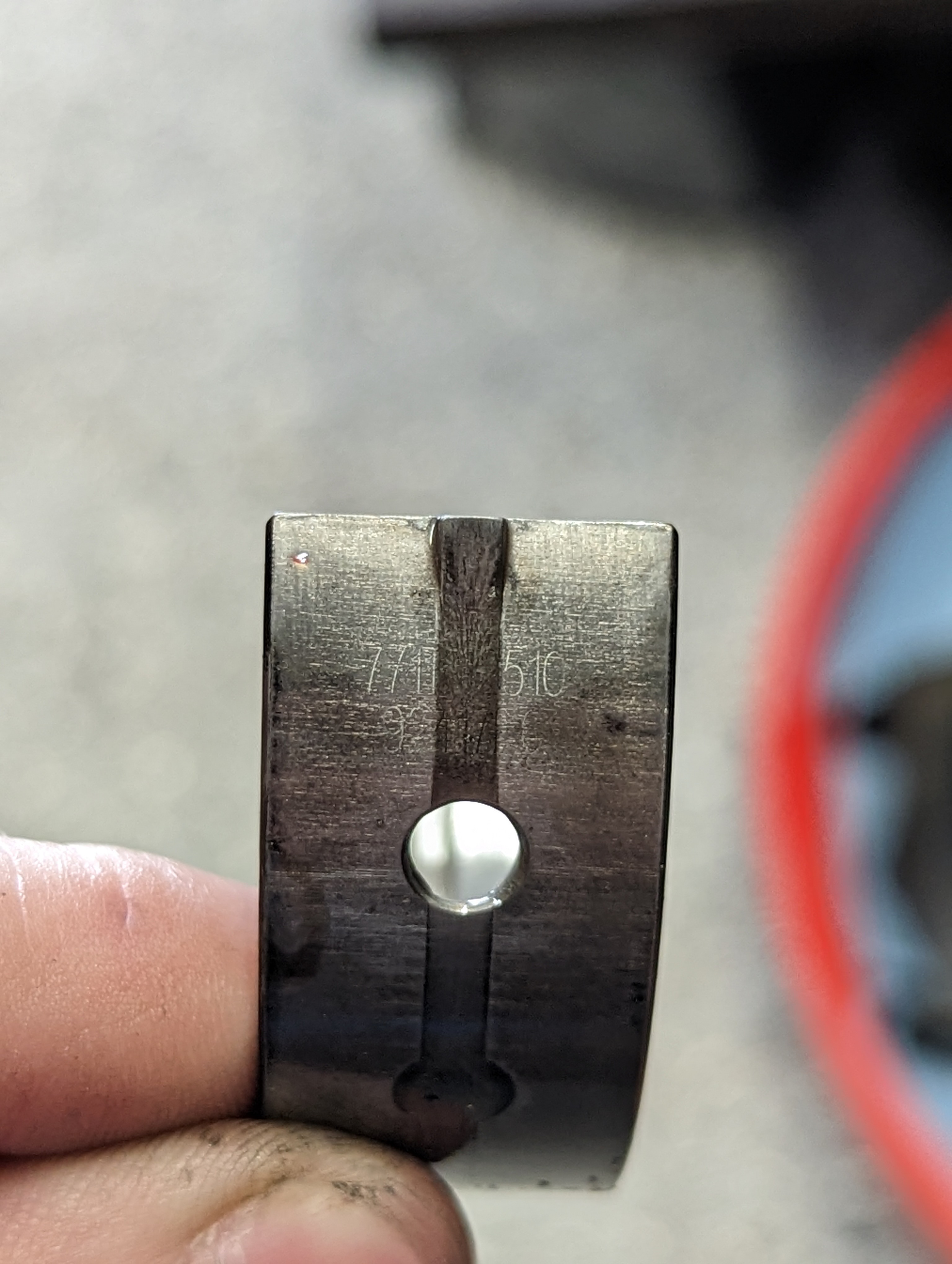

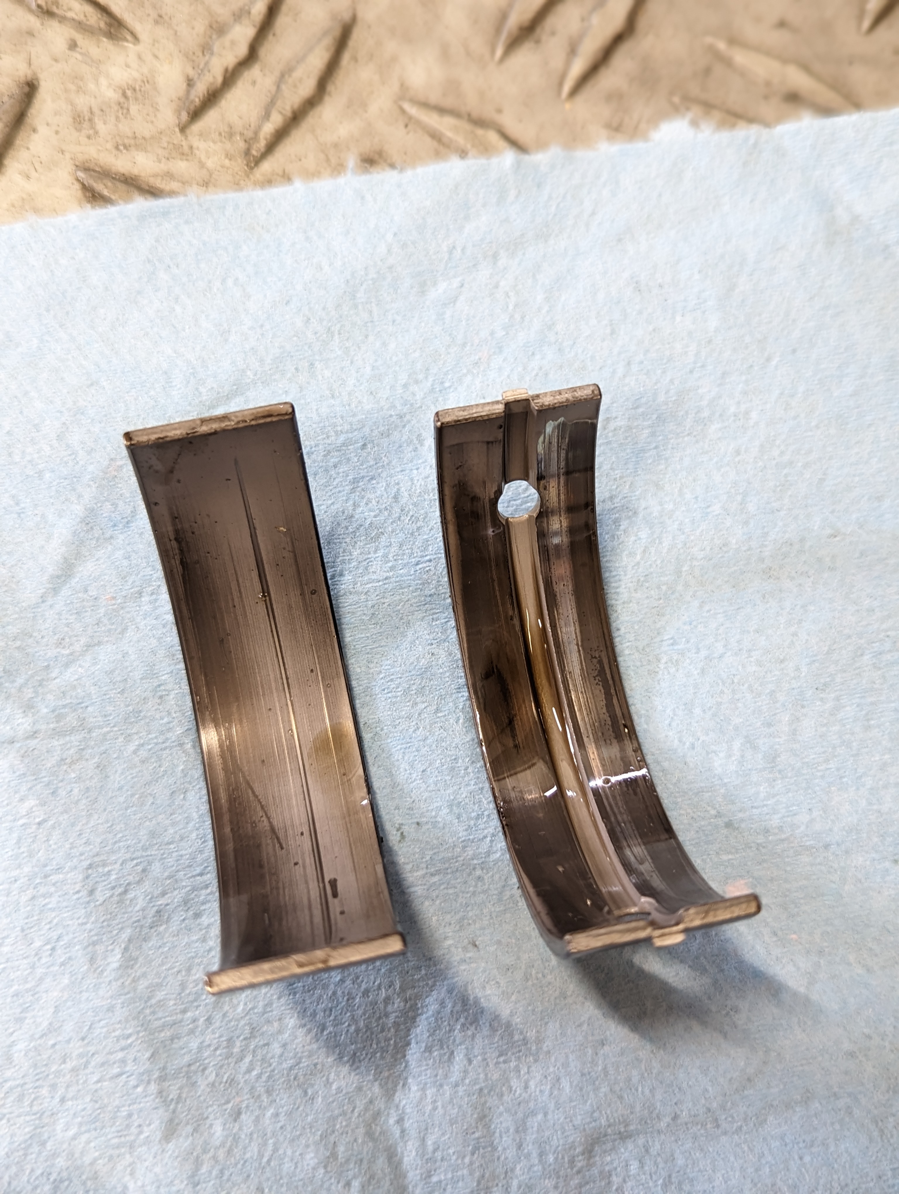

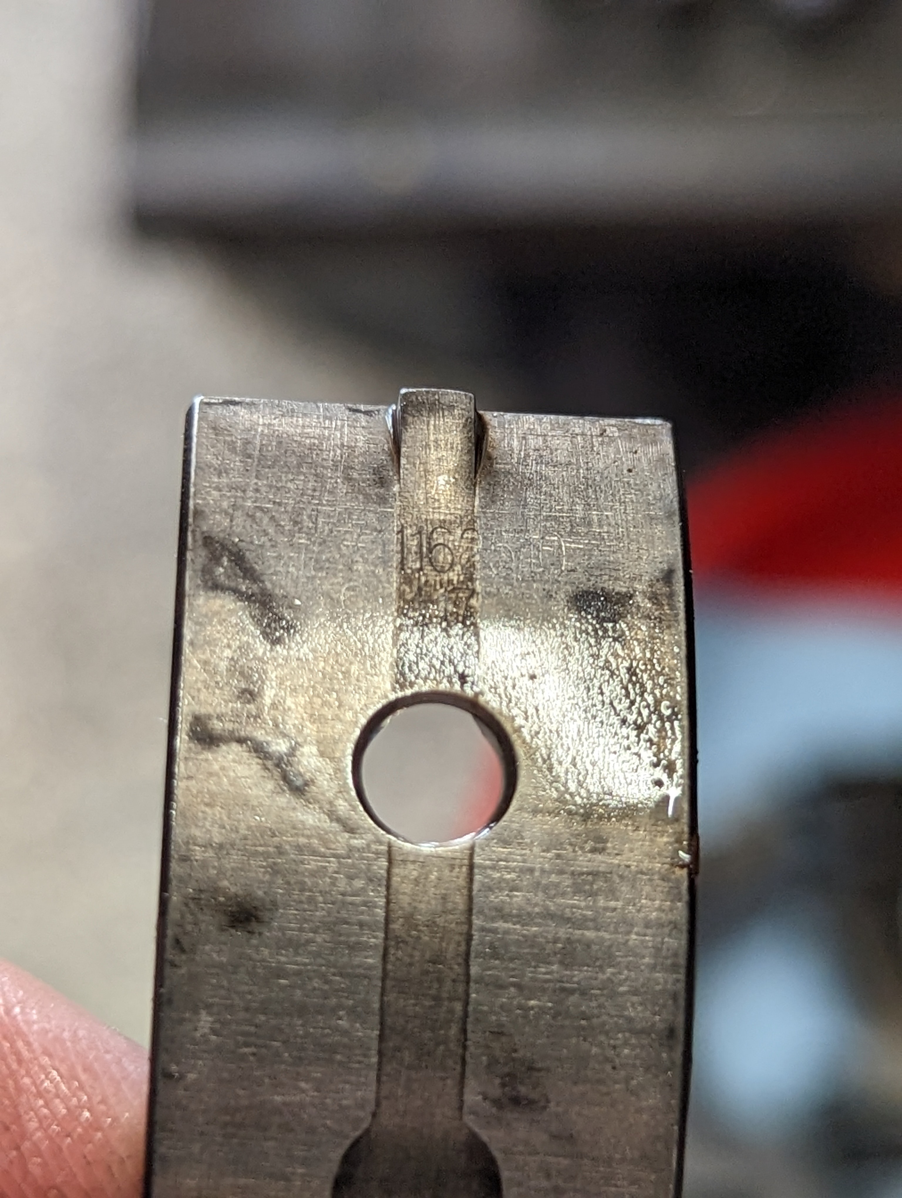

Does anyone know where to find main bearings for a F4A engine? I ordered the F4R bearings from ACL and didn't realize there was a difference until they arrived. Here's a photo of the F4A bearings. Notice the notch is in the center on both ends. I made out the part number to be 7711162510 which didn't help much on Google. Any help will be appreciated as I need to get this engine assembled ASAP!

Notches can be milled/ground off. The bearings are designed for the K series engines which have gaps in the crank to suit the tabs. However when I did this on mine I dont think I did it right as engine failed after 30 mins of running. So buy genuine which dont have the tabs.

I think he needs them with the tangs.
For the F4A in the Praga R1.

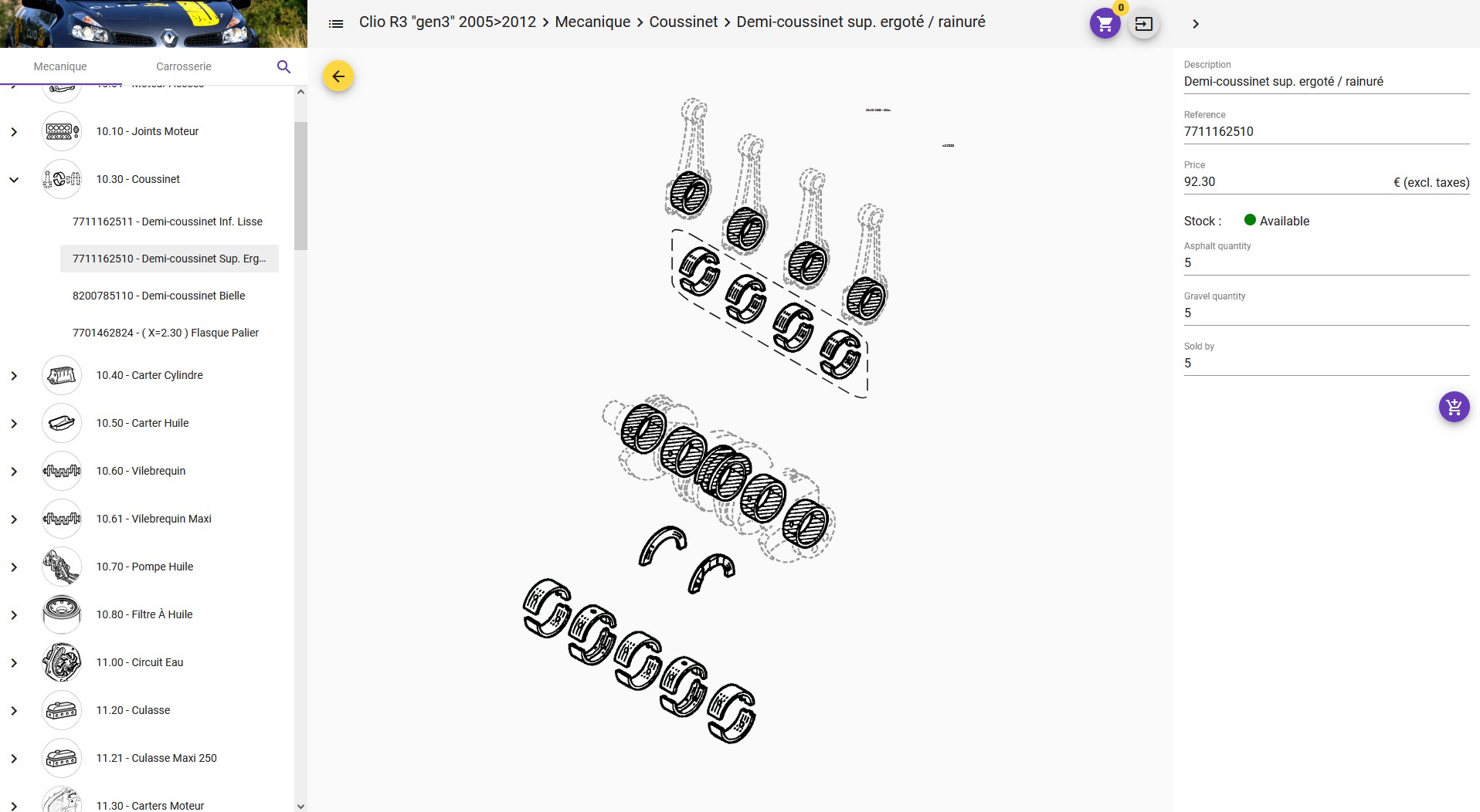

There's a list of parts here, but it doesn't show engine internals. Maybe try contacting Praga?
That part number also shows up for the Clio R3 spec engine.

I don't like removing the tabs because its so easy to warp the end of the shell so you lose all your clearance at the very end (where you typically don't measure) then the bearing spins in short order.
Had to do it on one engine but notched the bearing cap instead, not sure if thats an option here.
