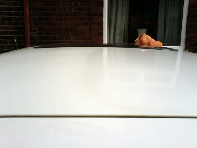

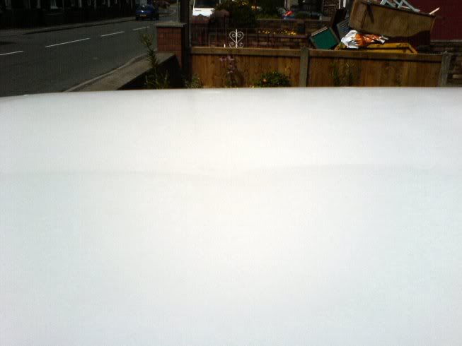

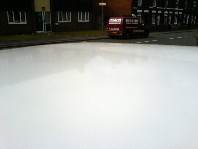

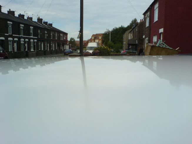

it did for me, the roof of my mums G reg Nissan Sunny was heavily faded, i used SSR2 and it worked well but i needed more cut so i cracked out the 3
hopefully you can see the line on these poor pics of where i have done and havent
All finished, SSR3 / SSR2 / AG SRP.........i could have spent more time on it and got it looking mint but the improvement i made was massive, even my mum noticed it, and rain stopped play :(
