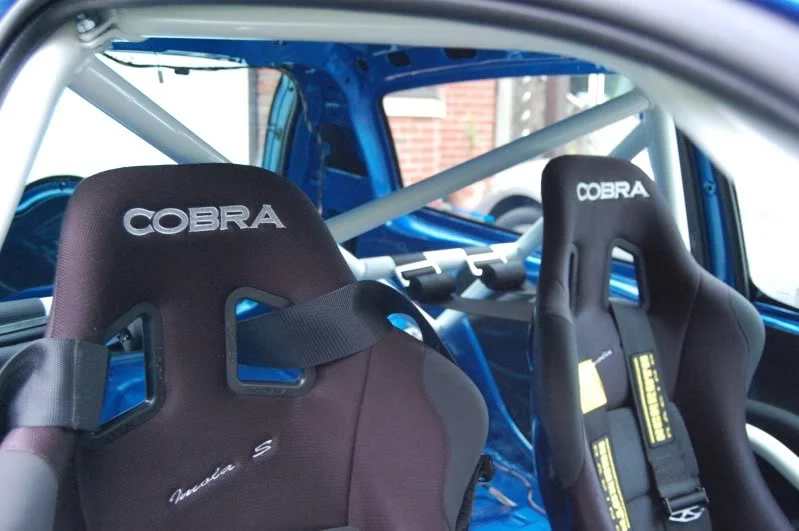

So your harnesses have these?
If so, just undo your harnesses so that they don't loop around them, and loop them around the cage instead (if that makes sense). This is how I did mine:
You can shorten the harnesses no problem and just roll them up (see pic above). Alternatively you could always cut them as long as you burnt hte ends so they don't fray
cheers mate, just had a look over my existing harnesses and did think the catch was stiched to the end of the belts, i now see they can be removed, thanks buddy.
for the angle is it not to exceed 20 degrees from horizontal and 500mm back from the seat, if exeeded i have to cross them?
cheers mate, yeah thats the infro from scroath ive been looking at, so ideally i need this harness bar buyign to be onthe safe side, otherwise the seats could collapse as ther not ment to take such strain from them angles.

to bring an old post up im saving your life. NEVER attach your harnesses to a strut brace as any accident you might have the strut brace will be ripped free as its not designed for that. always fix to cage or harness bar. oem seatbuckle holes will work with eye lets but harnesses will be at incorrect load angles
Okay, well i have a k-tec half cage so knowwhere to mount on there, if i was to weld in brace with plates wud that be okay, ill upload a pic to help explain...
Mk1%20Clio
Your pictures aren't working, but ffs don't mount harnesses to anything other than a proper cage.
Mounting them to a strut brace is just suicidal.
