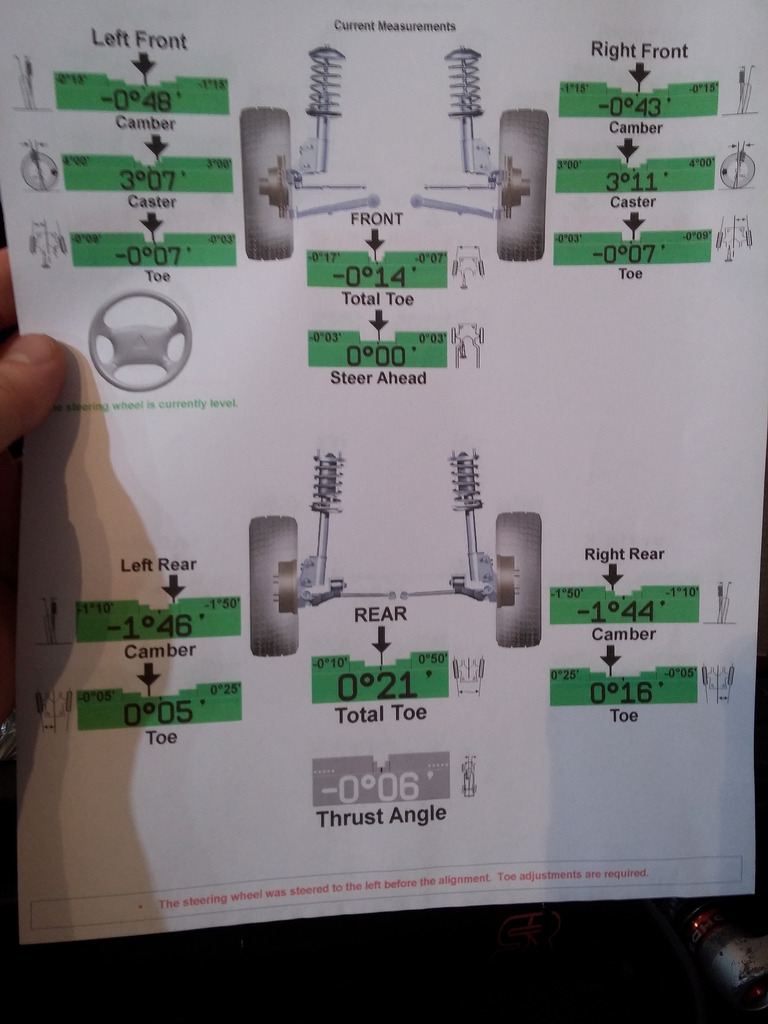

Had it on the hunter a few months back and this was the result
20141207_161246 by dann2707, on Flickr
nice and close, i've had them with 2 deg of difference!! would be worth sorting the toe out though if you're going to space it. pms do loads of shims for that.
