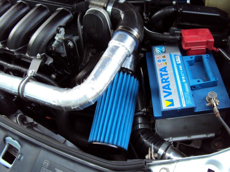

This filter is Jetex ER-7002, which would be a suitable alternative for your RS2 if you didnt want the PiperX. 70mm rubber neck, 100mm width, 202mm total length. £51 from Jetex Website.
Cracking - cheers Laine!
Funny - ive seen this picture in your project thread but didnt think to search for what filter you used. Looks like it will fit by the battery/headlight in my application.
