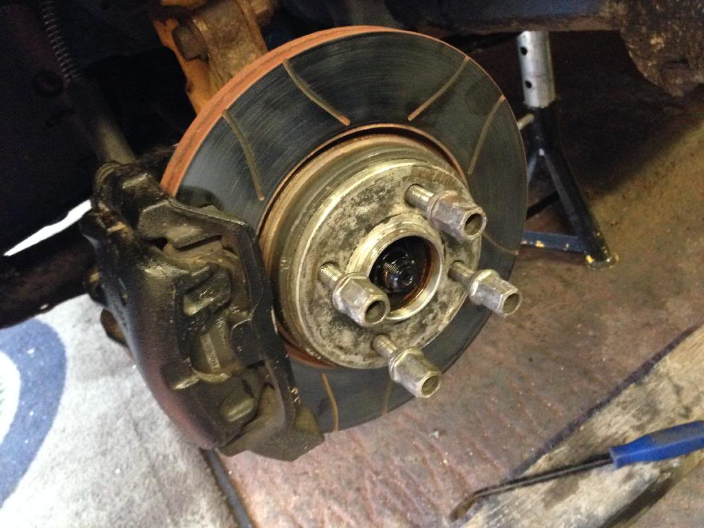

Last night i tried my track wheels with semis fitted only for them to catch on the rear shock and on the adjuster rings on the front.... Nightmare. I had some 10mm spacers knocking about but they need the hub spigots ground down.

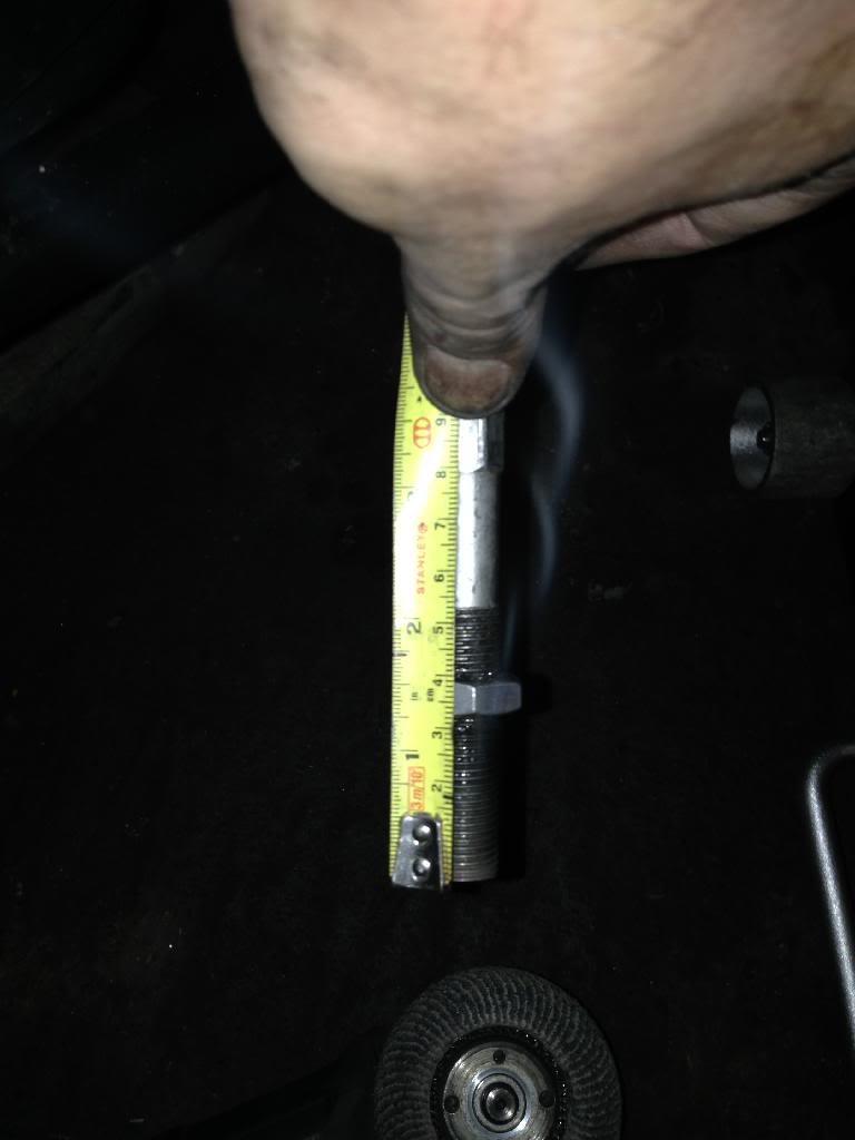

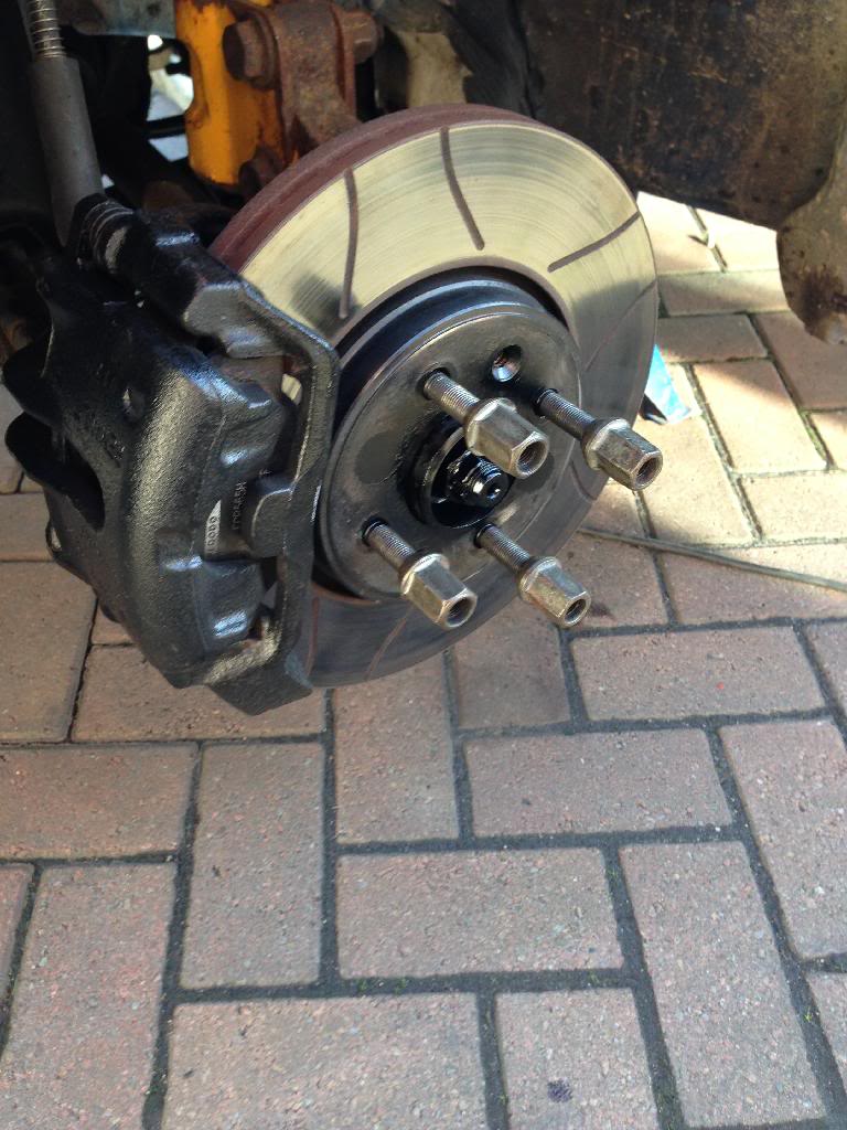

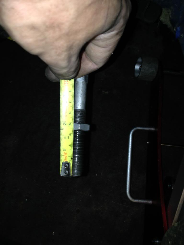

Today...... So I thought I was only fitting spacers, longer bolts and washing both the cars before getting the Clio on the trailer. It turned when I went to fit the spacers and the bolts I had were 15mm too long :mad: .
So I looked out my spare cup racer hubs and started to rob the studs and nuts from them. Every single one except 3 were an absolute nightmare to come out, locked nuts wouldn't touch them, heat had little effect so I cracked out the stud extractor. The extractor galls the threads a bit so you need to chase them ALL after removing them.

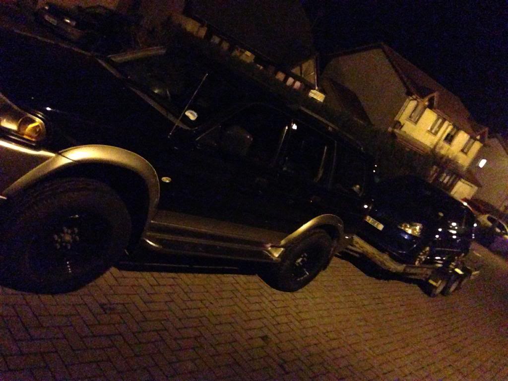

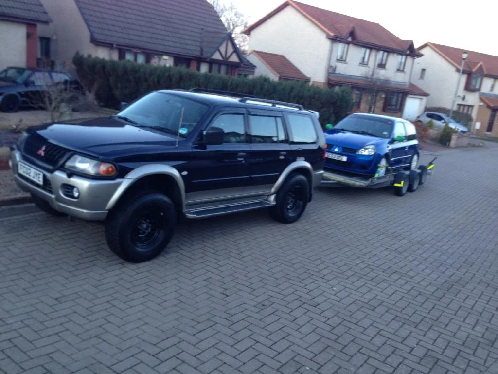

Anyway finally got that done and I go to collect the trailer to find the handbrake had been left on (stupid f**king c**ting boy that borrowed it last) and the brakes were locked solid, tried to drag it, no luck, battered the hubs with wood and a hammer, no luck. Finally I went to take it for a run and hope it freed, luckily it did 500 metres down the road after all that f**king about. Just as well, I was seconds away from hunting down the last guy to use it and murder him.

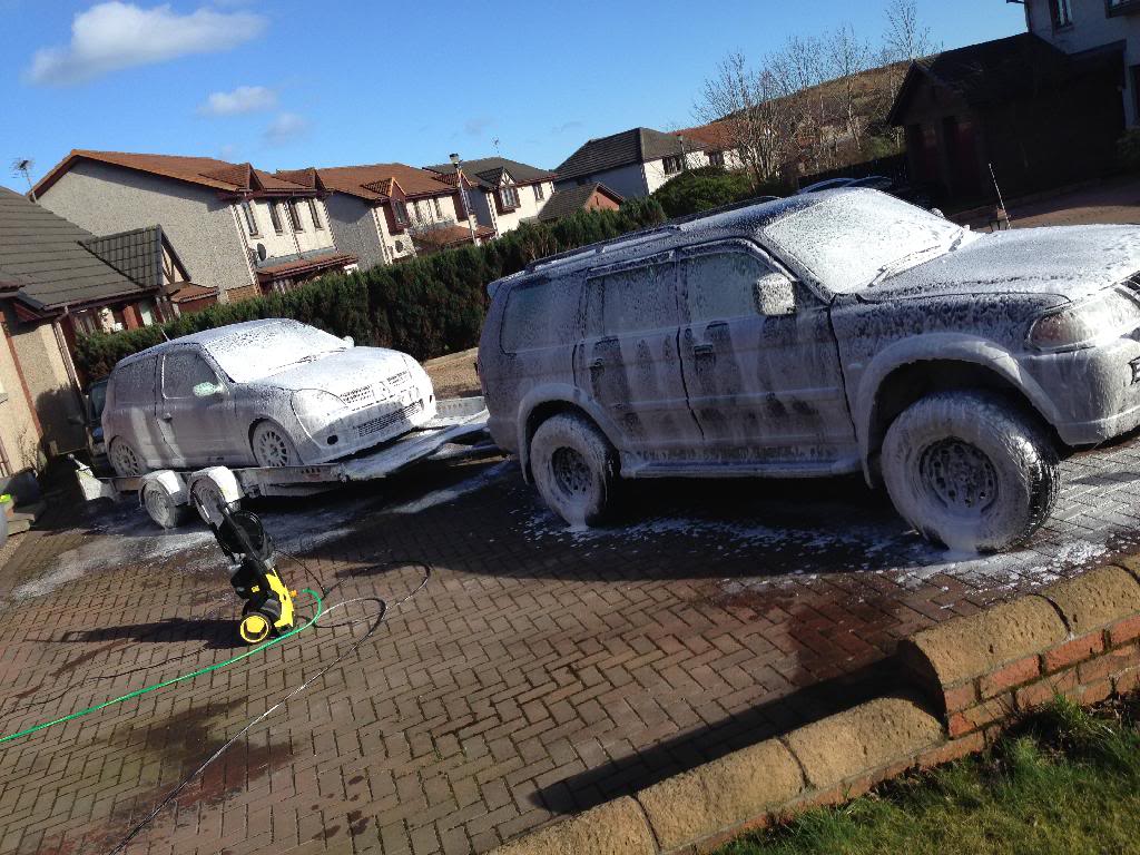

In between all that I washed both cars, repaired my drivers mat, fitted the hose and finishers for the breather tank.

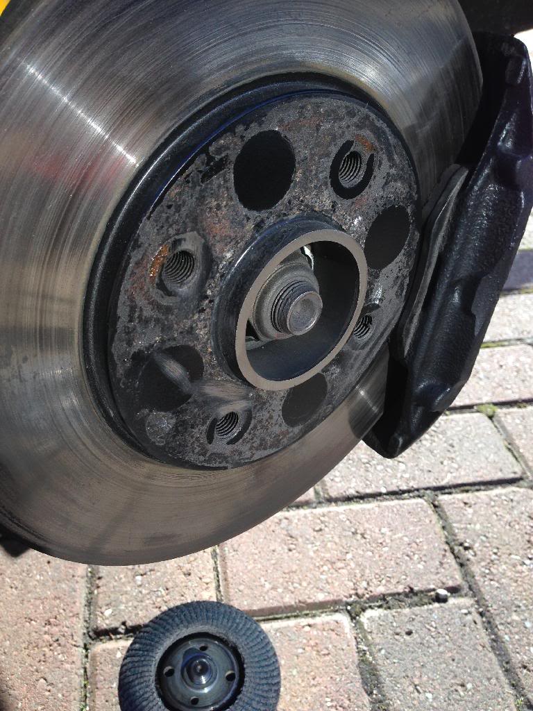

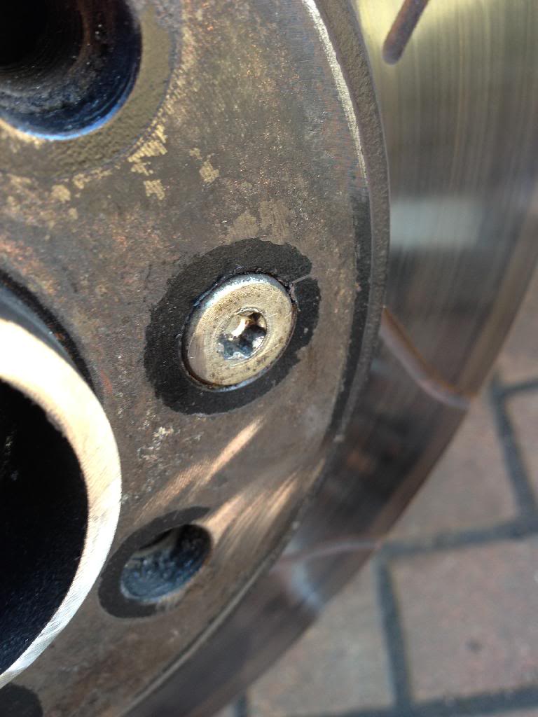

Spigot ground down on all four wheels.
Disk locking bolts removed as the spacers wouldn't sit flush.
All four corners complete, I had to rob 4x PMS studs from the race car as two studs were too galled and the other two refused to come out. I'm now rocking 12x cup racer and 4 x PMS studs.

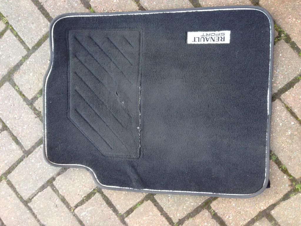

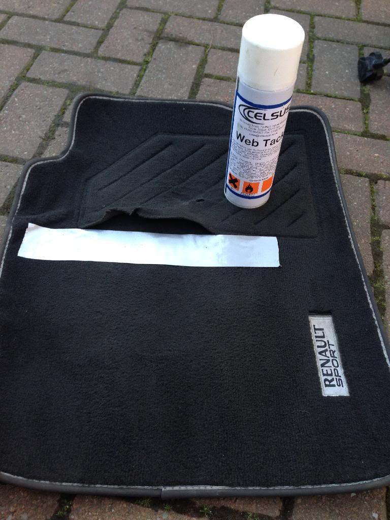

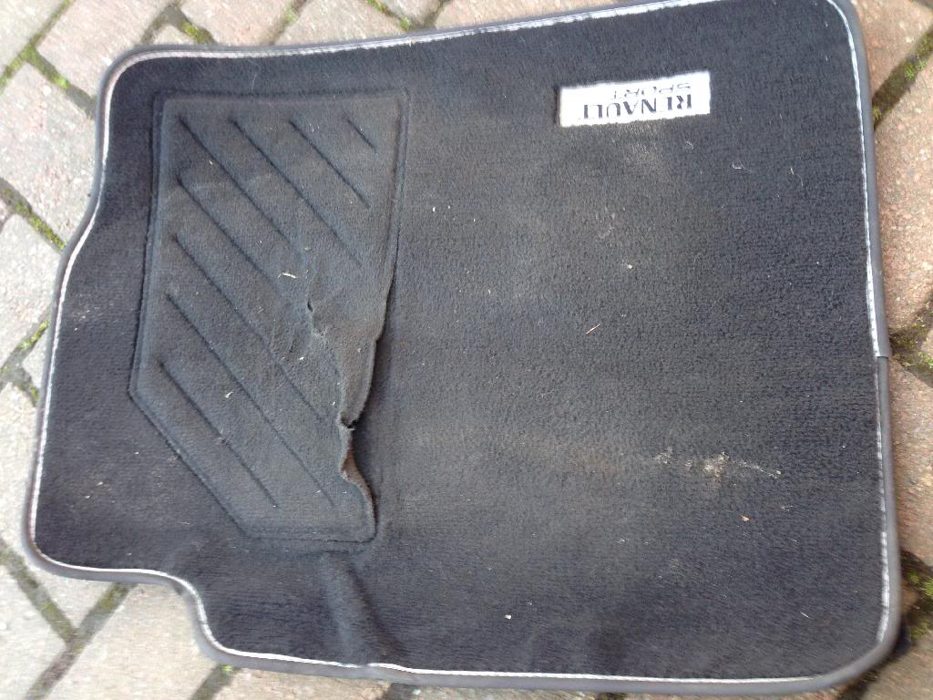

The drivers matt was looking tatty and started to lift on the heel pad.
Cleaned and some web tack sprayed on.
Finished, its not perfect but it will save me dragging the mat around with my heel.

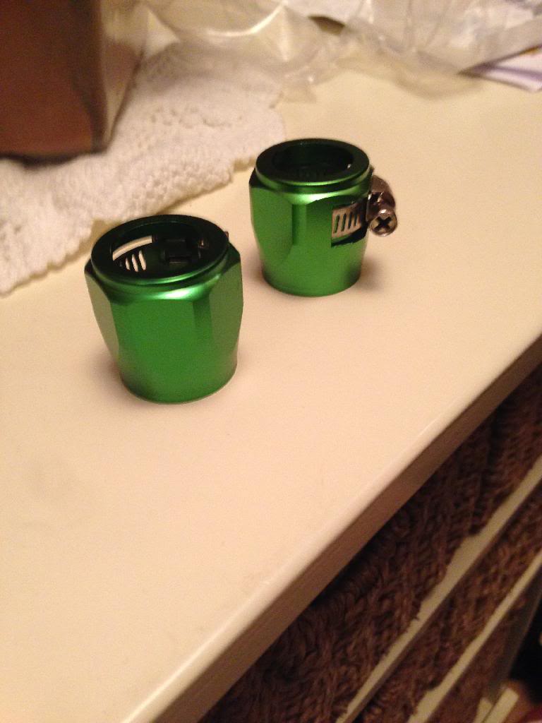

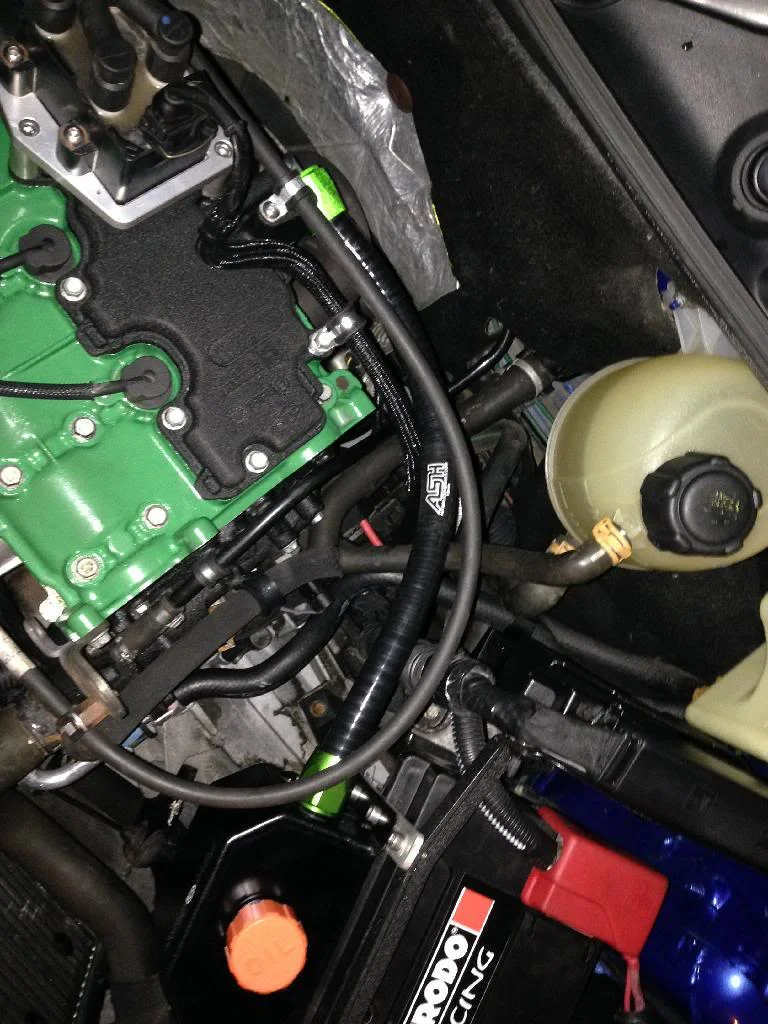

Received the hose finishers and silicone hose today, nothing like cutting it fine.
Fitted.

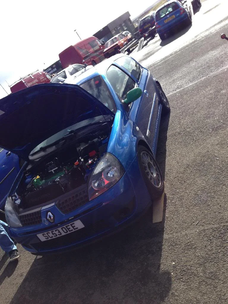

Well today was pretty poop for me, despite breaking my PB lap after lap the car just wasn't confidence inspiring to drive. Between the brakes going off after circa 5-6 laps, my bad driving at times, studs working their way loose at the hub a few times, the exhaust and box knocking like a c**t when on and off the accelerator (standard g/box mounts and a vibratechnics engine mount is not a good combination) and trying to find a good balance with the damping/tyres it wasn't the most consistent of days but fun was had at times when people would get out your way, a lot of straight line heros I thought.
@Gaz-m and your pal (I forgot his username) nice to meet you's and your car went very well Gaz and it surprised me in the first session when I was two's up. Your car is well turned out too. Shame your pals had issues.

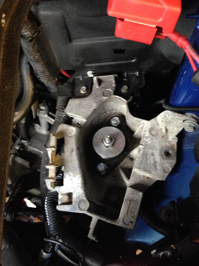

On the repair list.

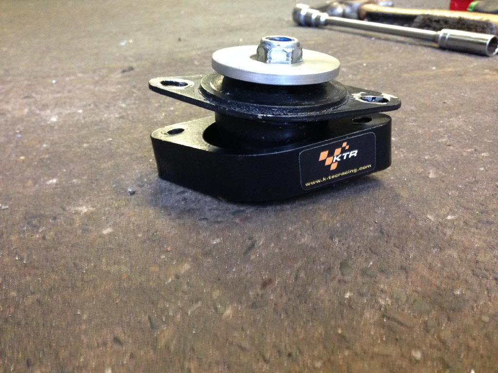

Both box mounts need looking at and the exhaust lowered along its length, engine position adjusted.
N/S CV boot has a nick in it and is weaping.
Remove, clean, inspect and refit the studs.
I need to run a data log on the AFR's and get it checked over, I'm pretty sure its running rich with too much backfiring on over run at times. Whether that's the map or the lambda causing that is yet to be seen.

Bet you it does! I had a similar issue going into the hairpin but was down to the powder coating on the wheel against the hub heating up and melting. Not a good feeling.
hopefully see you guys soon(ish) on track! Lol
Yeah powder coat can be deadly on the mating face and taper for the bolts.

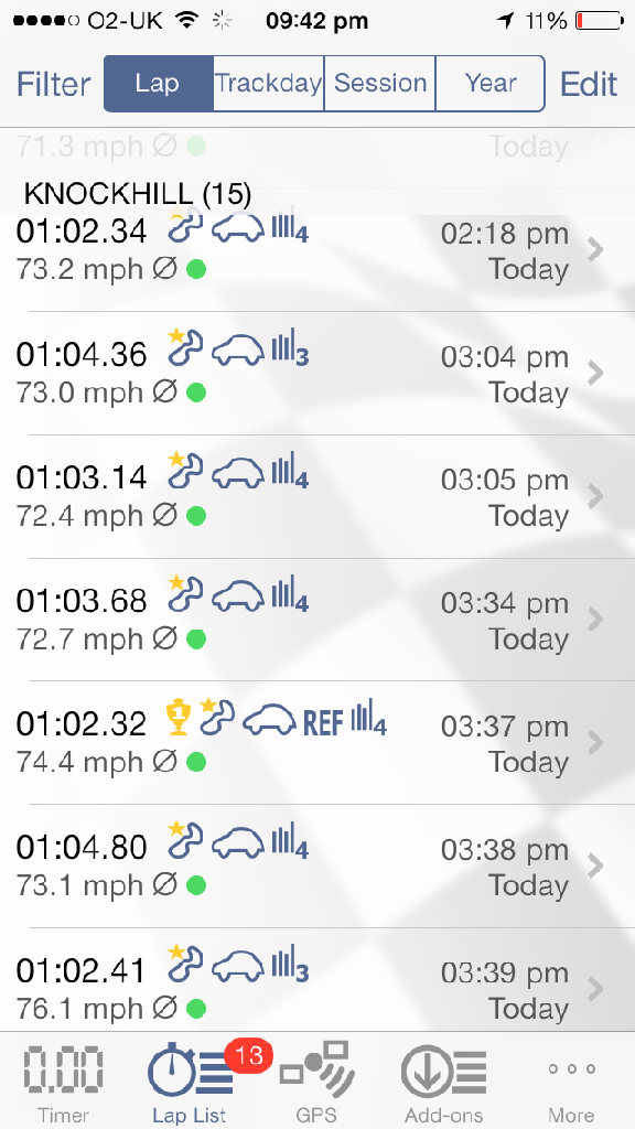

What lap timing app is that? Looks decent!
Its Harry's lap timer, its brilliant and does data overlays on the videos, lap to lap overlays and all sorts of graphs.

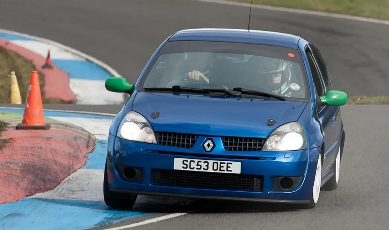

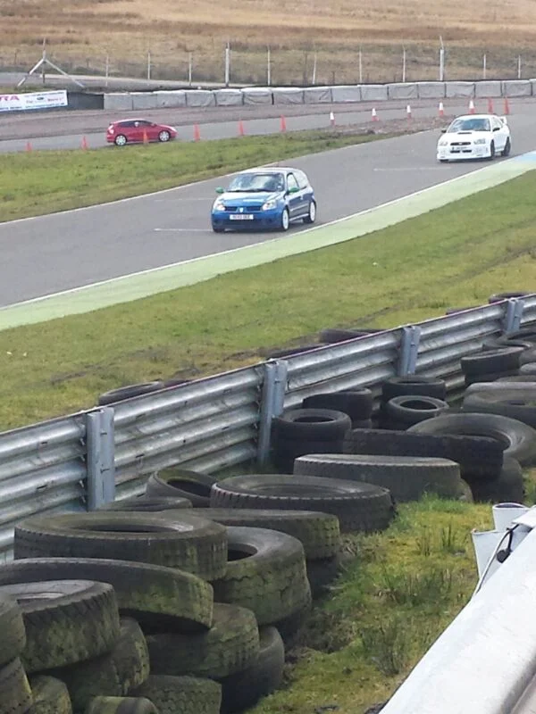

A few rubbish pics and a video from the the TD on Sat, one more video to come when it uploads.
Fitted a sun strip in a rush on the morning of the TD to keep the low sun out the car.
A poor pic on track from my mate.
One from a local photographer on track.

Heres a pic of you shoving that red beemer through the chicane..
That's the Yoko's at that point, damping was full hard all day on the rear and I can't remember what I had on the front at that point tbh. I trail brake through Carlube sometimes for fun if that's what your speaking about. Its on rails in comparison to the last one though haha or just less of a boat. Yours will become a bit more like that if your RARB's on full hard when them spanking 888's get some more days in them.
Aye seen that pic, I was totally surprised I was hanging onto M3's, Z4m's, Cayman S and the likes and faster over a clear lap.

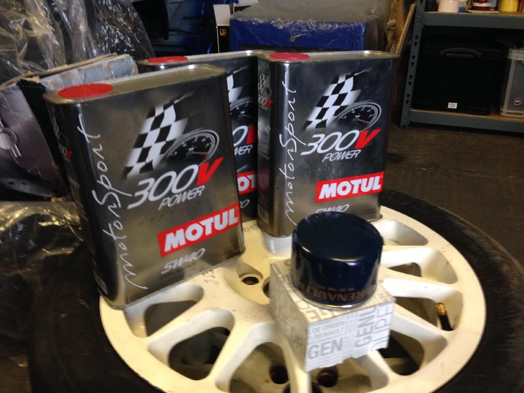

Today I set about getting the car ready for this coming Saturday's track day.
Genuine filter fitted and some decent oil used.
I was getting knocking of the exhaust when on and off the throttle as there was just a vibratechnics engine mount fitted. I got a gearbox one and got that fitted. The car feels much tighter now.
All the studs removed, degreased, and refitted with more loctite.

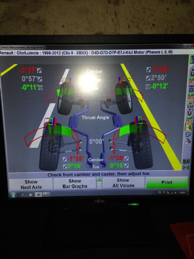

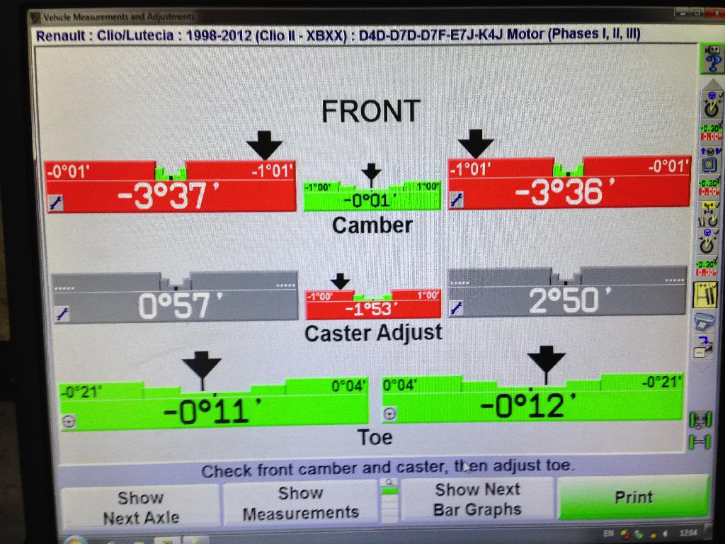

I done a more extreme geo on the car to hopefully get some better heat spread on the tyres this weekend. To get anything near the 10' toe out I wanted I had to grind off 10mm from the tie rods.
Thats everything done on the car other than to wash it tomorrow and get the N/S/F tyre swapped out for a fresher one. I just hope the weather predictions don't come to much.
Im jealous you just need a wash, its not looking good for me making it. :(
How much camber you running? Ive got 4 degrees and tyre was still hotter on outside !!
When you next out @.GAZ.
Nae good, come up anyway as there will be drop outs on the day. Half the cars are sheds on Knockhill days so problems are many.

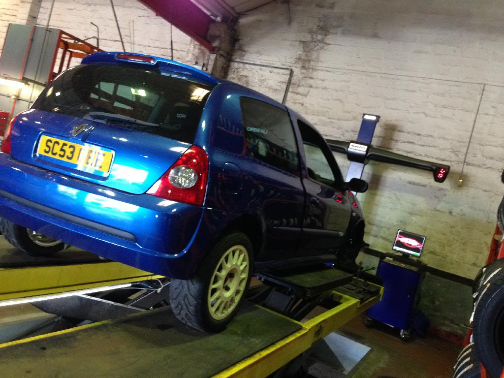

I have 4.5 deg on I think @Gaz-m and I'm going to get it on the hunter machine tomorrow to clarify what I have been doing with the string. Your never going look after the NSF tyre around KH with the lie of the land but you can do your best to lengthen its life.
The last few final bits before tomorrow.
I wanted to check what I had been doing with my string rig so I had it on the hunter machine.
The rear beam is pap on with some toe out, just how I like it. I can only get 3.6 deg neg on the front before I hit the adjuster rings on the coilovers. Even at 3.6 its cutting it fine.

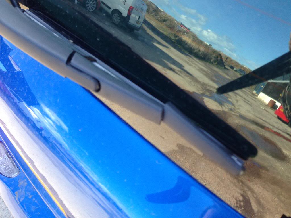

Another new wiper, the last one was a week old and broke. It must have had an imperfection in it.
Back home for a wash. 3 birds with one stone. Track car, trailer and tow car in the one shot.
Ready to roll tomorrow. Pressures set, wheels torqued, rain-x on the windscreens incase the weather turns bad. Looking forward to it, I hope my few niggles from last weekend have been resolved and I don't touch it all day.
