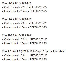

Thinking of replacing the front chassis mount bush and outer mounts.
My car is a 55 plate 182 with both cup packs. Which bushes would I Need?
The options are 23 and 25mm for the chassis mount bush
And 22 and 23mm for the outer anti roll bar mounts.
DO NOT GO BY THAT
I followed that and it was wrong. THe best thing you can do is measure it dude. Twice I had to take them back for inner and outer as they were wrong.

Hi Tom
The Powerflex bushes are all the same
23mm outer bush, 25mm inner,
I've certainly not seen any other combination for as long as I can remember.
We have them in stock here
I think some of the confusion years ago was because the Ph1 shared components with the Mk1 Williams and Powerflex did not measure.
