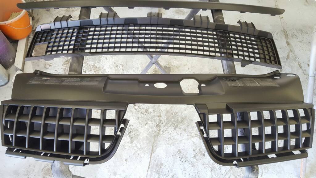

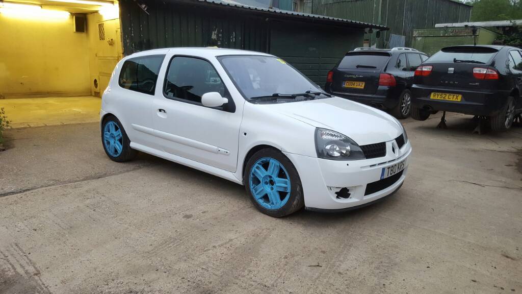

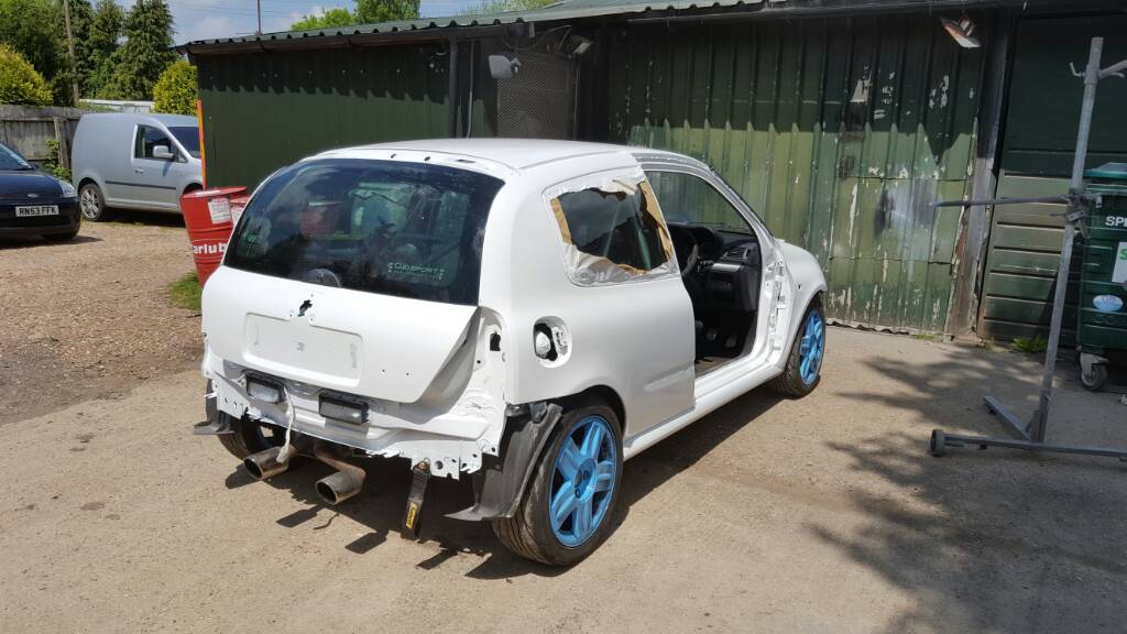

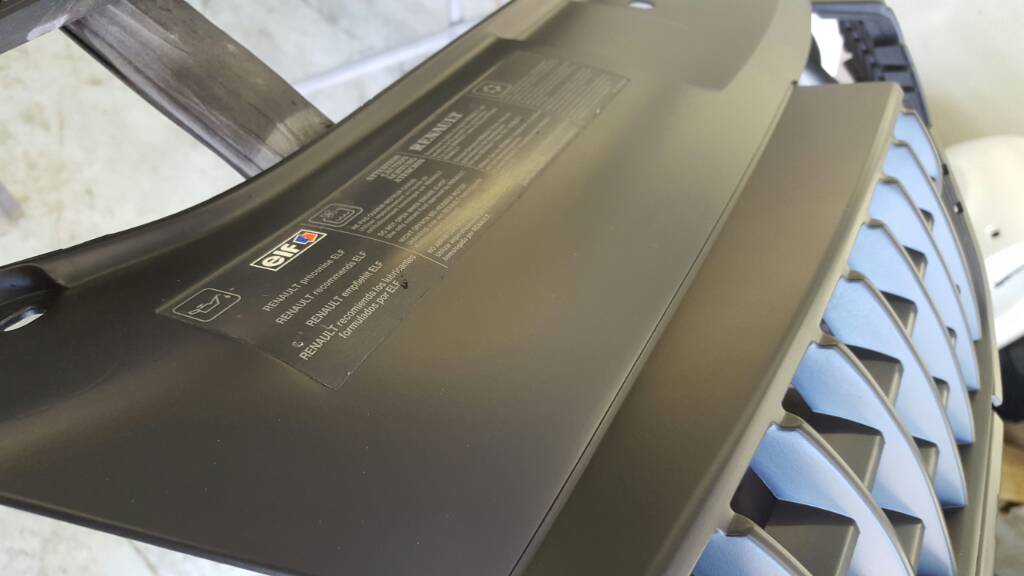

Also repainted the front grills in a special plastic trim paint which came out far better than i had hoped
  Clio 182 Track Car

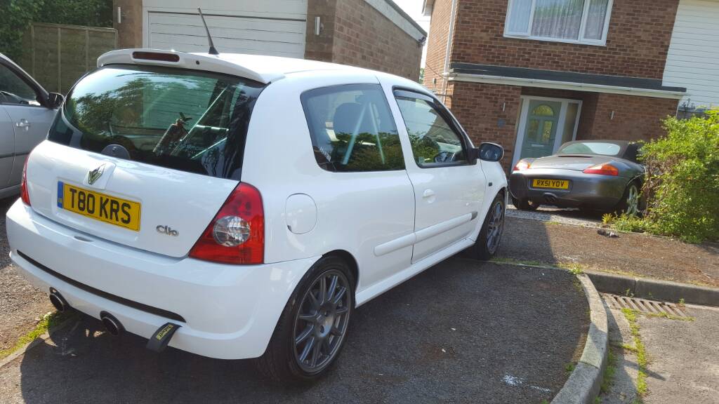

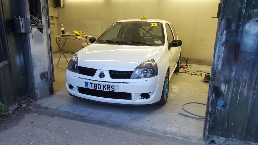

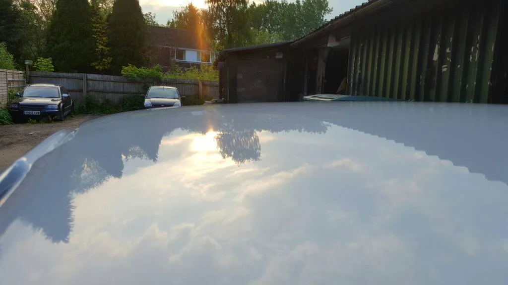

As it was a nice sunny day i was able to leave the car in the sun after baking. Thats went i was first able to really appreciated the pure, crisp white paint i picked.
I then loaded everything back in the workshop and called it a day.

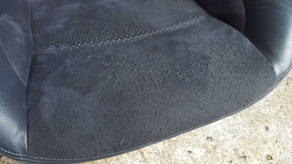

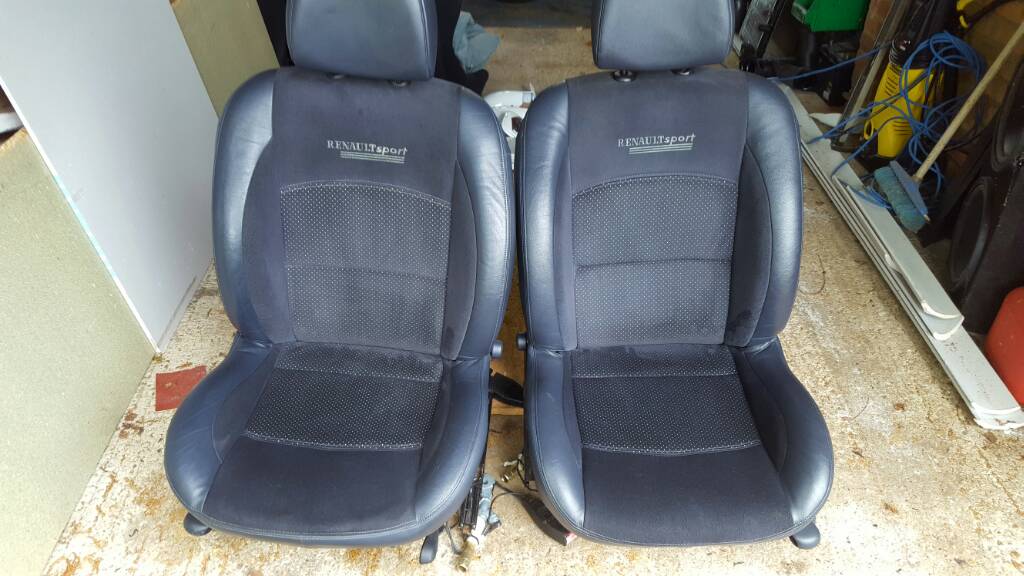

I left the body and panels to further cure for a few days so in the mean time i cleaned up my turinis

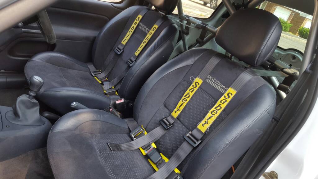

Cleaned up the original seats as i no longer wanted the raw buckets seats.

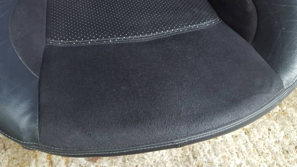

I also shaved the suede part of the seat to remove the worn nobbley bits
Before:
After:

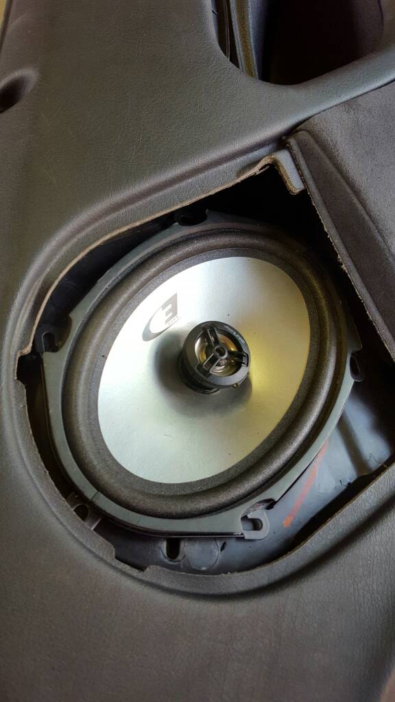

And fitted bigger speakers to the front

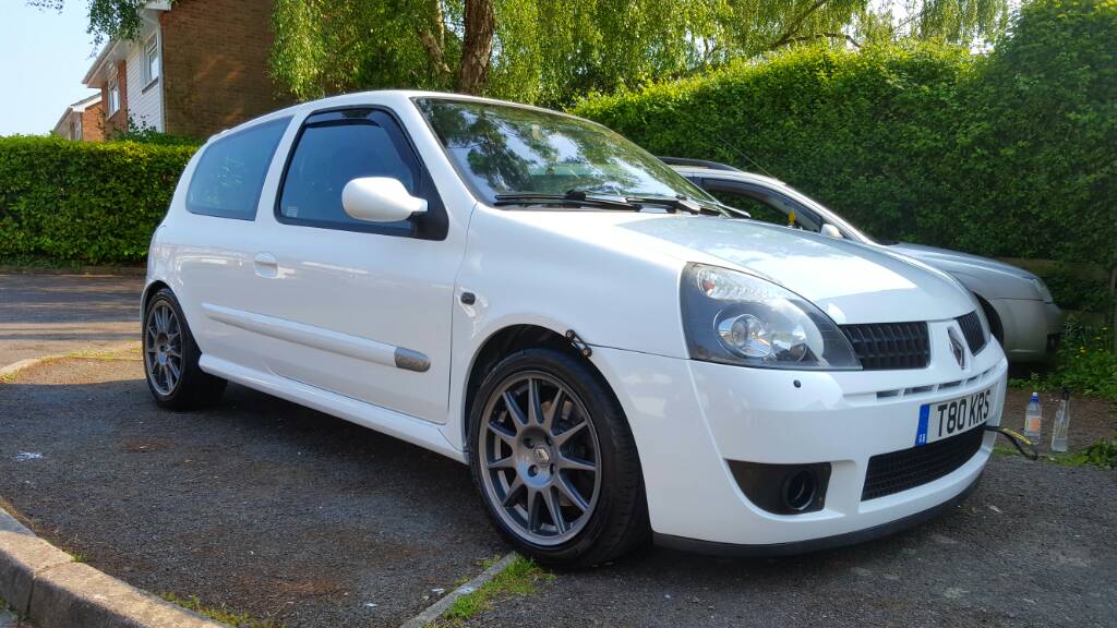

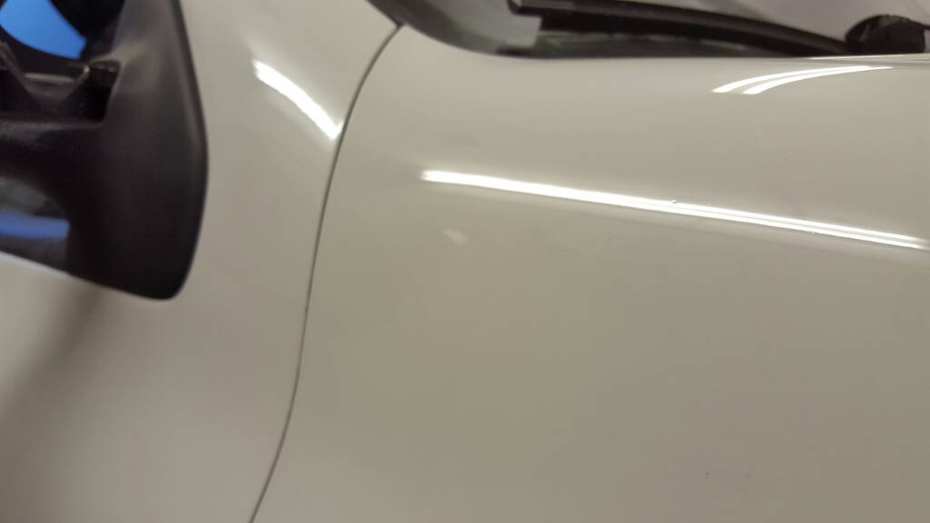

Evening by evening i put the car back together and start machine polishing it with a 3M 3 stage polishing system
  Clio 182 Track Car

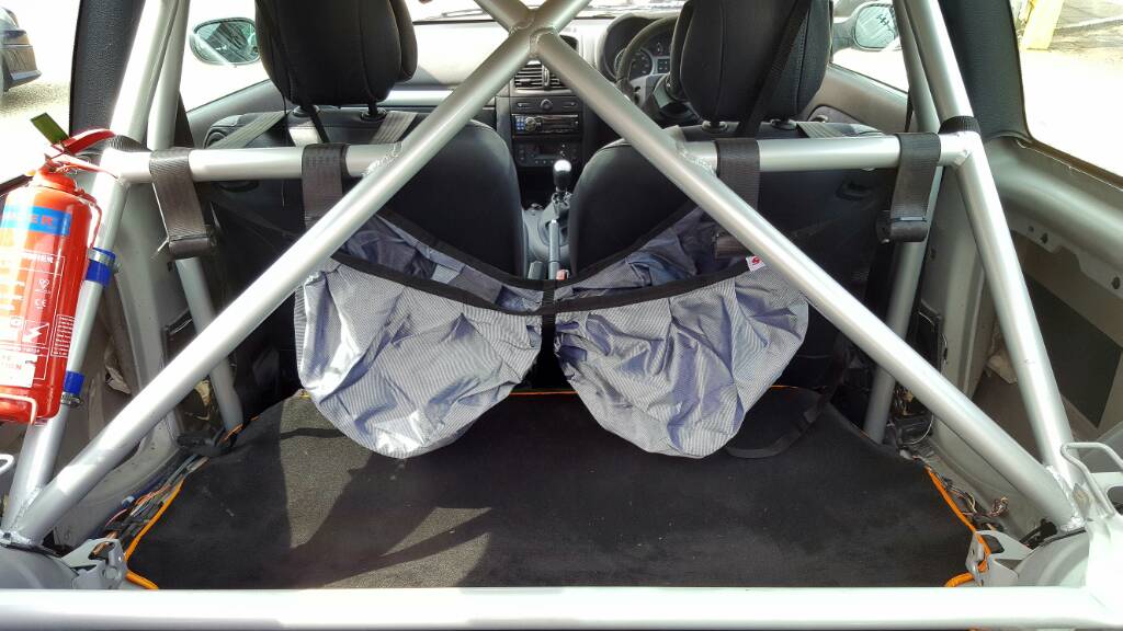

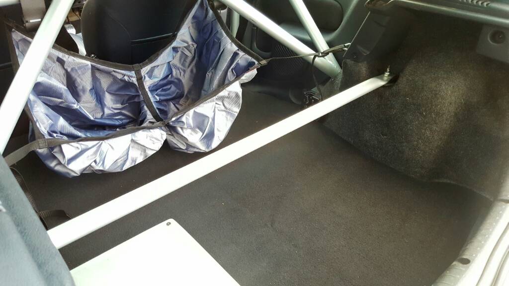

Once i had finished assembling and polishing i drove it back home to finish refitting all the smaller parts and interior
Custom carpet, inspired by Rob's stunning supercharged clio

White is so awesome for these, best colour by miles.
Really wouldn't be running harnesses with those seats though, so dangerous :(

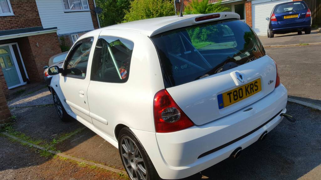

The repaint was intended to be a quick job so there would be many things done differently e.g full glass removal, if i was going all out and doing it properly. But for a quick job that took approx 3 weeks of working odd evenings i really happy with it.

due to the seat strength and structure in an impact?
It's not as bad as it could be because you have the harnesses mounted at a good angle but, if you did have a smash, the harnesses could cause the seat to collapse. Really wouldn't recommend running harnesses with standard seats so worth looking into bucket seats, or fitting standard seatbelts.

The harness setup with standard seats had been on my mind. I do run standard belts for road use and harnesses for track, mainly to keep me upright and secure.
I will probably end up with some trophy seats or similar

Yeah I saw an awful picture recently of a MK1 Focus RS that was using harnesses with the standard seats. He binned it (quite hard) on track and the seat had collapsed quite badly. It had actually bent the back rest. I'd personally only recommend using harnesses with fixed-back seats. Worth bearing in mind anyway.

Can't see an issue with using harnesses with standard seats as long as it's on the rollcage as it is.
The reason why the FRS was so bad was because of the angle so in the shunt its pulled the seat downwards (which that seat isn't designed for as it's fake) which has crippled the seat. In this the load will be directly going on the rollcage.

The car originally was just for track use only so running buckets was fine but now i need the car as a daily the buckets i have are no good. Will explore other options in time
