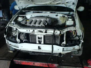

well thats restored my confidence in this site, ive heared a lot about u matt black, ur highly respected on here mind!! thanks for the pm it helped a lot, i printed it out and showed my mechanic and he agrees but we have got the 182 brain, uch and correct key so we are going to try and sort out correcting the brains faults, another thing i wanted to ask is can we program the brain to forget it ever had abs? when we turn the key, a stop light comes on the dash and another red 1 which im not sure about, but when we connected the fly by wire accelerator it is adjusting the throttle innlet, so thats got 2 b good news if its reading the throttle?
Whats the fault when you go turn key - does nothing happen ??
Does it attempt to turn over but not fire ?
If nothing happens at all i bet you its the UCH thats at fault
Have you checked the plip key to make sure the plip is emmiting a radio frequency ?
I think its the UCH personally - when a clio has been in a bump these usually bugger up and you have to replace them. Most conversions involve problems with the UCH - there hard work

no it wont even go and kick nor try and fire, its just nothing, but surely the throttle wouldnt work if there was a problem with the uch? ill find out off my mate what the other light is on on the dash cos im not with the car at the moment, and no i havnt checked the plip on the key, how do?

Its the UCH playing up - if you go to turn the key and theres nothing at all its the UCH - have you got access to a "clip" renault diagnostic computer ? this will confirm the problem and check through all the sensors and terminals to make sure everything is ok.
Out of interest whats the engine number - it will start F4R *** and then directly underneath that there will be a 7 digit number starting with a letter and 6 numbers following it. If you can get me these numbers i might be able to trace the ID of the donor car and get you your immobiliser codes !!
F4R 738
C 152345
