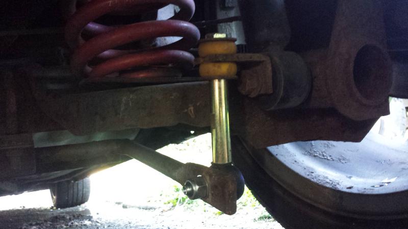

Ideal time to think up something better, I think that bracket (although it works) is the piece that lets the whiteline down.
What is the benefit from these uprated drop links?
The oe way they corrode and when you come to undo the two nuts that lock together the whole threaded bar twists or snaps. I was going to use two rose joints and bend the torsion bar out to meet the bottom of the shock more, then use a longer bottom shock bolt, but decided against it as I didn't want to upset the T bar.

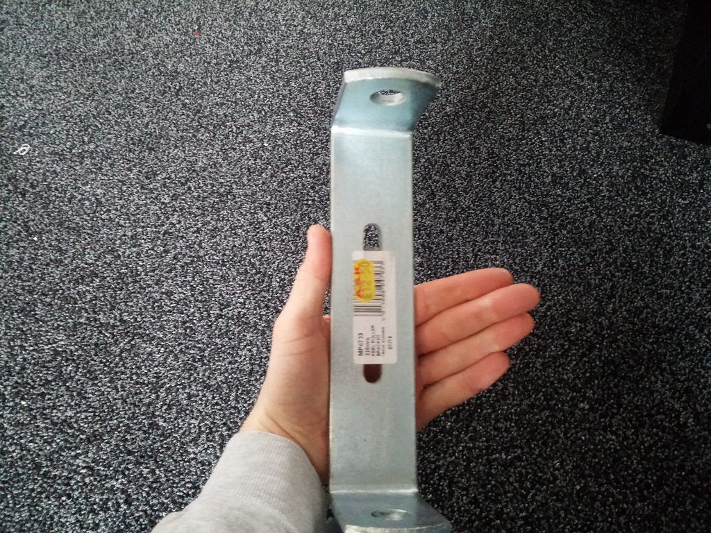

Went for a drive to wickes and B and Q and they didn't have any decent angle iron that I could use! All so short. Took a blurry as tits photo though
20150314_135936 by dann2707, on Flickr

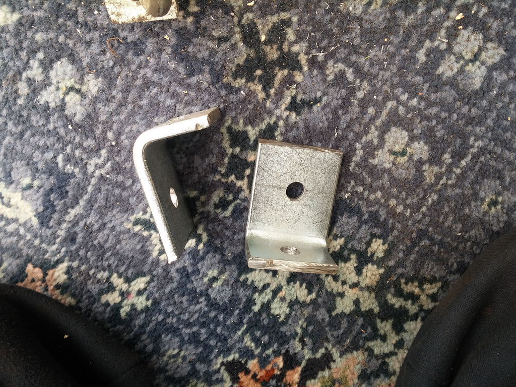

I then went to my local automotive shop up the road this place is an absolute godsend @bashracing will no doubt agree!! I found this from towing a caravan or something? No idea
20150314_143026 by dann2707, on Flickr

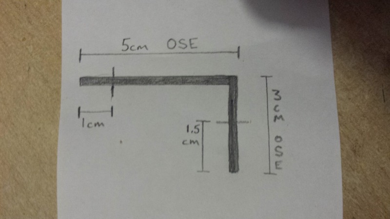

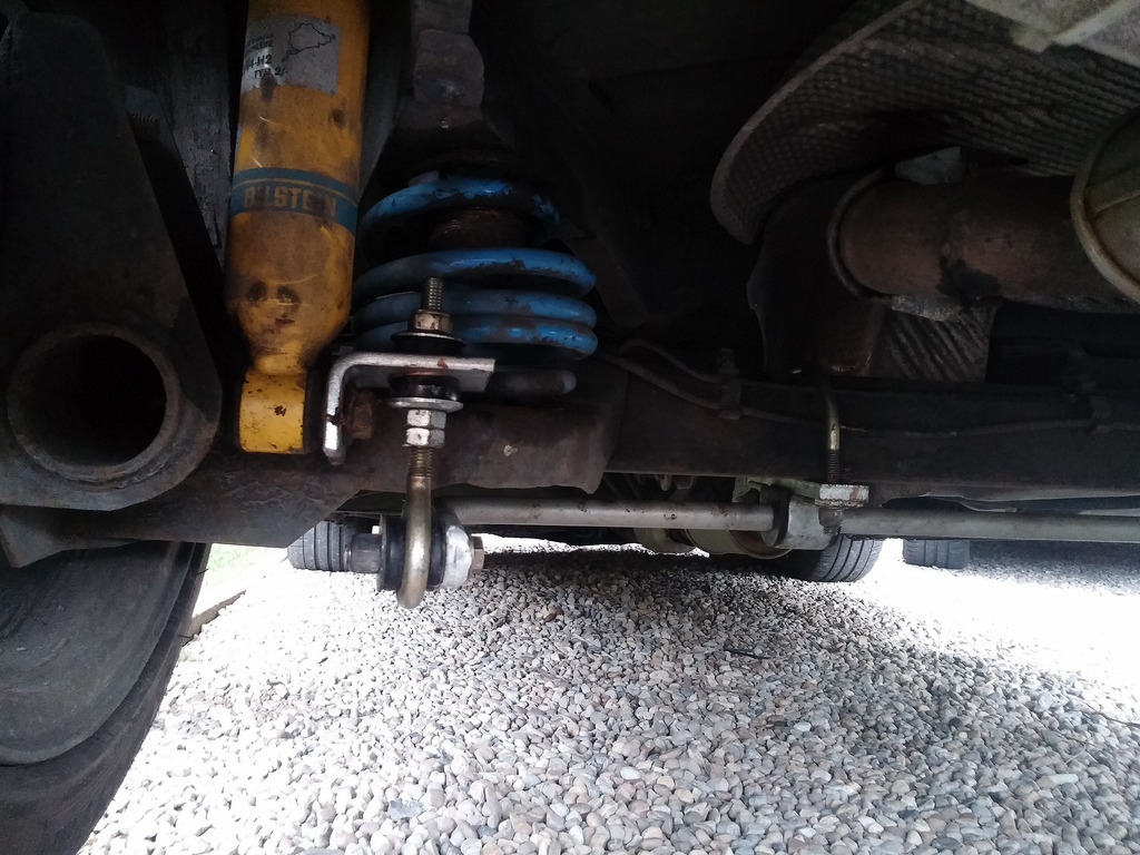

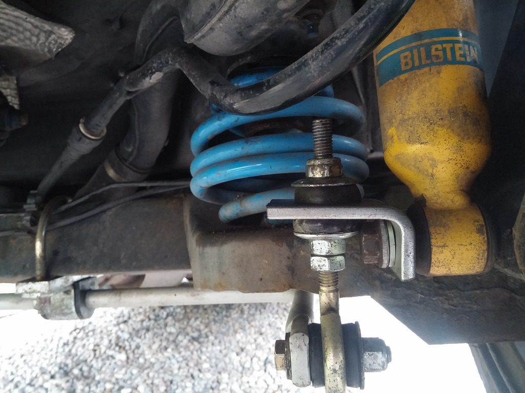

I then marked where I needed to cut thanks to @1812lsd giving me a drawing from his brackets :) And all done, not the neatest job in the world but jesus it's stiff!!
20150314_153718 by dann2707, on Flickr
Then reversed the car up.
20150314_155558 by dann2707, on Flickr

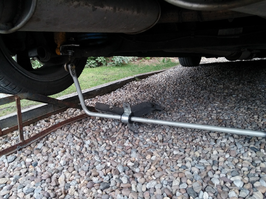

Fitted perfectly :D
20150314_160453 by dann2707, on Flickr
20150314_163259 by dann2707, on Flickr
20150314_164318 by dann2707, on Flickr
20150314_164322 by dann2707, on Flickr
20150314_164332 by dann2707, on Flickr

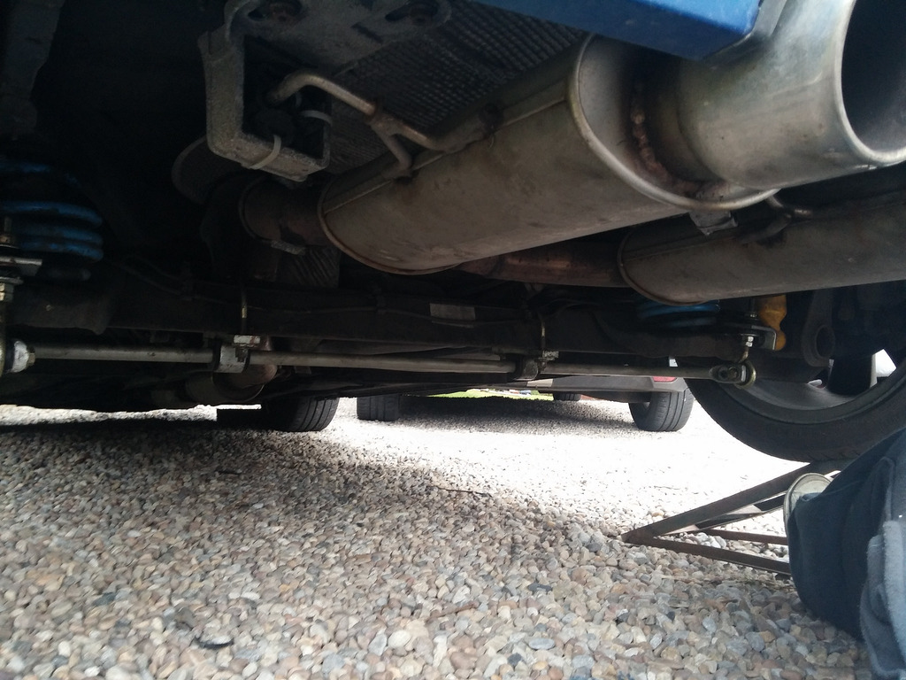

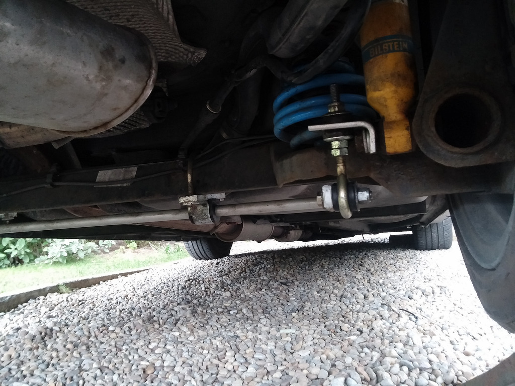

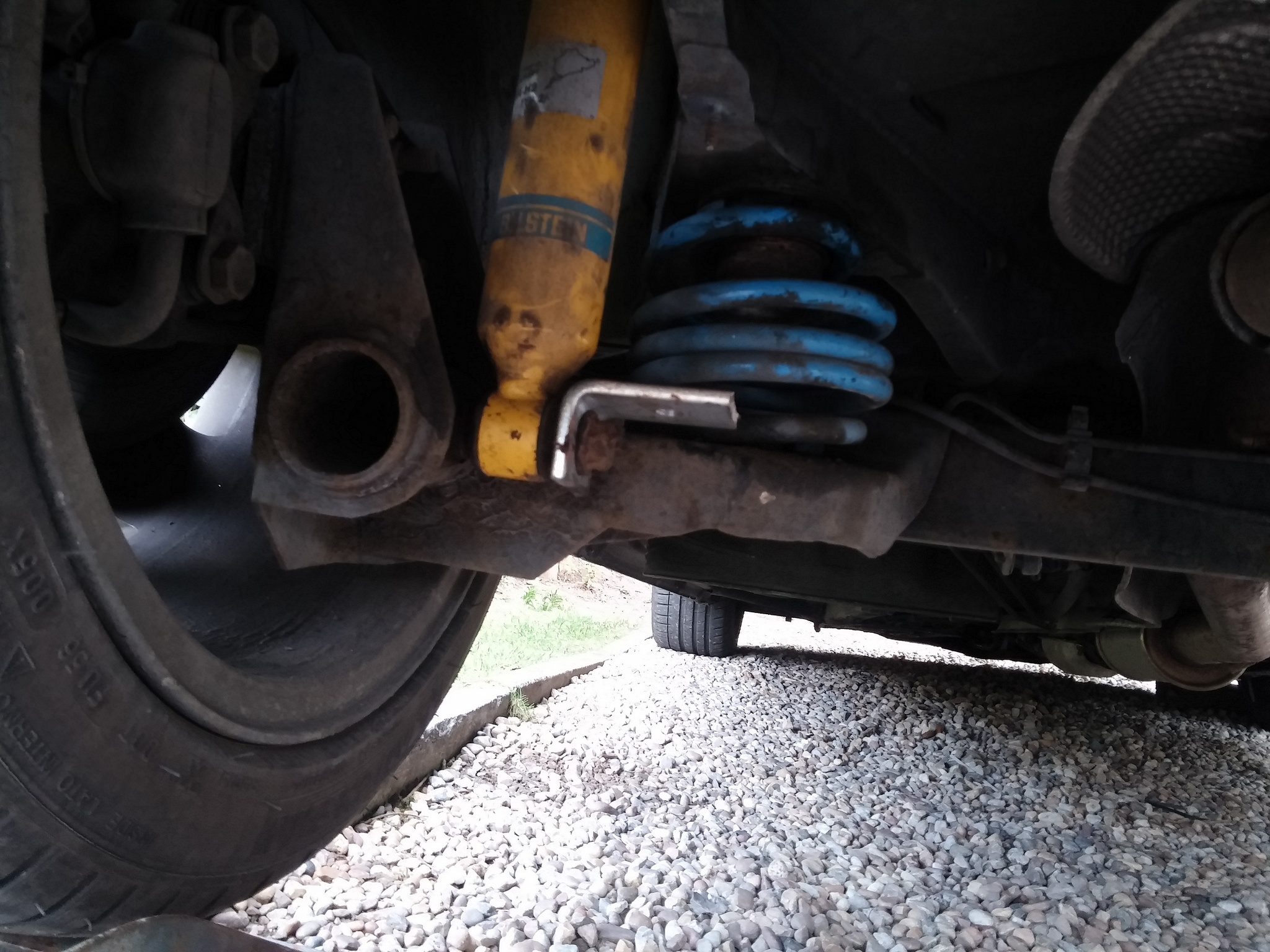

Have I overtightned these bushes? They're not deformed or anything? @debussetti
20150314_164341 by dann2707, on Flickr
Thanks for all your help in here guys :)
Am I right in saying that when on the hardest setting the L brackets I've made should be at a bit of an angle? The top part facing towards the back of the car?
They shouldn't be straight up
