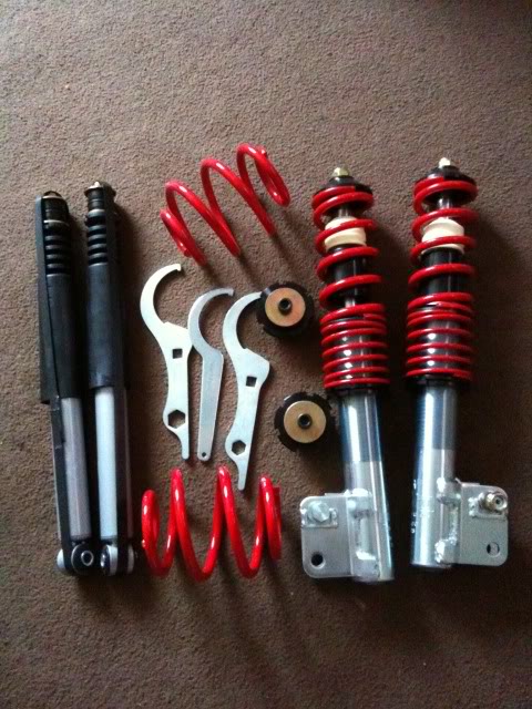

Why cant i get camber??
Ktec do the same with making their non cup coilovers fit cups. They just cut away another hole.
I'm interested in knowing if this is an ok thing to do as I'm thinking of buying some bilsteins and either getting them machined by the suppliers or myself.

Right, I had a little play with it and it looks like you guys are right, it is being caused by the bolt spacings! I set the hub to in-between the two holes and it gave a substantial difference in camber!
Next question is, do you think it would be possible to fabricate them to drill new holes? I'm thinking bore those holes out so they are one elongated hole then weld a plate over the top and drill new holes?

Pre 'adjustment for cup spacing' the holes would look like this.

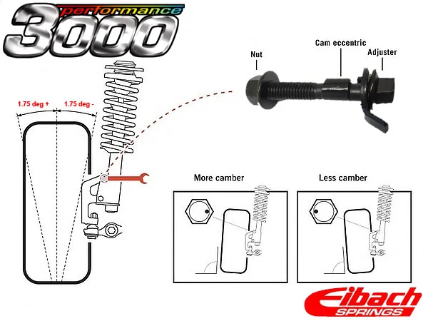

Out of interest, why did you go for the Eibach bolts instead of the ones supplied with the suspension? I have done the same, but that was because I thought i'd have more adjustment with the Eibach ones but in the end I think there's about the same adjustment.

I found the standard ones like putty! The washer just rounded and the bolt would spin freely without adjusting anything. I adjusted mine alot though trying to get a good set up for track.

slotting the hole is fine, it can't go anywhere. However you'll never get more than about 0.5deg of camber. This is why I sell Vmaxx as my budget option, they have completely redesigned brackets for 60mm fitment. Got another higher quality manufacturer working on a new kit too ;)

That double hole is f**king shocking! It's got virtually no edge landing on it. AVOID.

To be honest it is missing about a quarter of the surface area. Not good in anyway, but not unsafe/dangerous. I just want proper adjustment for camber!

Based on the images, I would suggest the following:
The position of full camber vs the lower bolt has changed. The reason this has happened is that if you were to remake the bolt spacing inline with the existing lower hole, you would run out of material.
It's a mess if I'm honest as it has not only changed the bolt spacing (crudely) it has also completely changed the angle at which the hub attaches to the coilover.
If they were mine I would be replacing the lower assembly with a blank / replacement part.

Well people its fixed, and it was a simple mistake...i read through this thread again and Fred is the winner
are you pushing on the hub (with the wheel off) when rotating the camber bolt? lower strut bolt has to be loose too
Pushed against the hub with a bit more force and its perfect, the eibach camber bolt was at the front edge of the top elongated hole! Now its at the back i have about 3.5 degrees of camber and the wheel is nicely in the arch!

Best way to have about 3 degrees of camber is to buy 4 camber bolts, 2 each side.
Then you'll have a possibilites to set both bolts separetely ( 1 bolt is giving about 1.5 degree of camber )
