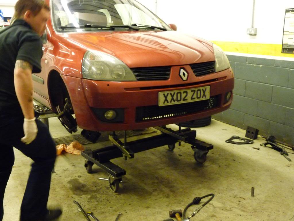

Carried out the widetrack conversion on my DCI today.
So here it is before

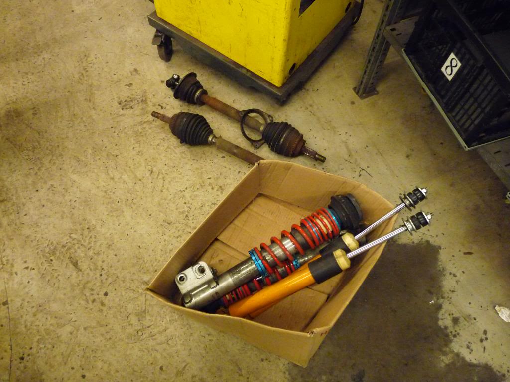

The subframe, wishbones, driveshafts coilovers and brakes from my 172

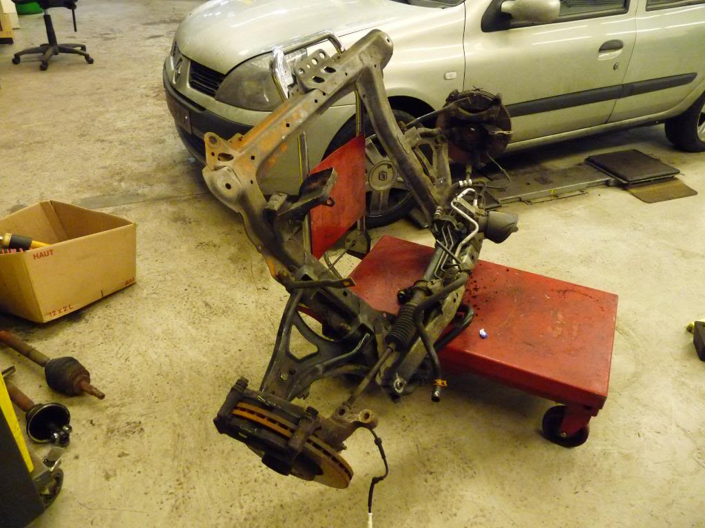

Swapped the electric PAS rack from the DCI subframe onto the 172 subframe
Putting the 172 subframe onto the DCI

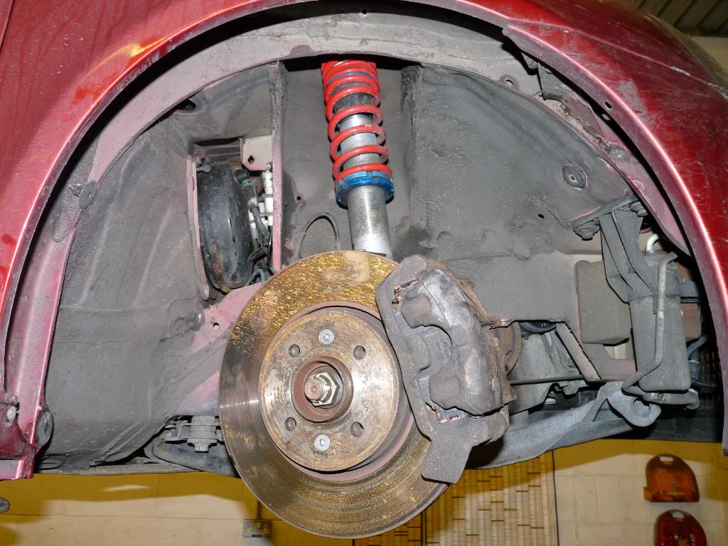

Front coilovers and 172 brakes on

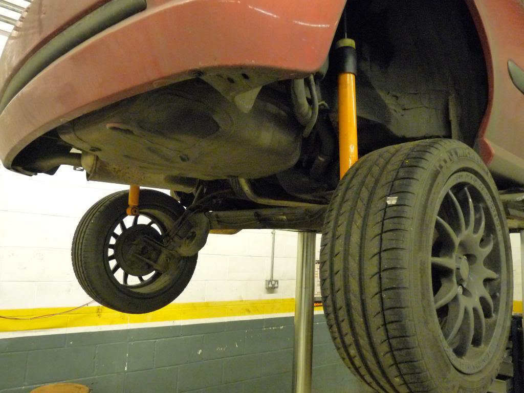

Rear coilovers being installed

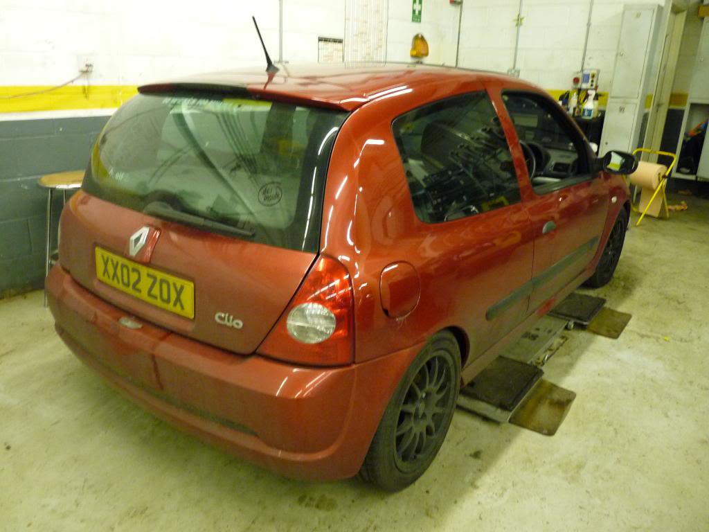

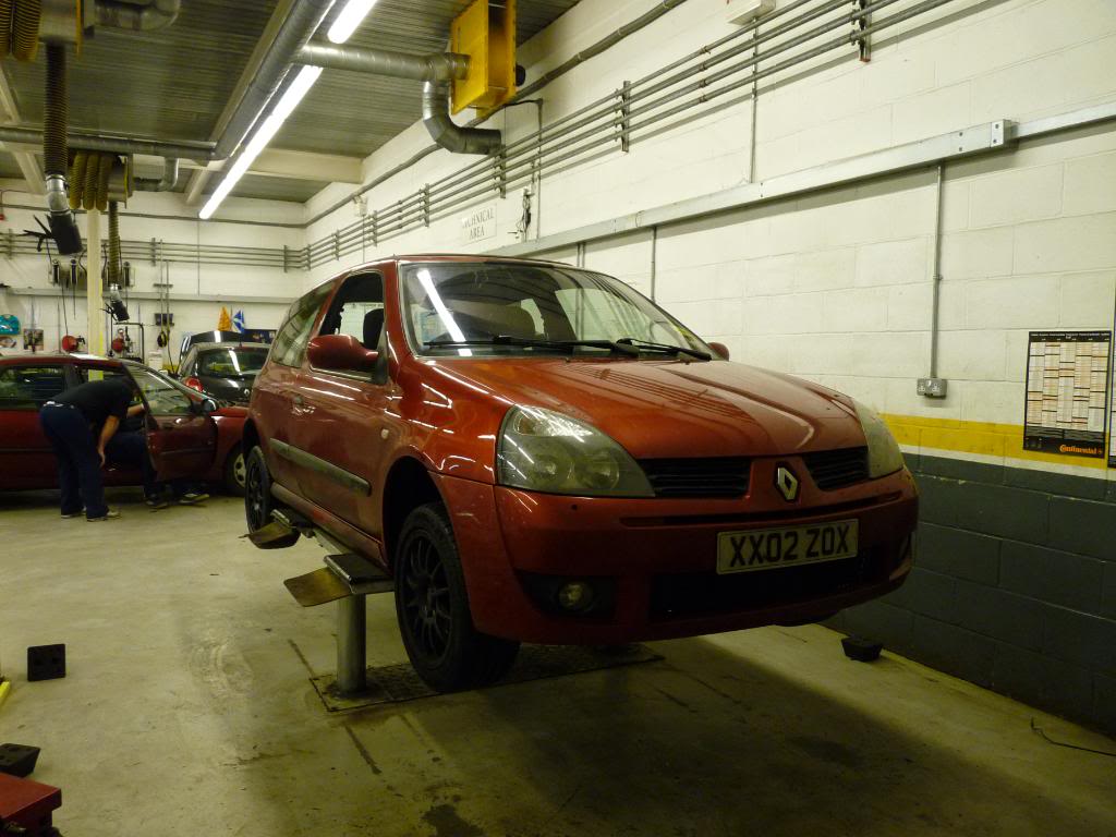

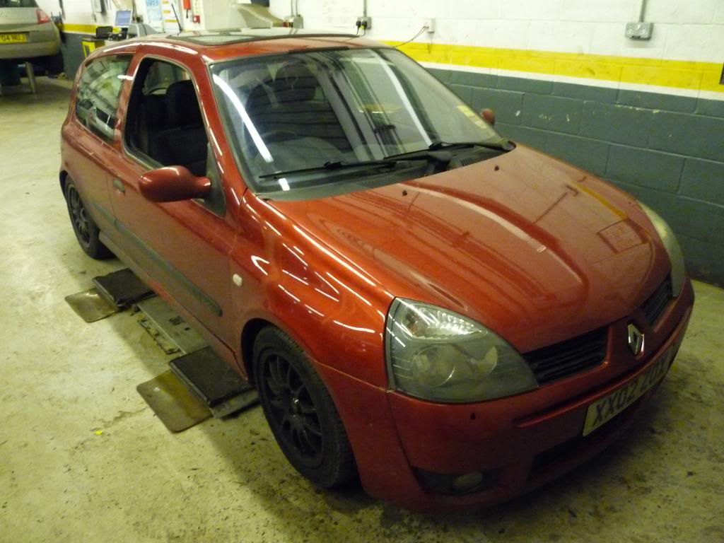

After pictures
Now just got to get 4 wheel alignment done and give it a wash :D

Out of interest can you get hold of the subframe lowering tools you're using there and any idea on price?

Haven't got a clue on the price of the equipment

Good news, had the 4 wheel alignment done today
Turns out that one wheel had 2 degrees positive camber and the toe was 3 degrees out - no wonder the steering felt a bit dodgy!!
Just need to get some camber bolts as one got mangled when we took it off!

its on the cards. i don't suppose you know if you need to change the whole rear axle to do the rear disc conversion or whether the rear discs will fit in the standard axle?
Is the 172 axle wider?
Do the whole beam, far easier and you get the thicker arb. Width change is minimal if any.
But yes they will fit the standard beam.
Cool thanks for that, we tried removing the rear axle from the 172 and everything was seized sold and bolts were spinning lol (so we gave up!)
Good to hear the rear hubs and discs etc will fit the standard rear beam :)
