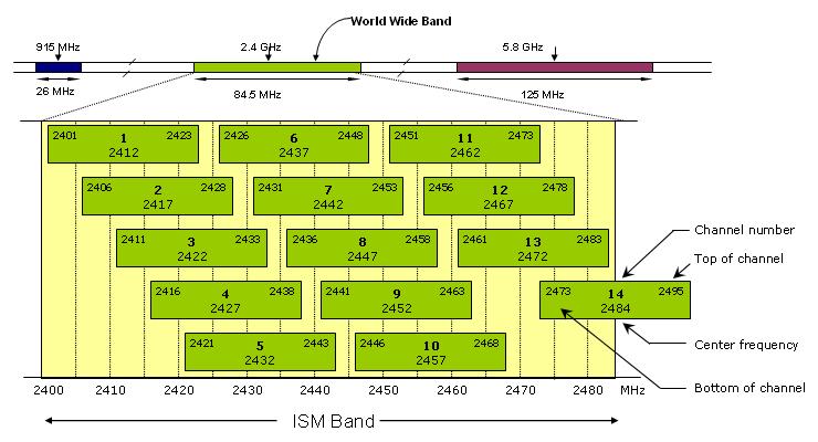

are then any other devices connecting to the network via wireless, as if you set it on say b/g/n and a b client connects it will use .11b rather than n which would give you 11mbps which is about 4-5mbps throughput.
Also keep it away from any other radio devices like next doors ap or your car if it uses wireless key entrance etc or has fancy alarm system even wireless mouse and keyboard could affect it. .11n 2.4ghz and 5ghz both run at the same speed just as it bonds channels together its harder to find availble channels so this is the reason for .11n being able to use 5ghz.
Also when picking channels its better to be on the same channel as other aps raher than one either side of it. In a perfect world you would be on channel 1, neigbour 1 would be on channel 6 and neighbour 2 would be on channel 11 but this is harder to do when using .11n as it would use the whole of 1 to 6 for example which is a bugger.
At the end of the day unless you are doing huge data transfer on your internal network it doesnt really matter as you will just hit a bottle neck at your router.
Just a few things to keep in mind :rasp:
Image of 2.4 wifi channels vv
