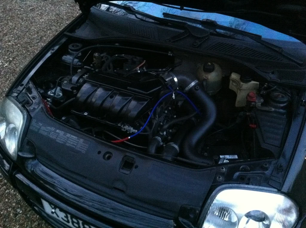

Hi, my 182 has killed a cam belt and bent the valves, A mate had a 197 head in his shed so it is now sat in my garage, does anyone now if it will fit and will it make it 400bhp or am i just making a monster job for nothing?
Toooooooo serious. No, just because i have been given a free head I wonderd if it was possable. I thought it might save me some money and get me a couple more BHP
It will change you compression ratio, plus I think your need to drill a hole to put a stud in for a pulley at the timing end. Search it the chaps that took over jms used a 197 head for a turbo conversion. Hope this help.
It will give you a few extra bhp but won't really warrant the effort involved to just do that as a modification on it own, as said above one of the main factors is that it lowers your compression ratio considerably so it's ideal for a SC/Turbo conversion.
