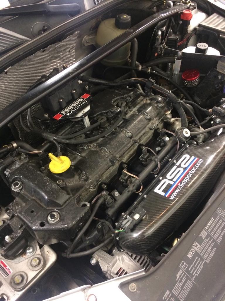

I’ve had my Clio 13yrs N/a had RS2 and now ITB’s and it’s a track car and I can honestly say it’s been very reliable and strong .
I’d dread to think [emoji848] what would : could happen if I boosted it .
I would have a drive of someone else’s car and then if you really want to go ahead then I guess you will.

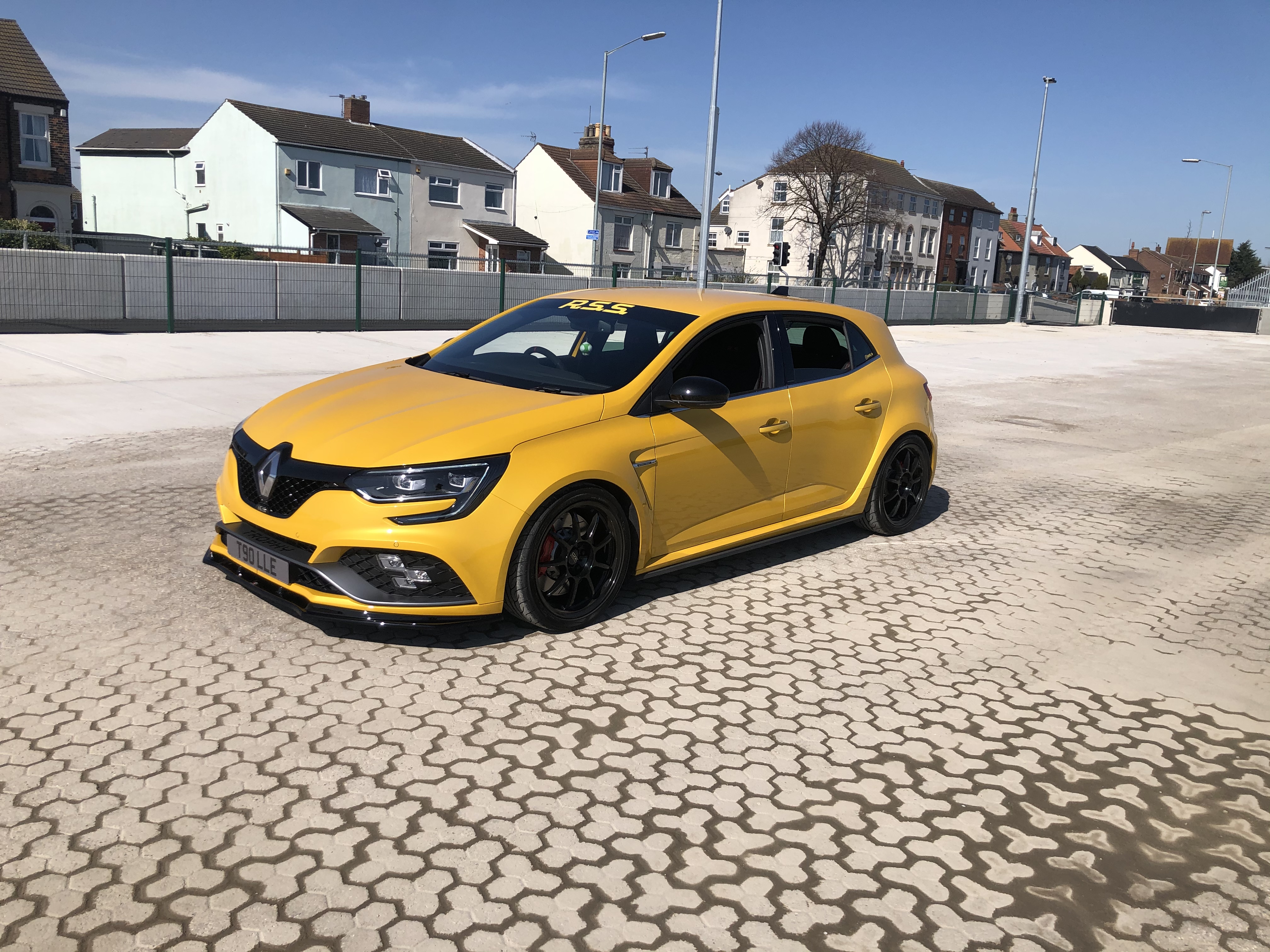

Yea I kept mine for 18months after boosting and only sold it due to needing a bigger car...
Which I’ve since sold to come to...
But an now looking for another 1*2 to build and boost along side the meg 🤦🏻‍♂️
