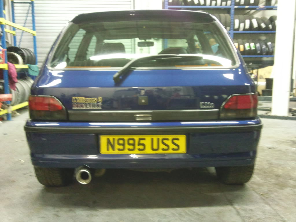

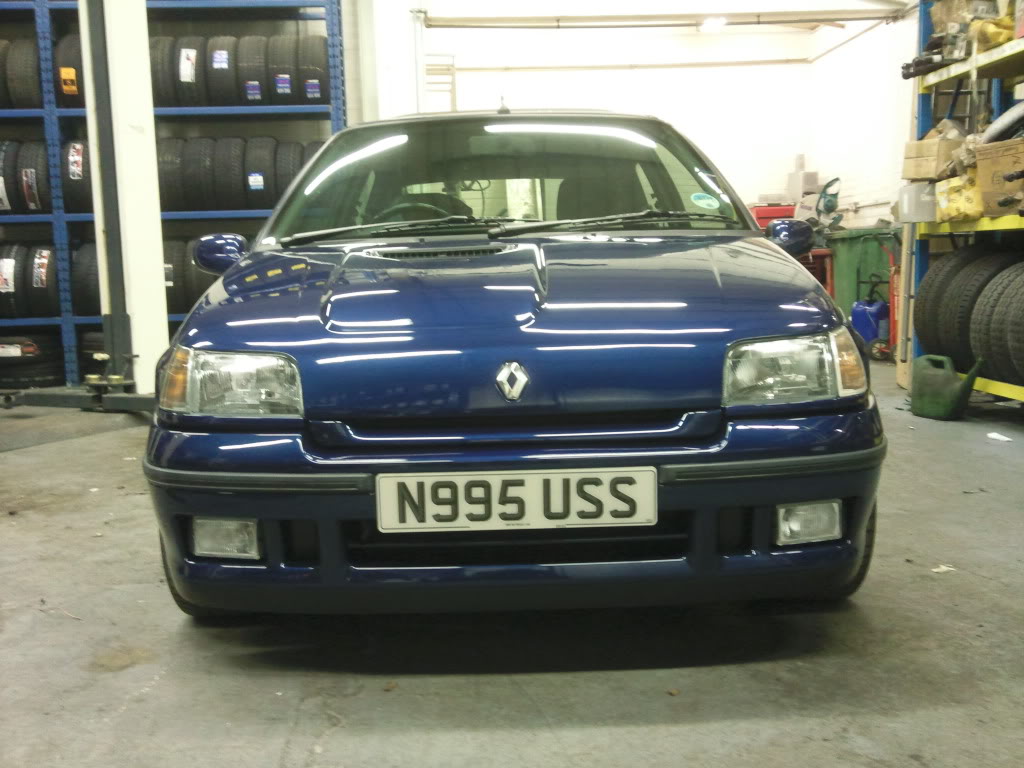

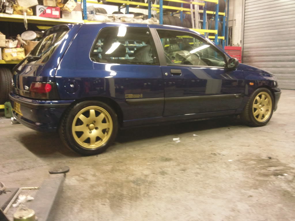

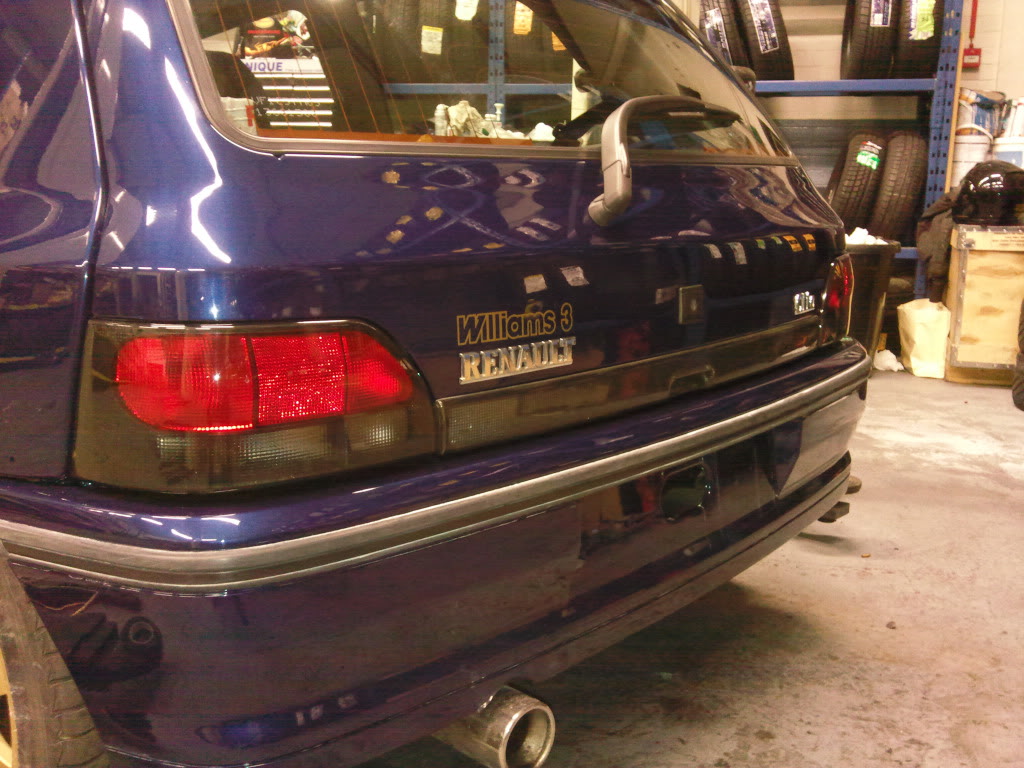

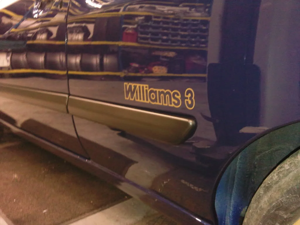

i got the tailgate fitted up, and the side mouldings on
Daz.
  Clio 200 RS EDC
You've officially entered my "I like you" list :)
(I love you list requires a wheel refurb/polished lip and removal of that exhaust for something more standard looking ;))
Oh that i like lots !
But i agree with Daz. it needs a standard/standard looking exhaust and a wheel re furb with the polished lip for epicness.

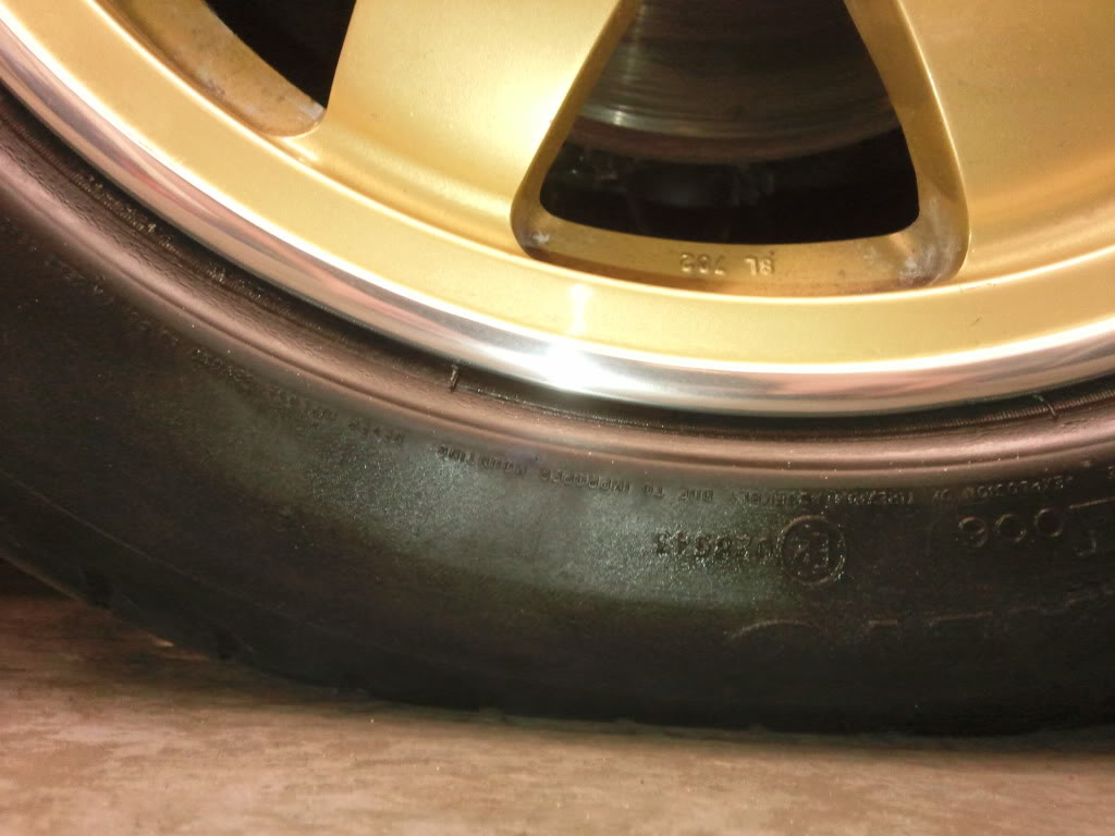

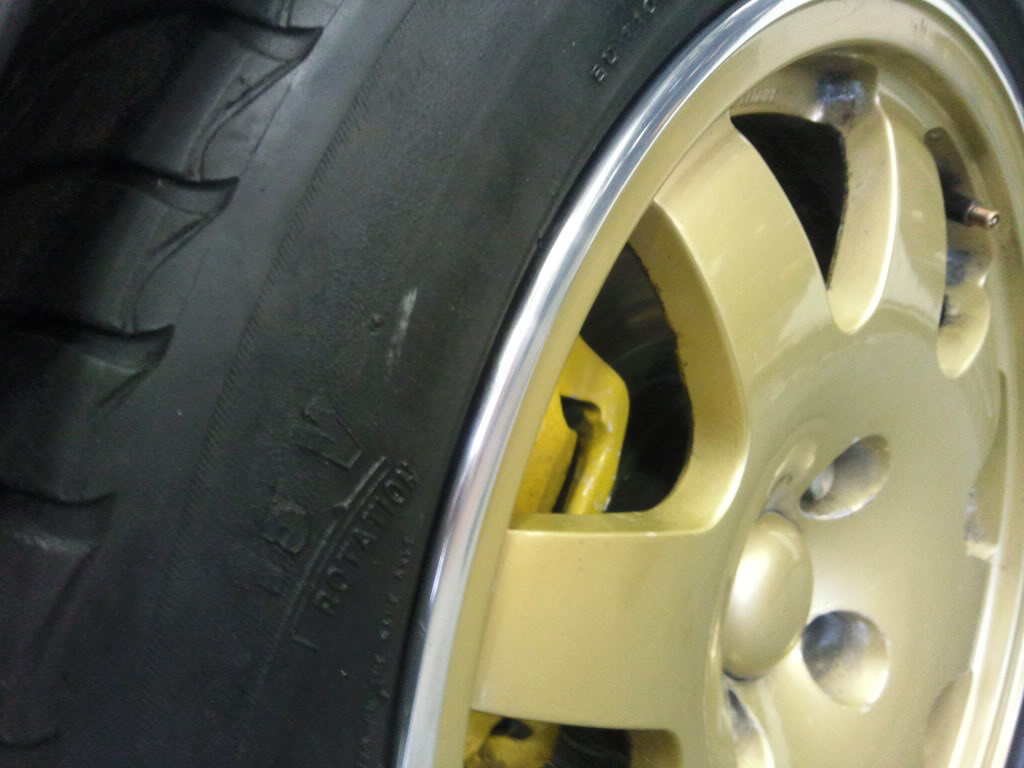

and as for the wheels and tyres, i ordered a set of conti's for it but didn't like the tread pattern so sent them back and i'm getting michelins instead!

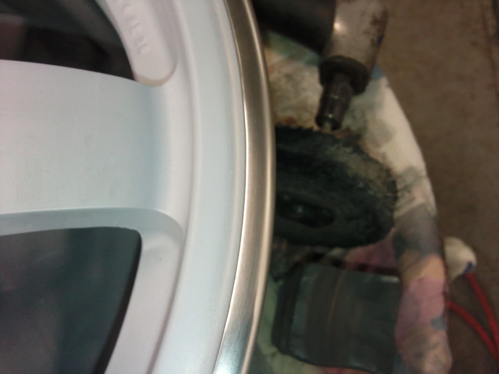

i had an hour spare today so took a tyre off and polished a rim to see how it looks, still need to paint the wheels, i just wanted to see how it looked, very subtle, but makes a big difference

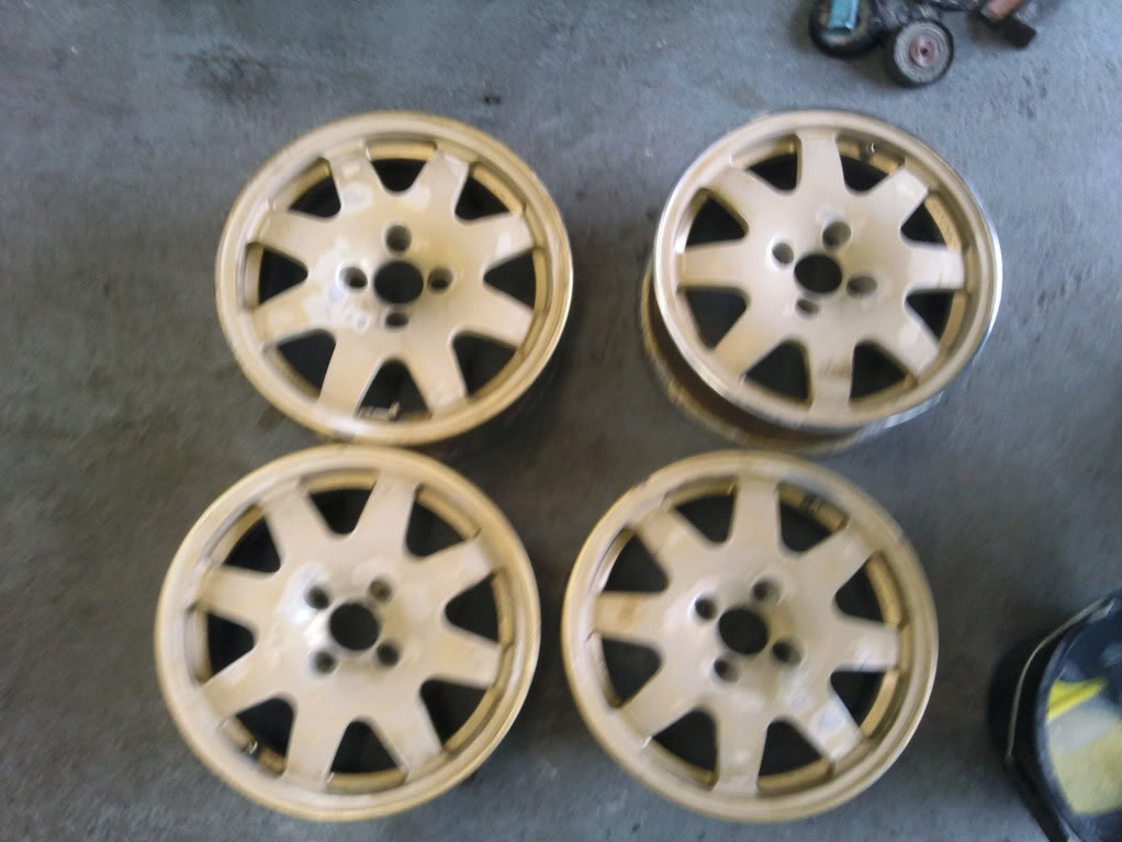

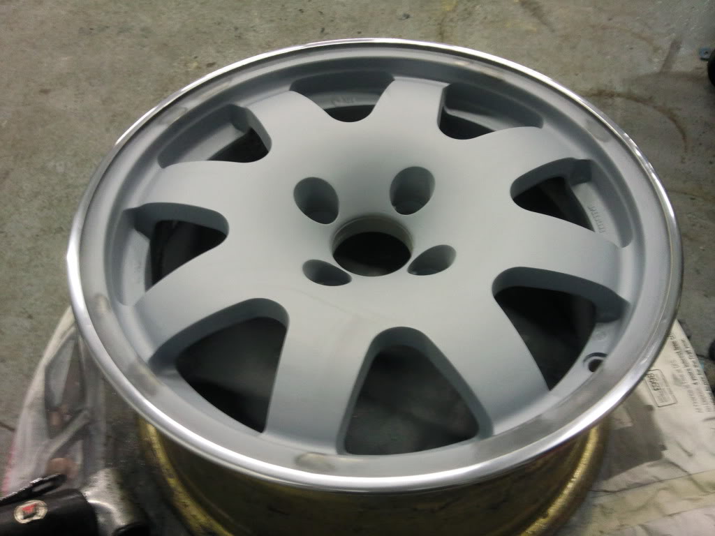

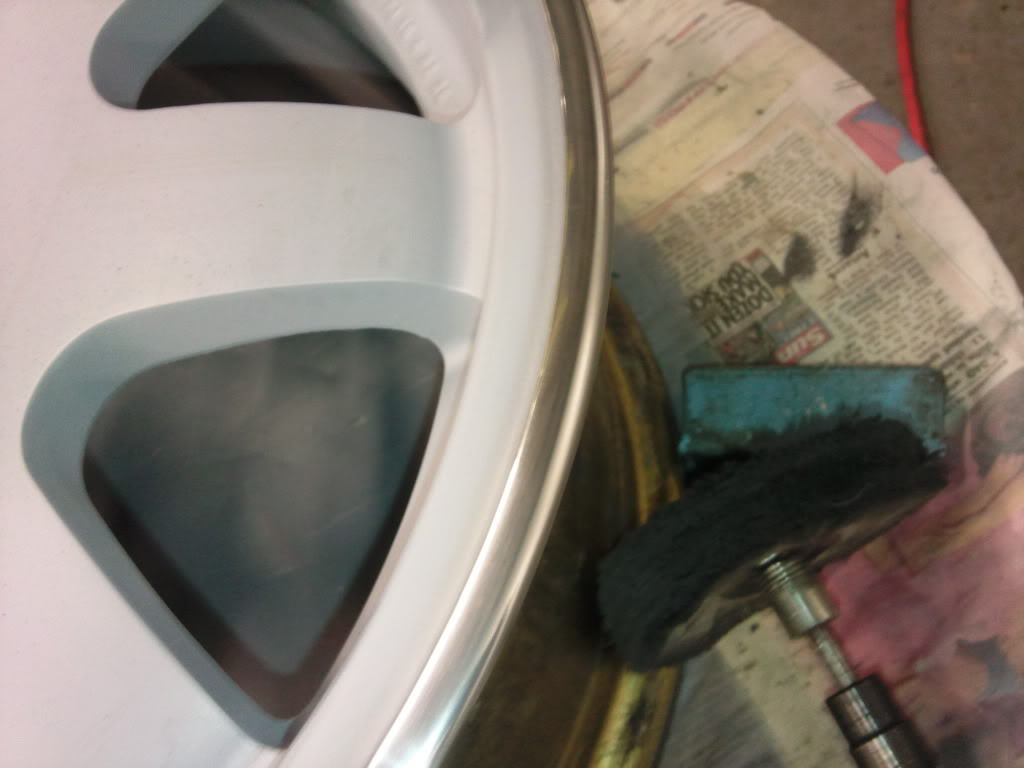

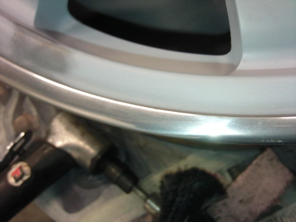

started on the wheels today, got a few pictures off the phone again, hope it don't bore you!

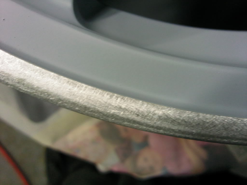

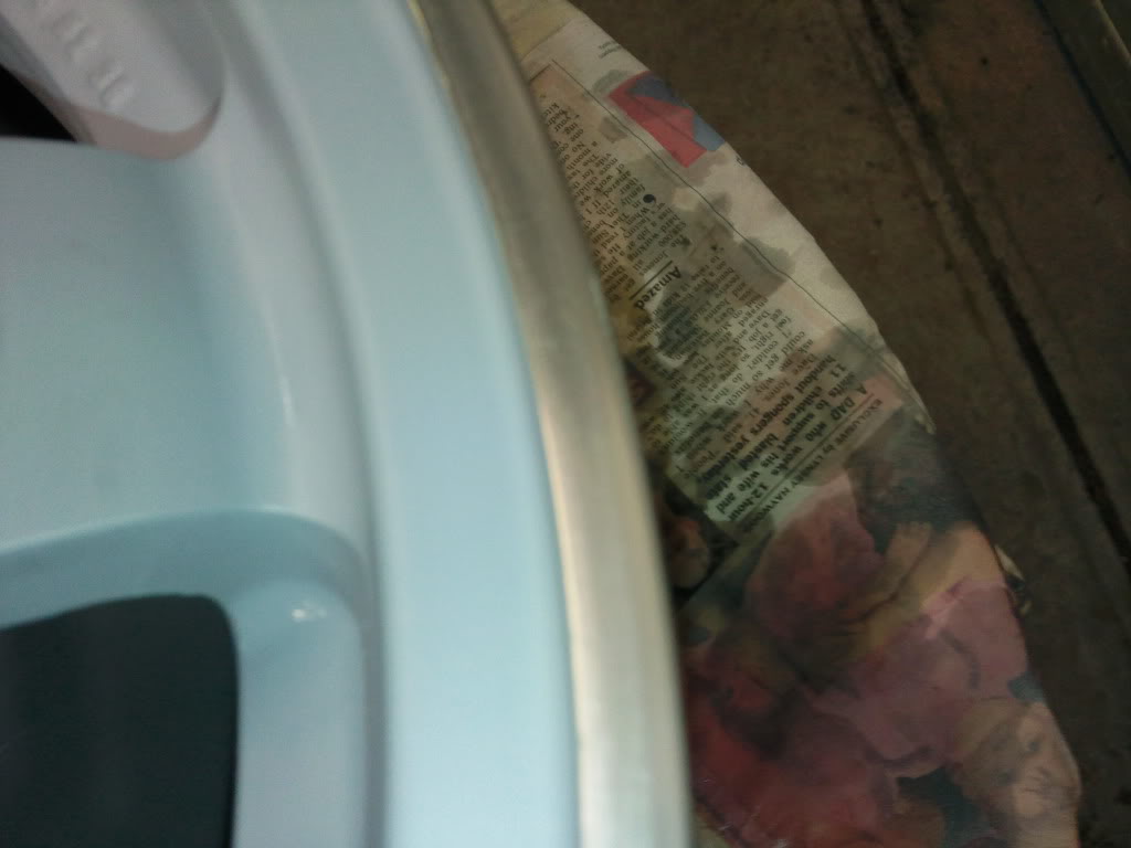

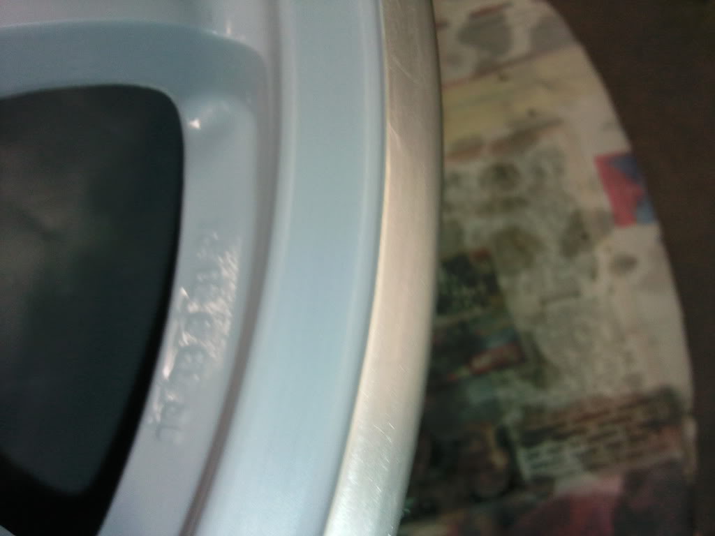

started by rubbing the wheels down with an orbital sander using 180 grit

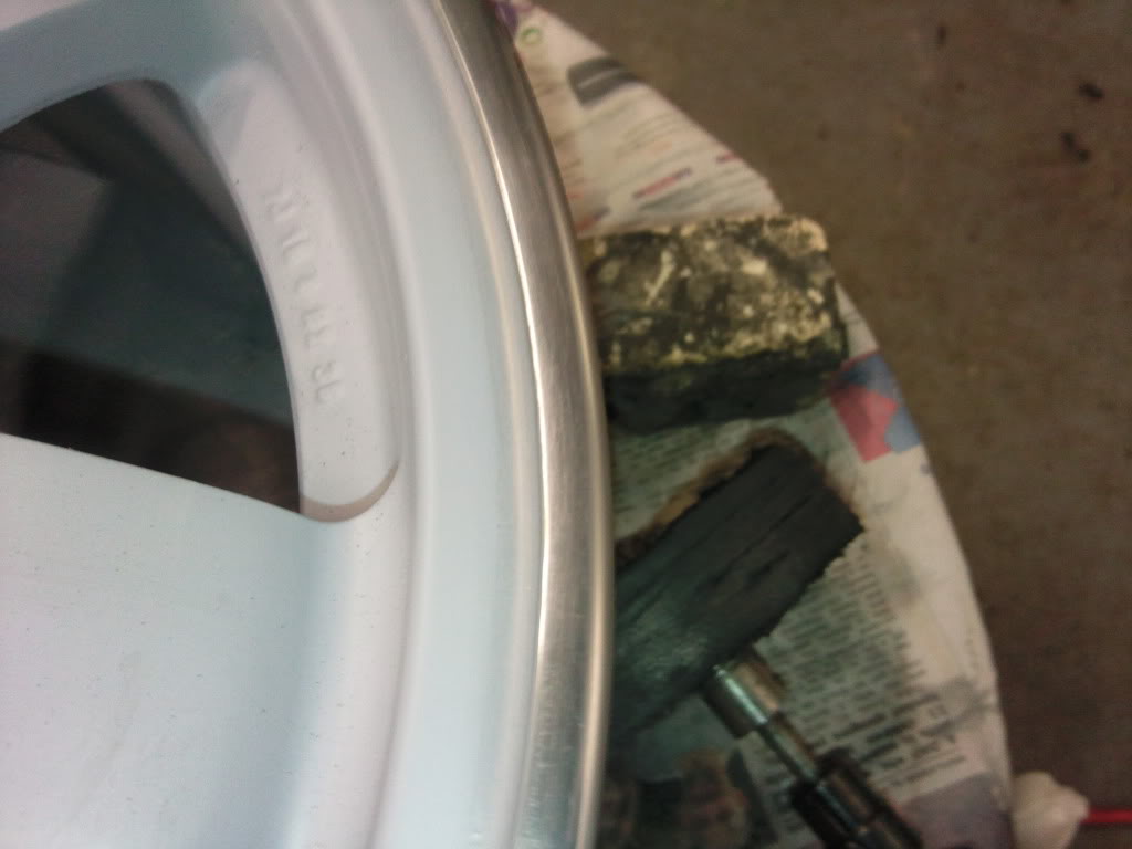

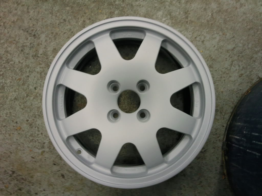

then a few coats of primer

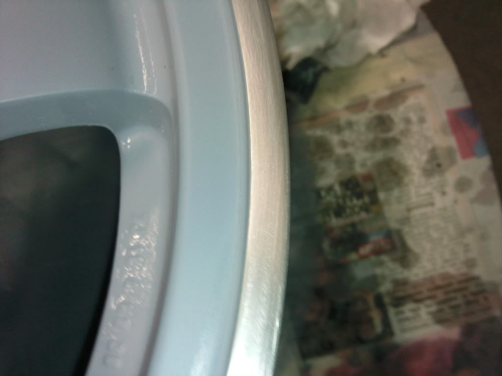

once dried went over the lip with 80 grit to get rid of the kerb marks
then 180 grit with the sander to get rid of the deep scratch's
then 240 grit wet
then 800 grit wet
last bit of wet with 2000 grit

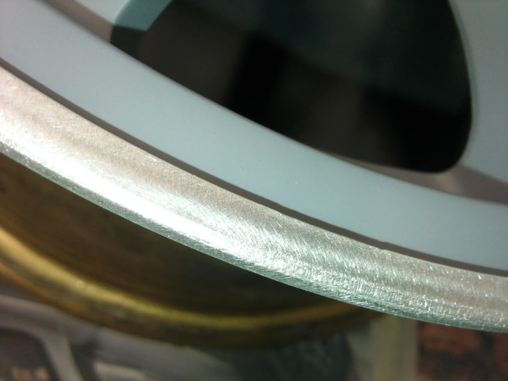

then four stages of polish
2nd stage
3rd stage
and the final stage
now just need to flat the primer with 800 grit base coat and laquar

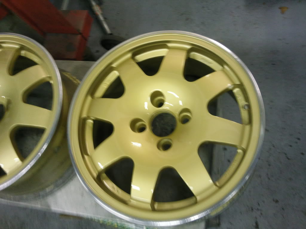

thanks guy's, and i think i have the correct colour, i'll find out tomorrow when i paint them

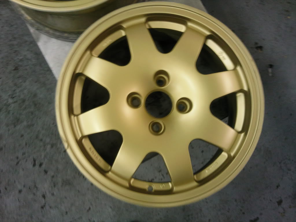

  impreza p1, williams 3

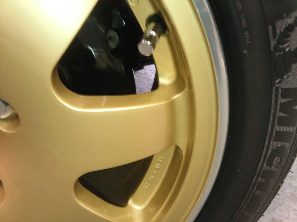

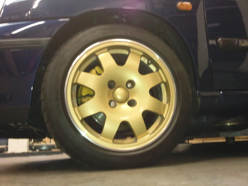

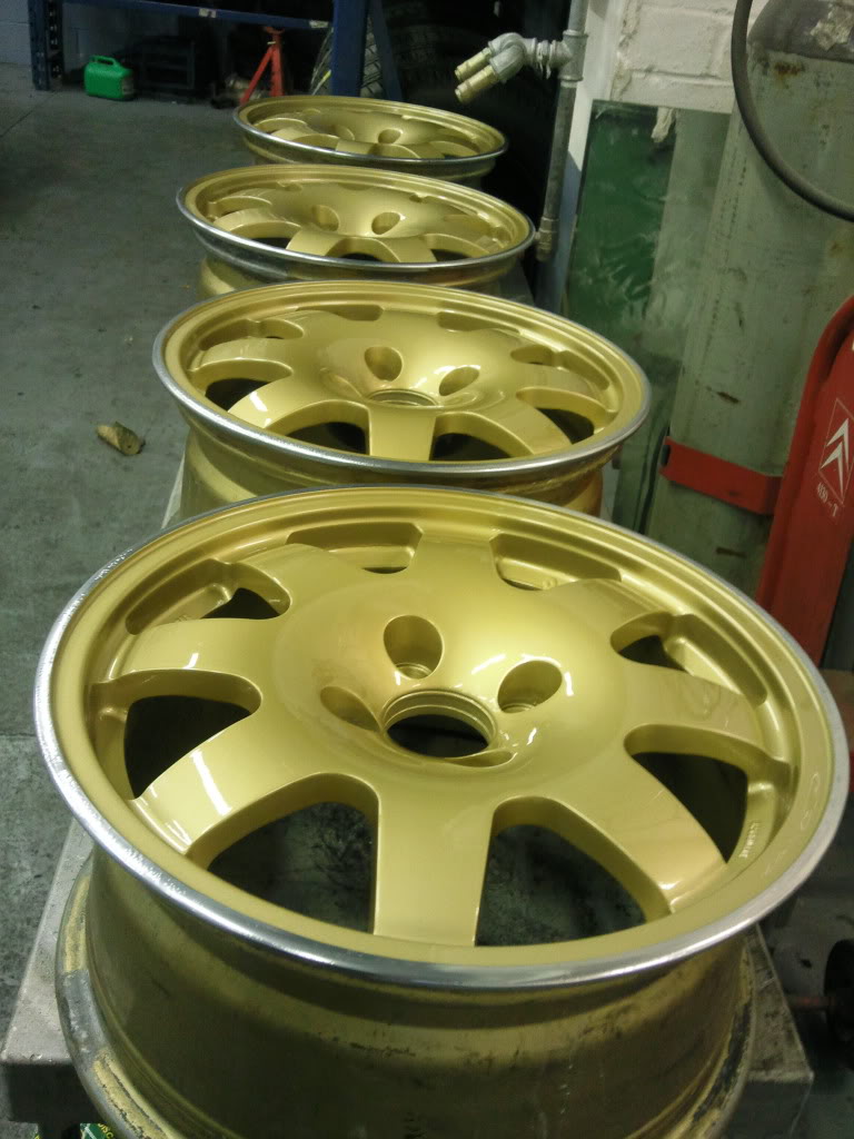

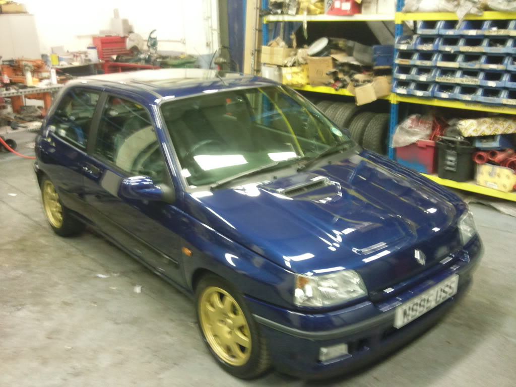

got the base coat on with the rim masked
then the laquer withe the tape removed

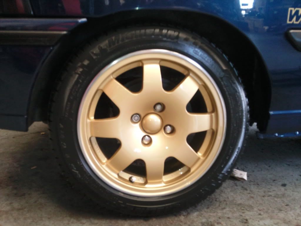

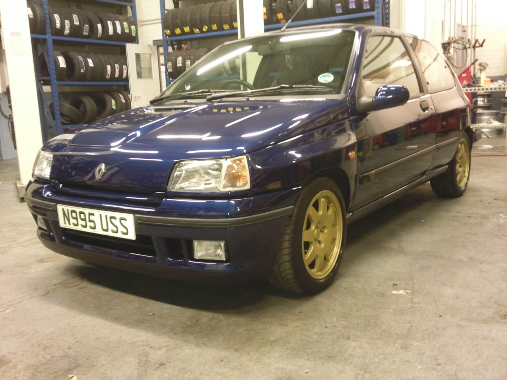

then fitted the new michelins and i put bead seal on as the rims are a bit corroded on the lips
and i painted the calipers semi gloss black as the yellow looked pants
