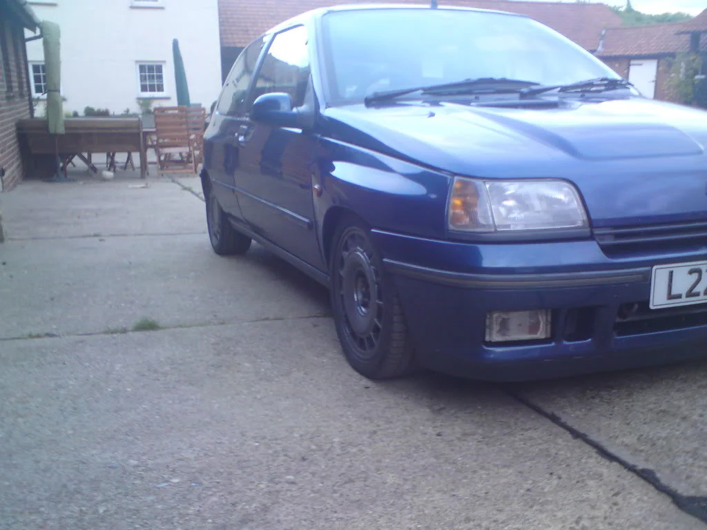

Now I wantto complete the all round of my car
It already has, polybushed ARB and wishbones. Brand new OEMtop mounts and new rear shocks
My front shocks are about 40k miles old...no leaks etc. Would I be wise to go new?
It also sits too low for my liking. Ive heard that 172 springs could fit the strut?
It sits like this...so would like tobring it up a good few MM

Its kind of put me off coilovers all together. For what I actually do with the car all I want to do is raise it a little as its a bit low for my old man ways now.
I cant be bothered to spunk another load of money on more coilies.
I like the way my standard suspension rides since i replaced the top mounts anyway. I like the comfort and trust the car. I just want springs that will raise it up a little, say 20mm, but dont want standard ride height

The actual struts from a 172 dont fit a williams. Just the springs are interchangable from memory?
The 172 and williams springs are the same iirc. the cup springs are a touch lower. They will all give a high ride height tbh
No coilover will match a Standard Williams set up for road use imo
you are correct mate the cup springs should be 5mm lower than standard springs
but the standard setup is fantastic
