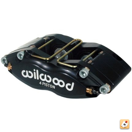

This might be a silly question, but when bleeding the wilwood 4 pot kit do you use the larger gold coloured nipple or the smaller black coloured one?
I was just a tad confused and hoped someone could help

If not then he will have to bleed the inside 1st then the outside.

Jesus, the Black is what? 6mm? Yeah I thought I was going to have to bleed the inside first then the outside.

I think its so that you dont damage the caliper, good idear tbh.
It will be 1/4 or something like that, anyway its a AF size.

Really you need 2 spanners one to hold the gold part 7/16 and a 1/4 for the nipple.
They are also a b**ch to bleed, I ended bleeding the hold reservoir. If you notice you pads wear like a wedge this means they are not bled enough.
