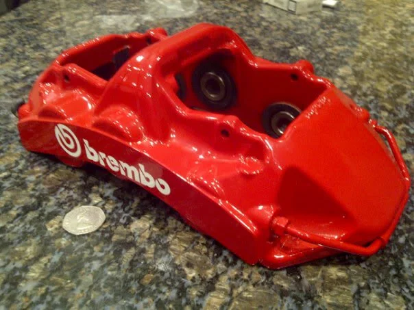

awww look at the tiny pistons
Tiny because the caliper is Huuuuuge!

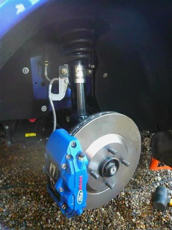

Fred are pads supposed to leave an edge around the disc?
My 4pot alcons are paired with Porsche 924 pads as alcons don't make the FRP pads anymore but I still get the ridge around the disc.
