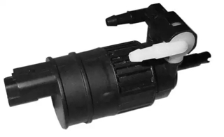

Yeah as above, the pumps are different. Should've mentioned that.
The one from the smaller bottle looks like this
The dual ones from the larger bottle have a 90 degree angled bit at the bottom where it goes into the bottle, instead of the bit going straight down on the above photo.

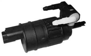

So will a 182 pump fit the cup bottle or dci bottle? If they are angled differently? I think Ive got a straight pump actually when I was given the wrong one when bought from GSF car parts win win!!
Nah they wouldn't fit each other. With the dci/cup/non sport/whatever bottle the pump slots down into the bottle, whereas with the larger dual pump bottle the pump sort of pushes into it from the back. It'll make sense if you see them both, but they won't fit each other. You should be fine if you've got a straight down one though.
A car with zenons has a twin pump bottle (which is a bigger bigger than one without zenons) yeah the pump's are different.
What's annoying, is people who say for a regular 172 etc, but show the above pic. Which isn't the right one.
