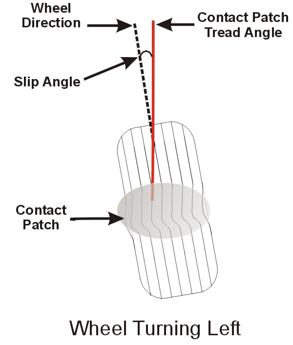

I didn't think the point of winter tyres was all about snow/ice/damp/wet conditions - as Oms clearly stated in his OP the point of them is that they work at cold temperatures whereas normal 'summer' tyres do not.
For a tyre to 'work' properly the tread has to work to turn the car as shown below...a summer tyre at low temperatures will not have the flexibility within the tread for it to do this as it should when turning hence the lower apparent lack of grip...
Makes a lot of sense to me.
