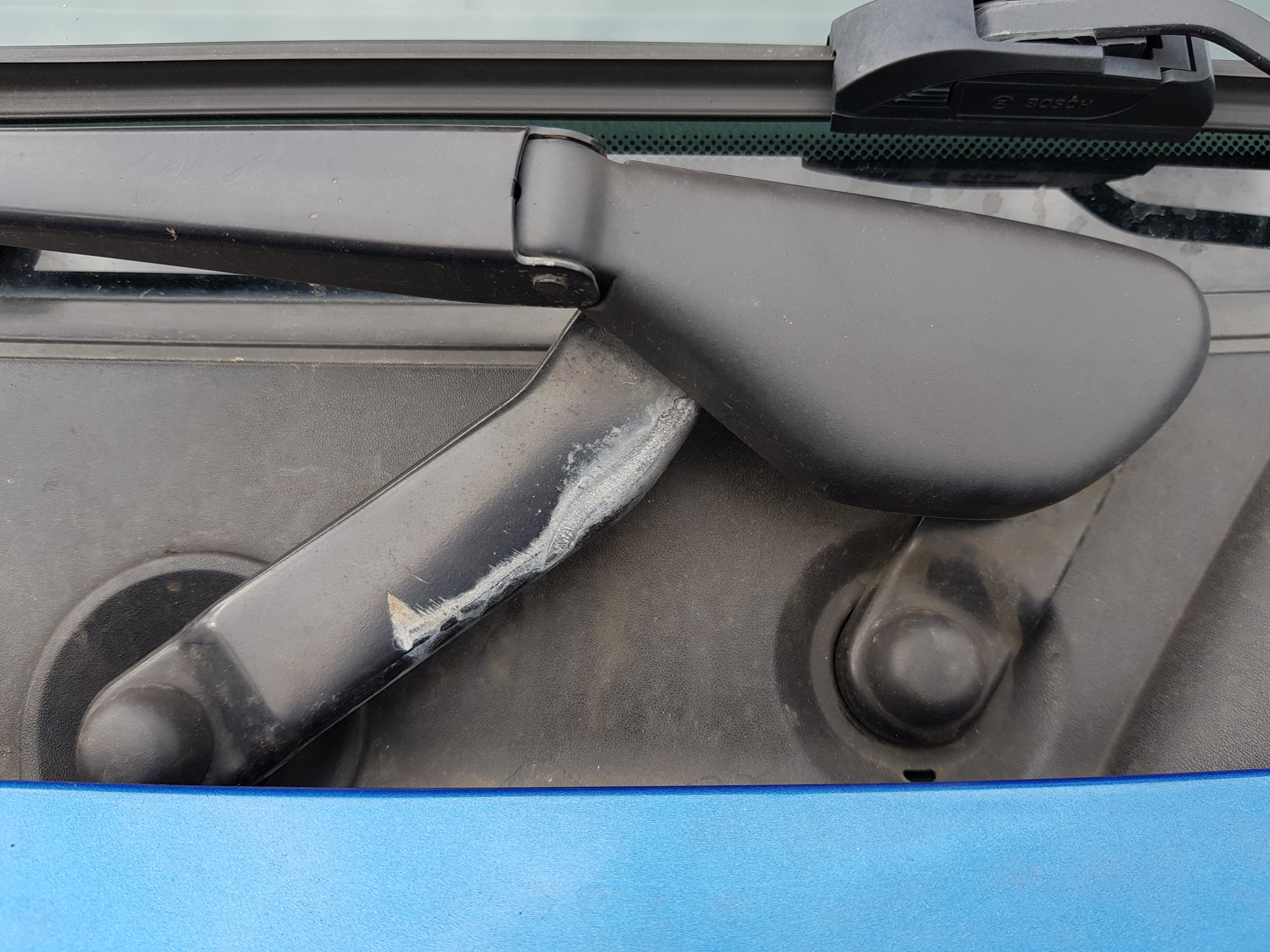

Anyone either got or had the same problem with the front wiper blade lower arms Scuffing and why?
looking to fix this and re paint them both

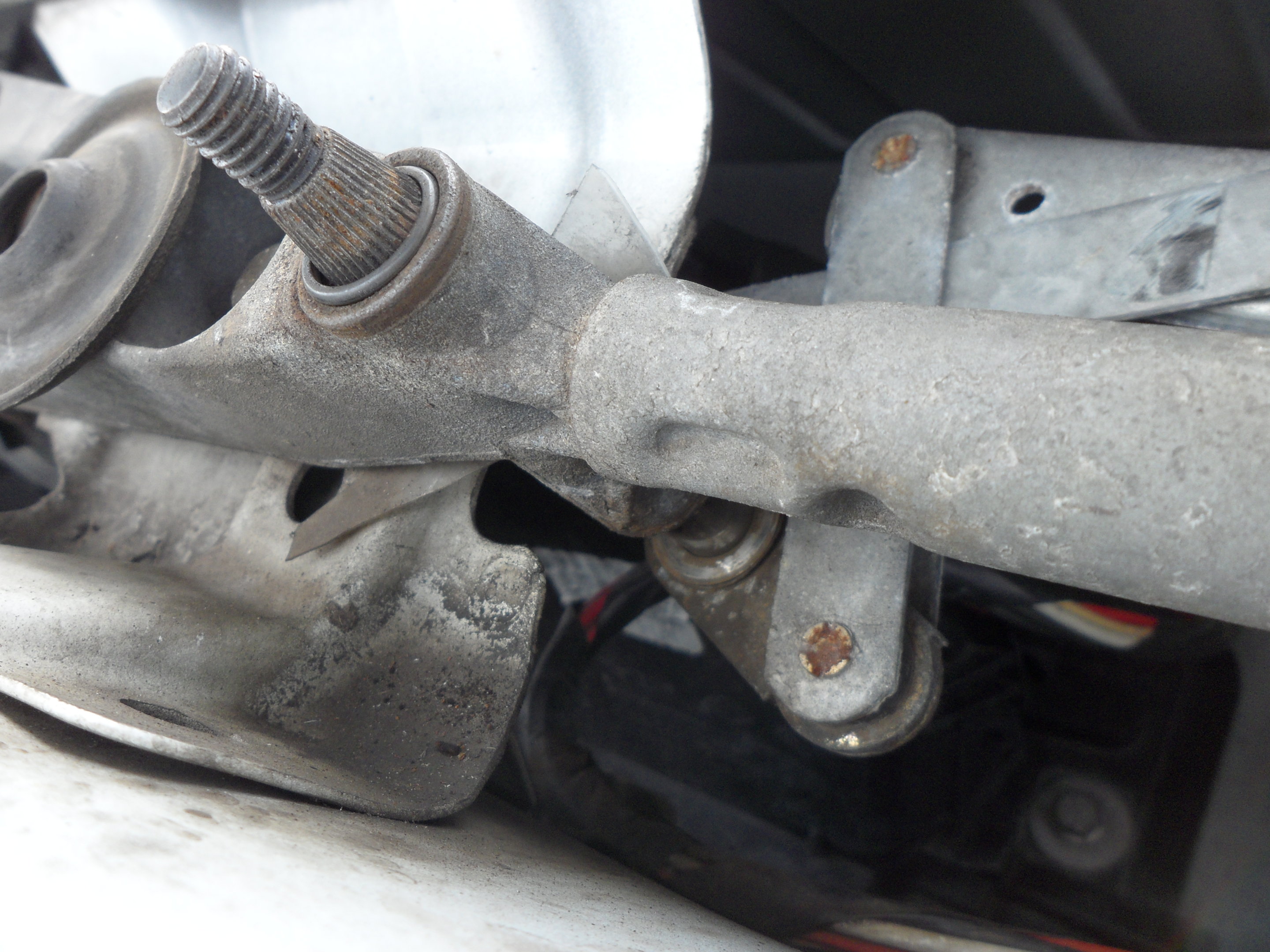

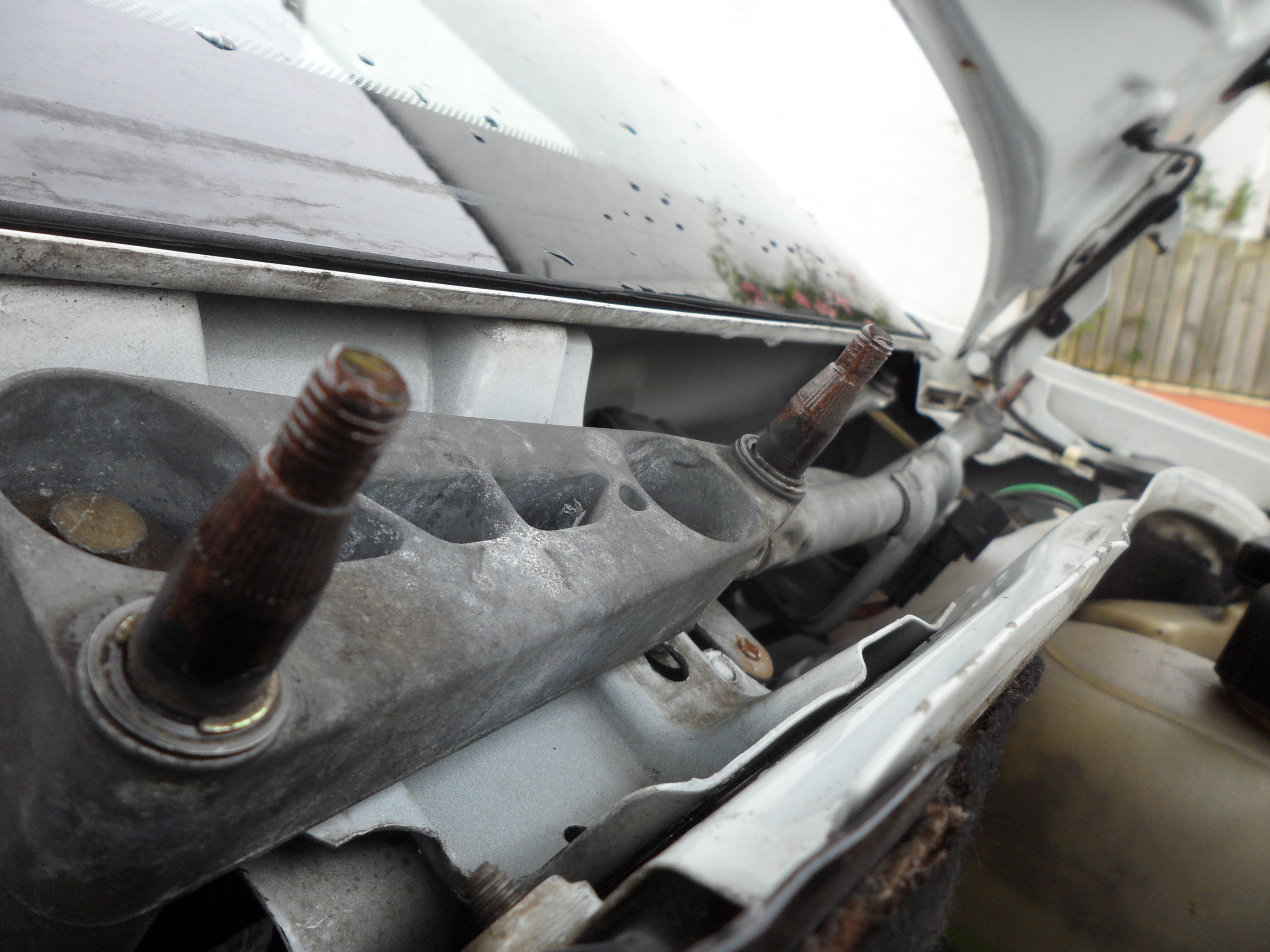

Once you have the wipers and plastic scuttle trim off, my guess is one of your circlips on the mechanism has failed. I had the same, and it makes the spindles drop and cause the rubbing you have alongside poor wiper performance of course. You want to get it sorted soon as I've seen one Clio before end up scratching the windscreen when more than one failed!

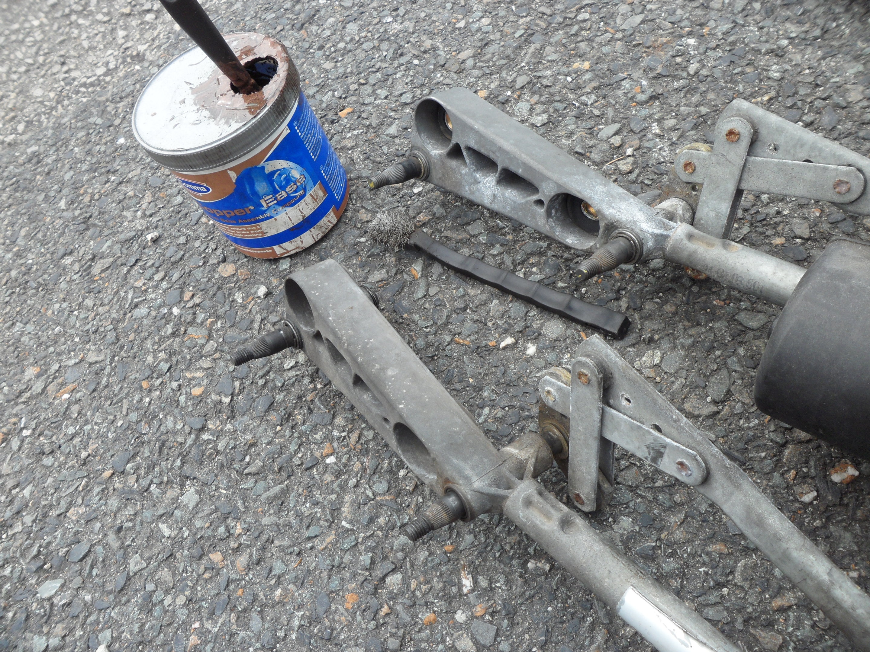

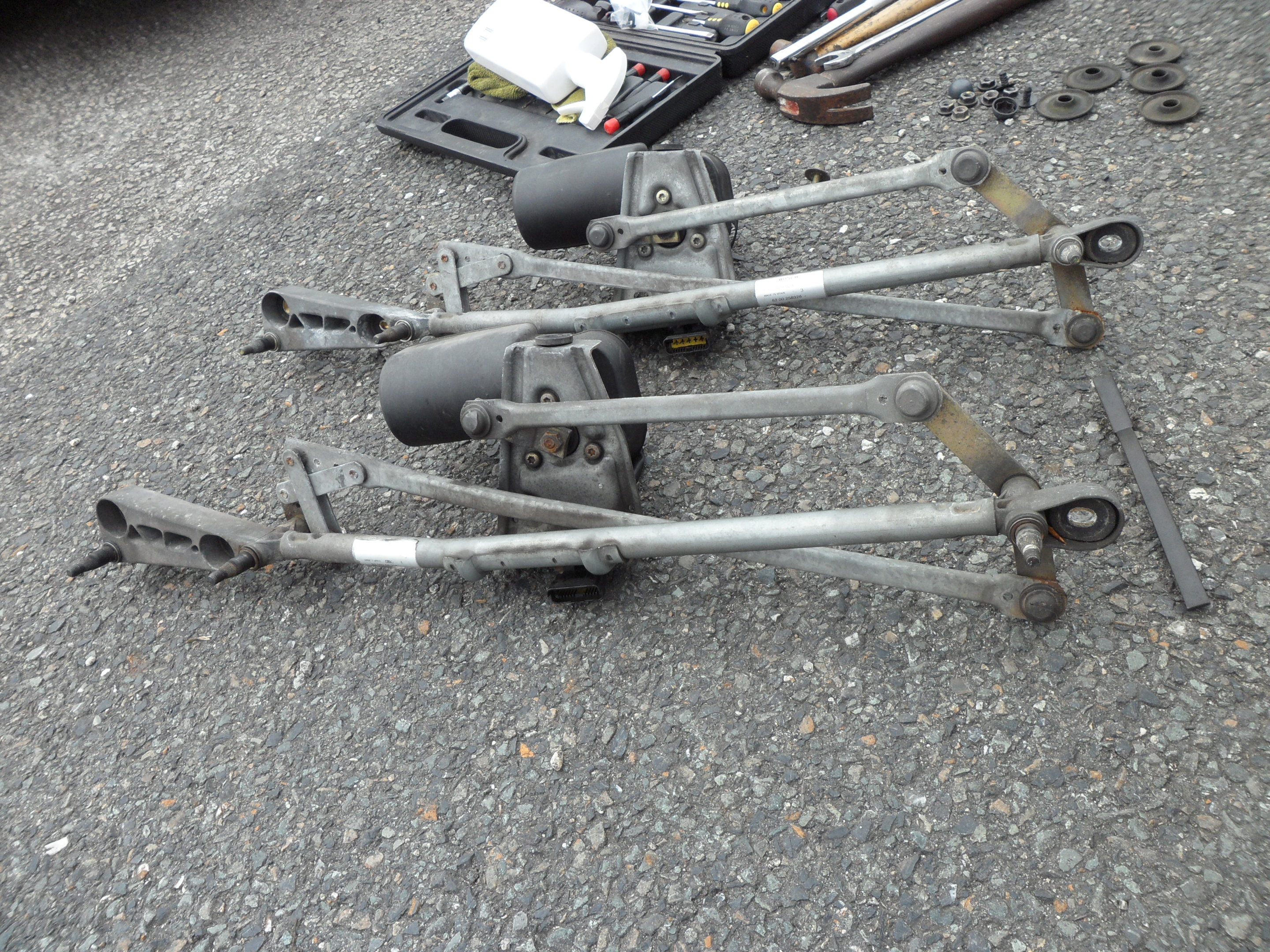

Here's some pics showing it dropped, and replacing mine (It was easier for me to get a whole replacement unit):
One easy way to check... pull on your wiper arms and see if they move in and out !
If not, then maybe the mechanism is not located properly on the pin on the body if you've taken it apart or maybe it's always done it.

I agree with Chris_Beer, when I refitted my wiper mechanism incorrectly & missed the 'infamous' peg, the wiper arm (the one scuffed in your picture) actually fouled on the windscreen, which is quite different to the issue you seem to have.

If you haven't touched it, then it will be the circlip mate. As I said try pulling the smaller one (on the right side in your picture) and I bet it moves in and out, certainly looks lower from the picture.
A circlip alone would be cheaper, but I was lazy and wanted to do the job in 5 minutes and not measure it, faff around fitting it, then discovering it was the wrong circlip, etc etc, you know it goes sometimes. The amount of cars being broken on here I bet most of them get scrapped with the units in so they will be cheap enough I would of thought :)

In my last photo, underneath where I've greased (the nut thread and the splines the wiper sits on) you can see the gold circlip. Scroll up and you'll see it missing on the first photo.
Yeah I believe they are all the same mate.
