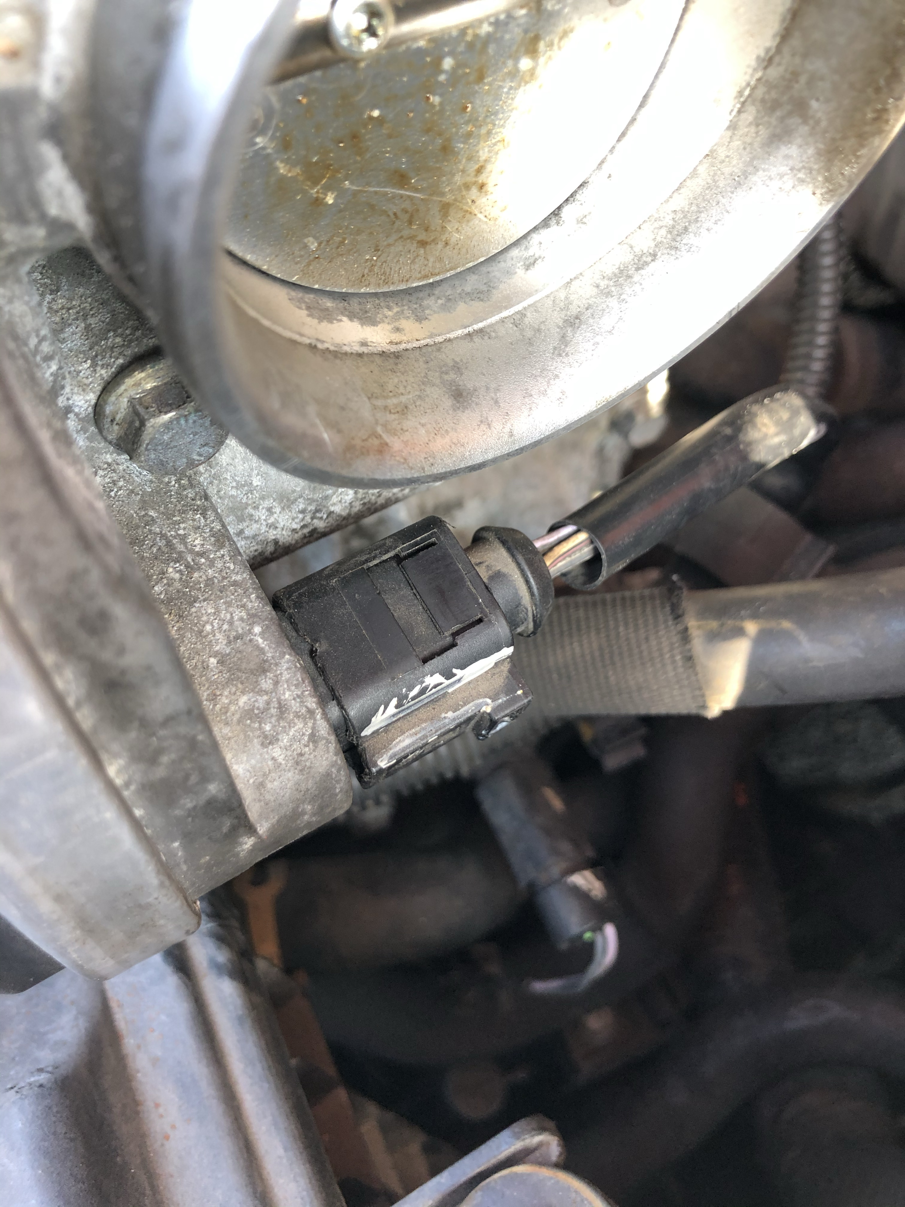

Hi does anyone know what readings from a multimeter I should be getting from the 6 wires going to the throttle body?
Reason I’m asking is I did a track day yesterday, car was faultless all day, drive 20 minutes home. Left it idle for 30-45 minutes. Jumped into move it and now it just cranks and won’t fire. And I’m getting throttle faults.
That is in the back of my mind. It played up about 2 months ago and all I did was unplug the body itself. Start it and plug it back in and it’s been fine since. Which is why I want to check that c

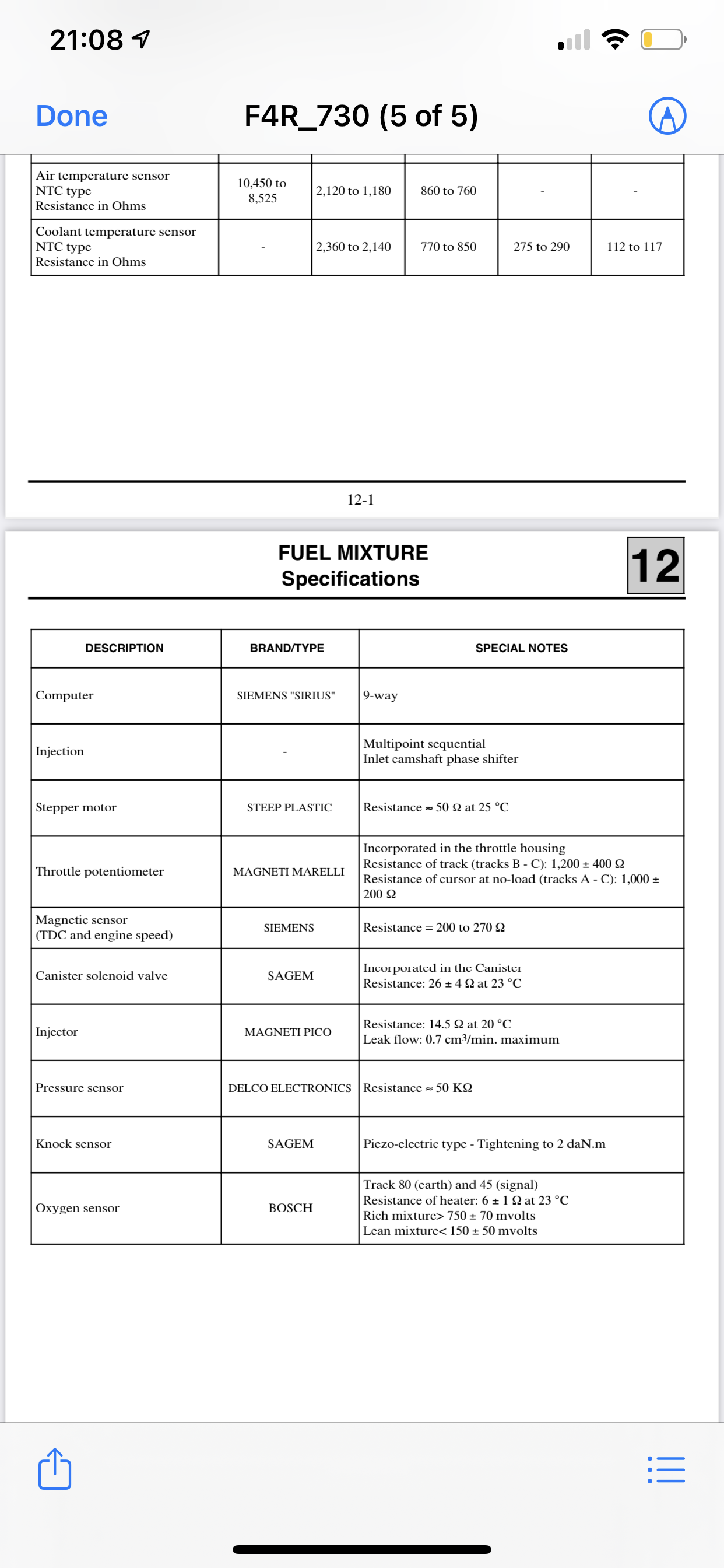

Here you go.
It would be rare for the peddle to go, if it’s the cup model then a wiring fault is quite common but you should be able to trace that with a meter.

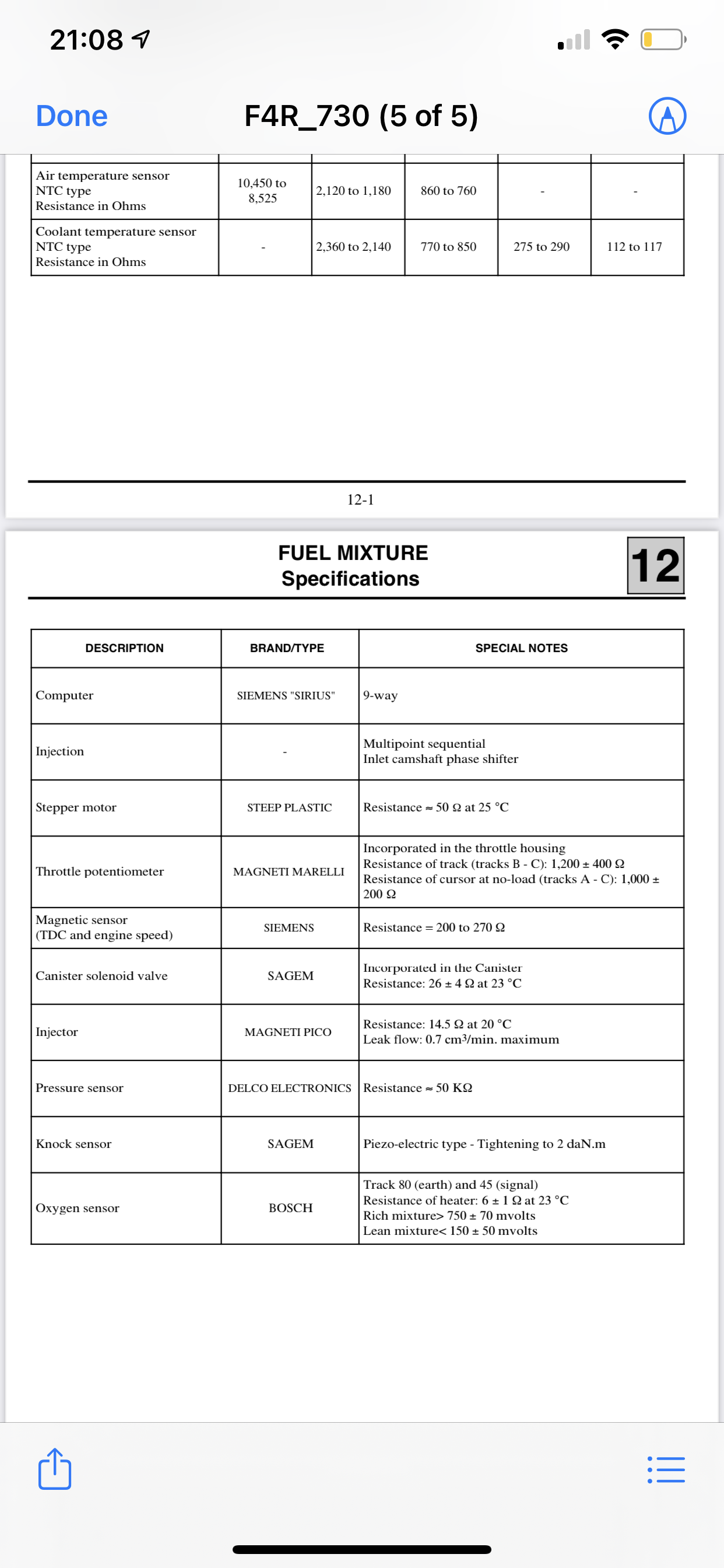

Here you go.
Brilliant thank you for that.
