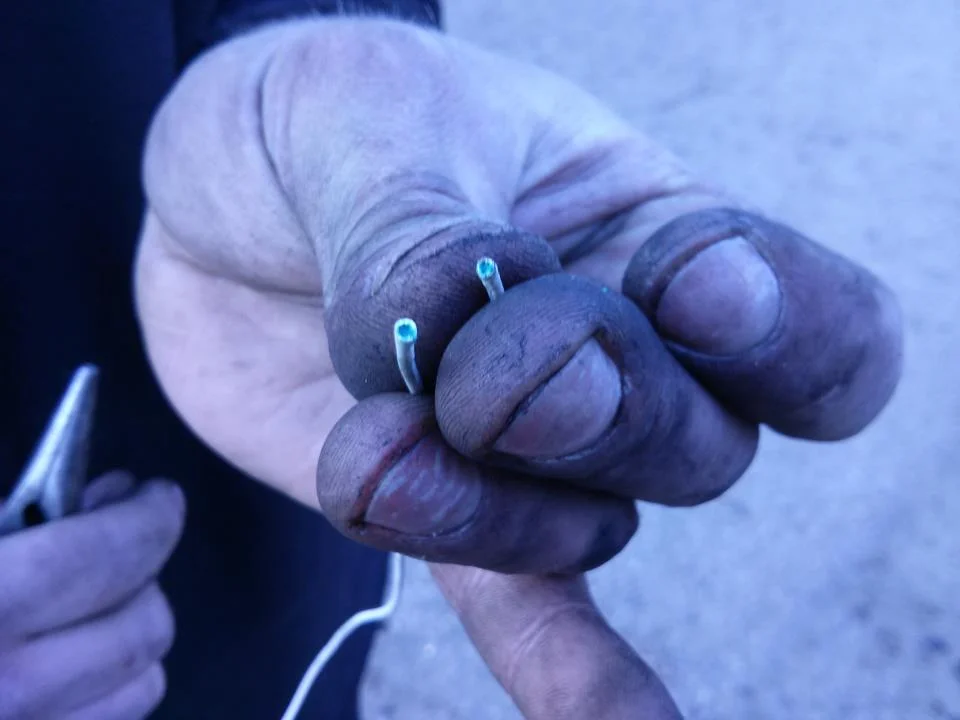

bet its the same thing we found recently. white wire goes from the ECU, down and along the front of the battery tray (inside the loom), up and into the relay box to one of the 3 brown or black relays (main power relay). Found corrosion pretty much the whole length of the wire.
What were the symptoms on that particular car Dan?
