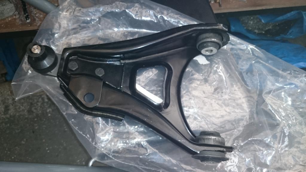

Andy_con
  clio 182
heres the one ive got
it cost me £30 and it does take a 12mm bolt

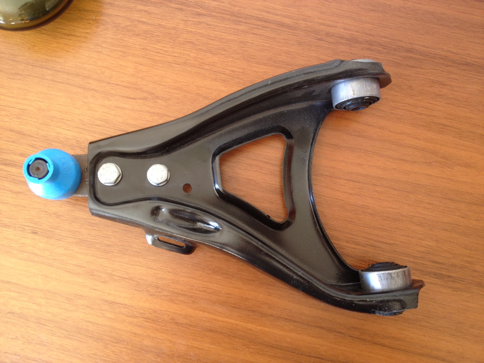

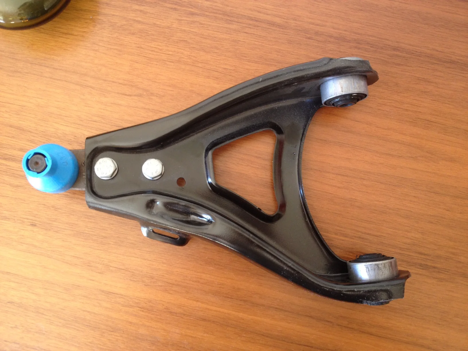

  Iceberg 172
That's not the correct type for a 182, the ARB mounting is incorrect.
Here is a picture of the correct n/s bottom arm for comparison.
  FF Clio 182
The one in the top pic isn't even for a clio. That wishbone it to take drop links but clios don't have them ....
