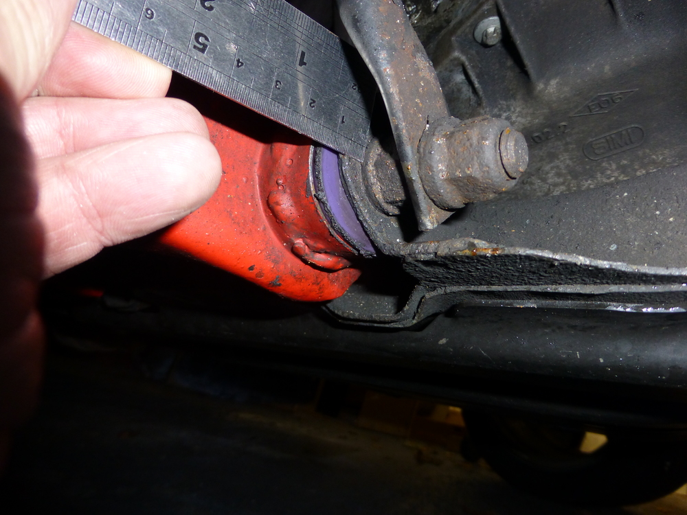

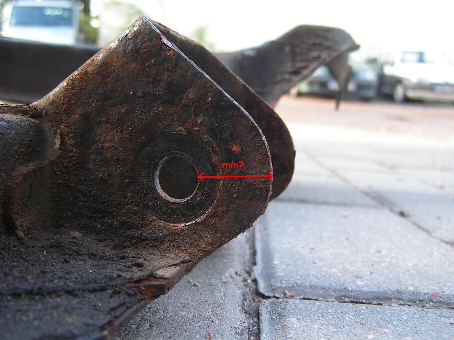

If we could get all measurements in the same format that would make it even eaiser. If they could be measured according to the picture below that would be ideal.

- 51 12mm
- 03 12mm
- 03 12mm
- 53 12mm
172 cup
182
182 cup suspension pack
182 cup
Trophy

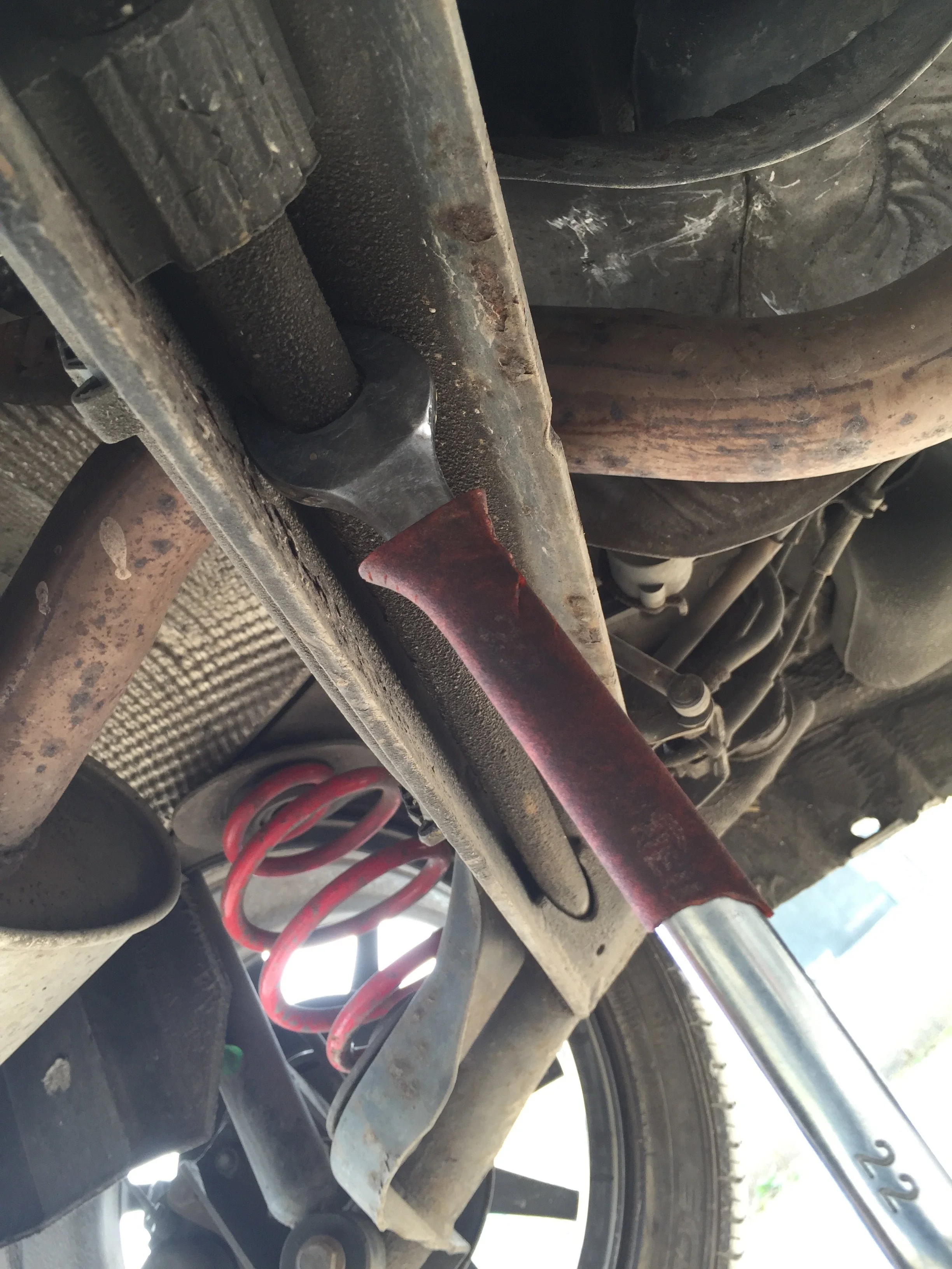

You can see in the pic below the rear arb and the easiest way to measure them.
Ph1
Ph2 172
- 51 22mm
- 03 22mm
- 03 22mm
- 53 22mm
172 cup
182
182 with cup suspension pack
182 cup
Trophy

Some 182s come with a bigger rear arb of 24mm as a posed to the 22mm found on the ph2 172s. I would guess that this lager arb was part of the cup pack suspension and obviously on the cup cars as well.

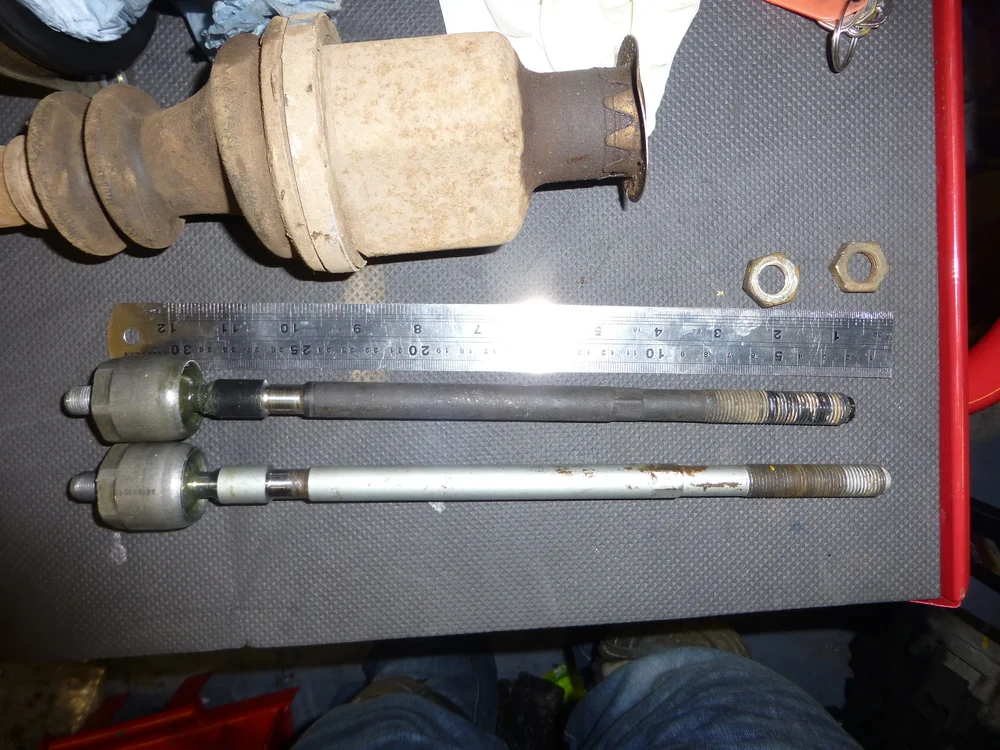

172 cups have wider drilled subframes, longest shafts and inner tie rods on any 1*2 model.

I've got a 182 cup rear beam with the larger diameter rear arb fitted so I can compare it to the original that's on my cup if you want mate.
Likewise had meant to compare the evo00/evo04 cup car rear beams I have - was sure they were 22mm as stated in the build manual but wouldn't rule out that being a typo. :expressionless:
CJM's figures seem to factor this, but pretty sure the 10mm difference he quoted per side should be attributed to 5mm for the wheel offset and 5mm for the subframe. The later Cup car subframe is the same as the evo04 uniball carriers are 5mm shorter to account for the pivot being further outboard.
  Cup In bits

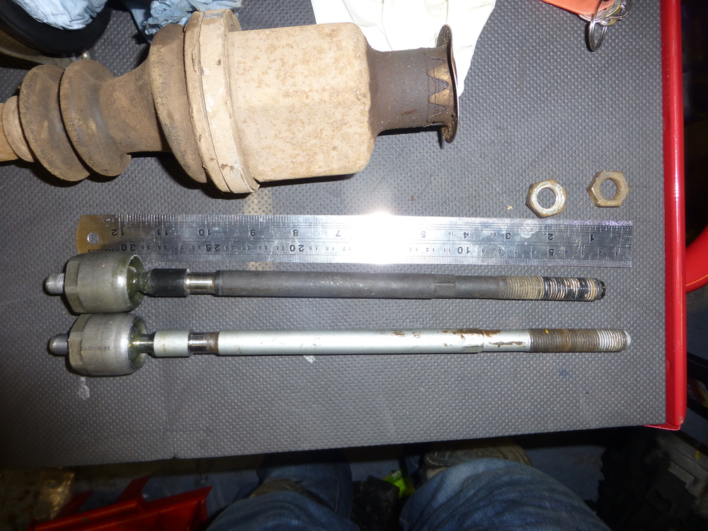

I'm not going to lie, I know very little about what is what on the different evolutions of cup racer @p@blo but I do know there is a lot more than 5mm per side of difference in the drillings on the subframe holes between 172 ph1 and 172 cup.
There was a thread on here last year where Mark182 posted pictures of different hole drillings and inner track rods/tie rods.

Just checked now and it is a typo in the manual. The later beam with the reinforcement is 24mm dia bar compared to 22mm on the earlier variant as @CJM had suggested.

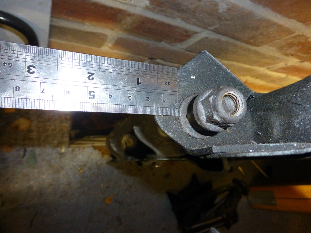

Cheers @mark123, is that around 10mm further outboard on the 172 cup s/frame? Are they both the same height?
Curious about the actual difference in trackwidth now with the two lengths of uniball holders & different wheel offsets. Will have a look over the weekend.
This one?
ph1 versus 172 cup (longer)
I also measured the door glass thickness and the 172 cup was about 1-2mm thinner than my 182 FF :)
My 182 FF also had the wish bones with increased castor and the subframe was the same as my 172 cup i.e. holes drilled further out.

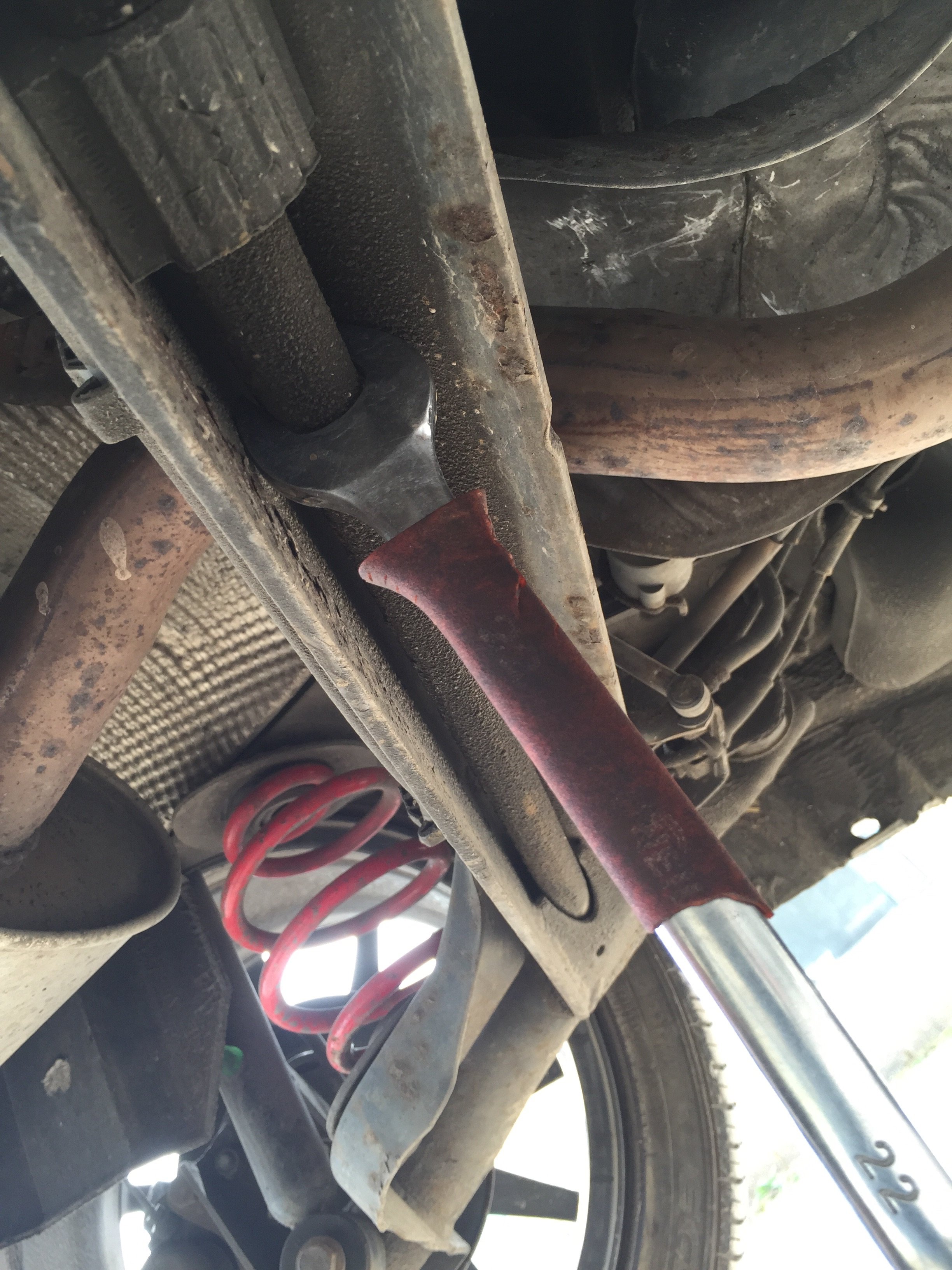

I’ve bought a 2nd rear beam off a 182ff to refesh and fit to my 172. Is there any issue doing this? It appears to have the 24mm arb too
YorkshireKyle
Not all gingers stink of piss. But I do.
Don't they all have the same rear arb thickness?
The only differences I've ever seen is that some 182 FF came with strengthening gussets under the spring perches
497adam
  clio 172 phase 2
Reading back in this thread some had a 24mm rear arb. This beam has a 24mm one best I can get the verniers in
497adam
  clio 172 phase 2
But I thought it was 182 cup that had it not the 182 cup packed cars?
