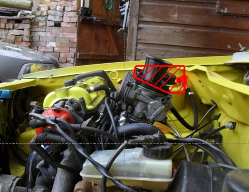

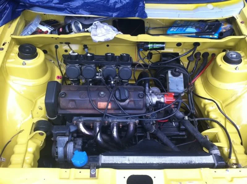

basically on the old golf i have not alot of room for filters on the bike carbs untill i get the manifold modified, to put the usual filter socks on the trumpet stumps is going to severely limit the air to the carbs. i seem to remember that carbs work better with air flowing better acorss them rather than directly into them.. i might have made that up. so i was thinking of fabricating something like
with some ducting then something like a cone filter behind the grill?
this is the carbs so the box would have to sit at an angle not nice n straight like the box above
God knows how you will get a filter on that, no chance of tilting the engine back?

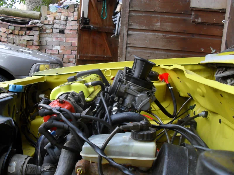

no it needs teh manifold modifying to bring it more in line, but i cant have that done for a while yet so need to work something out for now. the current carbs trumpets are like this
the box would go like this

these have never been run with full trumpets prevously so that doesnt worry me too much untill the manifold is changed.. as for butchering the bonnet on a mk1 golf.. no ta haha,
it'll be pretty rubbish without the trumpets, but shallow sausage filters are available that I think would fit
make your life easier, and mod the manifold straight away. It'll save you a world of headaches

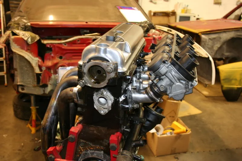

trouble you've got is, you've chosen carbs. They have to be angled like that for the float chambers to sit correctly
bit extreme, but can you not make some spacers etc and lower the engine in the bay by a few inches, i'm sure you're not as low as winston!
no they are at the complete wrong angle as it stands now, they are ment to be as close to horizontal as possible but bog bros insist that they are fine at this angle and they are the specialist so i belive them, i just dont think they accounted for the angle at which the engine sits in the bay
