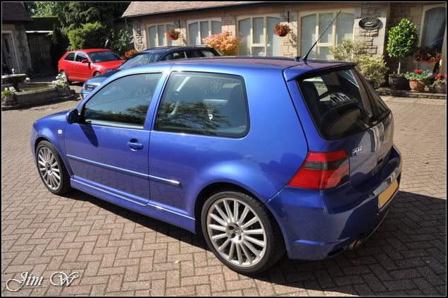

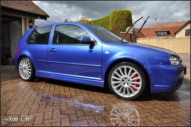

First up, the Golf R32.
Volkswagen Golf R32 mkiv – Deep Blue Pearl
A customer that I had done some work for in the past phoned through early June to see about sorting their R32 in readiness for GTI International 2011 this weekend at Bruntingthorpe.
Pushed for time before the show, I managed to shuffle a few jobs around last weekend to give a two day window for the job to go ahead.
Two day Major Paint Correction Detail.

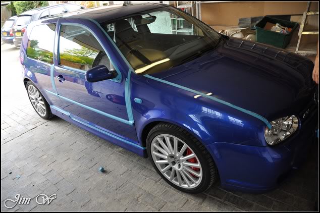

Now, if the mkiv R32 that Jonny (Pure Detail) and I worked on earlier this year was anything to go by, it’s going to be a long two days!
The sun was beaming down – no photos throughout the wash stages I am afraid other than a few wheels and contamination shots…

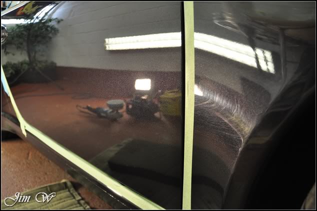

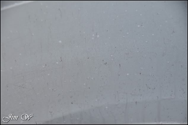

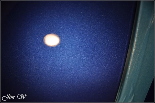

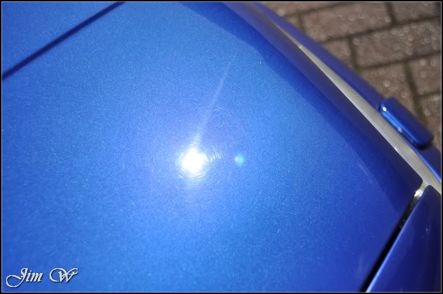

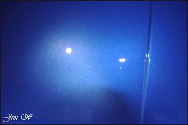

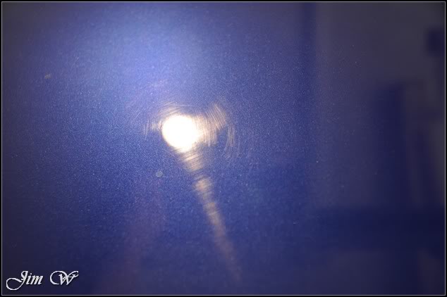

OK, so, clean, dry and inside. The first thing I notice is the finish on the roof:

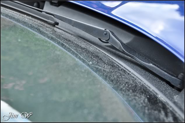

One or two areas on the car had seen paint.

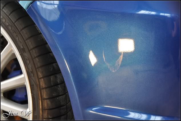

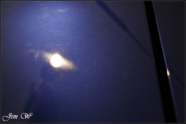

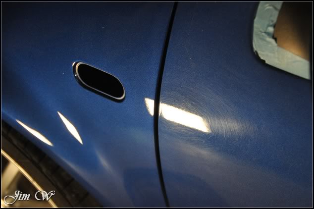

Defects:
Overall, the car was in a very good shape (compared to the other mkiv R as mentioned above!)

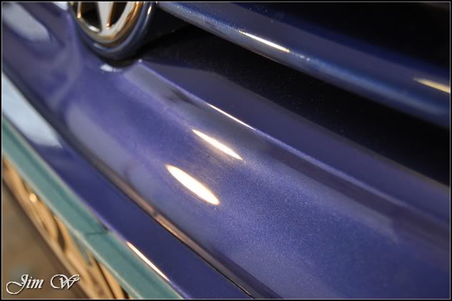

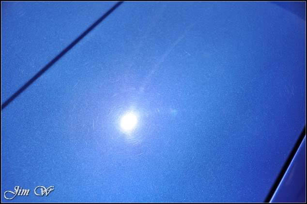

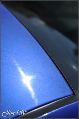

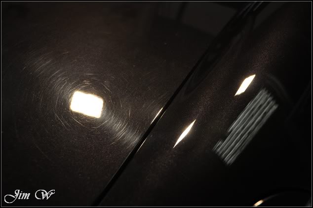

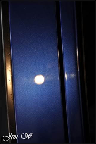

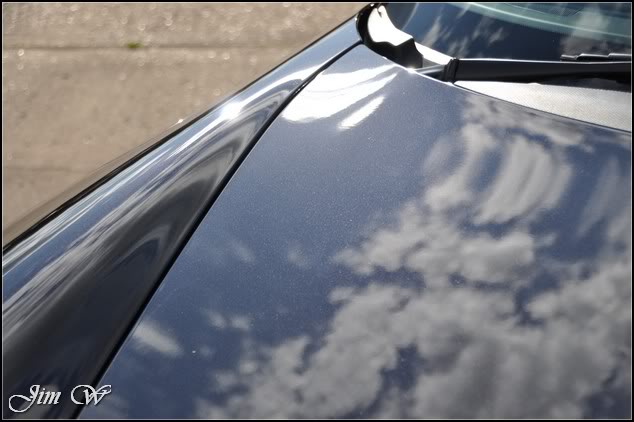

Starting high on the roof line, I picked out a few hazy patches.
Before/After:
Refined down to a crisp sharp finish:
B-pillar before/after:

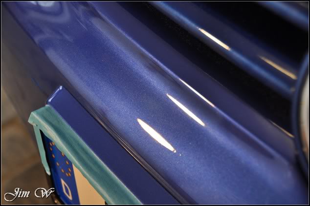

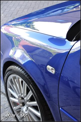

Flake pop:

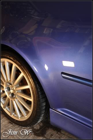

50/50 between wing and door:

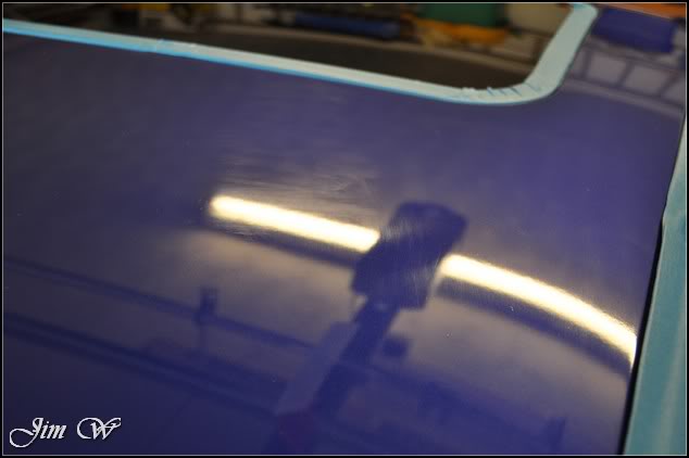

The bonnet was one of the areas the owner knew about in terms of ‘new paint’.
Before/after – light swirling and buffertrails left by bodyshop.

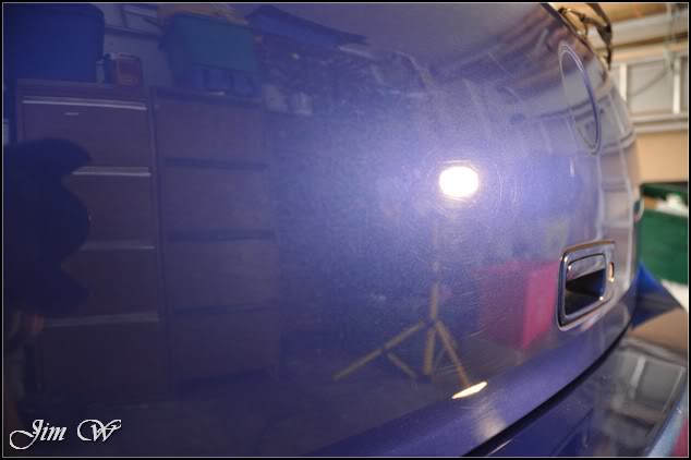

Boot lid up first.
Before/After:
Before/After:
Before/After:

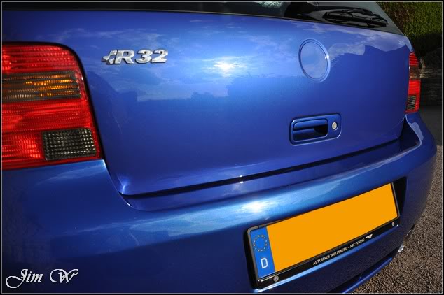

Complete: (see the swirling on the bumper; that’s next!)
In this light, the colour match on the bumper isn’t great although outdoors you’d do well to spot it.

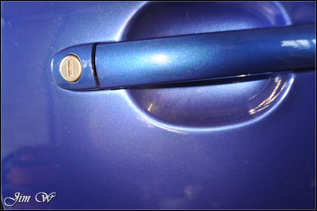

Inner door handle tackled with Menz 203s by hand. Before/After:

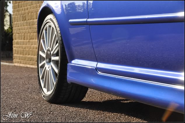

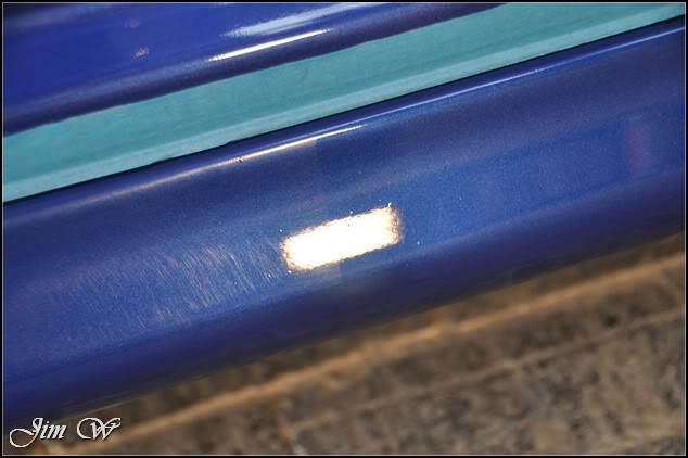

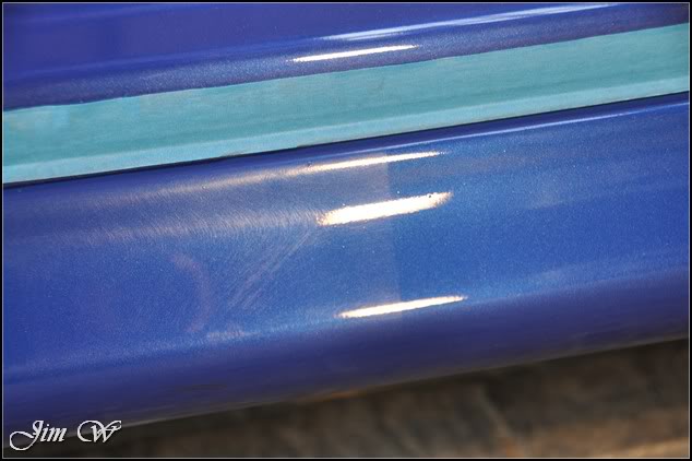

Side skirt 50/50:

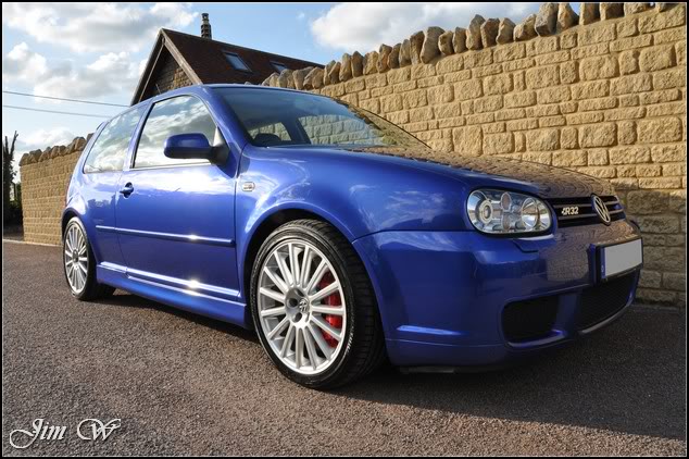

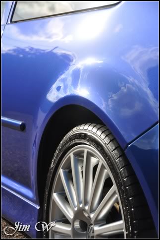

Machine work complete ~ 3pm into the second day.
Because of the dust created by heavy compounding, the car was put back outside for a good rinse.
After pat drying the car, it was blown dry with the Black Baron Vehicle Dryer to remove water from behind the badges, grilles, crevices etc.

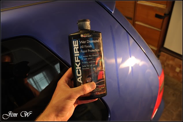

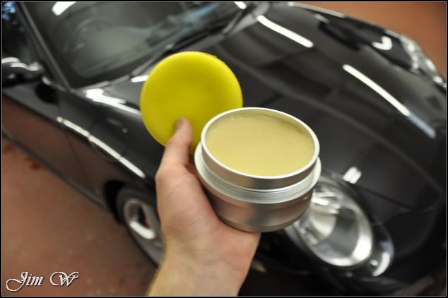

After a thorough IPA (isopropyl alcohol) wipedown, Blackfire Wet Diamond was layed down to protect.

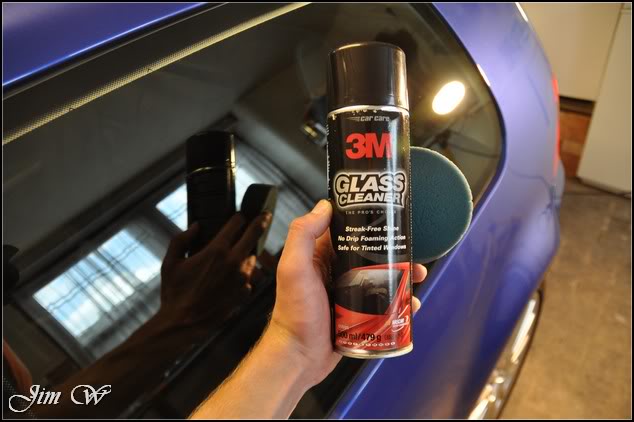

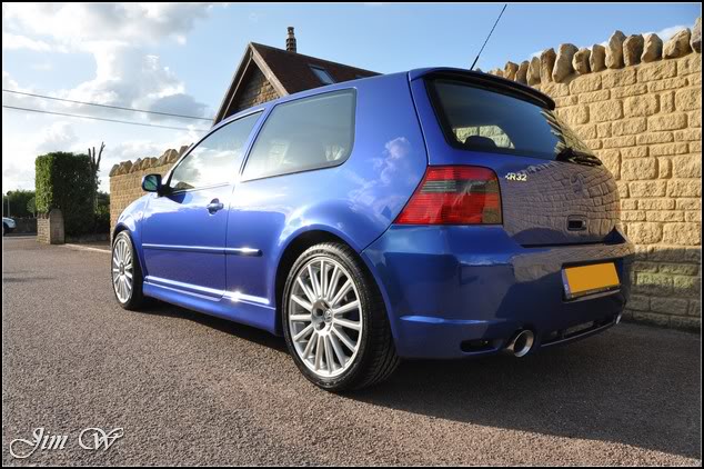

Wheels, tyres and exhausts sorted. Glass cleaned inside and out with 3M’s cleaner:
A final wipedown and then checking panel gaps for polish residues etc.

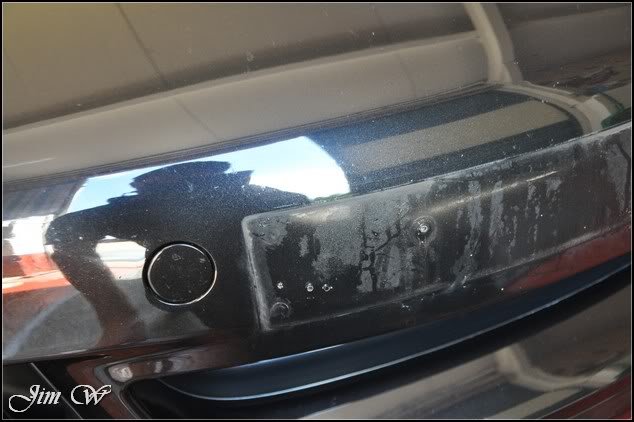

The owner is in the process of sourcing a new badge for the bootlid as we speak.
Overall, ~20 hours over the two were days put into this one. Considering, not a bad turnaround in my opinion!
Thanks for reading.

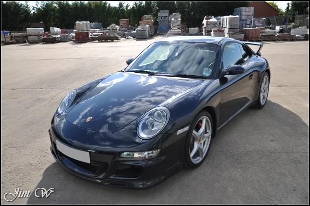

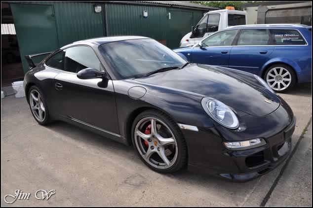

Porsche Carrera 2S – Basalt Black
A 37 hour ‘White Detail’ to give the vehicle a complete new lease of life both inside and out…

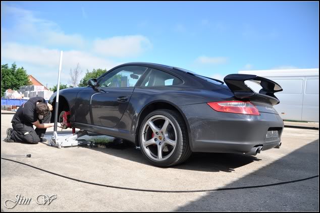

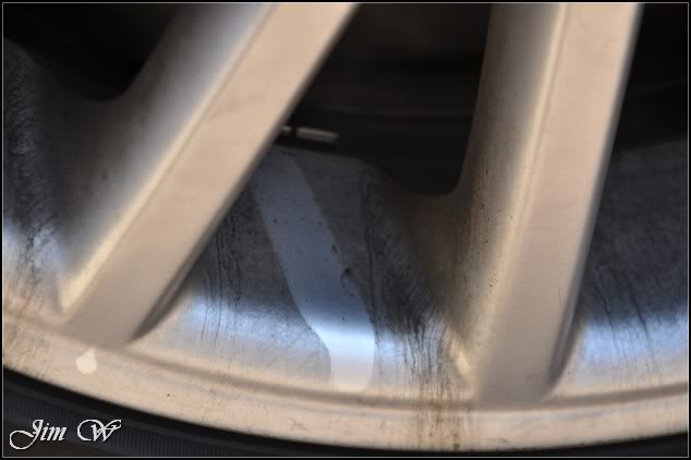

Day 1 I had planned to remove and deep clean the alloys (later being refurbished so not to spend too much time on them), prep the arches and brake calipers and then to paint the wheel hubs as they had started to show signs of slight corrosion.
Front arch after:

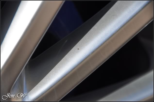

Some old wheel weight glue to remove:
Tardis in action removing organic contaminants:
And then Iron-X to lift any metal filings etc (pretty clean to begin with to be honest!)

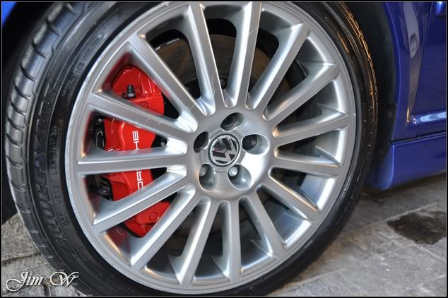

Hell. These rear wheels massive!
Again, more glue:

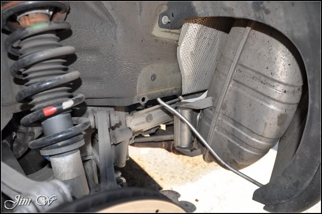

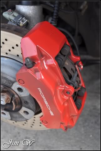

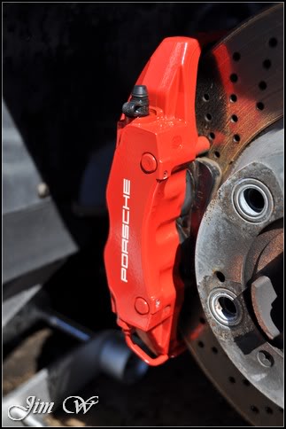

Caliper before/after cleaning:
Tar removal from exhaust silencer:
General before/after:

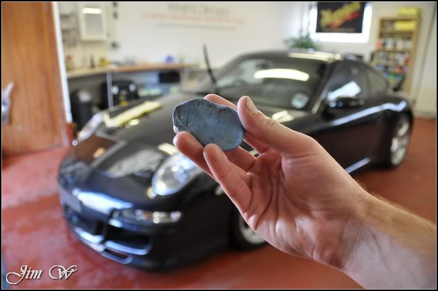

As soon as the usual wash steps were out the way, it was straight inside for claying and decontamination.
A few tar specs lifted:

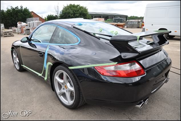

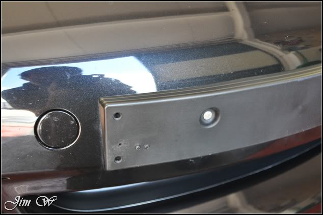

Front reg housing removed to allow tighter paint correction on bumper:

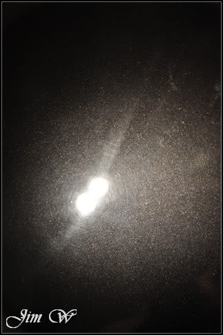

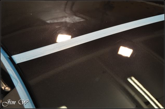

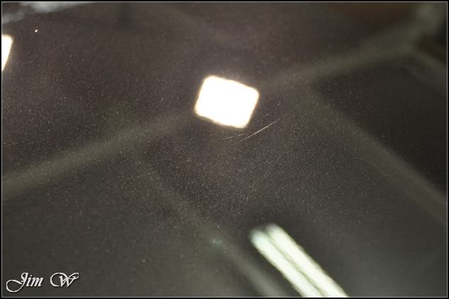

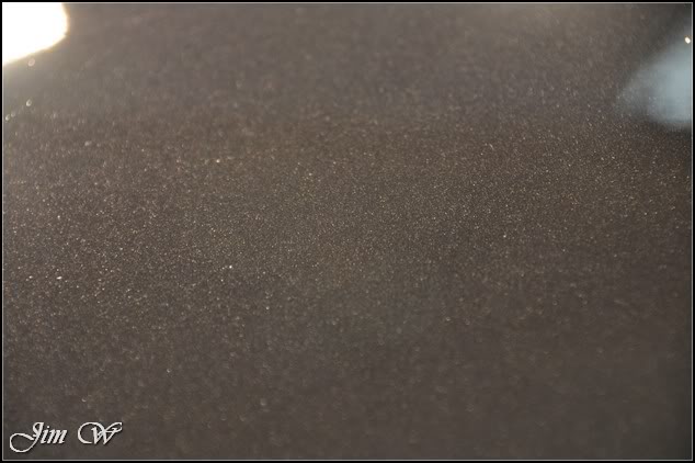

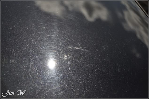

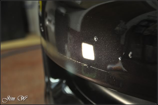

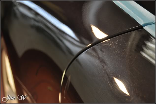

Back outside into the sun and here are some of the defects…

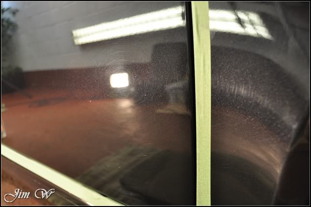

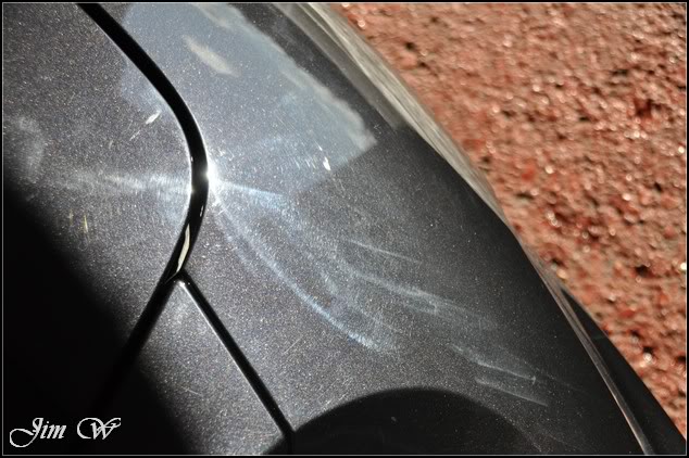

A few nasty etchings:

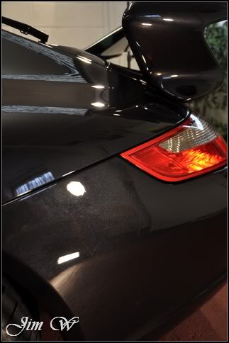

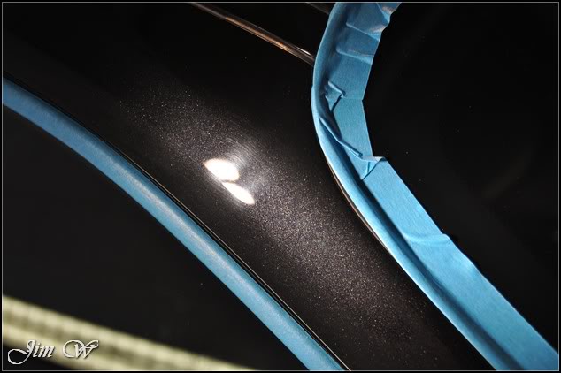

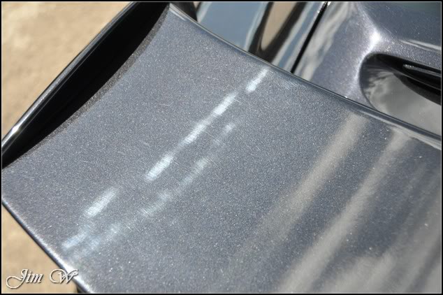

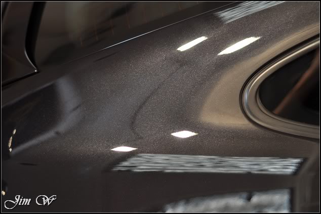

And caught up in the curves on the rear quarter were a few slight machine holograms:

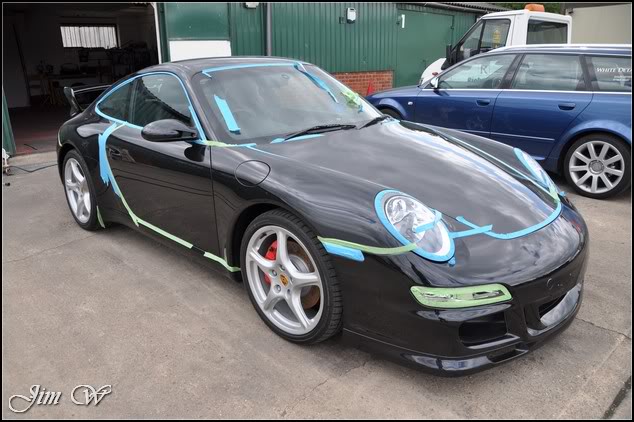

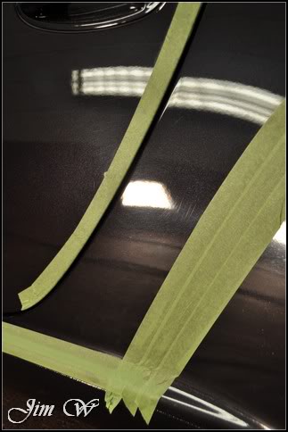

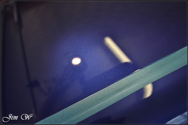

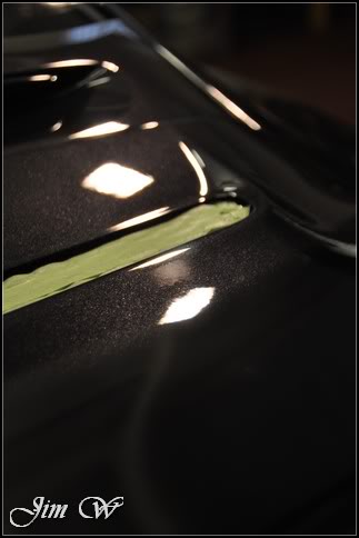

Back inside and taped up ready for an early start on Day 2.

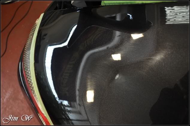

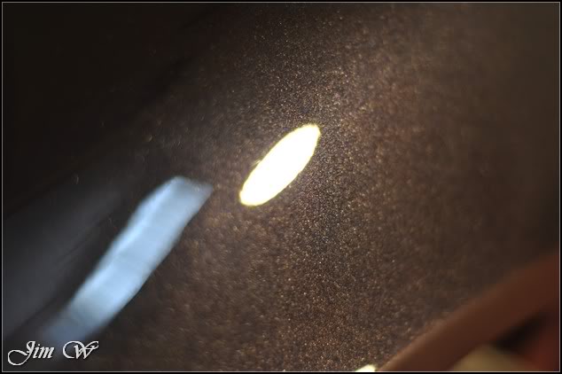

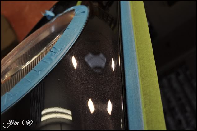

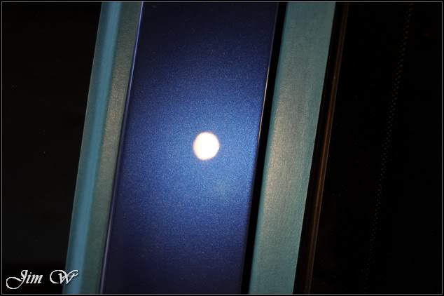

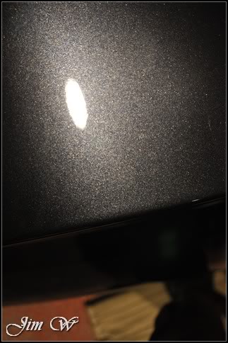

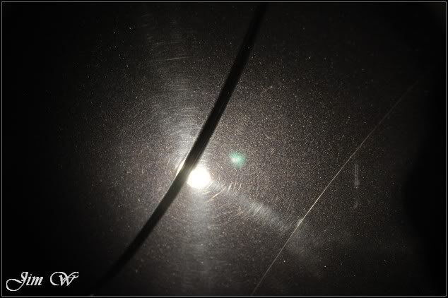

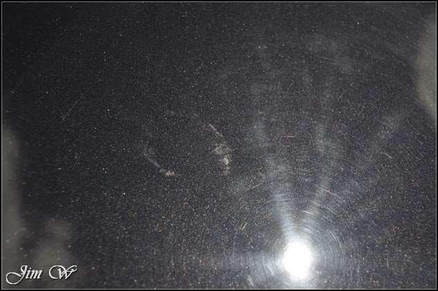

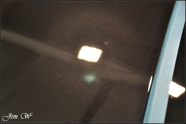

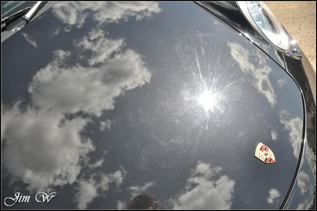

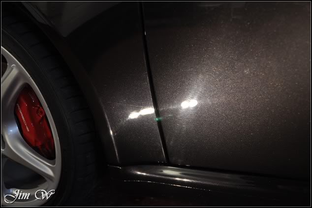

With the sun beaming through the unit doors, I noticed more machine holograms. This time on the front bumper (after a trip to the bodyshop no doubt)

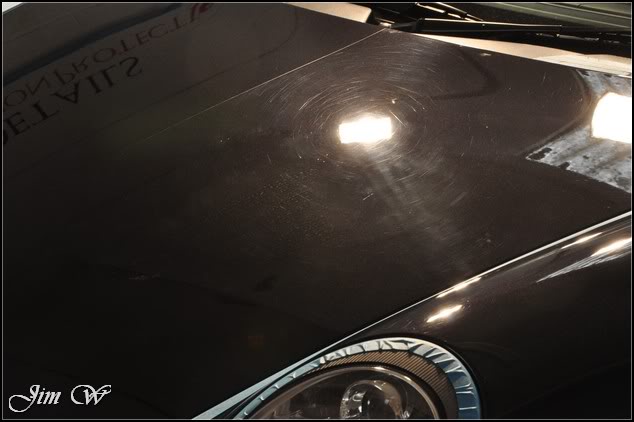

Defects under the Brinkman LED torch:

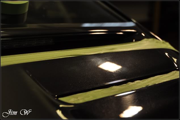

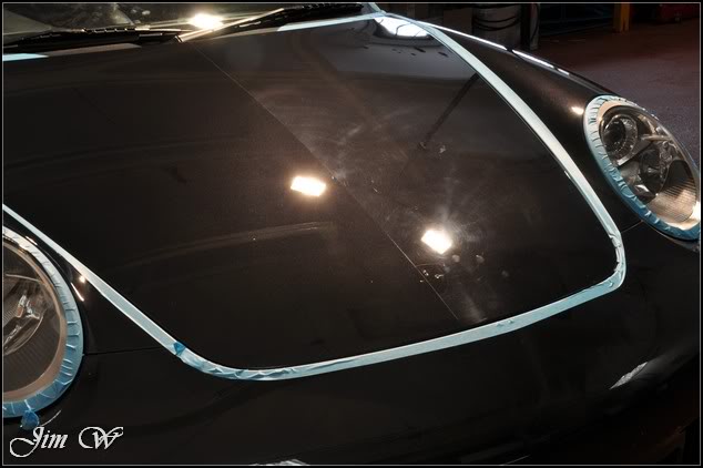

Even with natural lighting you can make out the ‘haze’ covering the bonnet: (promises to be a big turnaround!)

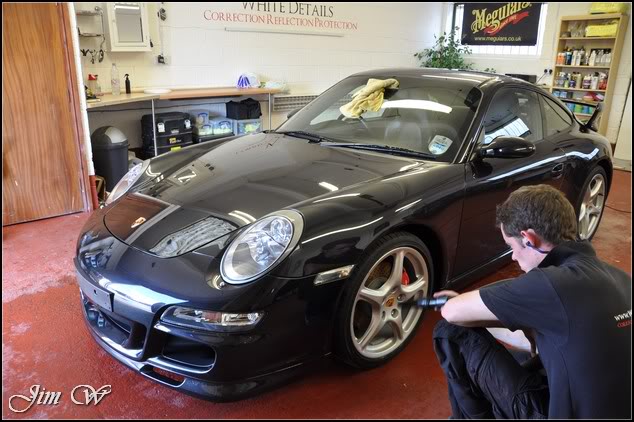

OK so, day 2 and time to make a start to the paint correction work.

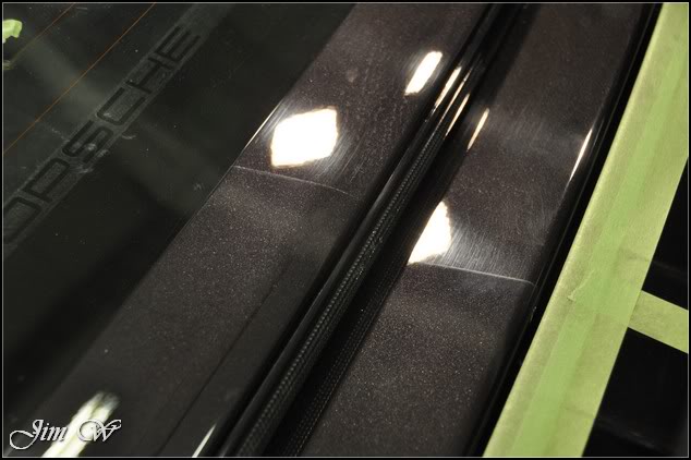

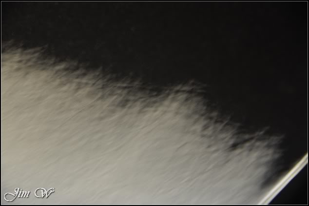

Unfortunately, whilst testing my pad and polish combinations it was noted that the Porsche was suffering with ‘sticky paint’.
With the rotary, whilst digging deep trying to remove the deeper scratches, the polish would dry out, clump, and deposit nasty clusters of polish that weld themselves to the paint.
Various tests were made; polish variations, pad swapping etc. The results were good, but it wasn’t half tricky!

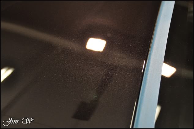

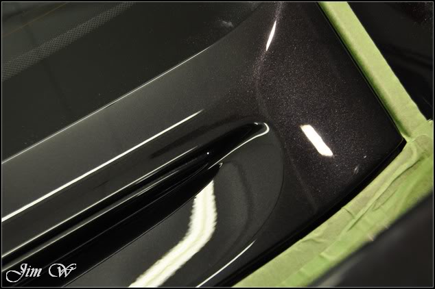

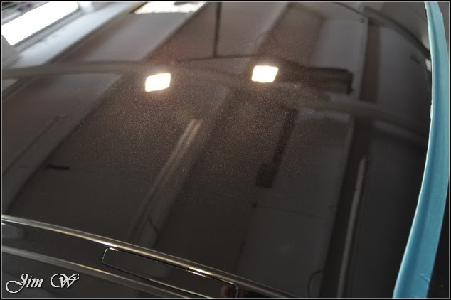

Roof before/after:
A-C pillar corrected:

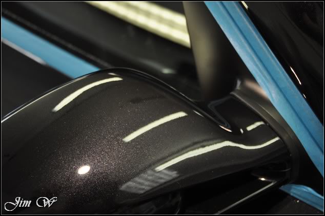

Mirror:
Eventually, I knocked back down to the Dual Action (DA) machine polisher as it kicks out a lot less heat (thus, ‘hopefully’ working around the sticky paint issue)
Progress was slow but still, results were good:

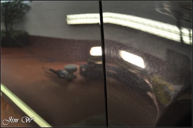

Before/Afters on O/S/R:

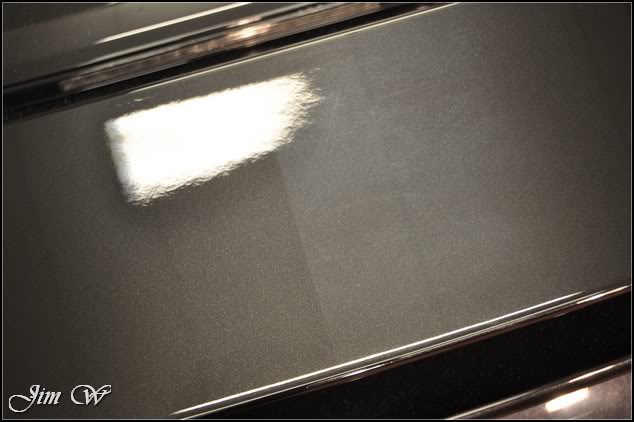

50/50 between the wing and door:
50/50:
Before/After:

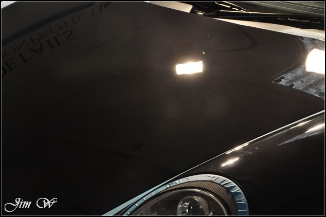

After three steady compounding hits to the bonnet, this was the result:
Lots of deeper (RDS) scratches remain. Spent nearly an hour and a half on one side of the bonnet alone; lots of marks to chase out.
50/50s:
Before/After:

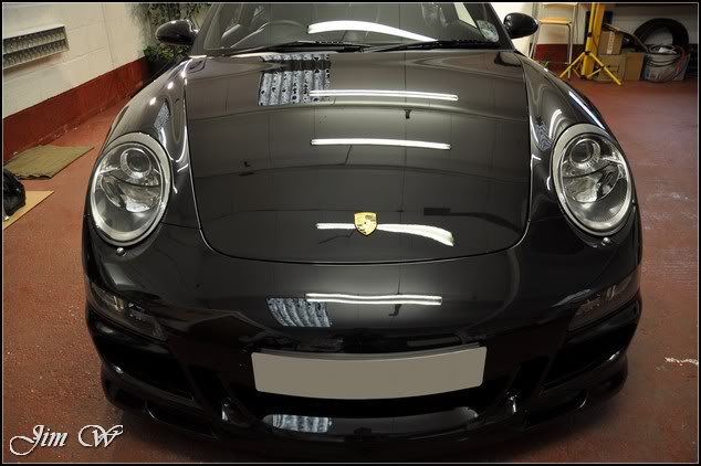

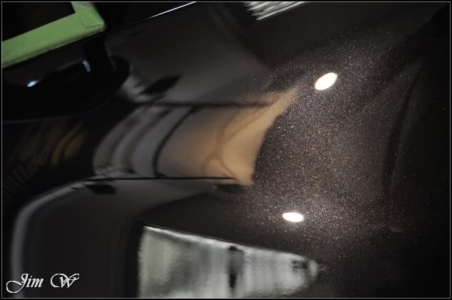

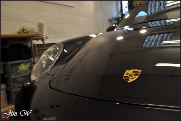

The finished result on the bonnet was stunning. Pretty much 100% defect free.
Front bumper before/after:

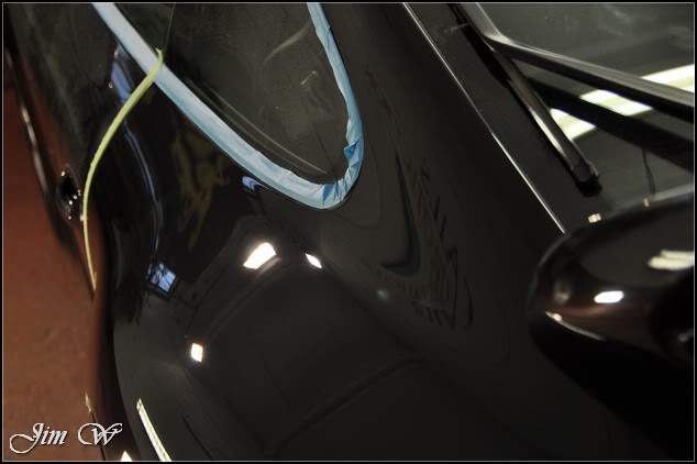

Starting to work back down the N/S, I begin high up on the roof.
Before/After:
N/S/R before/after:
Before/after:

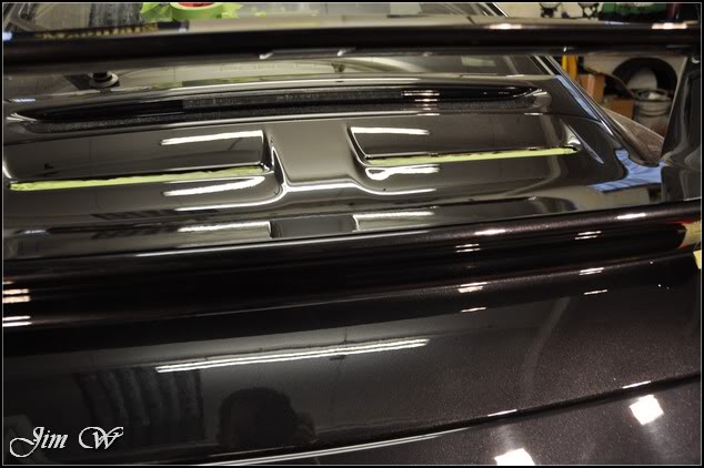

As if the bonnet didn’t take long enough, the rear end with the spoiler etc was going to prove very challenging!
Continuing my work with the DA:
Two 50/50’s:
Top section complete:

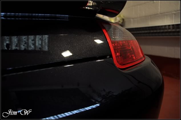

Finished:

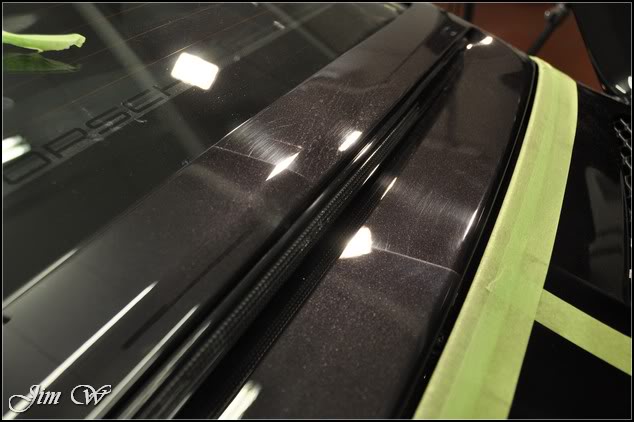

Albeit not perfect; I couldn’t quite lift this one: (massively reduced though by ‘rounding the edges’)
The paint finish on the aero kit spoiler wasn’t the best.
Improvements were made though:

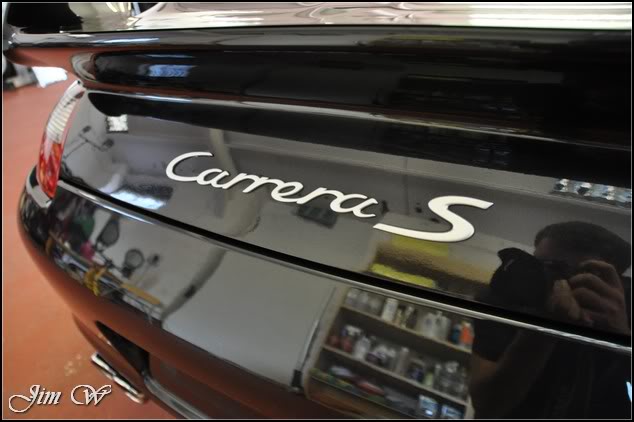

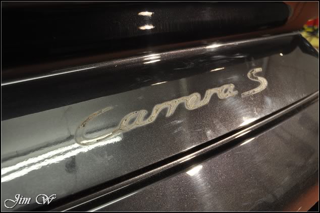

The owner had requested that the ‘Carrera S’ badge was removed off the back.
Happy days – makes my life much easier!

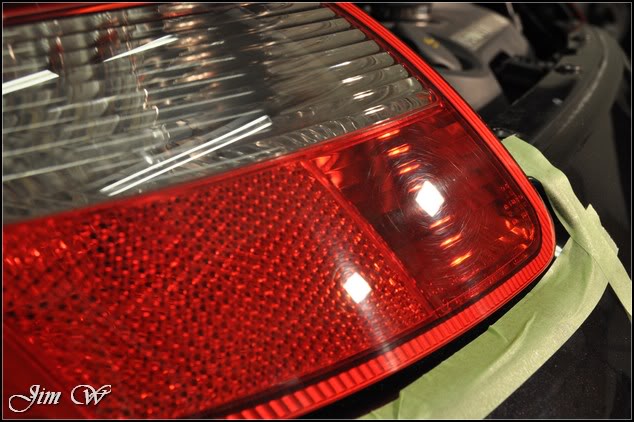

Rear lights tidied up:

Porsche manoeuvred back outside to remove both the tape and also the dusting:
After a thorough IPA (Isopropyl alcohol) wipedown to remove polishing oils, the car was treated to the first of two Black Label wax applications.

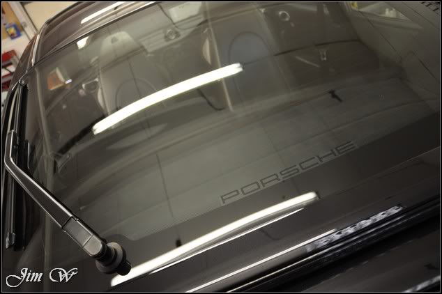

Being some 6”2’ in height, the inside of the rear window isn’t the easiest to access! (queue all sorts of funny grunts, groans and aches!)

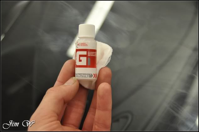

Windows sealed with G-Techniq G1 rain repellent.

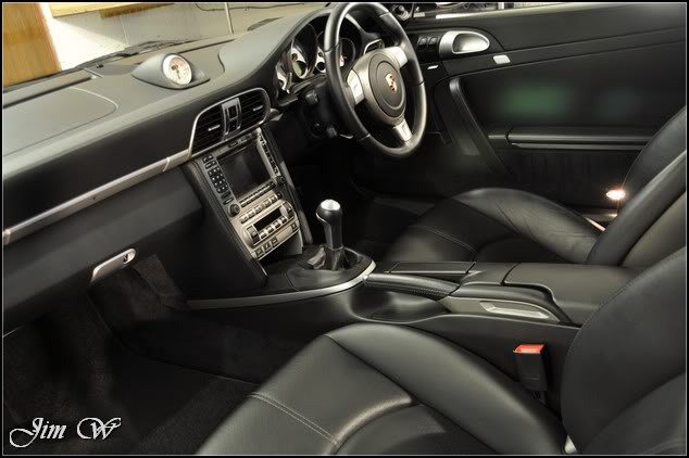

Interior vac’d, console wiped down and leather cleansed with LTT’s Auto Ultra kit.
Finer interior details were taken care of; some ‘toothpickery’ work to remove the engrained dirt from the numbers on the gear stick:
Engine dressed and tidied:

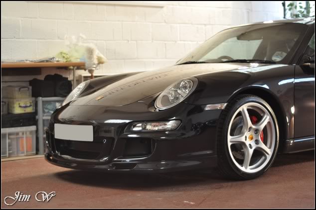

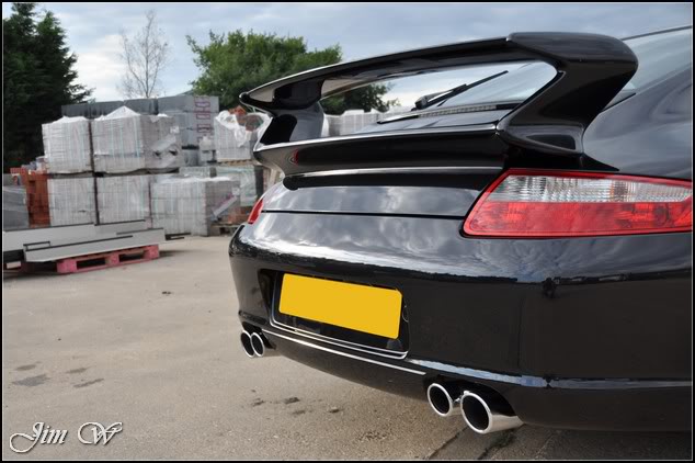

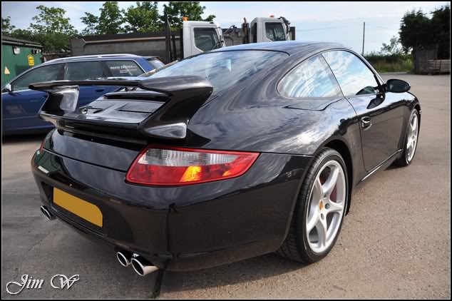

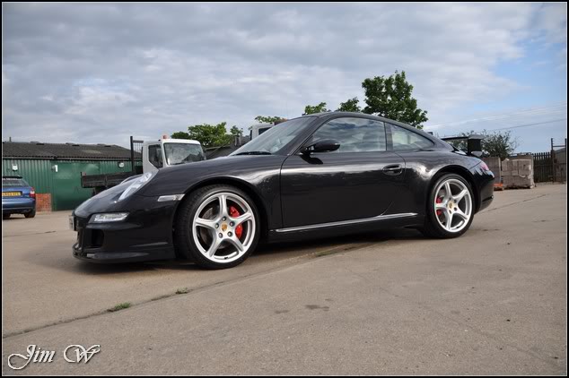

Reg plates fixed on and bonnet badge replaced. Finished.
Another basalt black 997 popped by for a sneak peak and a quote on theirs:
Wiped down and ready for collection:
Stunning. A few more ‘detail shots’ were captured on collection day; I’ll upload the new pics later on.
Most enjoyable turnaround, thanks for reading.
