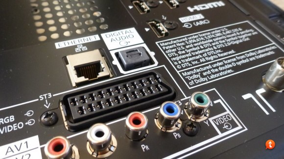

AV1 or the one scart it has will 99% be an output too. Hence these little symbols and this on a new TV that needs an adapter.

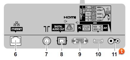

Number 10 RGB input only, Video (Yellow, Red, White RCA) is input and output hence the arrows in and out of the circle.
