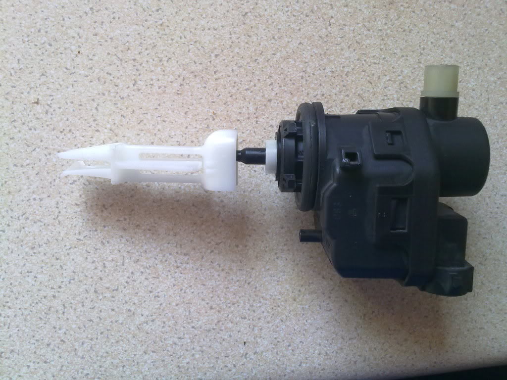

Right I've got the bulb fitted properly but when I was changing my sidelight bulbs I noticed that on one side the inside of the xenon seems to be loose. I've had a quick search and it seems like the headlight adjuster could have come off or something. I'm guessing that would explain why that headlight seems to be shining downwards? Is it a bumper off and headlight out job to pop it back in? Are there any guides on how to do it?
Depends what headlight it is really...the aircon pipes on the drivers side make that one a b**ch to get into if it's still on the car. It's manageable with small enough hands though lol. The adjuster just clips into the headlight in a sort of ball and socket joint. The white bit in the photo below should be attached to the inside of the headlight, and the adjuster just clips into the 'socket' bit of it from below. You'll need to remove the adjuster motor from the back of the headlight to let you move it about and clip it back in, but it just twists (cant remember what way) and pulls off.

Okay so I got the bumper off today and the adjuster was disconnected so I popped it back in, but while doing this I noticed that a bit of plastic was broken off. I think it was a bit of the plastic that the screw goes into as you adjust it. Just took it out and the headlight that side is still pointing downwards :(
Right I've just realised how thick I've been. When I took the headlight out, I saw that the ball and socket bit wasn't connected, managed to get that back together, put the headlight back in and realised it was still pointing downwards and assumed it was something to do with the little bit of plastic that had broken off. Just looked back over your post and seen that I didn't even take out or look at the adjuster in the pic. If the ball and socket bit is connected, could it be that the actual adjuster isn't connected to the headlight and that's why it's pointing downwards? Sorry if I'm being totally thick!
Emm, basically the whole inner light unit is sort of hinged on 2 clips, and then the adjuster motor connects to another clip (with that ball and socket joint), and this pushes in and out and tilts the light up and down. If any of those 3 clips have broken then the light wont adjust and that could be what's causing it to still point down.
If you remove the adjuster the whole inner light unit should be free to sort of swing back and forth inside. If it doesn't, one of the other clips has more than likely broken or come off. If it does swing about, it probably just needs reconnected to the adjuster motor with that ball and socket joint and then manually adjusted. Hope that makes sense lol!
