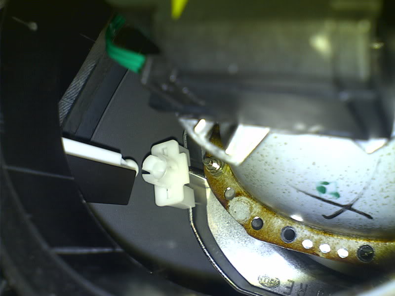

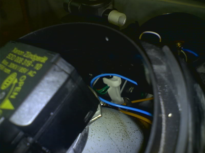

I've recently bourght some Xenon headlights from a 182 and the passenger side seems fine, the drivers one though has come loose inse of the plastic fitment. I think its meant to clip into 3 plastic clips to hold it in place and also so you can adjust the headlight. I have no idea how to put them back into place because I either need tiny hands or I am going to have to brake the casing of the headlight. Got a couple of pics aswell as its quite hard to explain. Any help is appreciated, Thanks.

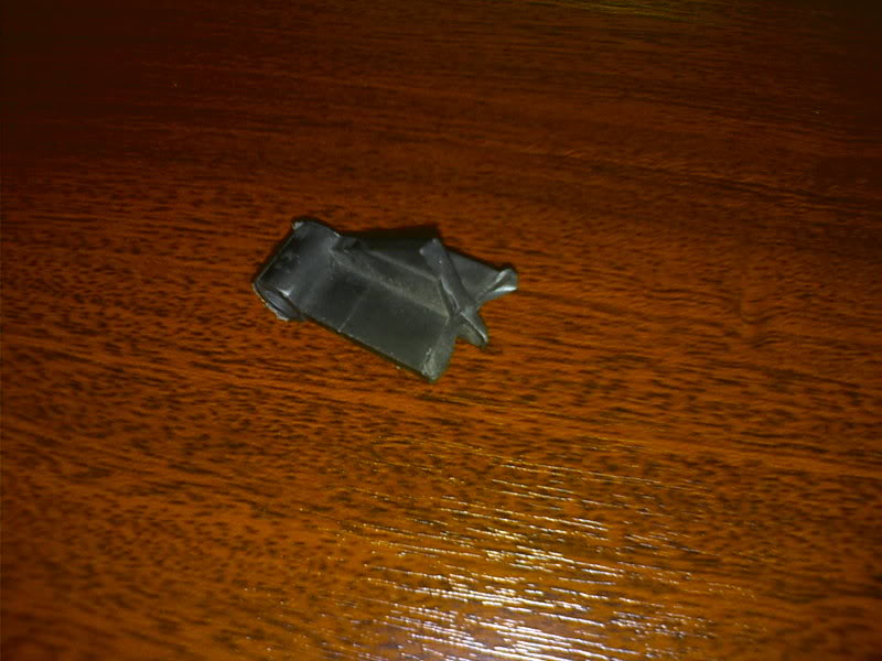

Also this is what fell out of the package when I opened it lol not sure what is is... hopefully its not important...

the bottom pic is the piece that locks the headlight unit into the slam panel of the car, look at the top of the light and you will notice its missing that bit . . . lol
the first pic is the adjustment part. that is easy to fix; it is literally as it looks ie a "U" shaped holder with a ball joint. so put the ball joint at the bottom and then push (quite hard) upwards and the ball will click into the "U" shape and be able to slide up and down.
having said all that, with the second photo you fcuked mate, sorry to say. mine came like that from ebay and had to reclaim off royal mail for brand spankers.
there is no way of getting to it easily and therefore you would need to break the casing which would mean letting moisture in = condensation on inside = not good

ahh man don't say that :( theres actually 3 clips which the headlight is supposed to sit in but they have all come out. Is there no way of getting all the ball joints into the holders just by fiddling about with it? Or is best bet just to send them back?

what about if I took the back of the bulb housing box off so I could get my hand inside there? It honestly musn't be that hard to fix.. nothing has phsically broken it just needs pushing back into place lol and I so don't want the hassle of trying to arrange a refund!

When they fully come away in the inside there pretty much useless.
Its a new headlamp casing needed which is about £185+VAT from Renault.
There pretty much impossible to get them to "pop" back onto the ball joints.
Surely you can pull the interior of the light towards you and pop them back into the ball joints no?

After many hours of fiddling with it I've managed to get both the plastic balls into there correct joints! The last problem I have -sigh- is that the third one (which isn't shown by a picture because its too hard to photograph) which doesn't have a ball and a joint it just has a square piece of plastic at the top and a thinner one below it which should push into each other and keep the head light from moving about, has broke and left half the bottom piece inside the top piece lol do you think it would hold if I could some how get some super glue inside there? I can see where I have to super glue but its a real struggle to get some onto the piece. I'm determined to get it fixed lol as I paid so much for them and also the other one is in perfect condition. Anyone ever fixed one before or thinks its not a good idea super glueing it back together?
