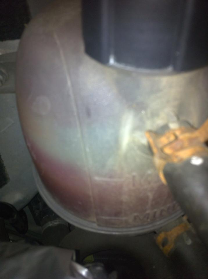

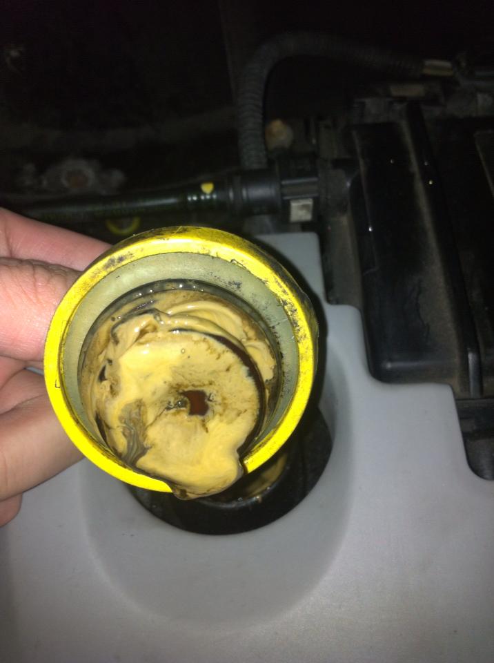

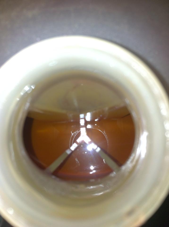

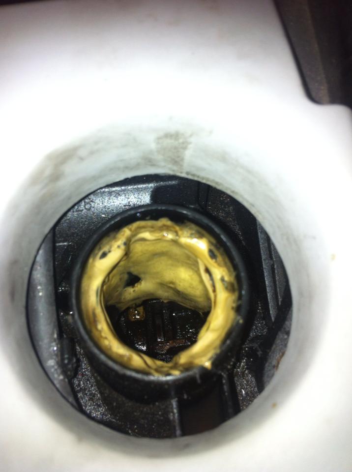

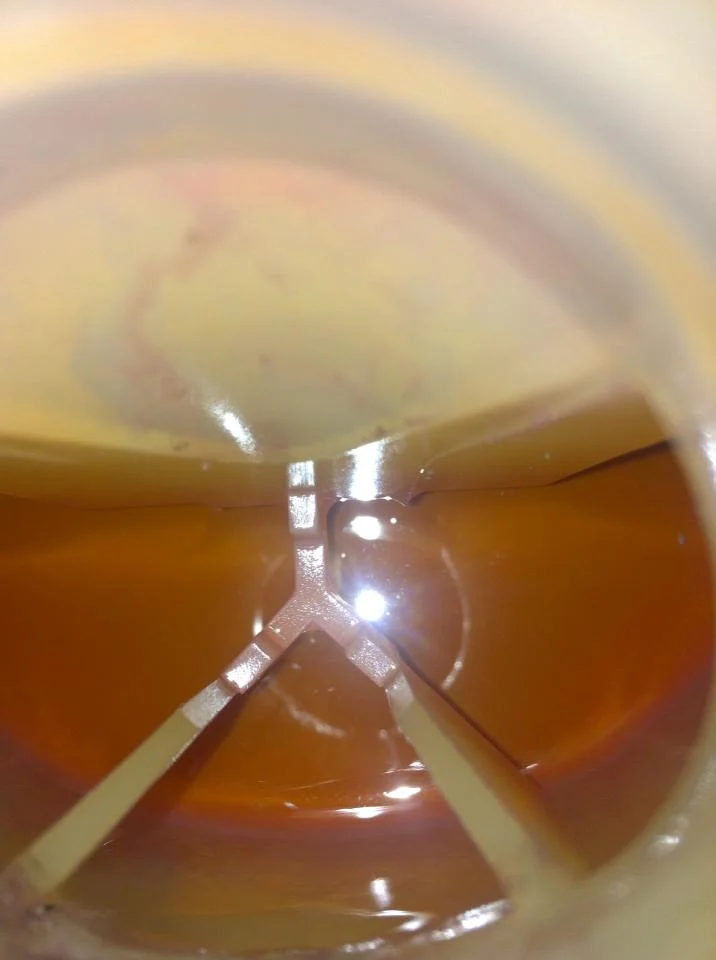

My first post on here in a while, back with another issue! I went to check my oil last week and for some reason I decided to take of the oil cap, when I did I seen this yellowy brown substance. I took it to a garage to have it checked and I got told 2 different things! Either
1)My head gaskets gone
2) Blocked breather pipe
The man who works at the garage asked me loads of questions regarding my head gasket, to which I answered no to all of them, including there is no constant stream of smoke (any color coming from my exhaust!
Anyone know what the problem could be? I have attached 6 images! I also have the car booked into renault tomorrow for the free health check, just to make sure everything else is in order, thanks a lot :D

It drives fine, pulls fine, no noises, no squeaks, nothing! Its used on small journeys but the engine always gets up to temp, holds the temp just fine, doesn't over heat, not a thing wrong? I have no idea what could cause this, although its last service was at 73,000 miles I think (Iv had the car a year) and it's just hit 100,000 (as I have been up and down the country a few times) so maybe new oil +filter and a engine flush (coolant) may solve the problem? I did clean it out last week and this is what has returned, after 1 week :\

This is normal for the D4F engine. The filler neck is a kak design allowing condensation to build up.

service done! The dealer told me that it's just condensation due to the weather (probably due to the crap design someone mentioned above) , and that after my check they told me my head gasket was fine, as he put it "head gaskets rarely go on renaults". Thanks everyone
