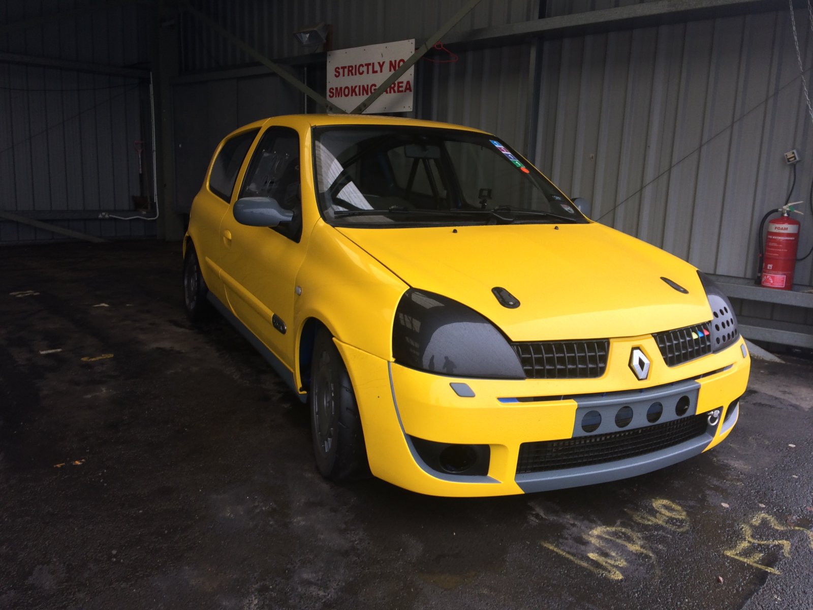

yet another Clio 182 track day road going car. Callyteee's blog
A little sneak peek..
:wink:..

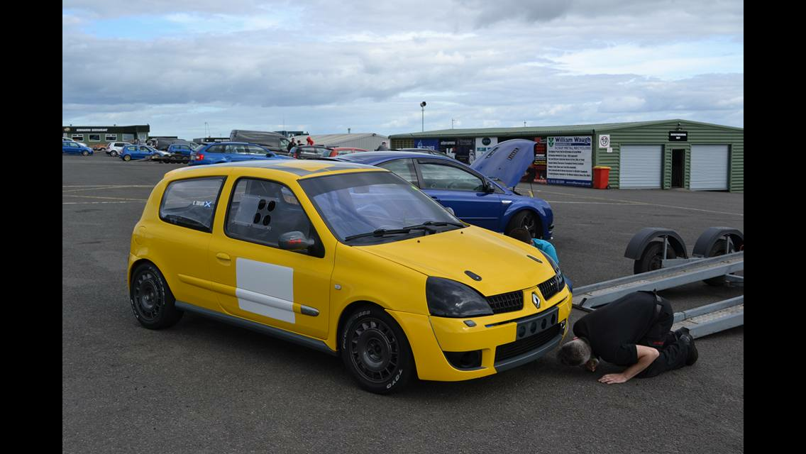

Car was out for the first time 2017...

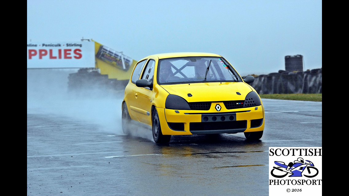

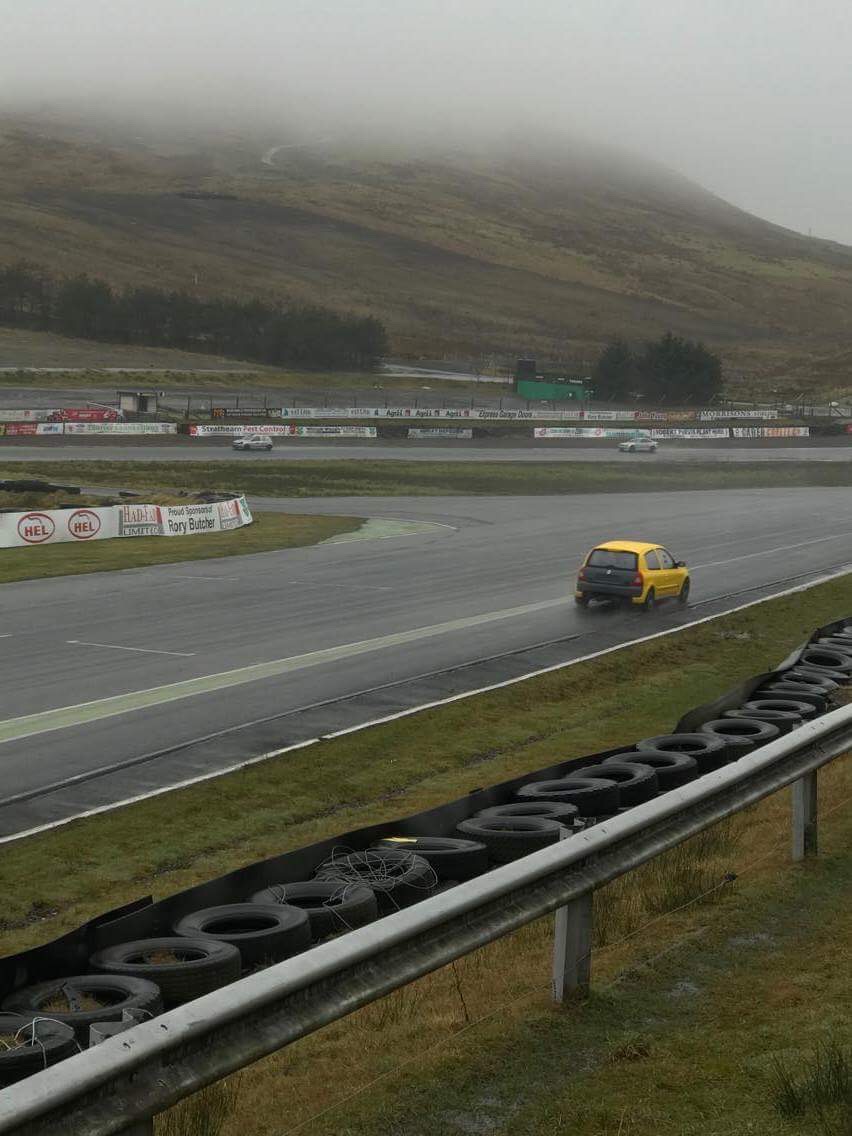

CSOC trackday, was an open pit day. Only down side was the rain but for me was a test day more than getting the max out of it.
Day started and out it went. Few laps no issues. Traction control light would not go off, still had abs! Asides from that no faults to show of as yet...
Got a good few laps in on the day. Was actually getting into a bit of rhythm, apart from hold back a little on the corner was starting to shift about fairly quickly.

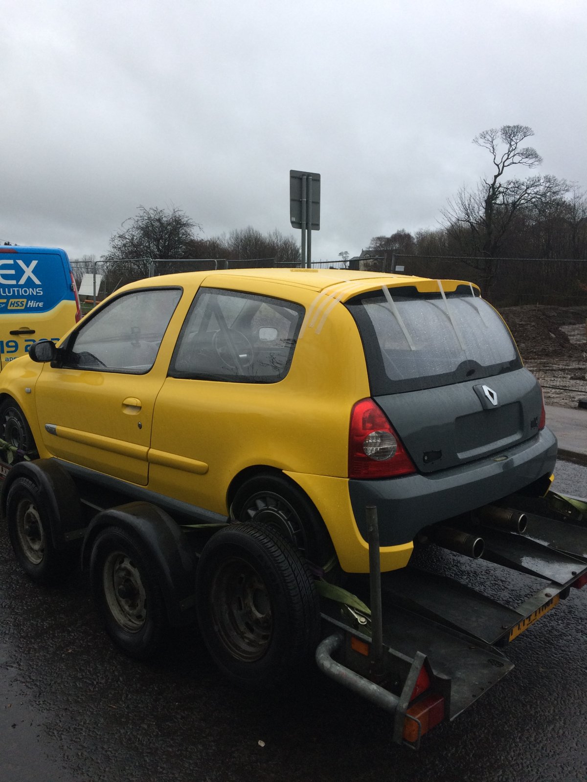

Coasted half the track till almost stopping and managed to take 1st and this whizzing noise came back took 2nd and drive back into the pits. In the pits it spat out its gearbox oil this time. (Last time it popped a hole in the diff)
So back on the trailer and home! Looking for a new box and will need to do the strip down all over again. Not to disappointed... that's tracks cars!

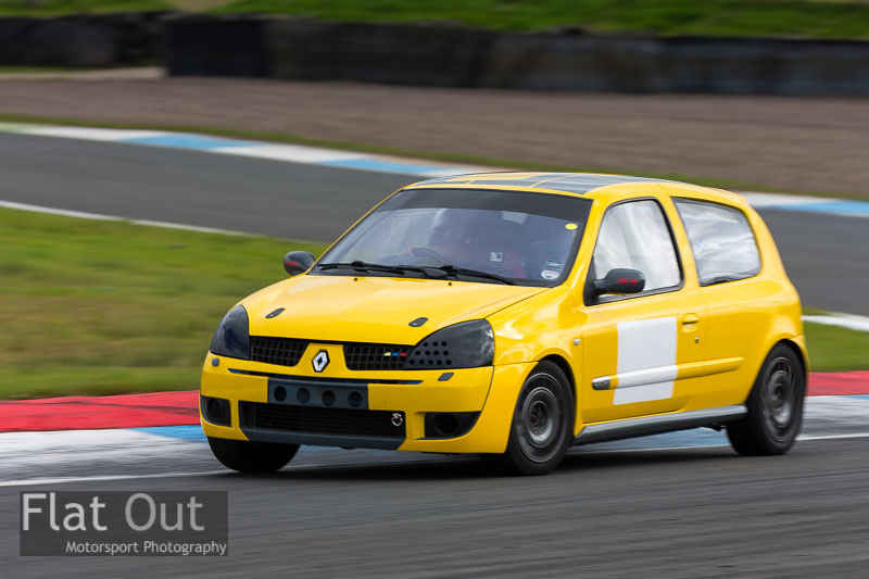

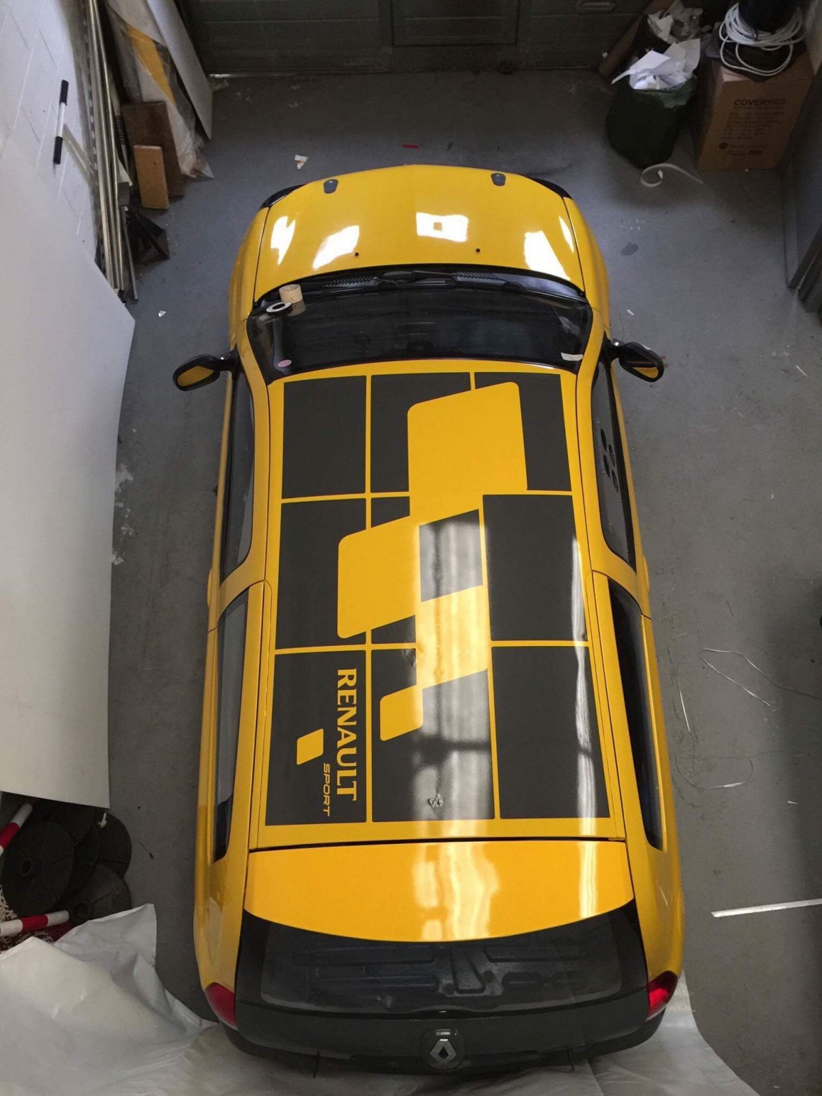

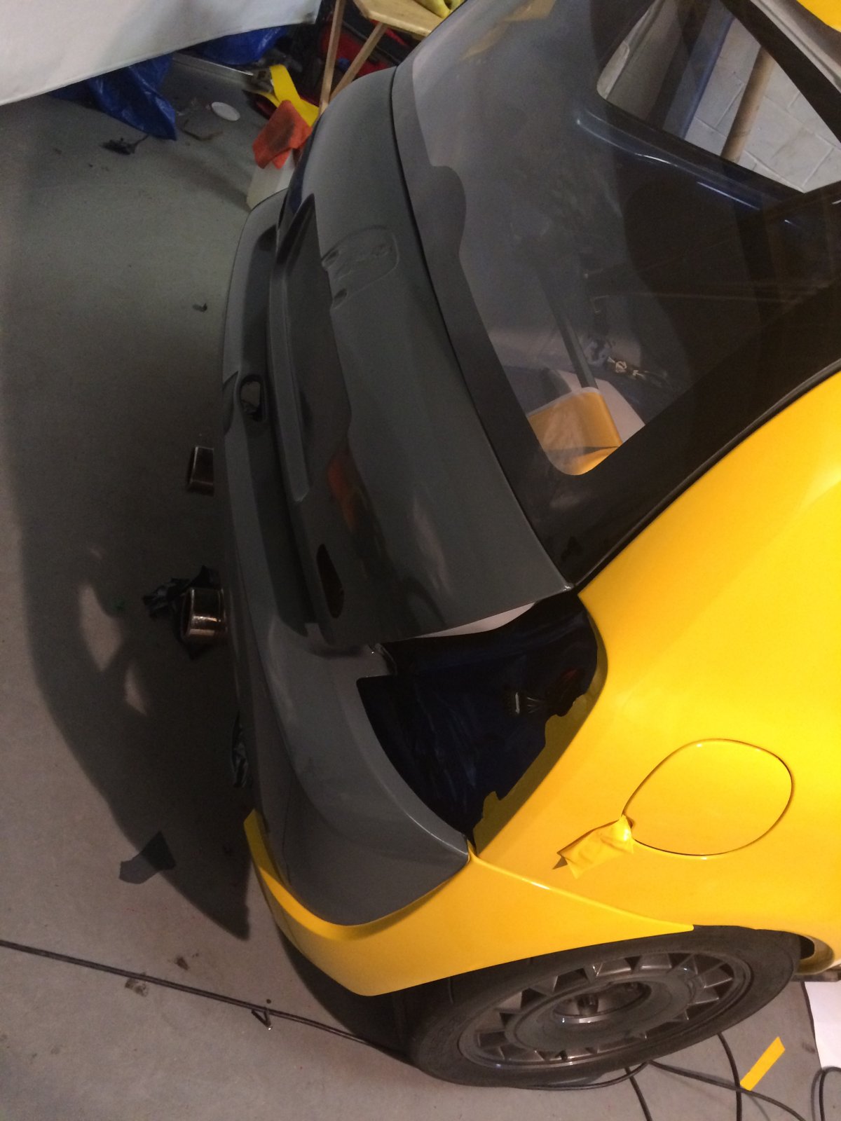

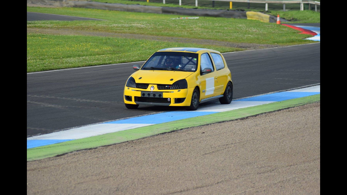

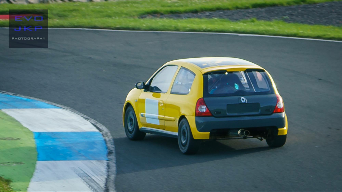

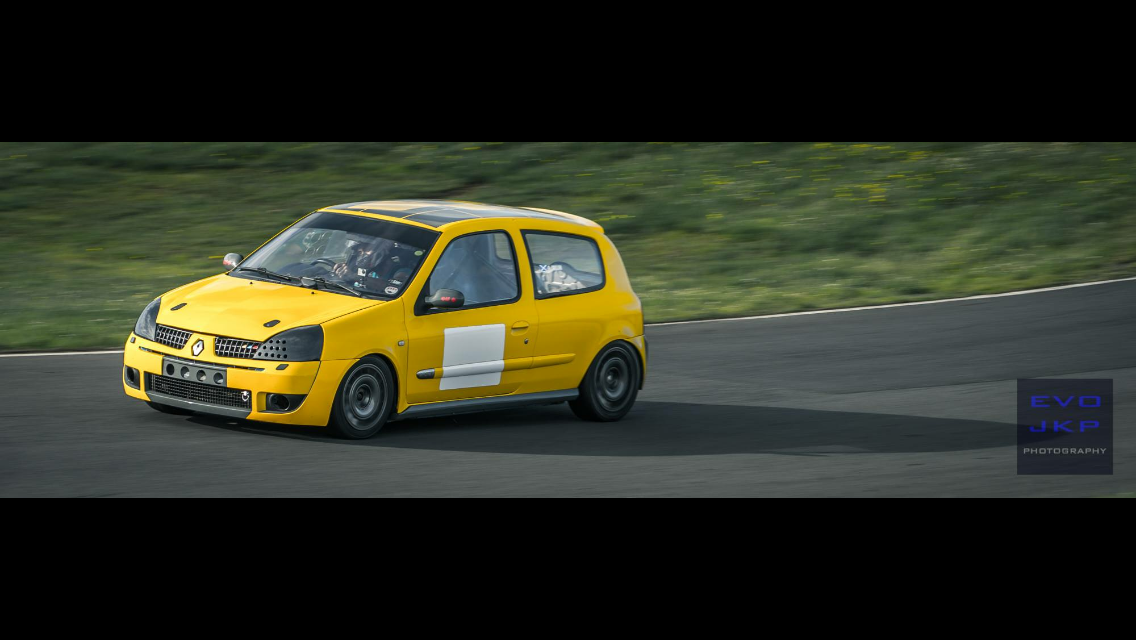

The BIG unveil of the car wrap, all be it it's still needing finished off. Still got roof to do and to get a few decals aswell.
But here it is plus a few track shots :tongueclosed:
Trackday done!... and with no issues RESULT!!

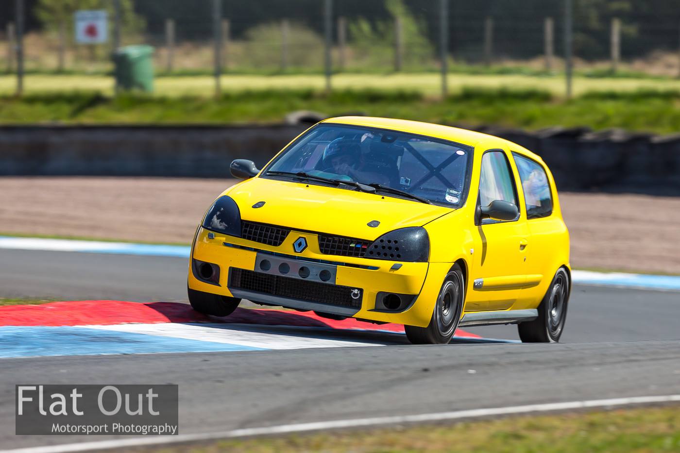

Trackday at knockhill 16th April SLS day with Clio track session!
Car ran faultless all day. Started off with being cautious, especially going from 3rd to 4th as felt a little stiff but think it was more getting used to it again.
Loads of compliments aswell which is always good to hear and appreciated, on both how it looks and how it was performing.
Had a great race with a 61plate Megane sport and playing with the Clio turbos was good fun aswell. Enjoyed the day and looking for the next. :smile::up:

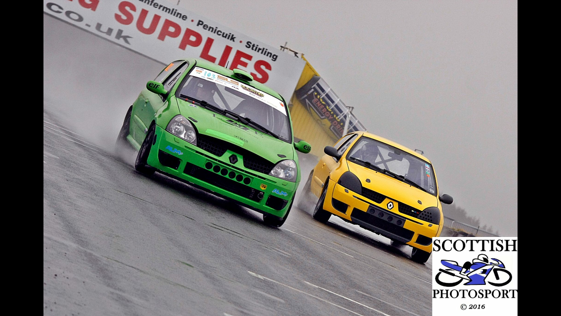

Wrap on this looks great. Really different with the grey details, like it a lot. What's with the GRP bonnets for these being so floppy though. The one on the green one in the pics above is shocking! I'd be putting a bit of metal in the front of it to try and stop that flexing I think.
Cool car though.
Cool car though.
Cheers mate still to get it finished off. But It deffo sticks out now haha!
To be fair the one with the green has had bits chopped out as it's on throttle bodies
Depends where you put the aero catches aswell, mine seems to hold well.

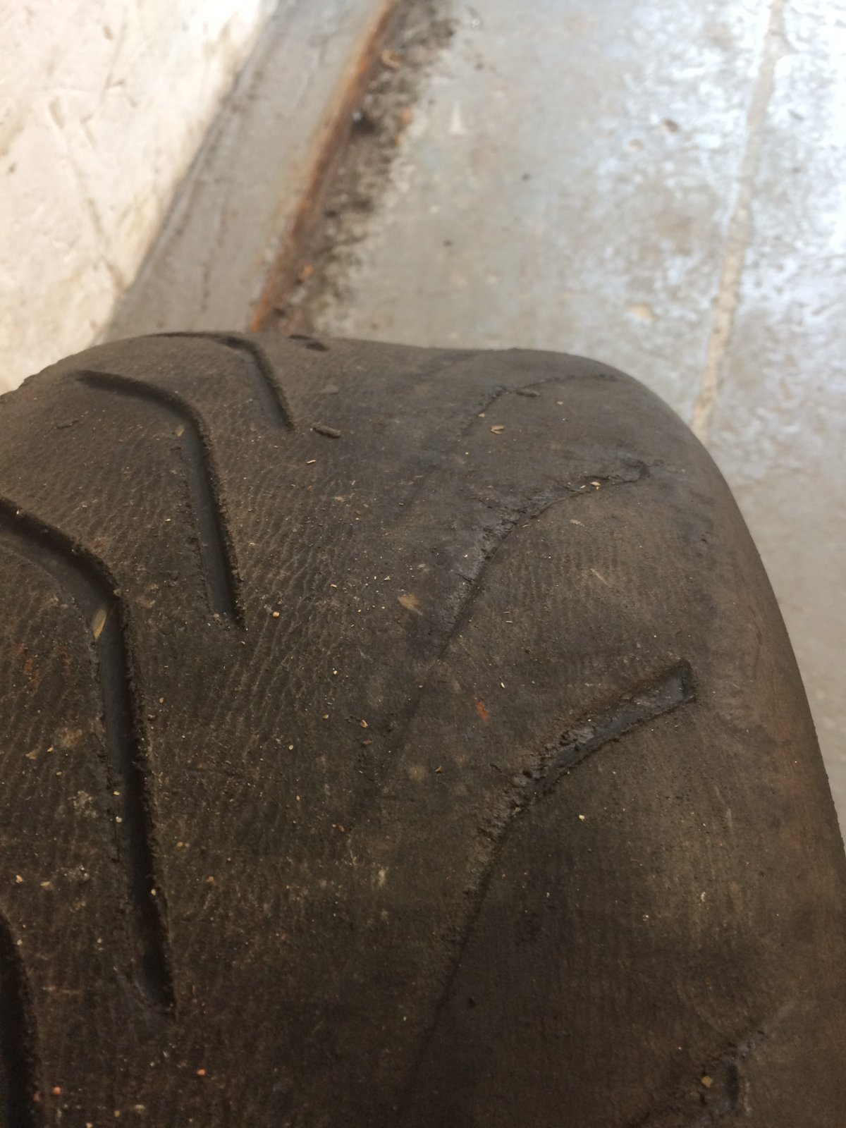

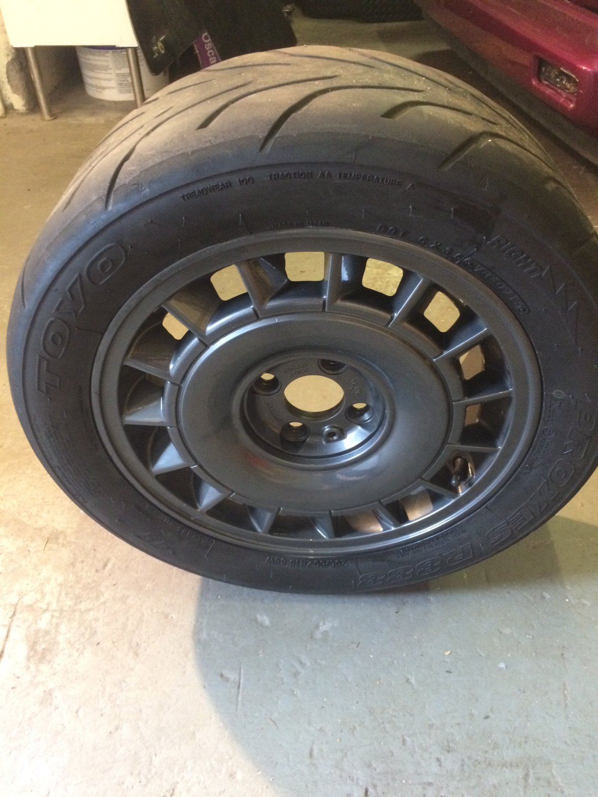

Fresh tyres on as the old ones where starting to show there age..
Got a hold of 205's this time instead of 195's and I'm not sure of them, they do slightly touch the coilovers, so might need to pull camber out a little.
Any one ran 205/50/15's, how do you rate them?

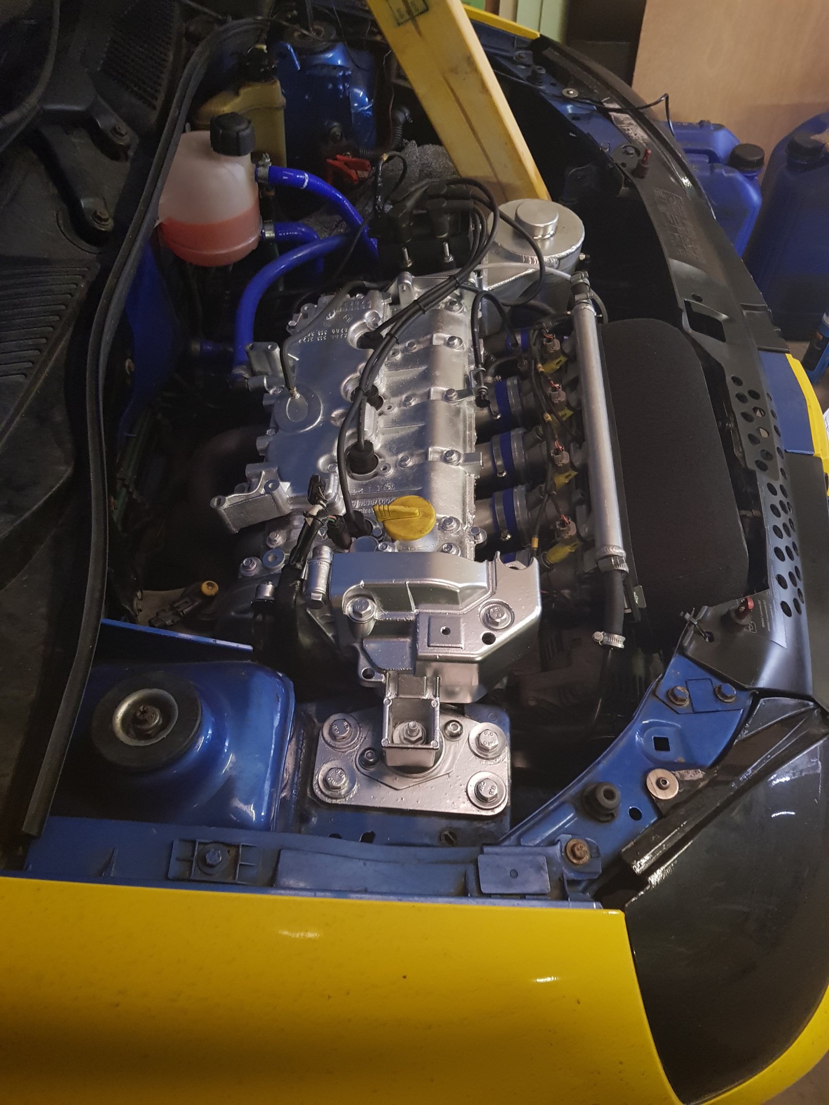

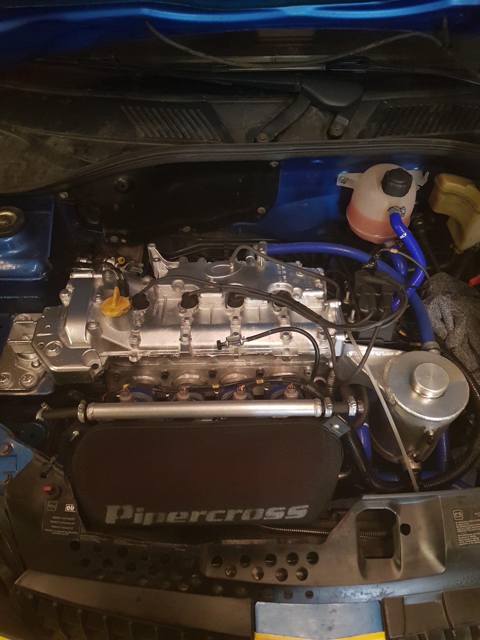

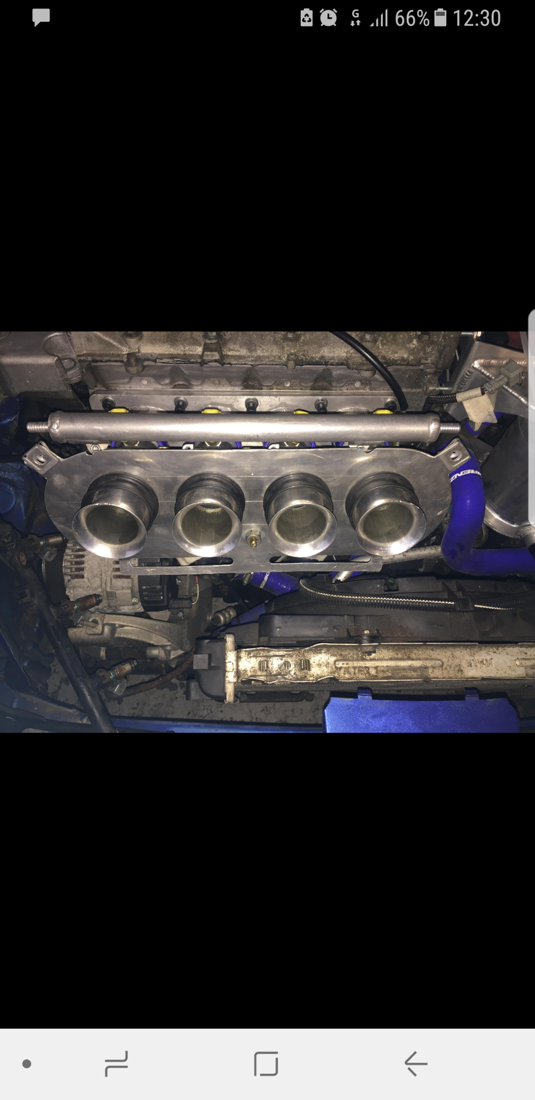

So over the winter the car had a bit of a transformation. Decided to go down the Itb's route 😅 had seen a full kit up for sale a thought.. " why not :cool: "
Motorbike throttle bodies running an omex 600 ecu.

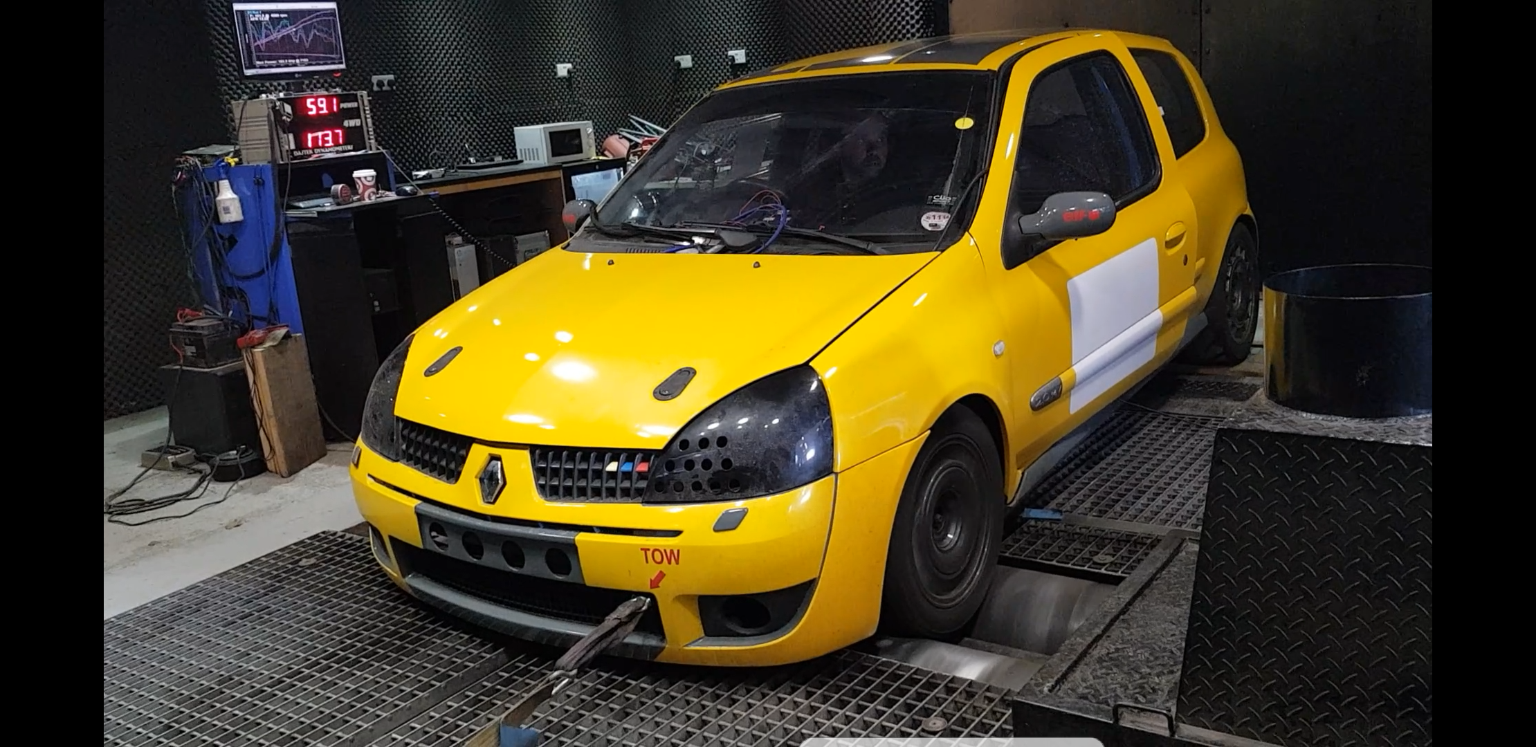

So when all was fitted off to RA Motorsport for a map and power run. Was a little disappoint with the bhp figure but the pull on the car is really strong and overall it's a good result :up:

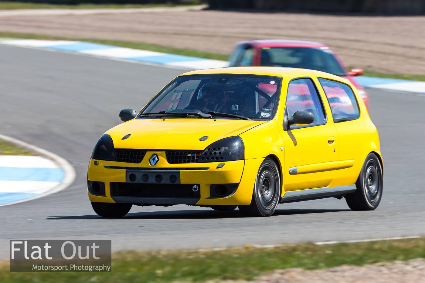

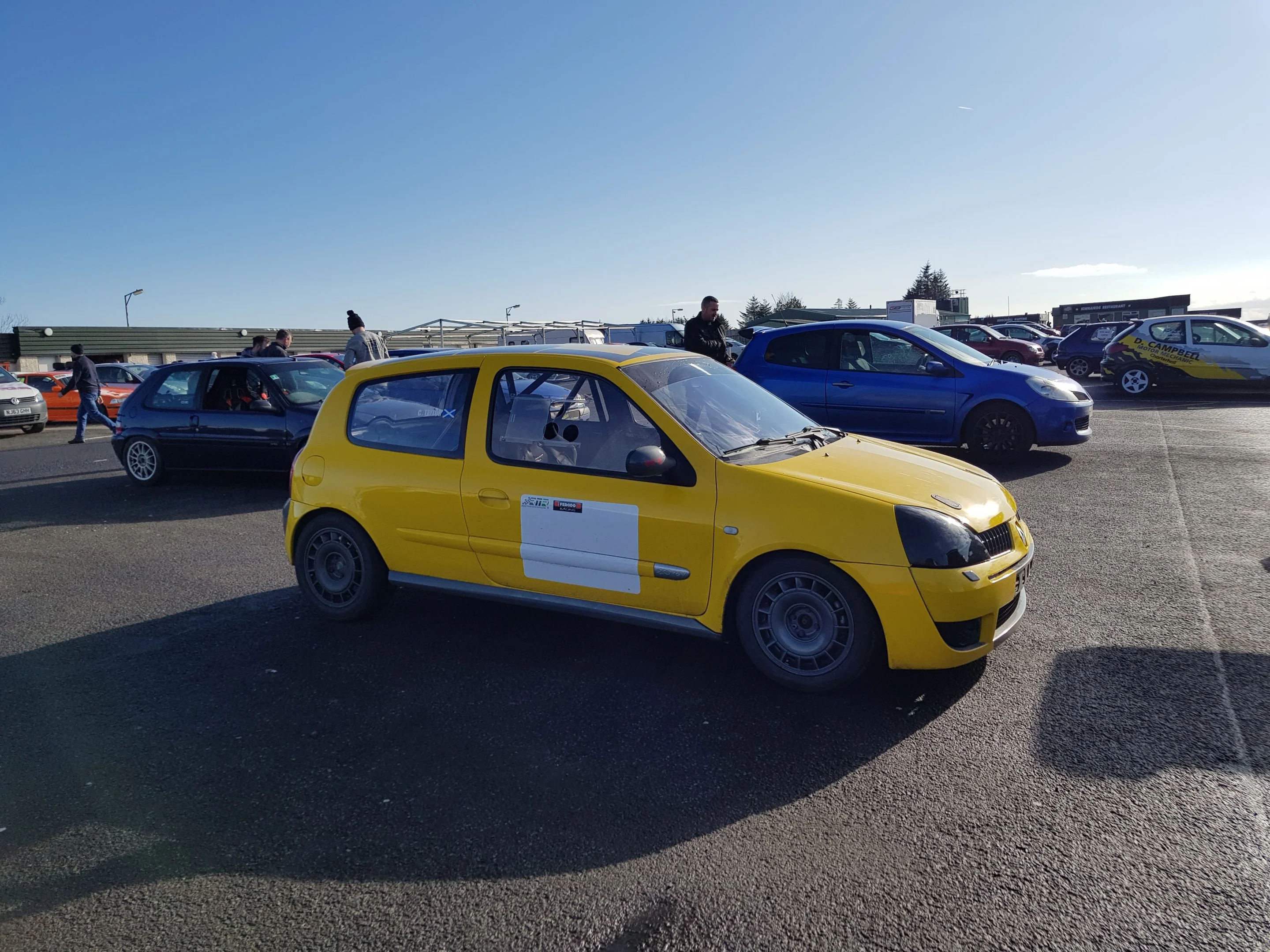

Fast forward to April the 1st.. knockhill Easter hot hatch day. First day out and couldn't have been buzzing anymore haha! Wasn't hoping to set any times or anything but more just a good day out and issue free...
First video was mid-day and was having a good chase with the puma 1.7 turbo, overall it is still quicker but the gap has closed and maybe if I improve my corners and over technique I'm in with a shout...
On the plus side set a new PB of a 61.08 :cool: and was on a busy track so very possible and the target is a 60sec :up:🙈
