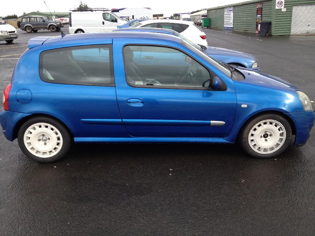

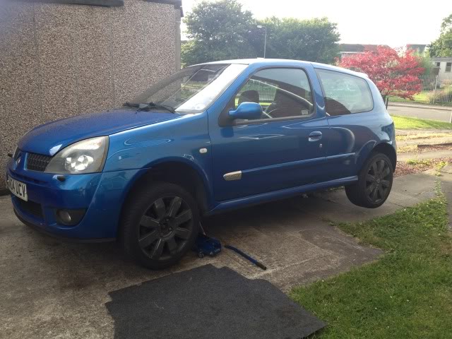

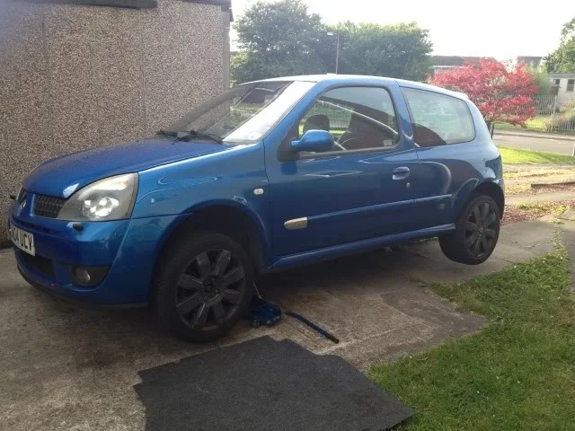

wee cheeky picture to when I first got it.. and started jacking it up checking it out.
the plan is to keep up to date with what I have been doing and get info from a few of you's as well, will be sorting myself out with a membership soon aswell.. seen a few of you's up at Knockhill, like the blue sport with the french colours on the grill, there is a couple of dark red clios and a few others.I did do a bit of knockhill before with this

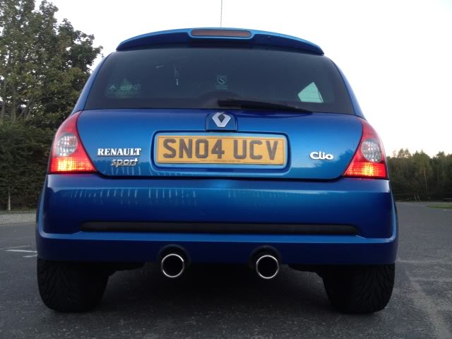

end result being a full custom RMS stainless system, told them to try and keep it quite, but has a fair bit of grunt about it, not that I am complaining haha

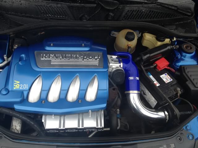

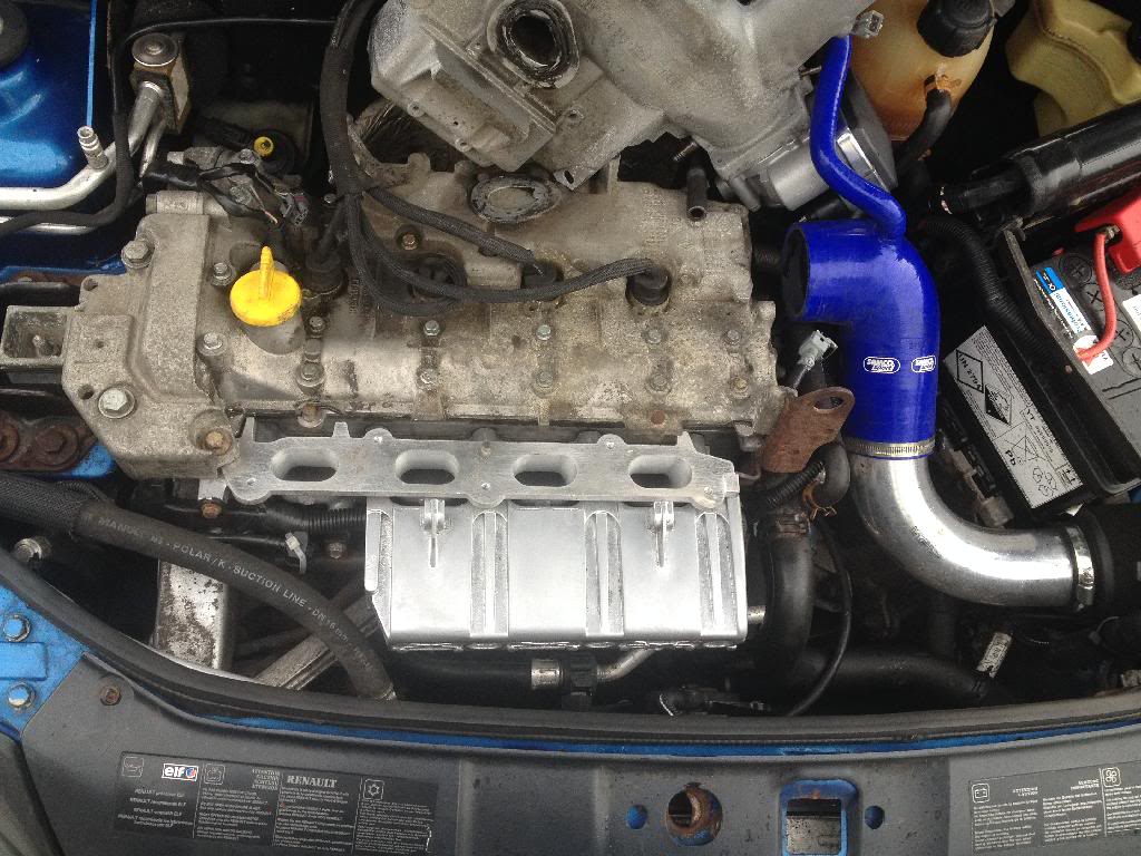

induction setup. - Completed

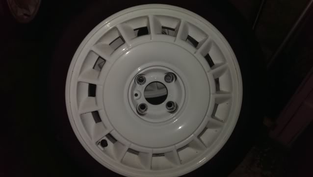

Ditch the standard alloys for some 15s. Cheaper tyres, less weight, better acceleration and IMO better handling.

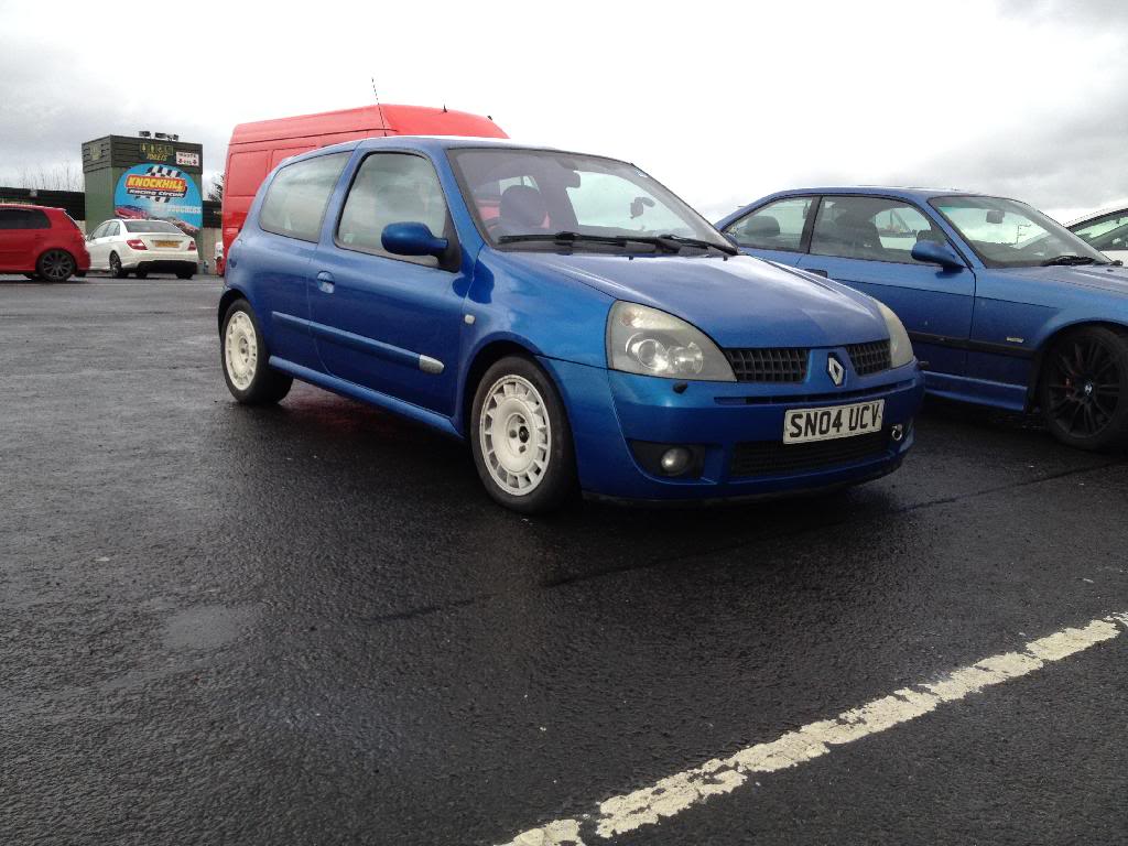

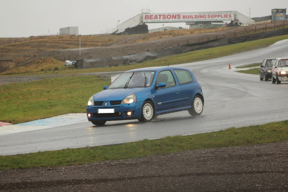

so had my first session out in the clio at Knockhill on Sunday there, and over all I'm very happy with it.
Drove the the car up in the morning following my mates Evo lasted the full day and drove home with no major issues. One problem I did have is my exhaust has moved slightly and touched and melted the bumper a little, nothin major.
As for for the track day... Car is running standard at the moment apart from having a stainless, preformed well passing a 182 throphy and another 172, taking a few redtop nova's, BMW 328i, mx5's... Has a good wee fight with a mx5 supercharged so happy with the end result.
A wee picture of it sitting in the paddock

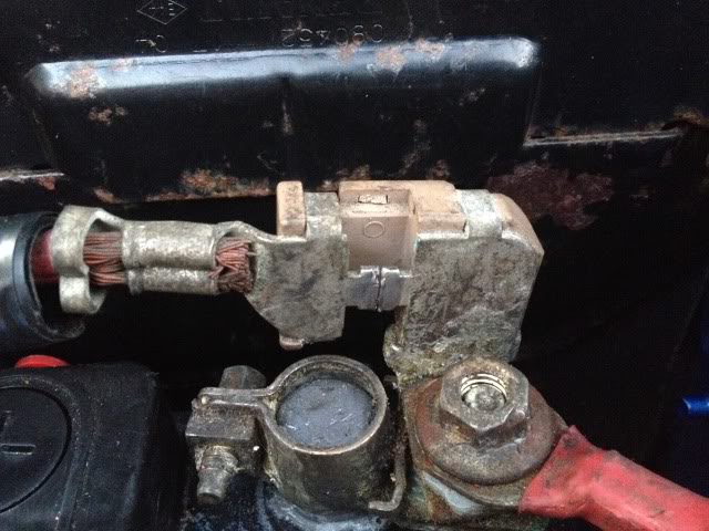

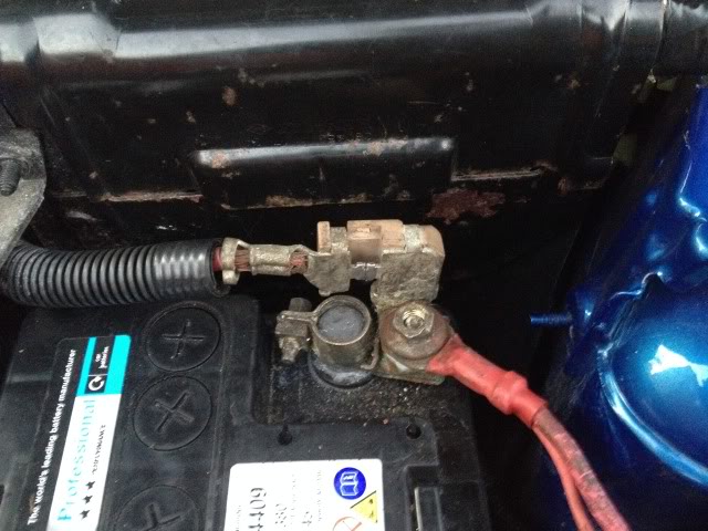

Only issue I now have with the car, Is that I took the car out after being out on Sunday and it's died on me, after further checking I've found the positive going to the starter had shorted agenst the exhaust manifold and blown the fuse that's on the positive lead coming from the battery. Anyone have any ideas on the rating of this fuse, as it's not stated on it.
So officially now a ClioSport Club Member :D check me ooot!...
fuse issue got sorted, with the help of a breaker on ebay and my handy crimping tool, joining it with the original cable, no need to strip the loom out or run new cable. so thats that one done and got the car back up and running.

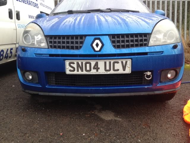

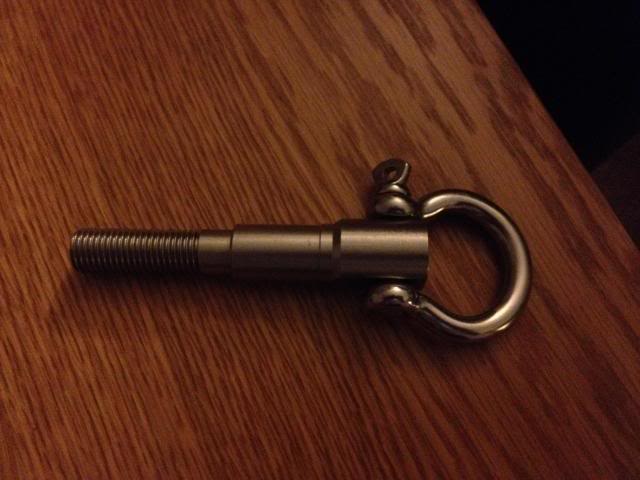

bought a must have extra that will be getting fitted shortly: -

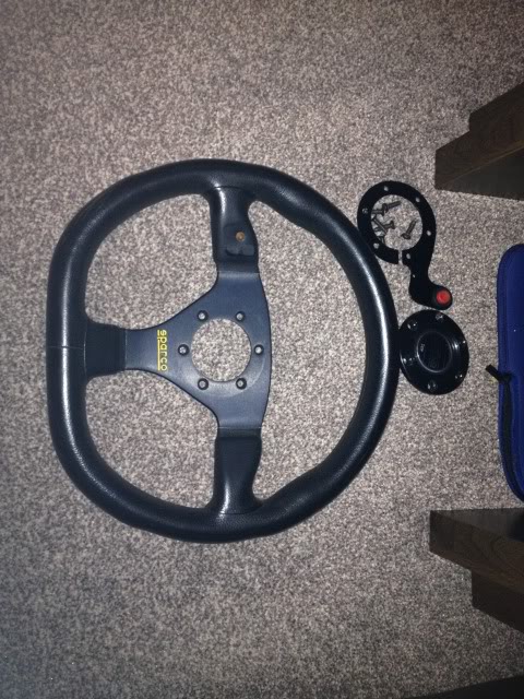

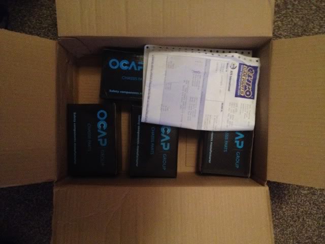

been busy buying a few new bits and bobs as you can see:...
new track rod ends and Bottom ball joints:

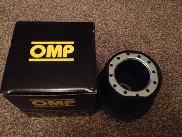

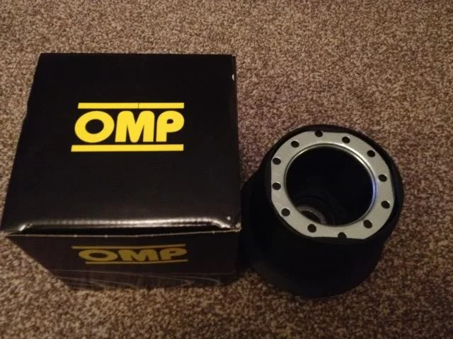

Sparco Wheel:
new wheel Boss:

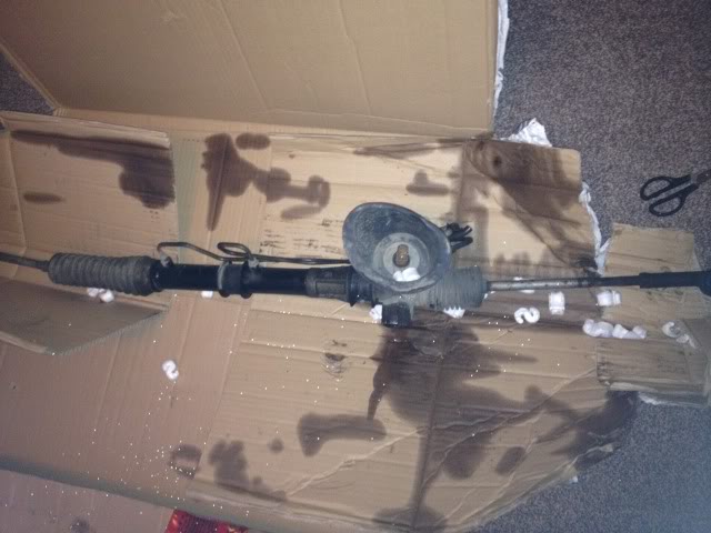

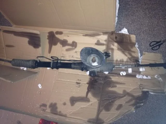

replacement steering rack: (terrible picture)
if things go to plan these all should be fitted and done by tomorrow :)

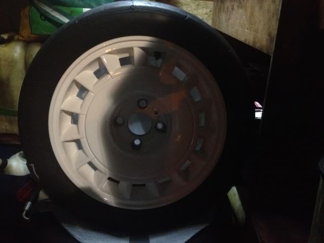

And to go along with the new suspension setup is a set of 15" alloys complete with marangoni track day tyres
cheers Dave999 happy with them.

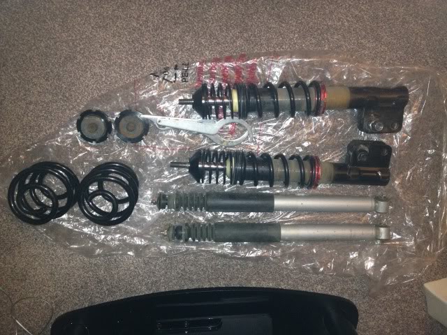

what I need to know is - what is an ideal height for track use.. Not wanting to go super low, anything as a guide would help.

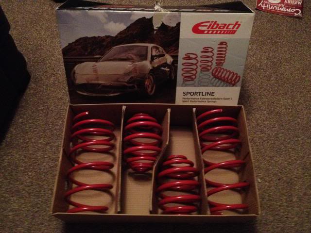

since my last update I have done a good few changes after fitting a new steering rack, bottom ball joints, track rod ends, rear shocks, drive shafts, I also put uprated top mounts on but I just wasn't happy with them...
as much as they looked good I had went back to new standard kit and far better all round

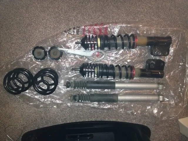

along with fitting eibach springs after getting the wrong type of coilovers..
was going to get cooksports but none available at the time.

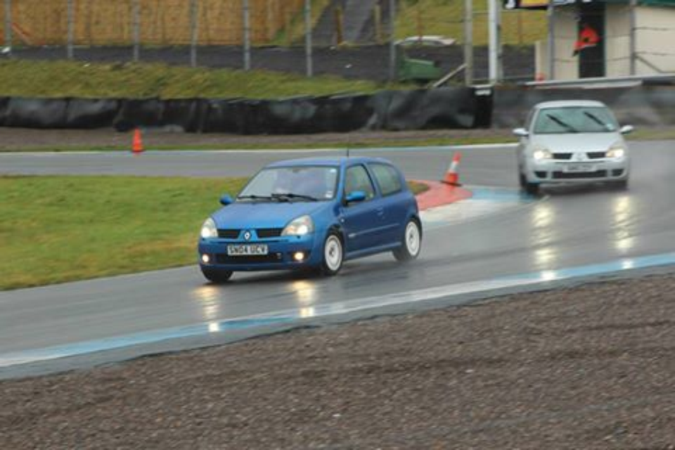

...so back to Knockhill,
proper awful day weather wise, cleared a little but good fun never the less :)
car handled well, did notice an improvement from my 1st time up so happy with it there. I had a set of 15" with semi slicks but never took them due to the weather, just didn't think it was worth taking them, saving them for a dry day.

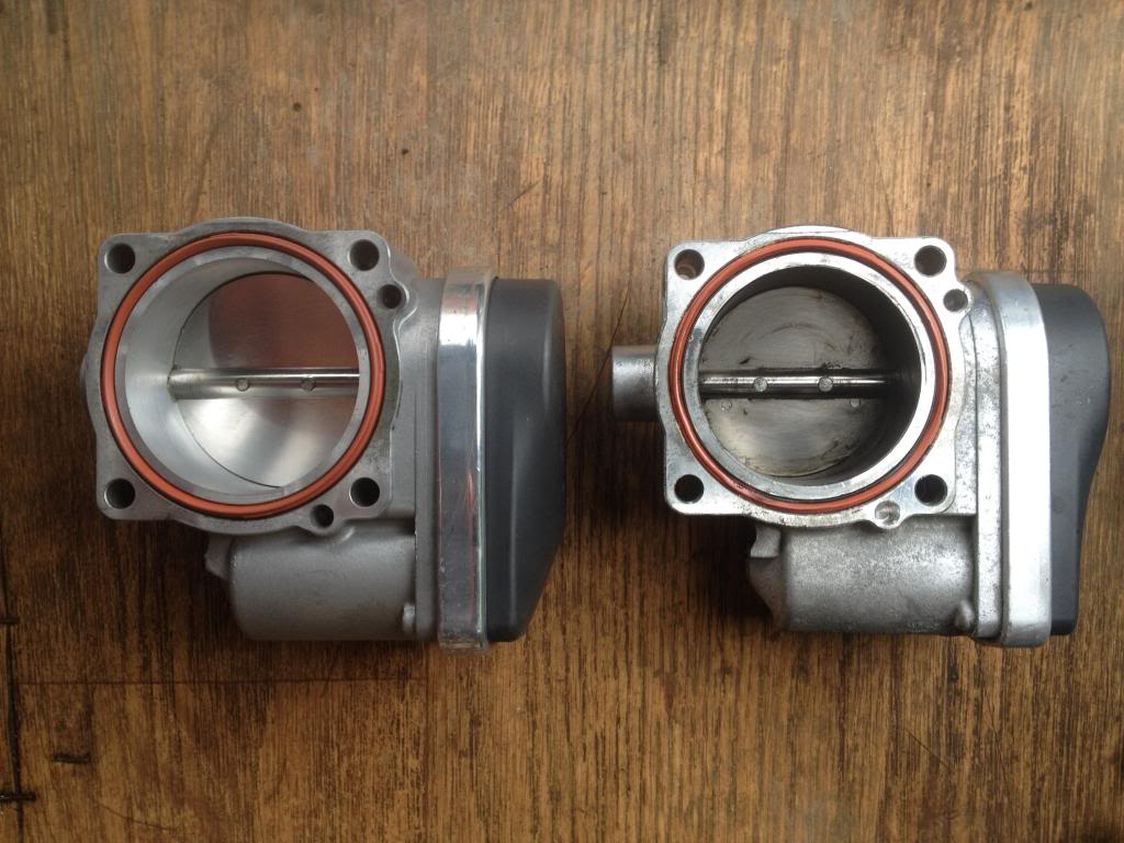

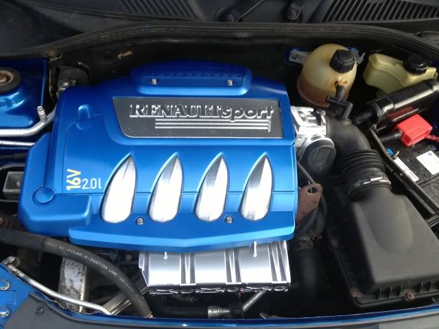

had my car go into limp mode a few times near the end of the track day so today I plugged it in and found the throttle body to be at fault so thinking about just buying new, k-tec are doing new for £330 or about that price but also found spead.co.uk doing a machined reconditioned one for £120, tempted and he has a few other machined clio sport part so I'll be looking into that.

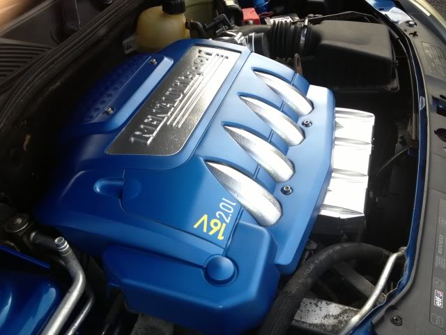

little update:

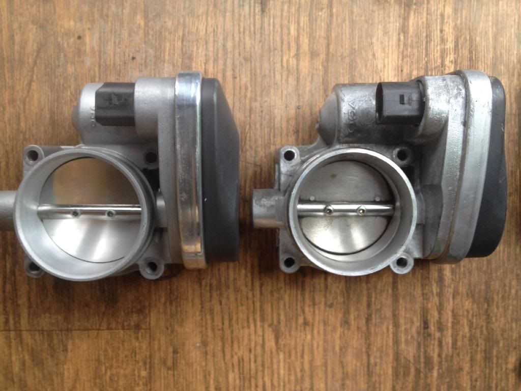

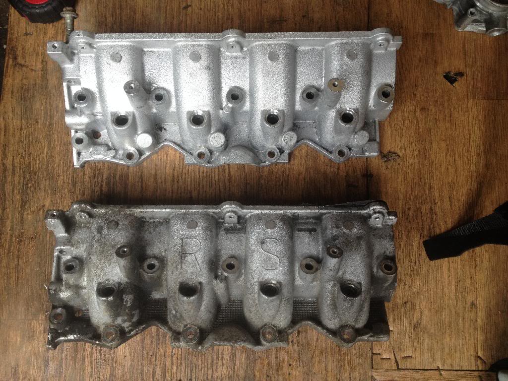

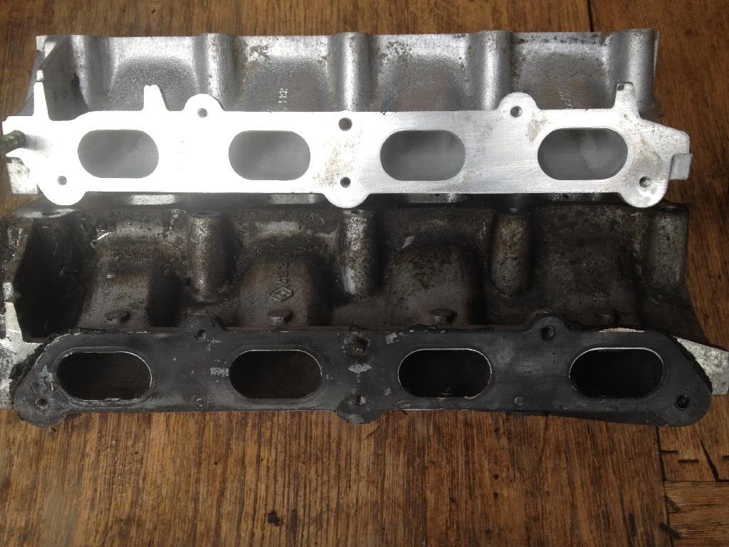

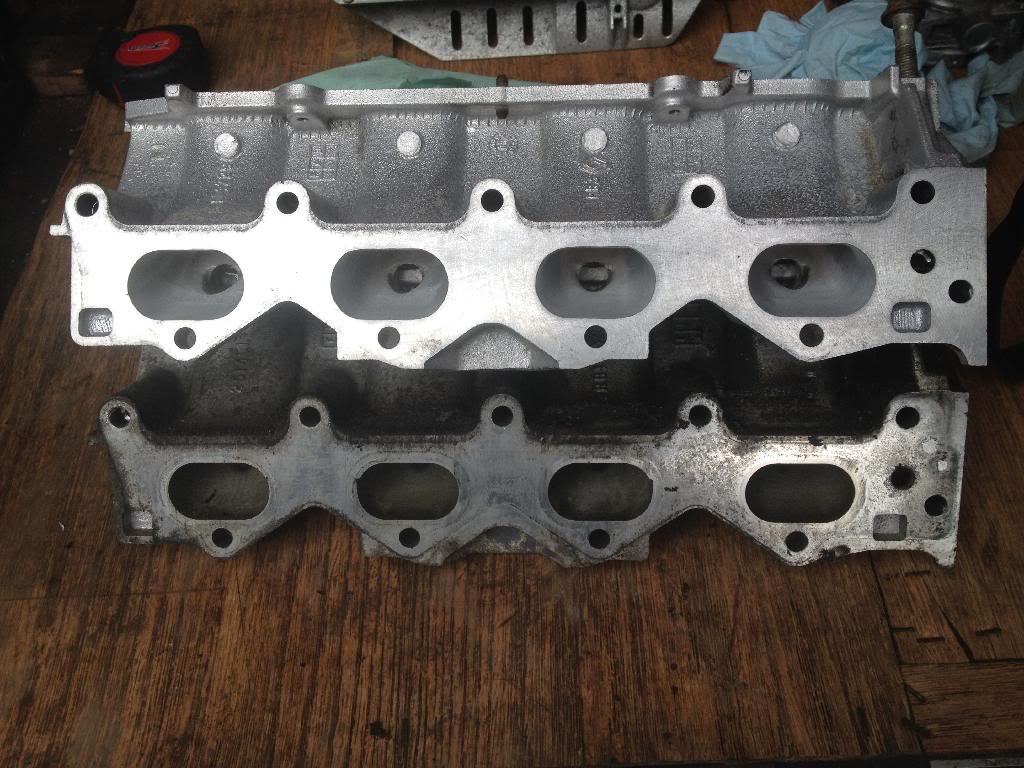

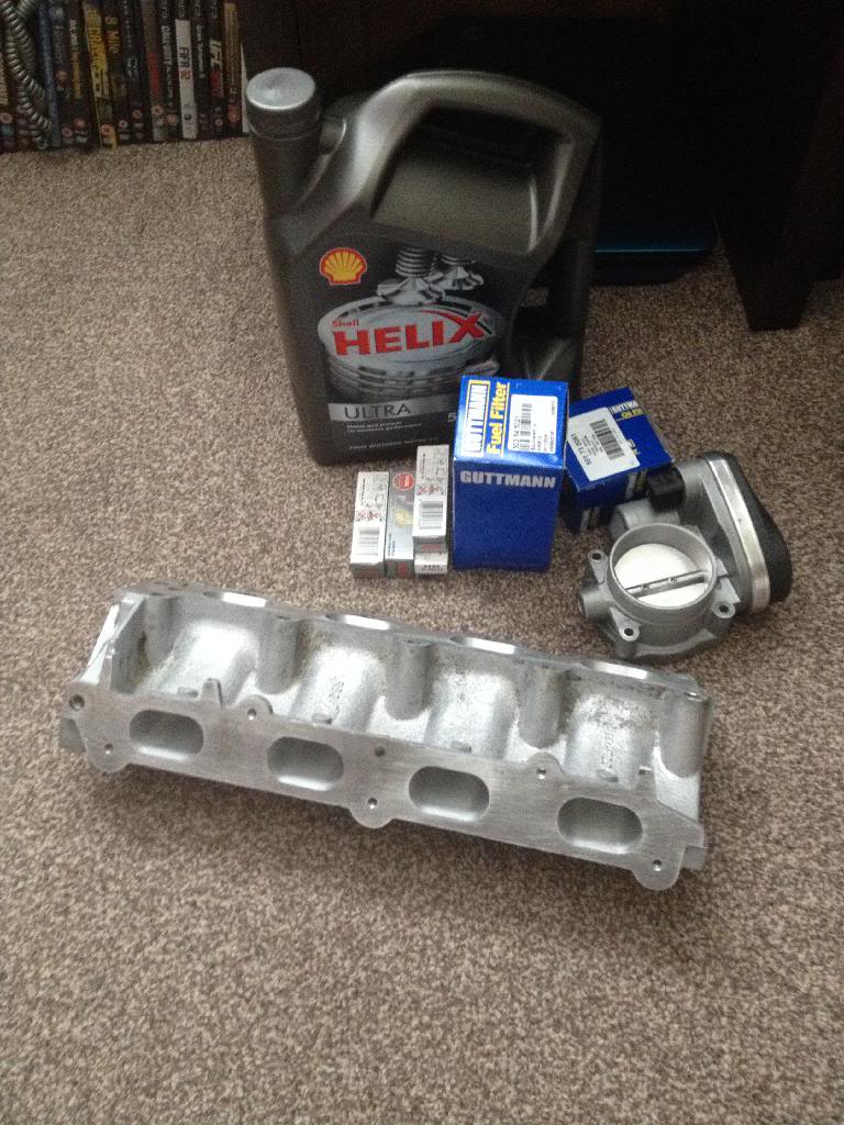

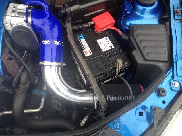

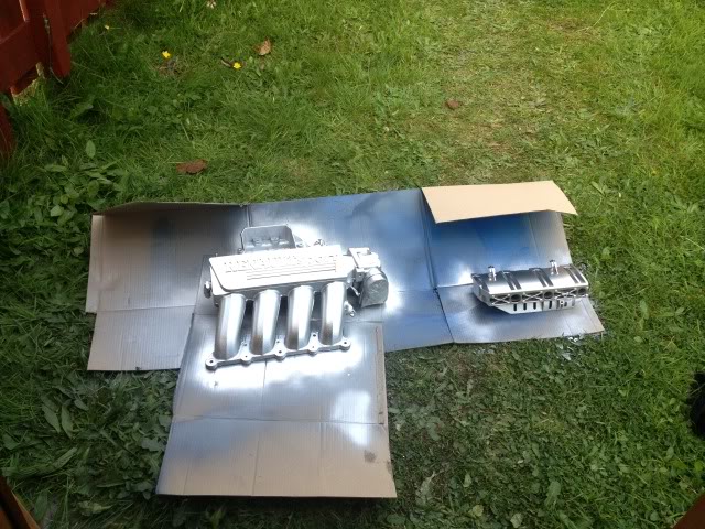

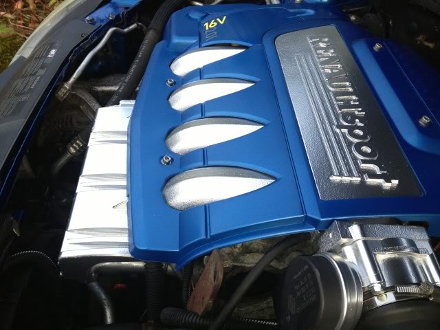

today I was fitting my new go faster parts :D. Had a issue when on the track where it went into safe mode, and long story short it turns out to be the throttle body sensor.
its a built in unit so new throttle body was needed. could have went standard but found a guy down Sussex, and after talking to him and checking out his work (has a clio project himself) decided to get a machined and enlarged one from 60mm to 65mm along with a machined and enlarged lower inlet manifold.
the claim is an extra 10bhp +17ftlb
www.spead.co.uk
so This was today 'To Do' list...
a few New Vs old picture
just awaiting a new inlet gasket as shown..
looking forward to see how it runs now.
still to change the oil and fuel filter but that can be tomorrows jobs + a check over on pads etc to get ready for next Knockhill on the 23rd.
next step Im considering is a remap... what I wanted to know is does any one run with bigger injectors or fuel regulators, or not worth it?
Looks a good project hope to see it up the Hill at some point this year.
I would think your more likely to see 4/5 bhp max from the body and flowed inlet not 10, I would get the fuelling checked to be safe as mine went lean in the midrange after i ported my old inlet.
Yeah I was thinking more 5bhp than 10 as claimed, but I'll hold out and see. Definitely looking into if extra fuel will be needed, tempted to get it on the rollers to see what I'm putting out.

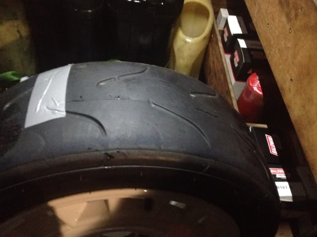

so after it's 3rd time out at Knockhill on the 23rd Feb just there, the car ran well no issues to report but had tried my semi slicks for the first time, and running on 15's aswell.
Outcome: not impressed but to be fair the conditions just didn't suit them and they are not like R888's or similar. A little more slick than them. I felt they just didn't dispose of the water atoll, Leaving it slipping and sliding a lot more than I did last month running in 16's and road tyres. (The conditionslast month was worse than this months.)

A good picture of eibach's sport lines VS cooksports
Any issues with the larger throttle body?
Looks good!
never experienced any bother on the day I did have a worry I might be a little lean with both inlet and throttle body being larger, more air and not enough fuel but it felt smooth wouldn't say I noticed a major difference. I think I got a little more lower range but marginal...
When I did fit the inlet and throttle body the ecu took a while to correct itself and was running at 2000rpm but now back down to 1000rpm when Idelling. That what's making me think a remap is in order.

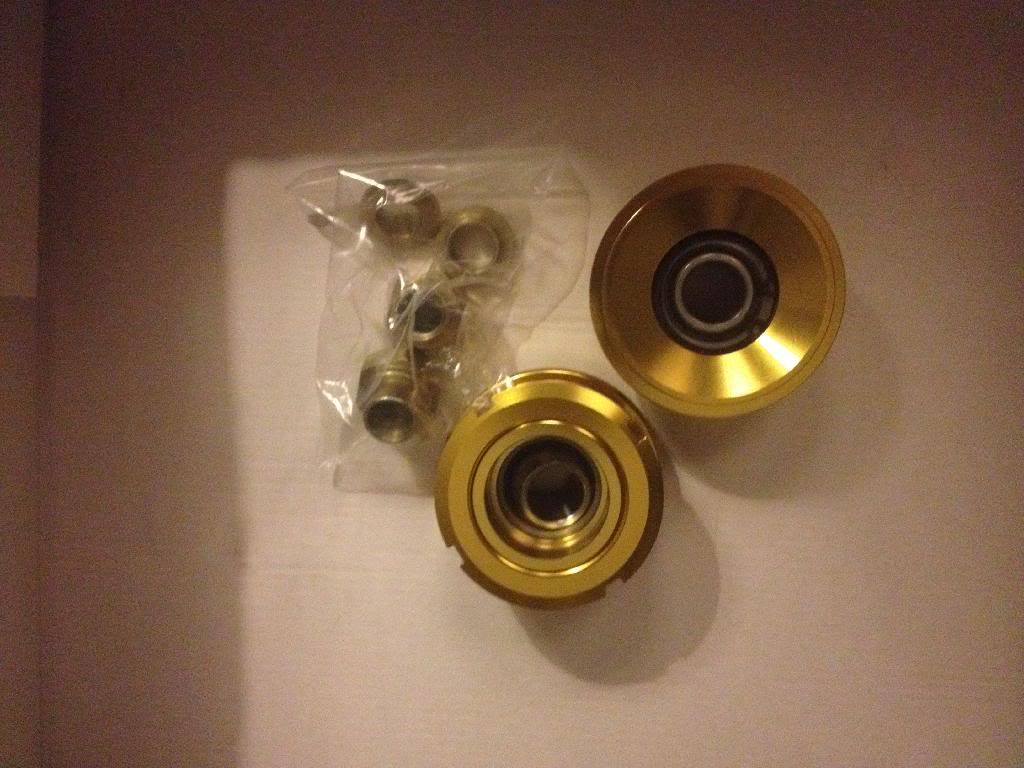

Had the car in for its MOT today and it failed on bushes on the anti roll bar, along with the horn I melted haha! not a major surprise but told them to go through it and tell me all faults. result being needing rear axle bushes and the dogbone
... so just ordered my self a set of powerflex's along with a uprated dogbone mount from EvolEngineering2013.

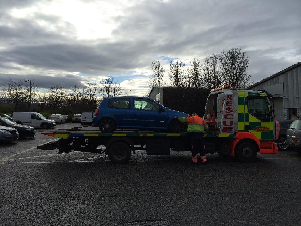

The bad luck seems to be continuing right now... On route to rentec the clio dies on me 2miles away!!
battery light came on and then airbag and handbrake and abs and in fact all ....
So let's see where this takes us...
