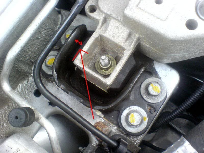

I tried to to do this and it didn't move. Took bolt out and hole was round. Couldn't understand how it would move? Any one?
Have a look at the mount in this pic, ideally you dont want a gap beteen the rubber and the black bracket (where the arrow is). You want the gap on the front side of the mount as in this pic. Follow Bens guide, if your still getting knocking one or more of the mounts is badly worn.
