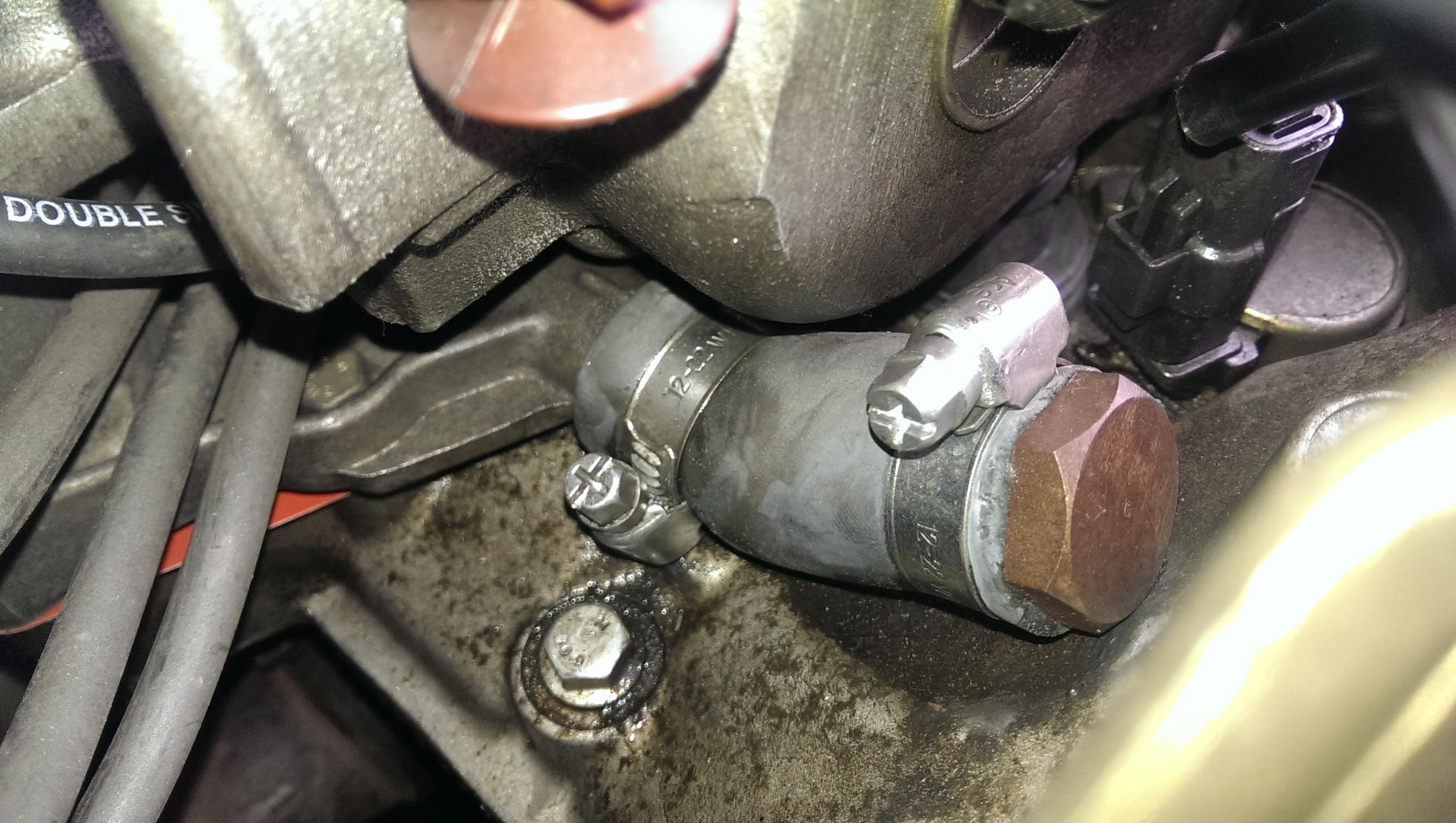

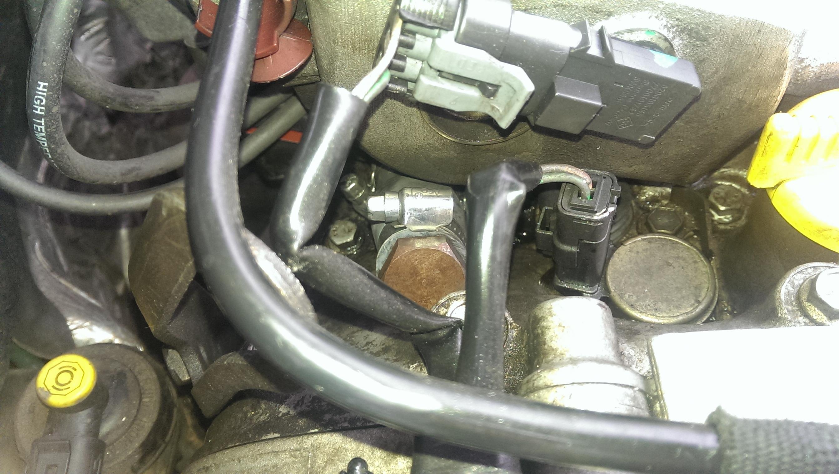

Last question what is this in the pictures it doesn't look very standard what should be there instead is it missing a pipe or something ?

Thats a 172 engine breather , on the 182 engines that parts not used.
So it may of had a replacement engine or head at some point.
Hence bolt fitted in pipe.

Thanks for the reply, ok so the fact it's blocked off won't be hurting the engine in any way if it's not usually used ? And it would cause an air leak on the engine ?
that wont cause the airleak, best bet is to check the upper manifold seal, remove the renault sport manifold at the top its onlt a few bolts and on the underside you will see a rubber seal make sure its fitted correctly or replace it.
